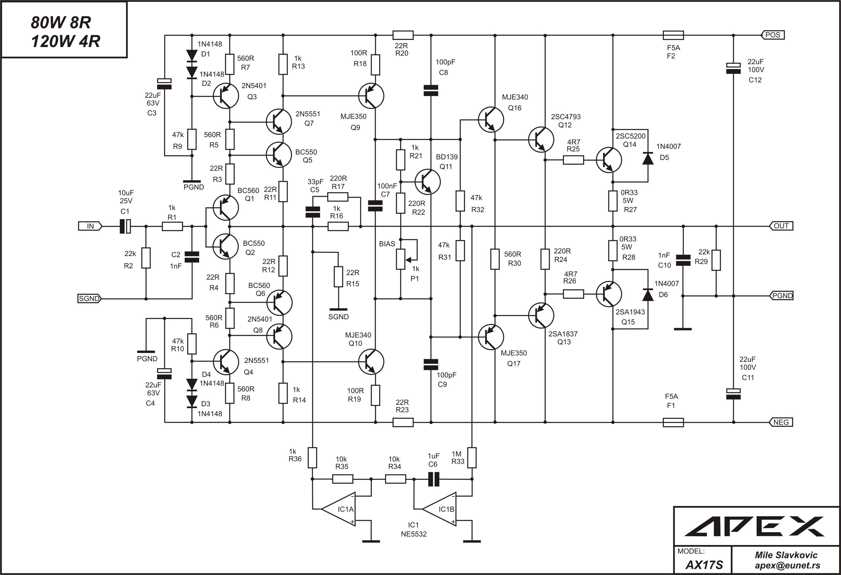

Do you use any protect on this amp?
Regards
AX17S

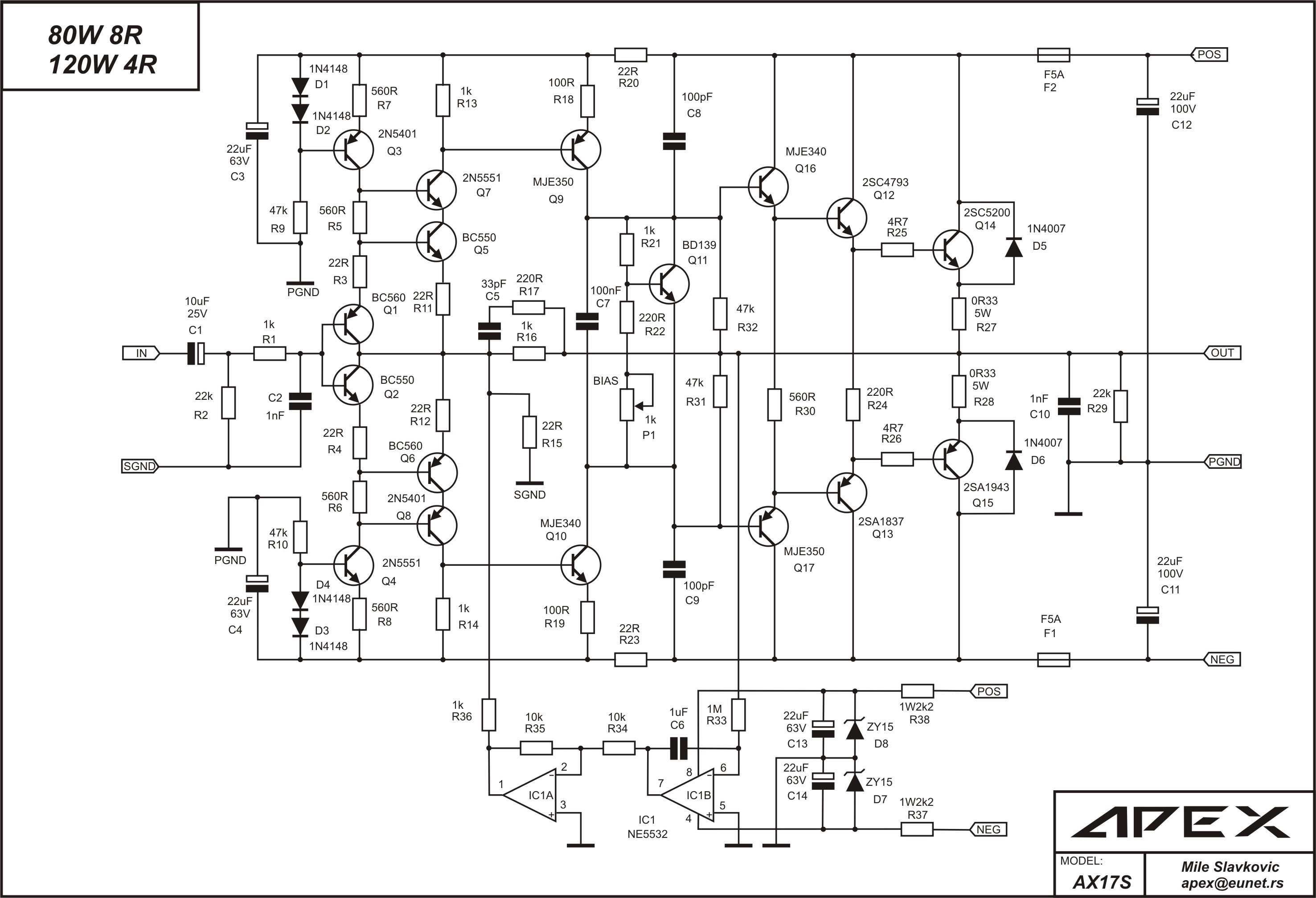

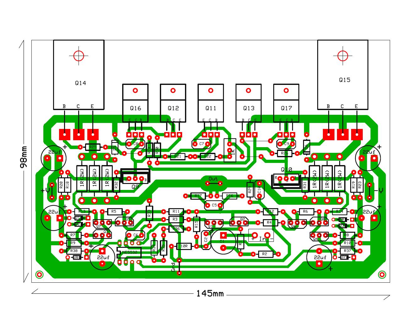

AX17 with DC Servo circuit.

Hi Apex,
What is the difference with AX17 for the sound,
is this one has a deeper bass?
I'm not make the AX17's PCB yet, maybe its better a lot AX17S
or better I make the AX17 first & add servo latter?
Regards
Amplifier must be neutral in sound, for deeper bass use speakers with deeper bass or 'loudness' circuit if you must.
No need to use servo, match transistors and add pot for set DC offset, with DC servo it's easyer (auto set).
Regards
