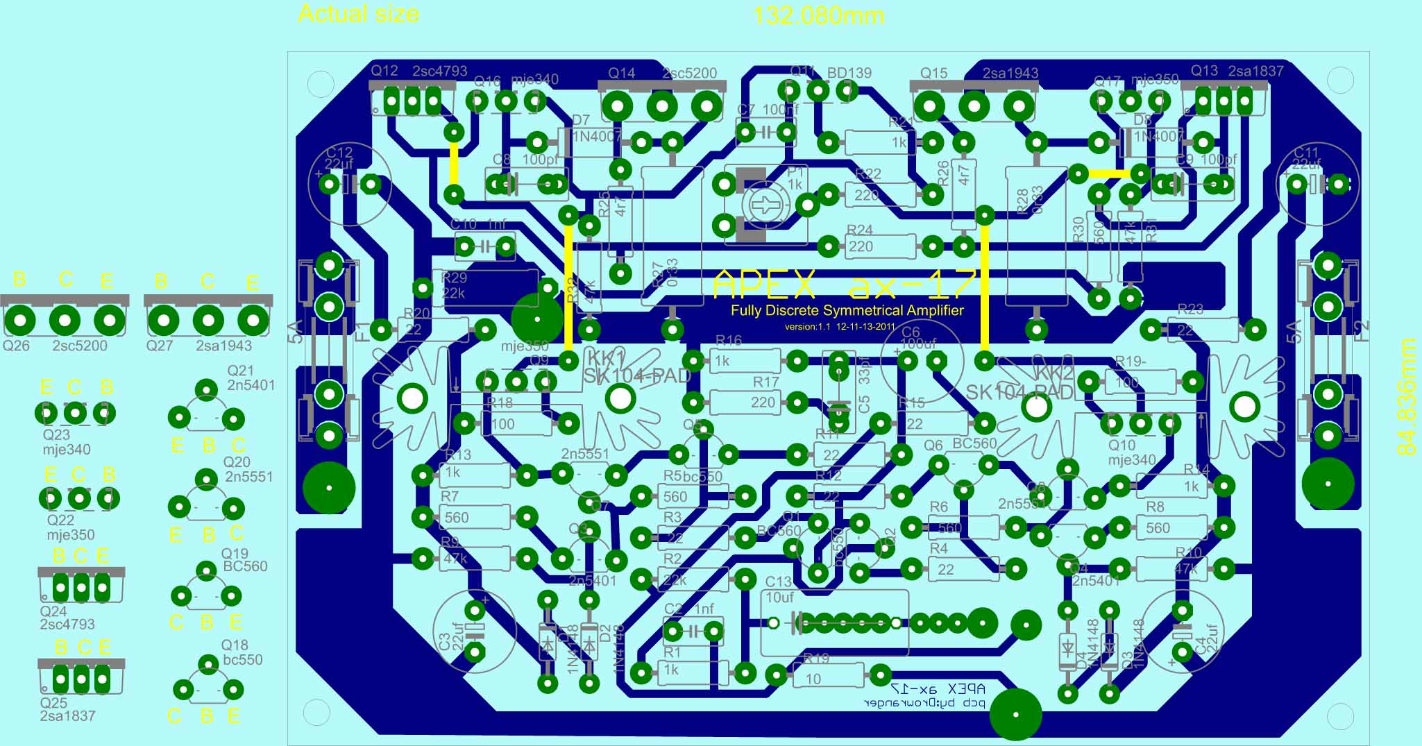

In post #995, you mention of an AX17S v2; Is it any different to the PCB in post #994? If so can I have the PCB of AX17S V2, I need to etch it. Also, may you please give me Power PCB / Schematic. What transformer should I use If I want to power 2 AX17S V2 for stereo sound. Thanks.

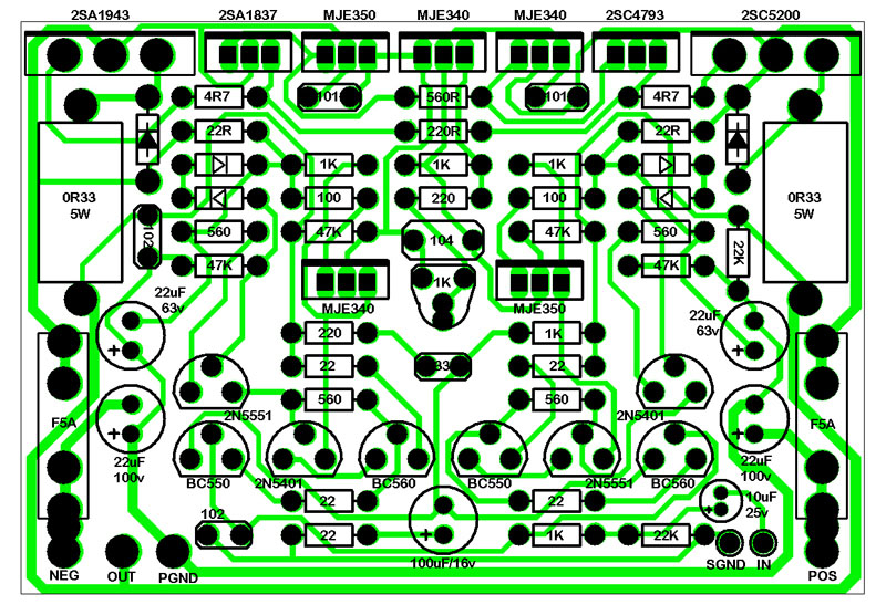

Use pcb from post #993, and AX17 can use same PSU and protect as AX14, NX14... or similar +/-45V 5A for stereo.
@ JOHN BALI use pcb from post #993, your pcb is not good for amplifier.

Pcb must be design with 'star' for ground 'star' for output, and rail tracks after decoupling caps, feedback from output 'star' to input... You have right for your tracks, but pcb is better to be smaller as posible.

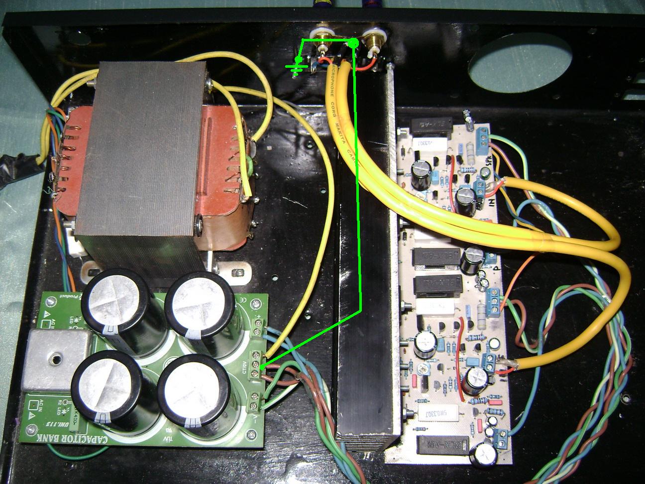

Dear Mr. Apex,
Unfortunately, my ax-16 has just produced noise and pop up when it turns on on both channels I don't know why? It does never happen before. I measured dc out put but still low.
Please give some advices to solve the problem. Some one told me that there are some parts (small transistors) could be malfunctioned or broken...Could you give me clues which transistor potentially broken?

Measure BE voltages on small transistrors, must be about 600mV.
I have replaced all small transistors with new transistors , also all glass diode , but the result still the same. My amp still produces noise and hum, I need your advice. I am sorry I forgot to measure BE voltage...Could you tell me the purpose of measuring BE voltage? I will do it soon.
Thank you so much...
Connect GND from PSU to the input terminals, from input terminals to case, discconect amp gnd from input gnd on amp pcbs and add zobel network on speakers terminals ( 10R, 100nF)

But these noise and hum never happened before. It run very great before with that lay out for months, and I like the sound so much. It happened first time only for left channel, and the other channel went the same. I think some parts may be in trouble.
Add zobel network on speaker terminals, with EI transformer instead toroidal HF instability is possible.

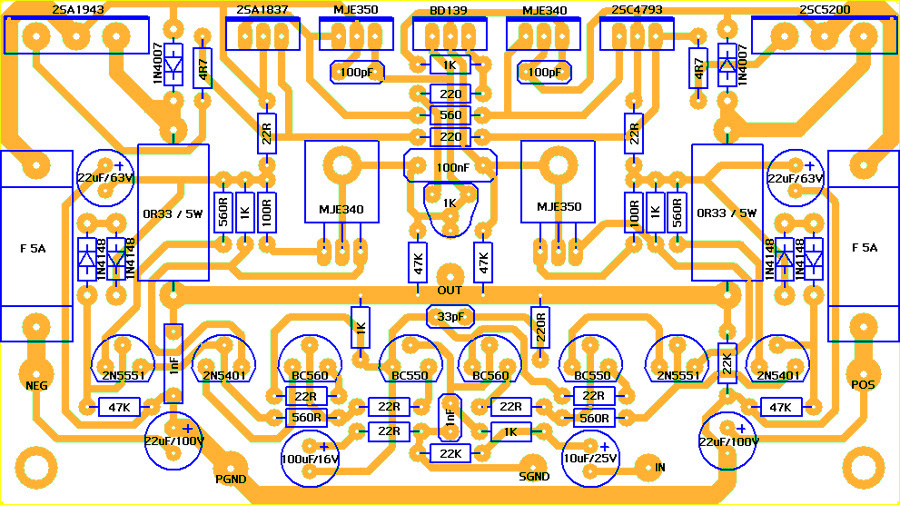

Thanks to Apex,
You really save me... 🙂
I hope this one is okay to continue
if not okay yet, I will make new design again...
If okay I will made it soon

Thanks to Apex,

Hi John Bali...
I have checked all the supply caps ...fine. Also I changed with other supply from another amplifier ... still get the same noise and hum...
