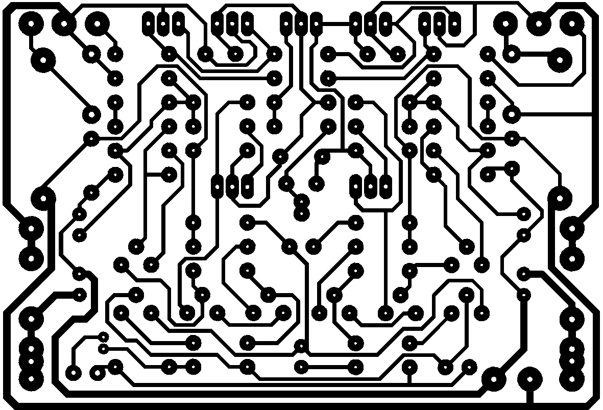

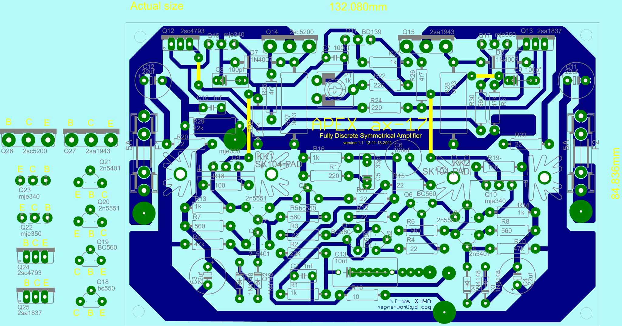

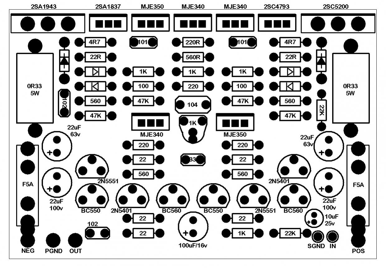

Here my PCB design...
It is okay? Maybe some comment please
Pcb size is 10cm x 6,8cm
Regards
John
Single pair for +/-45V DC & 4ohm load maybe it's hot
If add 1 more pair what happen?
Need to add 2 more 0r33/5w, 2 more 1n4007, & 2 more 4r7
or I do need to change anything?
Regards
John
Fully simetrical pcb

hand made againFully simetrical pcb

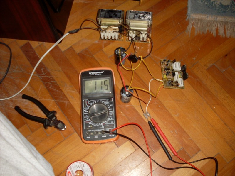

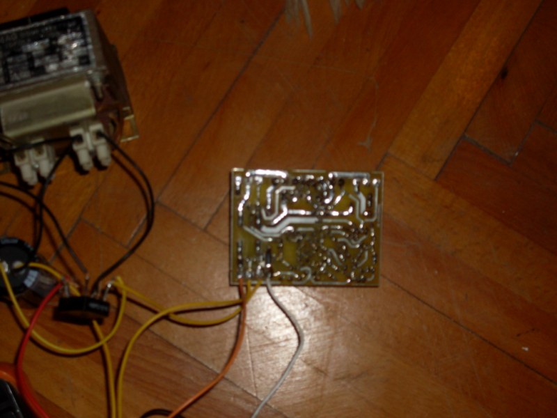

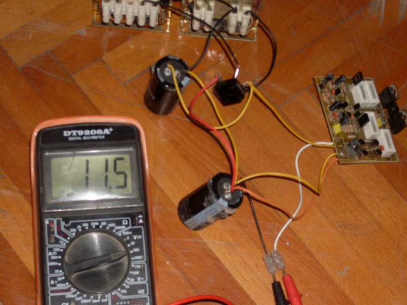

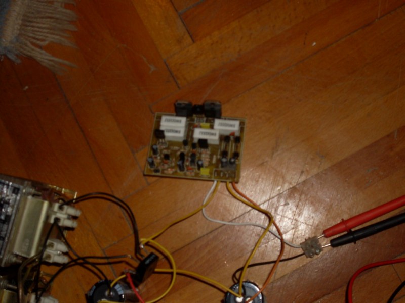

Hi, Apex sir.
Can B80 amplifier work with more than +/-45V, and what need's to be changed?
Have a lot BDV64C/65C transistors, they are 120V 12A 125W.
Regards.
Also I have problem with some your amplifier boards that I trade with my friend. There is ~12V DC on output.
Will post pistures.
Regards.

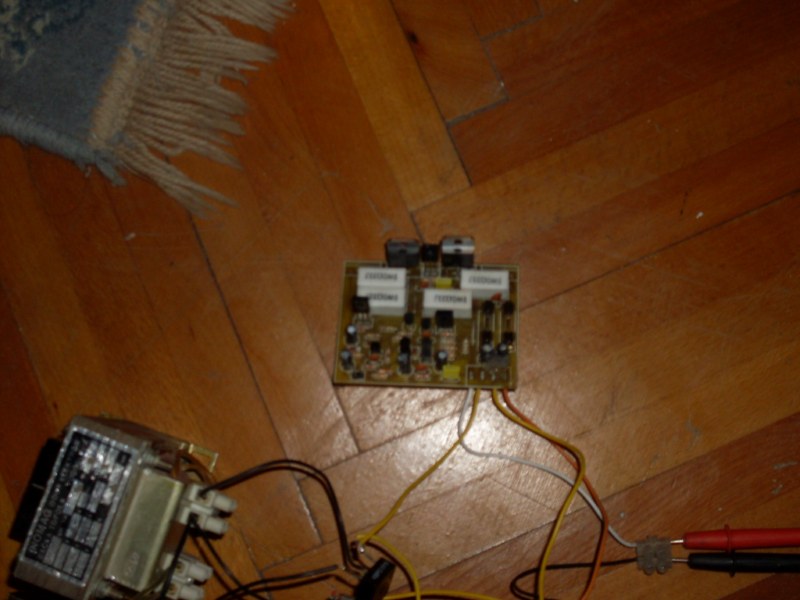

Will post pistures.
It have ~12V with +/-40V supply.
Regards
Input GND must be connect to PSU GND, and short amp input to input gnd for all DC measurements.
Regards
Hi, Apex sir.
Regards.
Will post pistures.
Amp on this pictures is D14 with 2 pairs of darlingtons in output stage, and you can use it with +/-60V DC rail voltage without changes but you must add another pair of BDV64C/65C outputs.
And again you must connect input GND with PSU GND for any test and measurements.

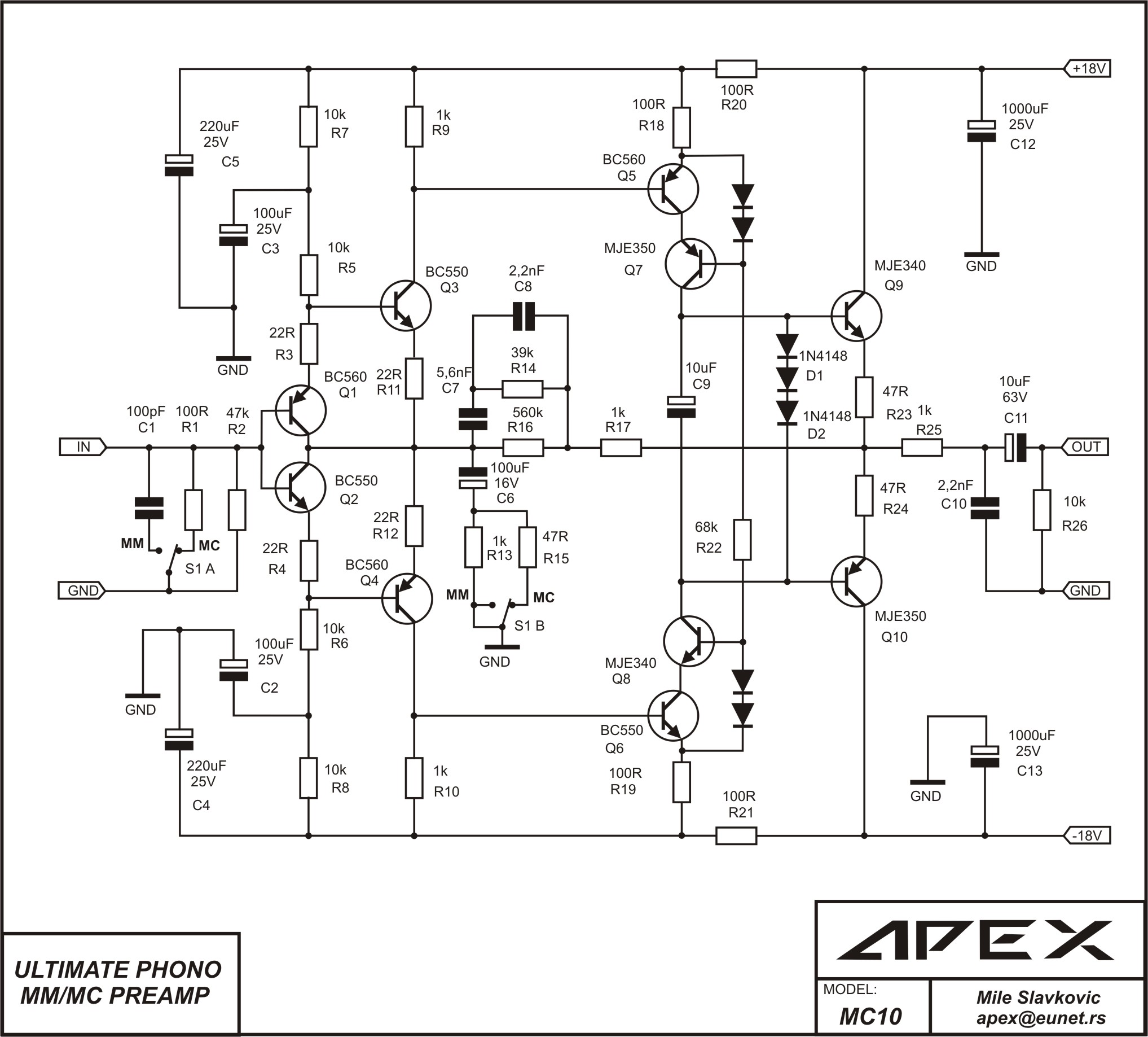

MM/MC Phono Preamp
S1 is MM/MC switch, current position is MC
