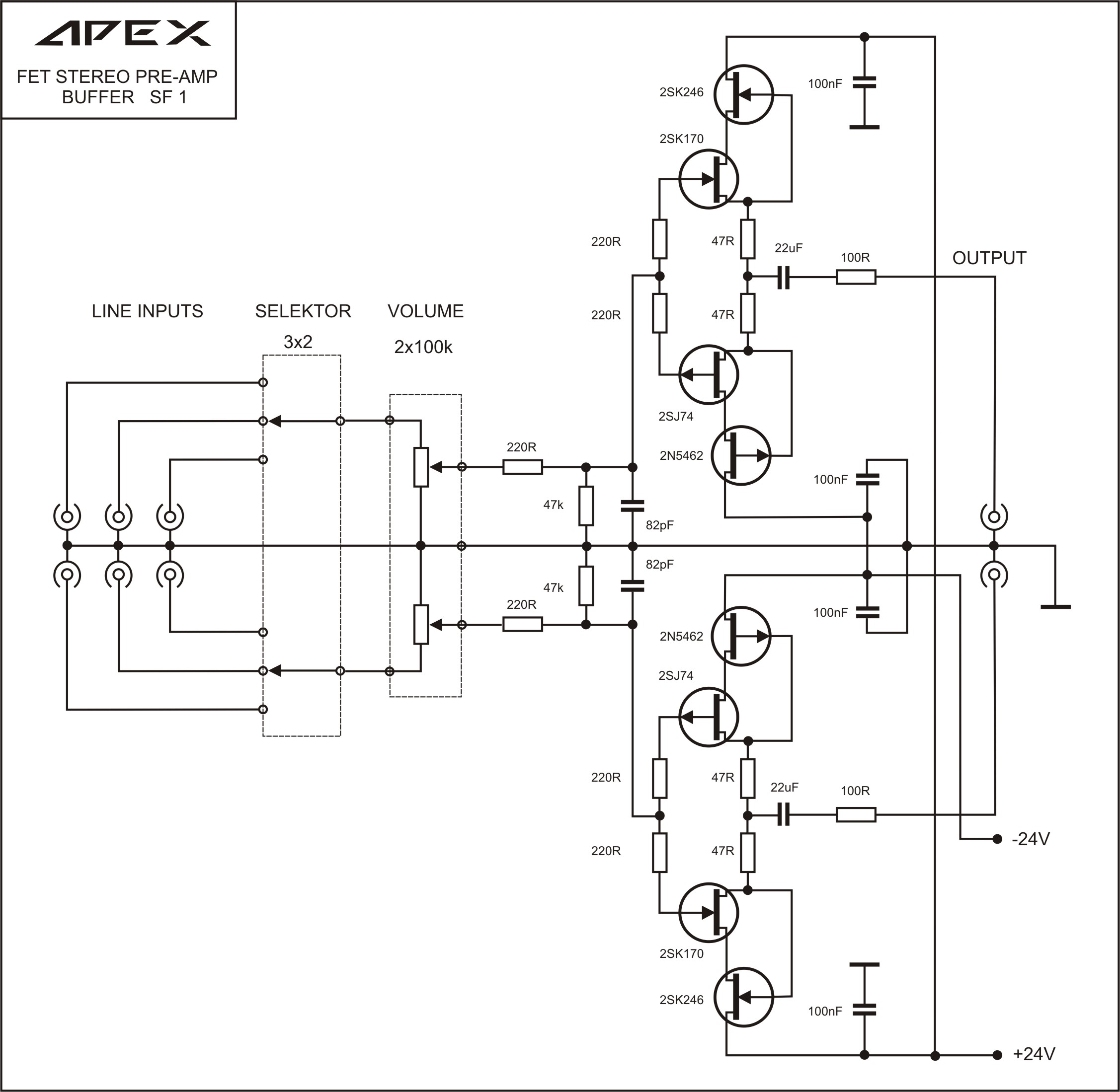

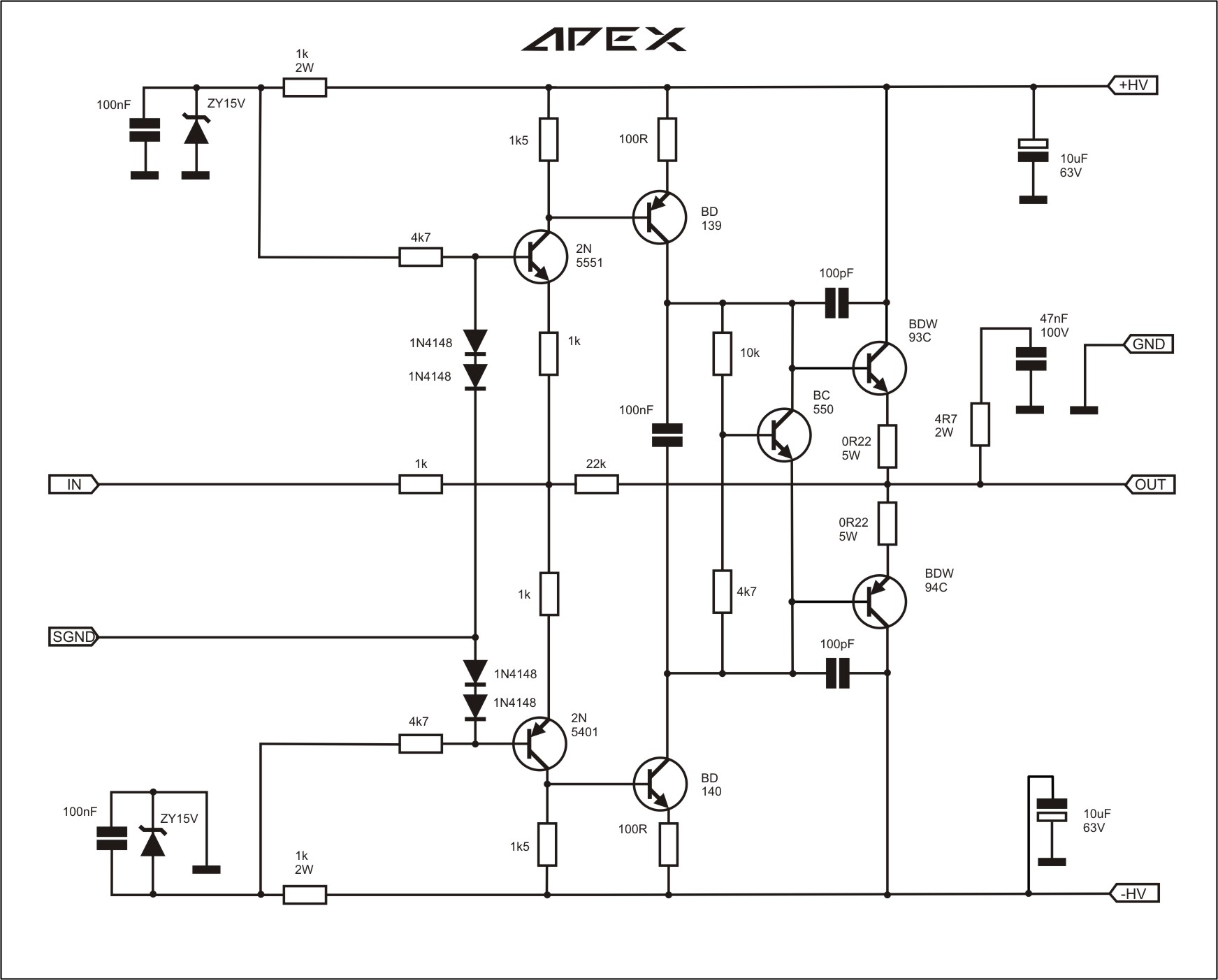

Dear Apex, Im try to desighn the preamp for my b500. could you please to chack for me this desighn. Ultimate Fidelity Amplifier
Your pcb design for stereo preamp from post #57 is OK, I suggest to use stereo buffer as preamp.

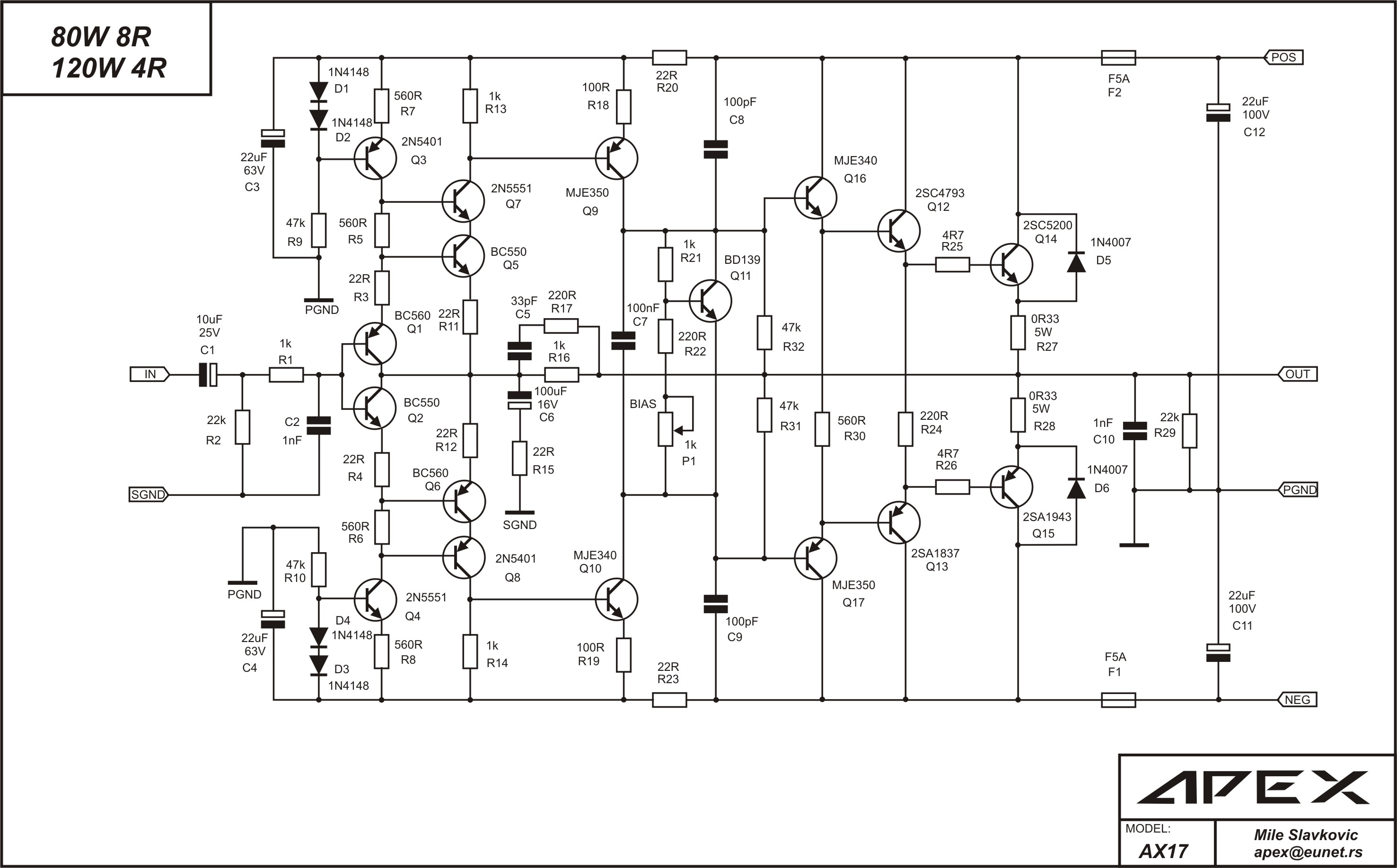

Yes TEF is Triple Emitter Follower output stage like this AX18.

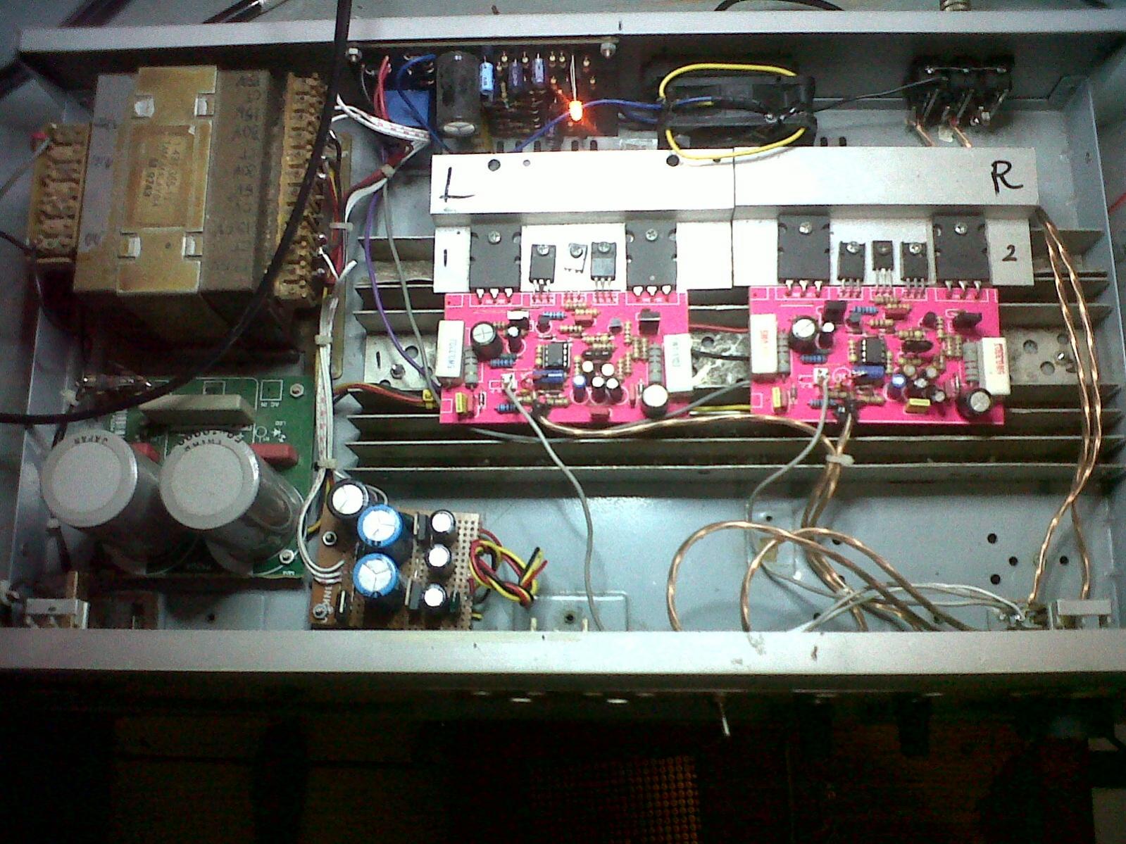

I want to know the correct placement of bd139 for correct thermal compensation in tef configuration.should it be mount on on the first stage of tef configuration ? shuold all these transistor in tef configuration be mount on the same heatsink along with the output transistor together with bd139?

BD139 must be mounted on the same heatsink together with drivers and outputs, only predrivers can be placement separate,

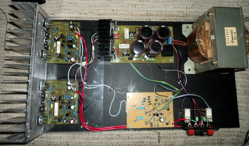

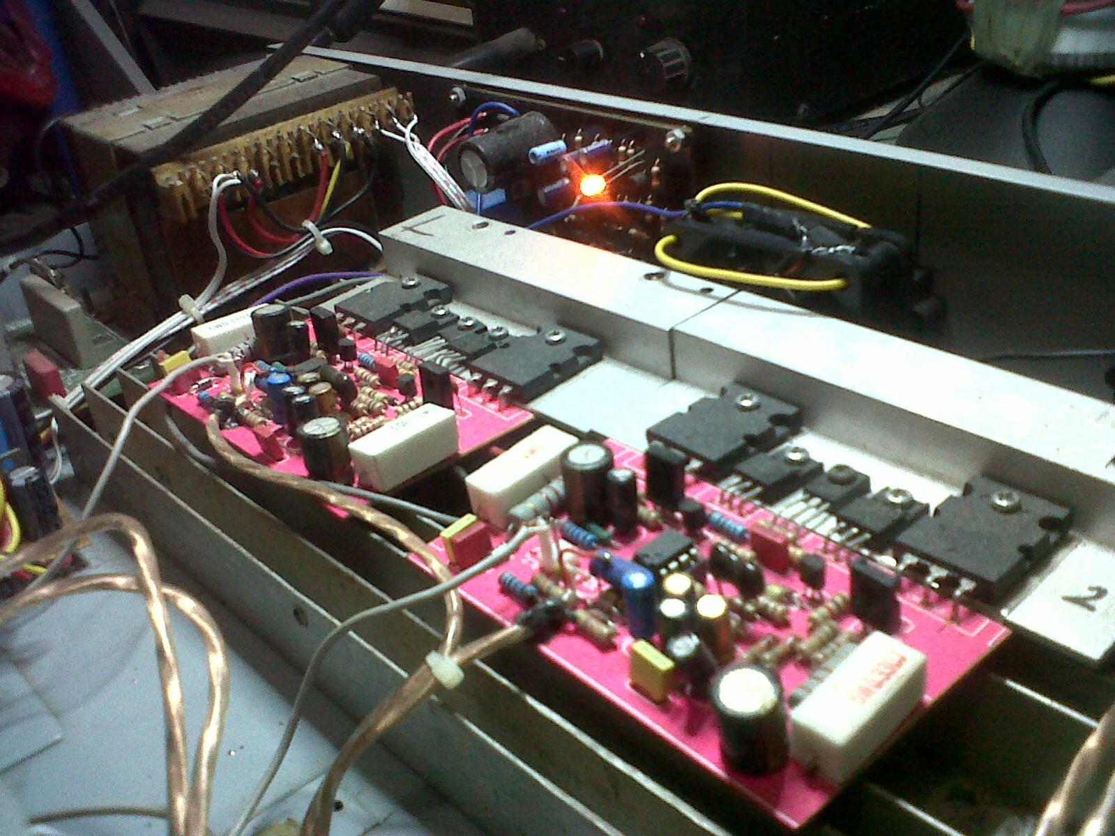

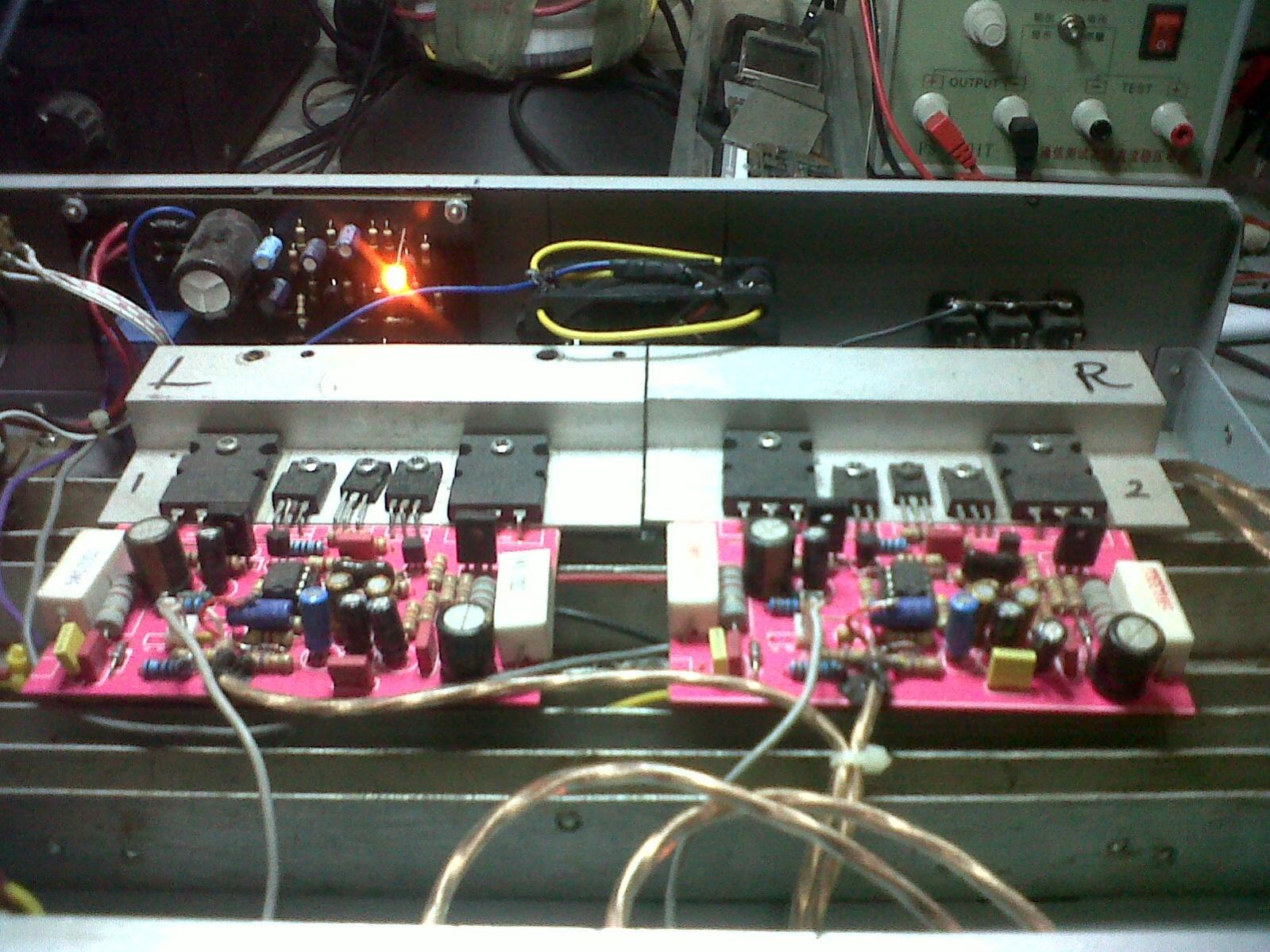

Ok Dear Mr. Apex. I will take a picture and post it...later...I put B1 buffer. It's a little bit difficult to find good caps with higher votage more than 63 volt. I plan to supply 45 - 0 - 45 Vac. Some suppliers only have 50 volt as a common. Now it is operating in 40 - 0 - 40 Vac.
Best Regards,
Arif

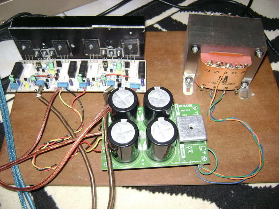

How about changing the transformer into toroidal type? Will it make a lot of improvements? My friend has some bad experiences using toroidal transformers, 2 times blew up after 2 hours operation. There were because of the toroidal quality I supposed. Now he is trying to make his own toroidal.

I suggest to use regulated PSU.

Toroidal type transformer have adventages but problem can be high voltage from turn to turn in primary wireing (over 200vac).

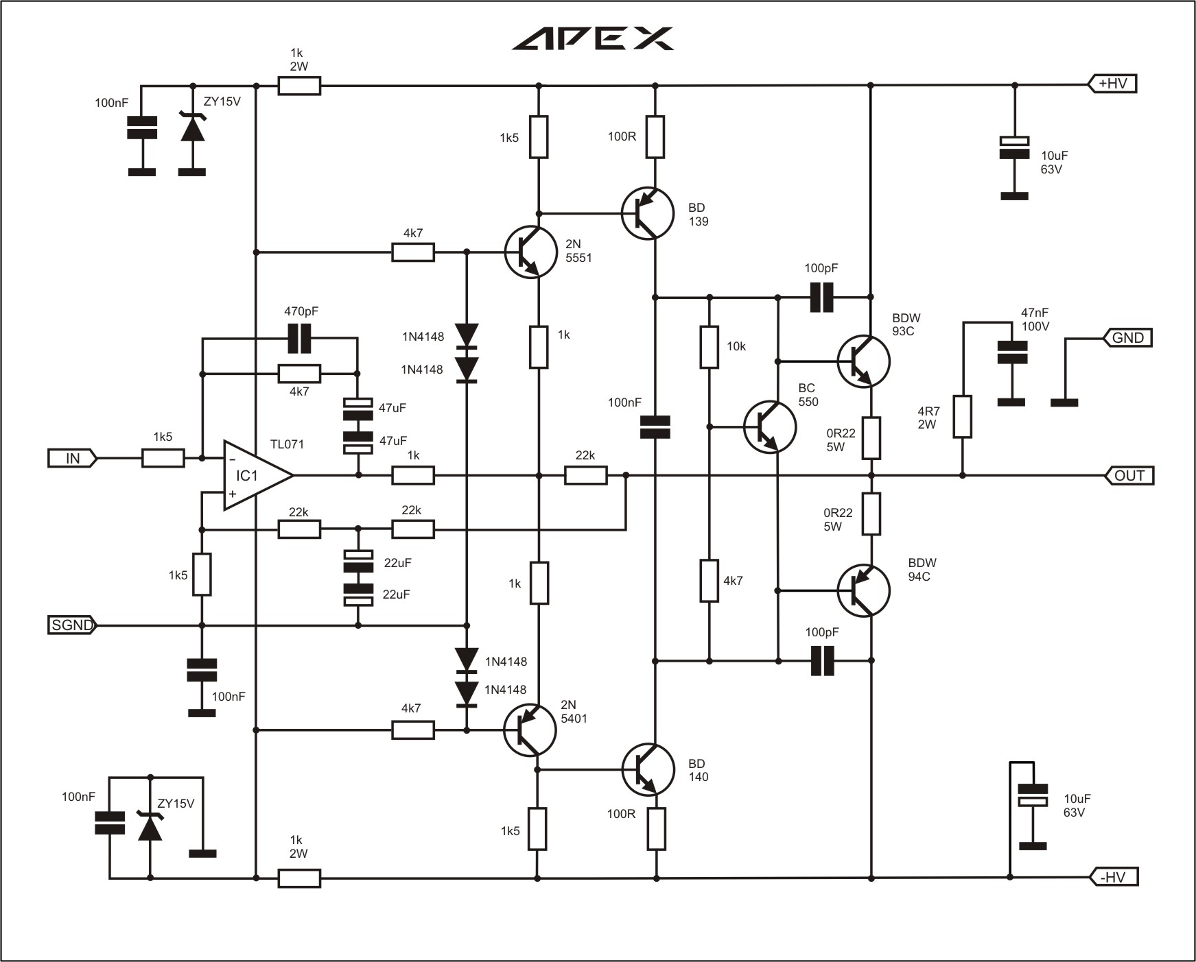

B500 with single pair of outputs can be use as Hi-Fi amplifier. Basicly B500 is symetrical descrite amplifier with common base input stage. OP amp is for DC servo and AC input buffer for low impedance emiter amp input.
