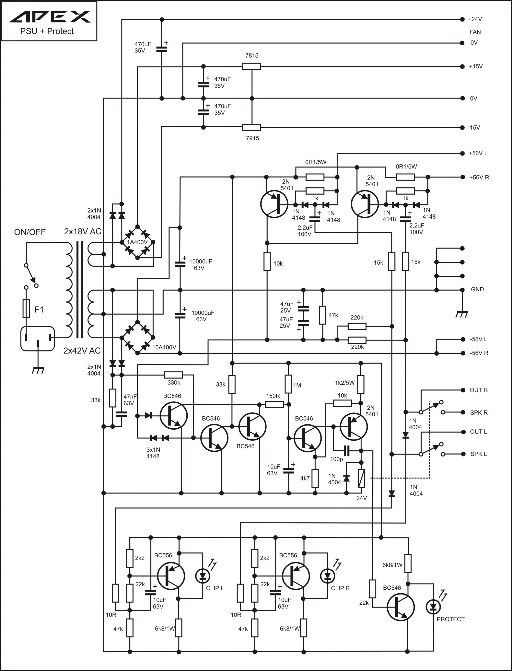

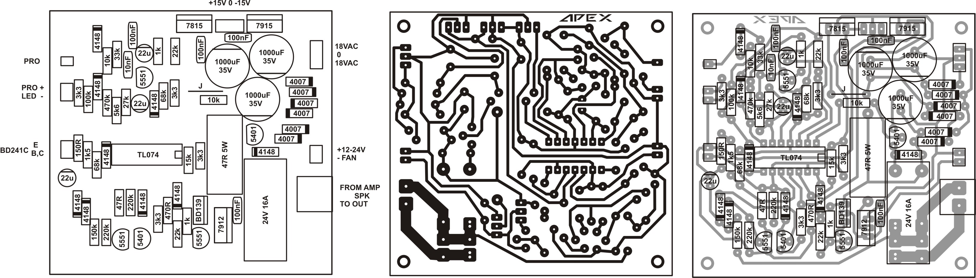

Clip Indicator
Clip indicator circuit indicate when amplifier output is about 6V to rail. Some amplifier can give that high output, in this case 2k2 can be replaced with 1k5, clip indicate when output is about 9V to rail.

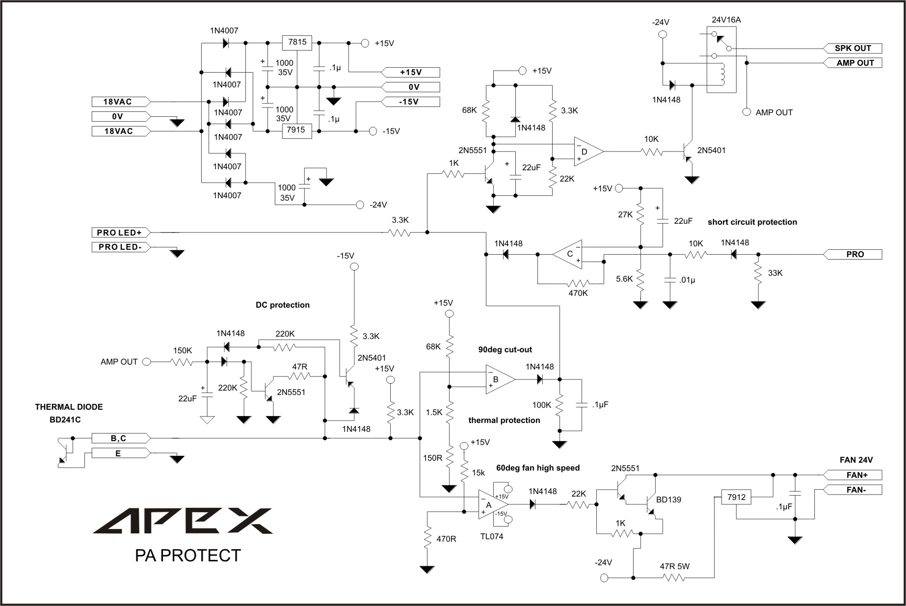

Short Circuit Protect
Nobody like VI limiter in audio amplifier and possible distortion, but overcurrent can demage output. In PA short circuit on output for long time can damage amplifier with VI limiter also. This PSU have short circuit protect, and can help with experimenting amplifier. Schematics for short circuit protect can be implement in any DC protection.
Short circuit protect will be activate in case shorting output terminals even when amplifier operate with few wats, no need 6A to activate at first.

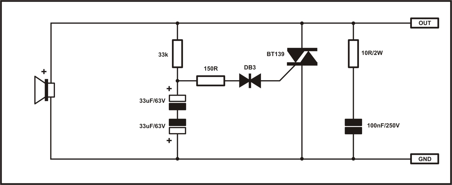

Triac DC Protect
This DC ptotect can be use if rail voltage is over +/-40V DC, and if there is fuses in rails or amplifier output. If on amp out exist over +/-35V DC, triac short circuit speaker output.

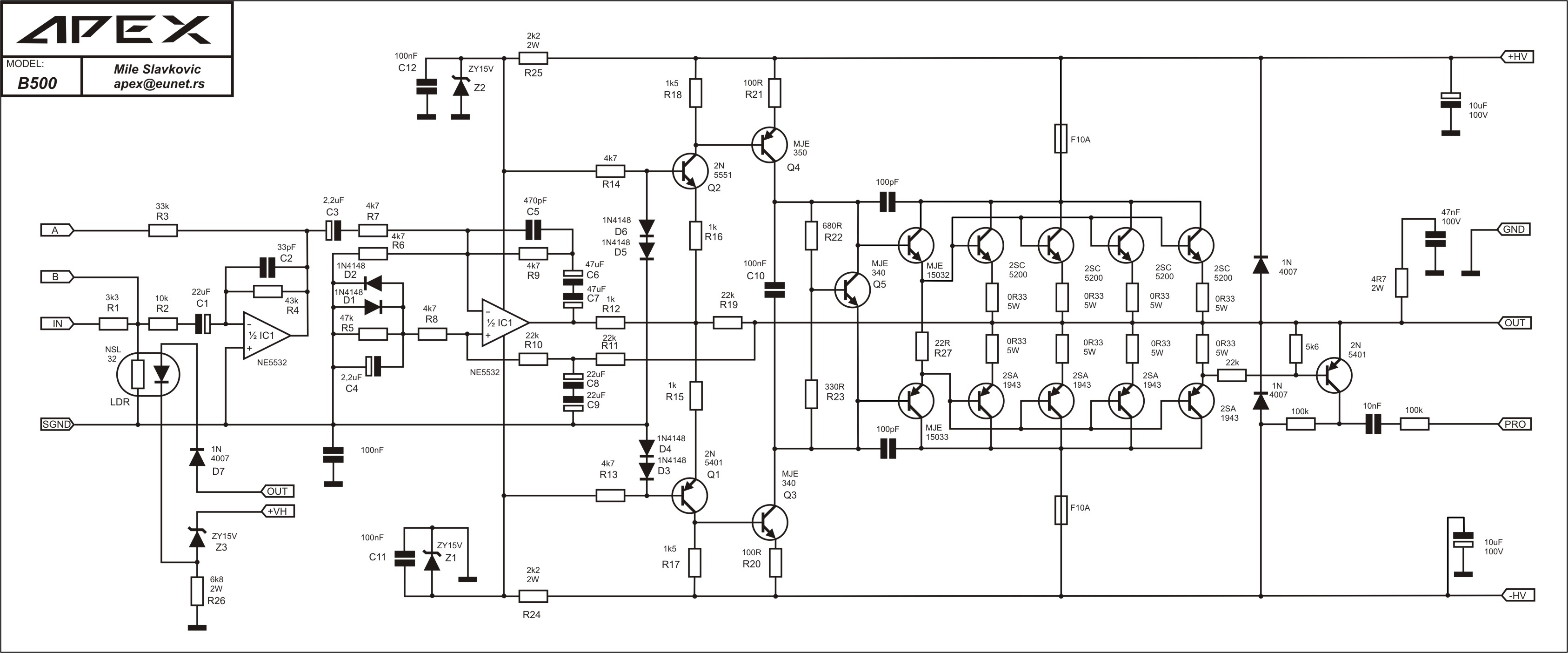

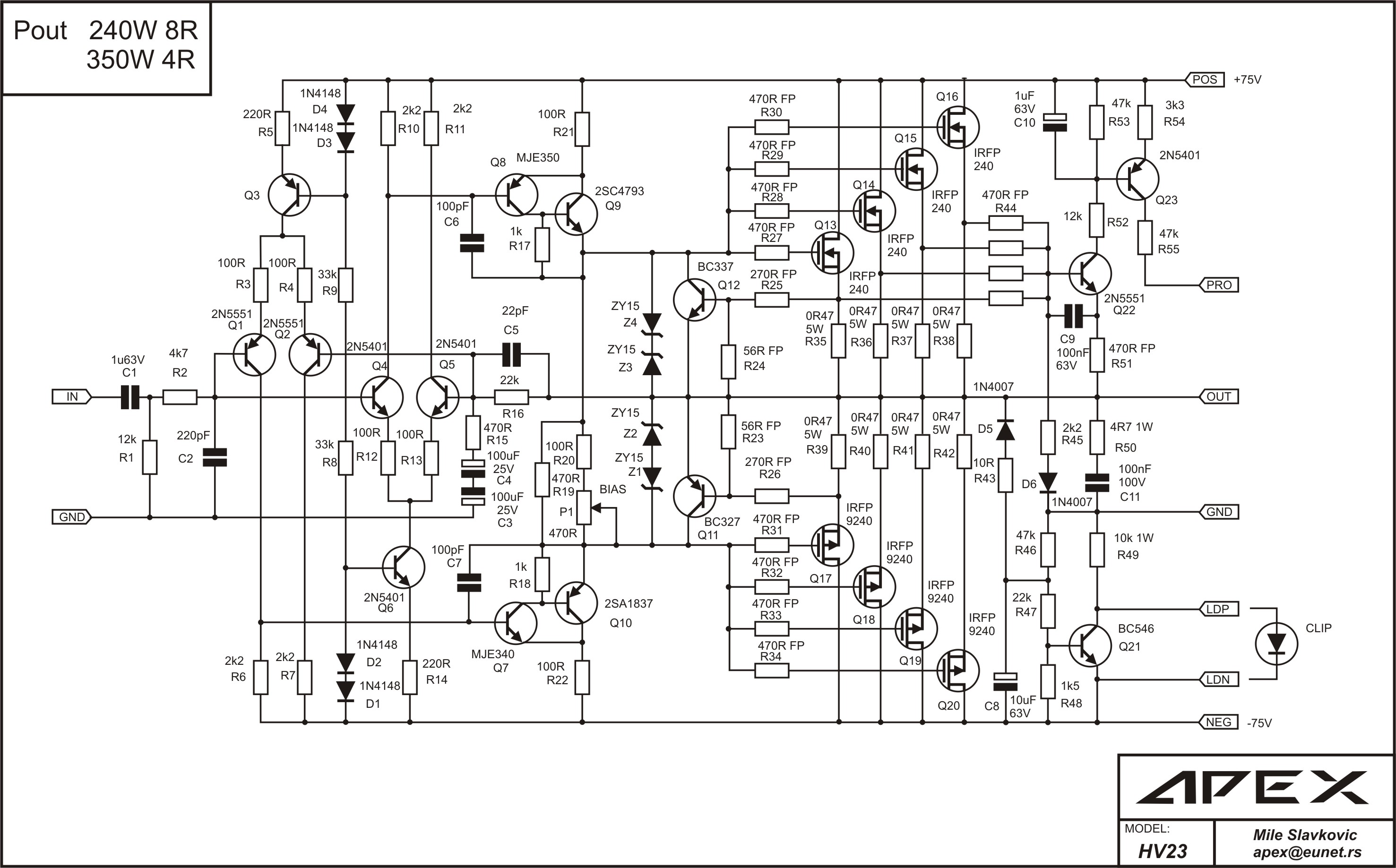

where does the PRO pin connects to??
PRO pin must be connect to over-curent detector on amplifier circuit. Protect will be activeted with positive DC voltage (mosfet amp hv23), or ac voltage (PA amp B500). Unfortunaly this Hi-Fi amp have not over-curent detector circuit, and it must be add if you want use this pa protect with short-circuit protect. PA protect can work witout short-circuit protect, just not use PRO pin. Protect which I suggest early in this thread have short-circuit protect without over-curent detector on amplifier circuit. If you have no expirience to add over-curent detector circuit on this amp, is better to use this circuit.
Regards
