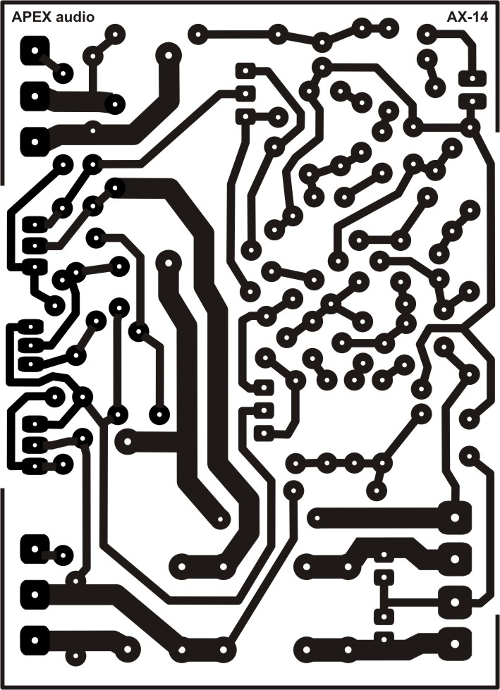

Pcb ax-14
PCB size: 60x82,5mm
Zobel Network 4R7 and 100nF on speaker terminal.

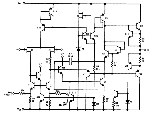

I use a greatly simplified version of this amp ah-la LF351...
This amplifier is completely different to the LF351.
Below is the LF351 schematic from National's datasheet.
Perhaps if you actually looked at a design before commenting on it, your comments would make more sense.

LF351 has FET however BJT may be used. This is very similar. The same general concept except much simpler.
Godfrey obviously knows the difference between the functional schematic of the design concept for the IC and the actual schematic as put on the die inside an IC, or maybe not.
The only company I ever heard of that built the schematic as found inside an IC was Analog Engineering in Kentucky or Tennessee.

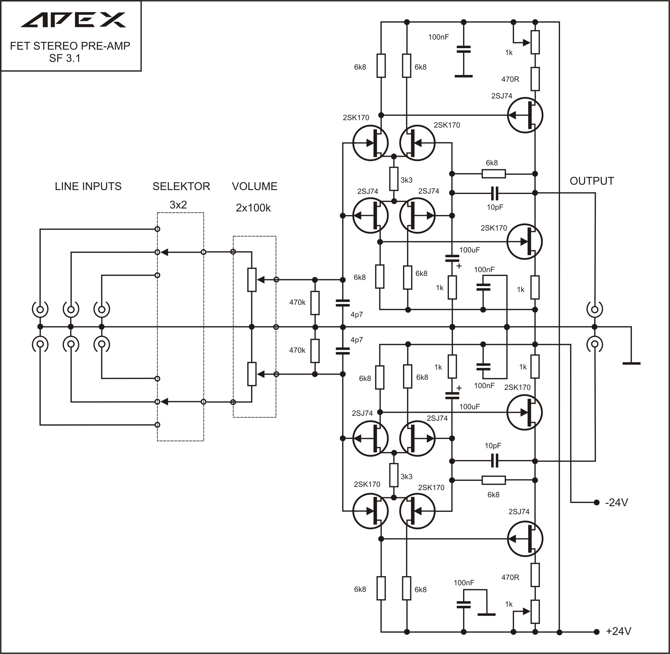

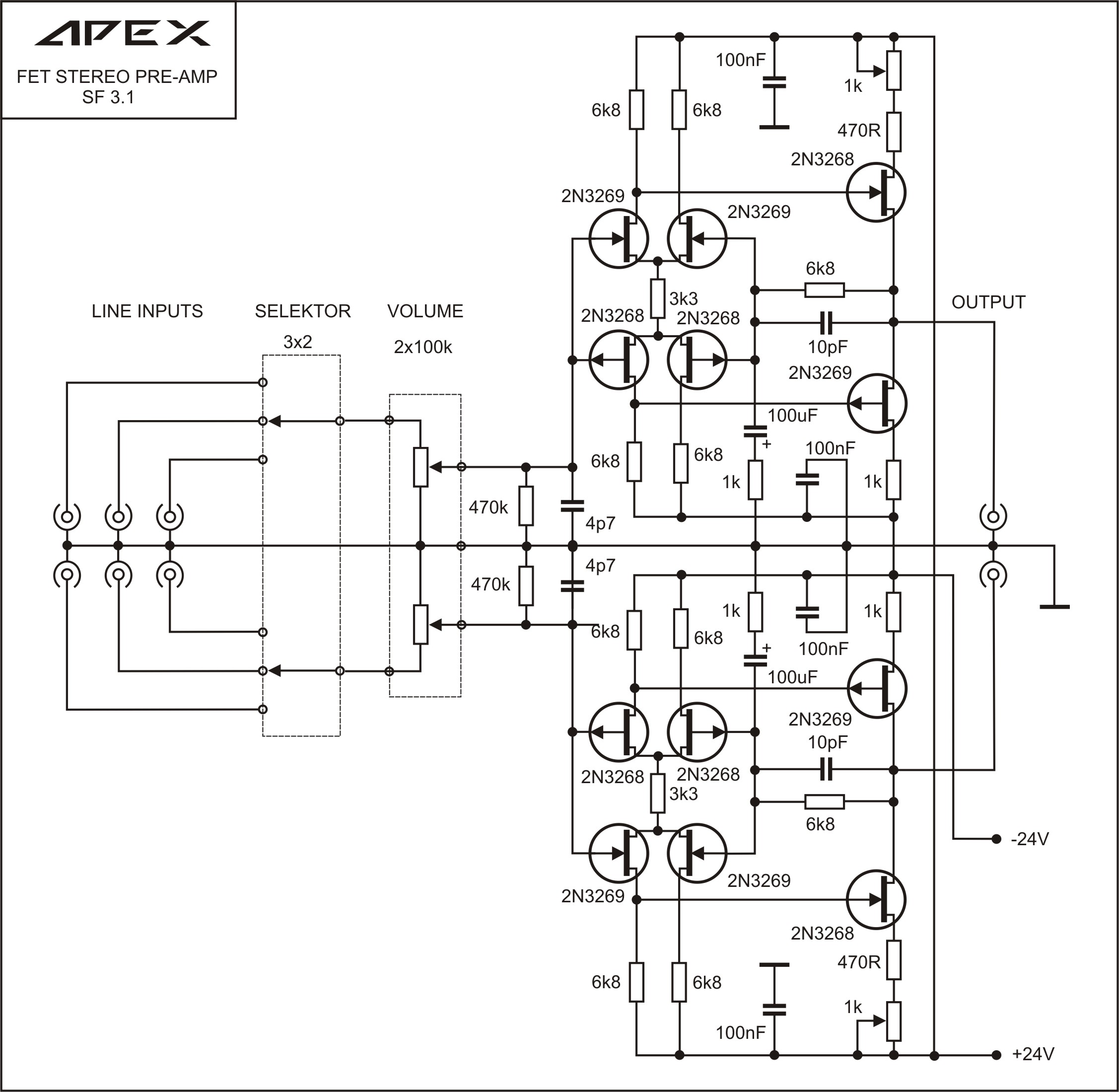

Preamp circuit SB3.1 is simplified version of my preamp from 1990.
