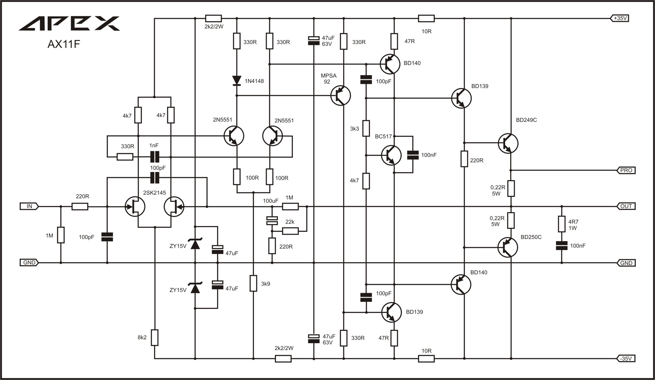

Thanks, its understood. without reading the datasheet, i would not think of populating especially when replacements are concerned.
i still like to know whether i can use
1. Q1/Q3 2N5551
2. Q5/Q6 2N5401/2N551 with resistor R12/R16 increased.
3. Q8 and Q9- MJE 15030/31 with small to-220 PCB mount heat sink
Dual FET input... no need preamp.
You can use MJE15032/33.
For VAS transistor you can use higher power dissipation than 2N5401/2N5551 but with same or lower Cob. Higher Cob may be need to adjust capacitor compensation's value.
Thank you Bimo,
I will order what I do not have (KSA1381, KSC3503) and then start building.
One more thing, is there any particular reason why you have used 1/2 W resistors in places of R20/21, R19, R17/18, R9 ?
I looked at the sim, the dissipation is quite less in those resistors, to minimize temperature effect?
reg
Prasi
I would always try to achieve a target dissipation of less than 50% of the resistor max rating.
In sensitive areas, like the NFB loop I aim for much less, usually <10% of max rating.
And also try to avoid excessive voltage effects: two 10k in series is better than two 40k in parallel.
In that case I think 1/4 w will be more than sufficient, as max dissipation in R19 is abt 8mW. R17/18 about 6mW. rest of the resistors have dissipation in uW's range. Unless ofcourse I am reading wrongly in the LTSpice.
