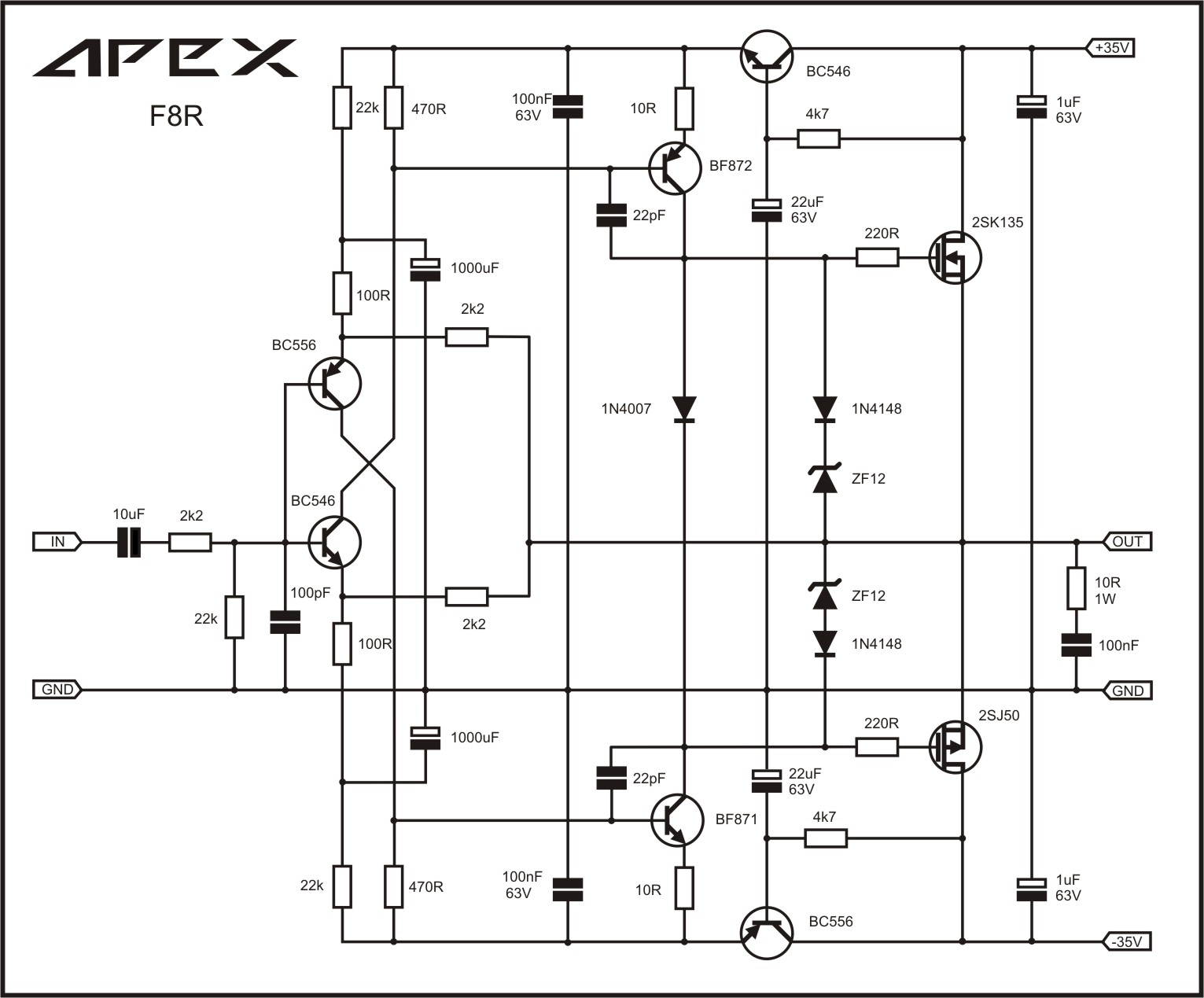

Small modifications... just to put the big input capacitor and those of 100uF/100nF in supply rails.

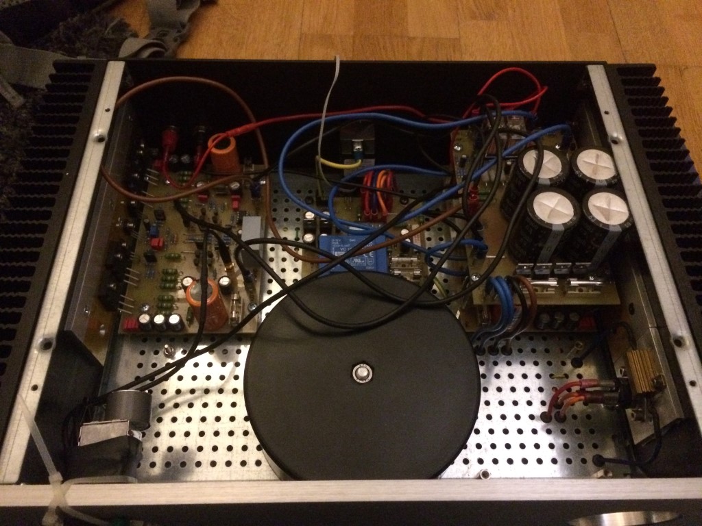

Hey Folks,
as a beginner with first audio experiences i still need some help with my Apex A23 Project. After a complete assembly of two A23 Boards (see Post #6069) with one FX100 PSU using 2x20.000uF (Post #6844) I still have some issues with hum noise even with shorted inputs directly on the amplifier boards. Increasing power supply capacitance does not help, so i think that insufficient PSRR is not a problem. Grounding is absolutely star. The torodial transformer has a shield winding, wich is connected to earth. Can you make any suggestions how to further localize the problem?

the transformer screen should be connected to Chassis.
The inputs (both of them for each channel) and the outputs (both of them for each channel) should not be connected to chassis.
Does the amp PCB include a connection from Signal Return to Speaker Return?
All the ground symbols (except 2) are the same. The two exceptions are GND1 and GND2.
Does the PCB actually connect all those gnds together?
Does the PCB connections share trace routes between various front end returns paths with Power ground and speaker returns?

Hey AndrewT, thanks for your help!
Transformer screen is connected to mains earth and chassis. At the moment it's isolated from transformers secondary DC ground. Amplifier inputs and outputs are also isolated from chassis/earth. The ground speaker return is directly connected to the star ground between the dc supply capacitors. At the amplifier PCB only one ground connection is used (also connected to star ground).
