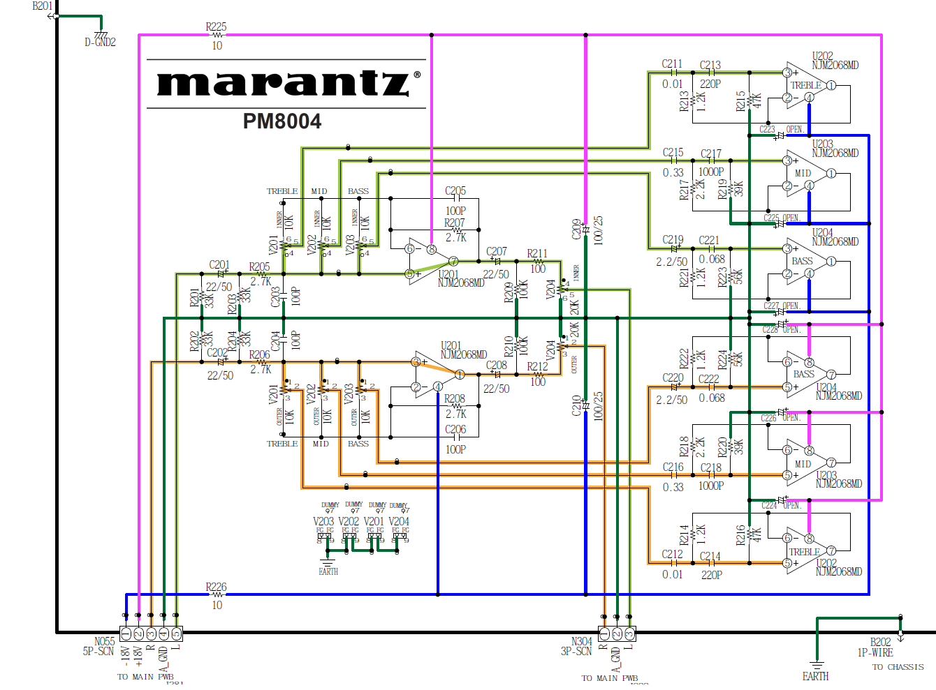

I am not at my computer but if you look back in this thread, I posted the pdfs for the TB3. It includes a couple jumpers on the balance pot that I found to be necessary for proper function.

TB3 schematic with add jumpers on balance pot.
nice sch, but doesnt have the typical APEX looks to it.
Hello Sir Apex, I am going to do the TB3 build just curious about the frequency response of the ckt in lows and highs. So can you please tell me that thanku.
TB3 use graphic equaliser circuit, you can change frequency response if you want.
It have marantz look, basicly it is qraphic equaliser.
