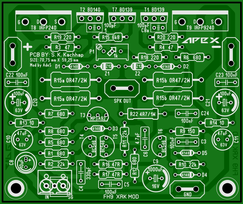

"BOM" of FH9
I'm building and I have this list:

Nice, thanks for doing this. Looks good.
This amp will not disappoint - it sounds great and has amazing bass extension. 🙂
Good luck on the build!
I would add that for FH9HV (120w into 8R with +/-52vdc rails) make the following changes:
47uF C10 --> 47uF 63v
47uF C11 --> 47uF 63v
BD139 T1 --> KSC3503
BD140 T2 --> KSA1381
BD139 T7 --> KSC3503
Try to match Hfe on T4 and T5 and DC offset should be under 5mV, typically 1-3mV.
Make sure all 4.7pF (C6), 100pF (C4a, C8a), and 330pF (C4) ceramic caps can handle 100v, preferably C0G/NP0 or 100v film caps
All 100nF caps should be rated 100v and are preferably film caps.
Note that FH9HV will work fine at +/-35v rails as well and gives flexibility to run any voltage in between.

Where did you get the image with part designators (R1, C1, etc)? The one I have just has the values (and still has older 20k and 550R values vs 22k and 680R).
Edit - I see the "mod by AdeS" - you made it - thanks.

T7 can stay as BD139 as it is the Vbe multiplier transistor. Putting here KSC3503 is waste....

Hello AdeS!
A BoM can be very helpful for people like me (not new in building amplifiers but over many years out of business). Recommended by xrk971 I focus on FH9HV which fits well to my existing PSU. Could u please publish her your Gerber/sprint files?
Do u have your BoM in Excel? Even a conversion from another format wouldn't be a problem. So if u could it post too, would be great.
@xrk971 many hours reading posts even didn't make me sure: but V1.05 should be the last version? I could only find gerber files but no sprint file for this! In case AdeS hasn't sprint file, could you provide the V1.05 sprint file?
Many thanks in advance!
Erwin

Eaglemaster,
I used Gerber v1.05 from this post:
http://www.diyaudio.com/forums/soli...imate-fidelity-amplifier-746.html#post4718422
It's not labeled with part numbers but only values. Not hard to figure out though. I don't make Gerbers so you will have to ask Sonal Kunal to update the file or ask AdeS for his/her Gerber file.
Good luck with the build!
Tips: stuff and solder all small resistors and diodes first, then small caps, then small transistors, then spade connectors pots and terminal blocks. Then big caps, then output MOSFET and driver VAS.
Set pot to about 400ohm for initial startup. Use a 10w 10R power resistor in series with rail supply lines and clip DMM across 10ohm and monitor as you switch on. If volts across 10R < 2 to 3v you are ok and adjust trim pot to get about 1.75v. If large voltage like 12v to 25v, shutoff immediately and find problem.
If all good remove 10R safety resistors and reconnect directly. Monitor voltage across dual 0.47R power resistors near output. Adjust trimpot for about 41mV to get 175mA.
Check DC offset with input grounded. Should be about 1mV to 5mV if the input LTPs were matched for Hfe.

Hello xrk971!
Many thanks for your link and the tips!
I indeed got the gerber files of V1.05 already. What I still would like to have is the sprint file for this. As far as I got it, you have only sprint file of V1.04. The only difference should be the 100 pF caps Mile suggested and, if I include the post of AdeS, the partnumbers. Ofc it is no rocket science to add it, butI guess AdeS has it already.
so @AdeS
If u have it could u please post it? About BoM: you didn't reply! It is the same here: is no rocket science to convert the data from u post to a excel file, but I guess you have it already?
In case AdeS has it not:
@ sonal kunal
at least you have the sprint file of V1.05 Would you please post it?
Maybe some of you may wonder my requests for sprint files: I might have to modify the position of fixing holes slightly due to my given mechanical layout.
