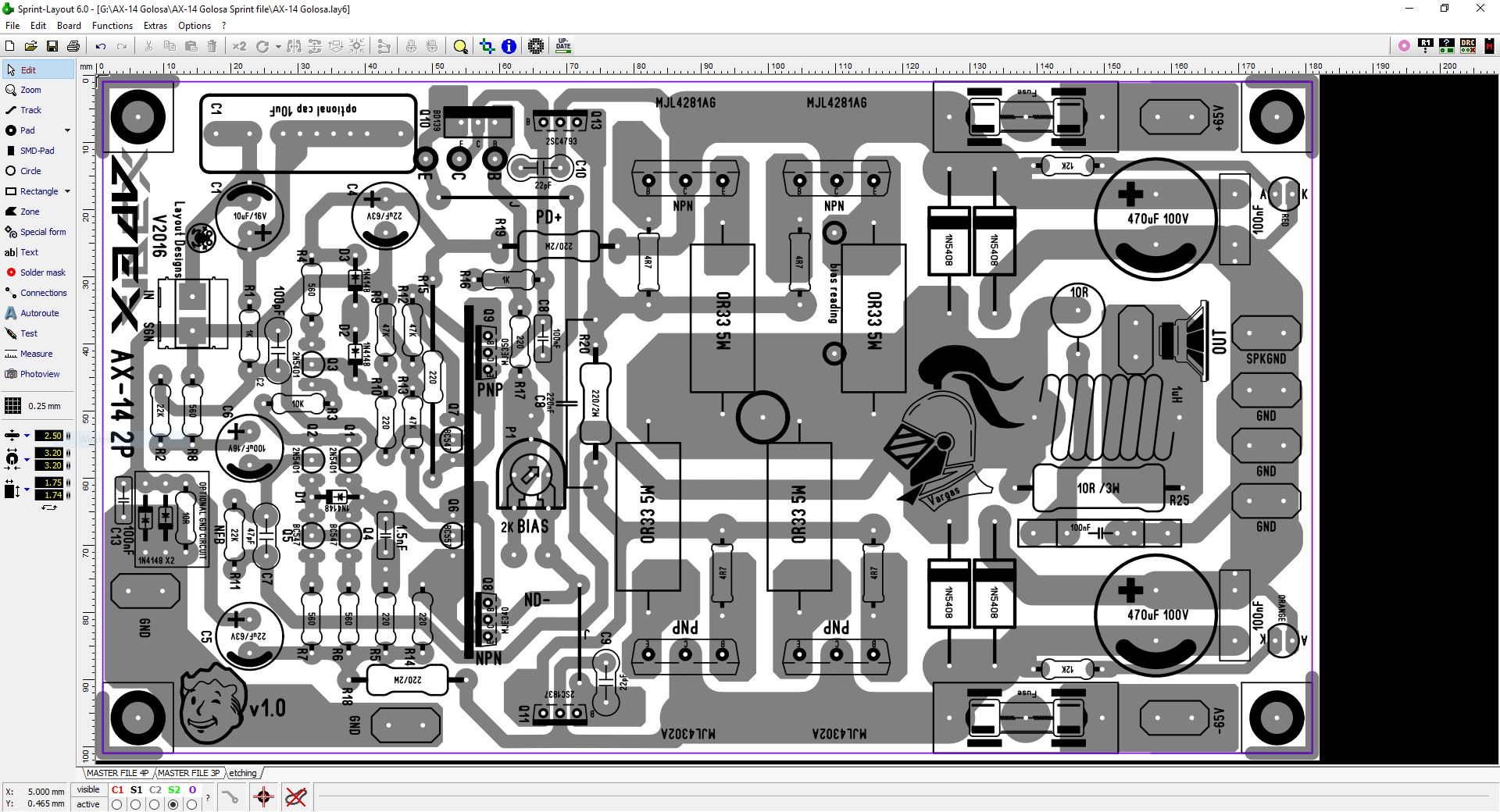

Sizing posts are odd.
The Sprint pic in post7727 shows the purple/violet out-line from:
01mm to 181mm giving a length of 180mm
and 01mm to 101mm giving a width of 100mm.
That 180 by 100 agrees with the size stated in the same post.
Why is a pdf giving a bigger size?
Why is Still4 seeing a different size using the same "Sprint" software?
The Sprint file shows the board to be 208mm x 100mm.

Sprint file juan shared has 3 output pair.
I use both cute pdf writer or foxit reader, cute writer make smaller pdf file size than foxit.

I'm sorry. I didn't notice there were three tabs in the Sprint file. The 2p layout is indeed 180mm x 100mm. The 3p is 201mm x 100mm and the 4p is 224mm x 100mm.
