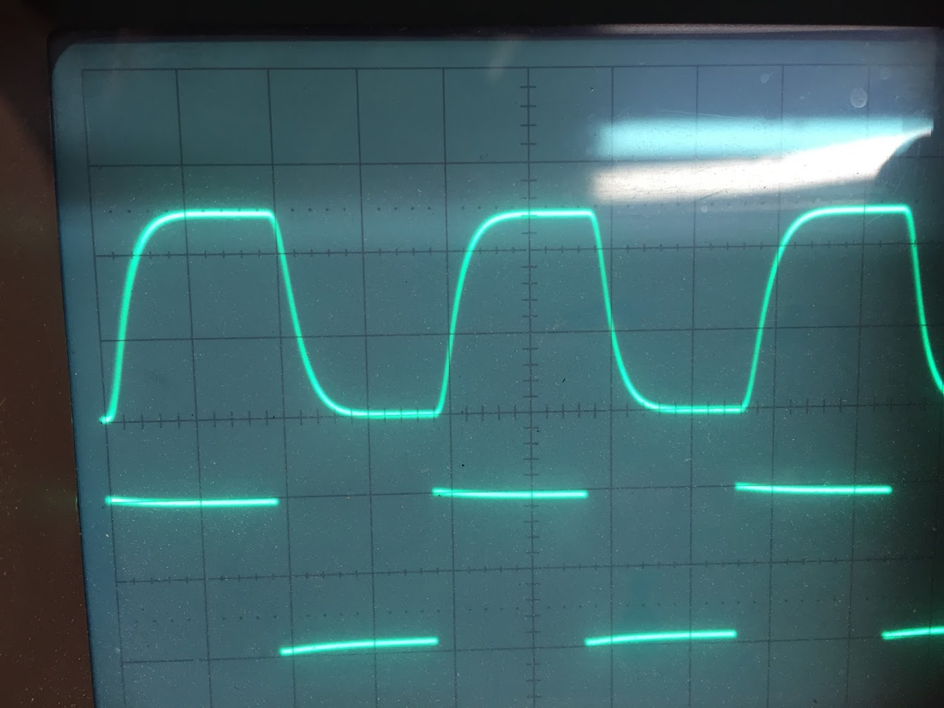

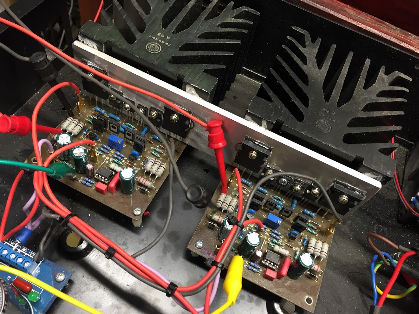

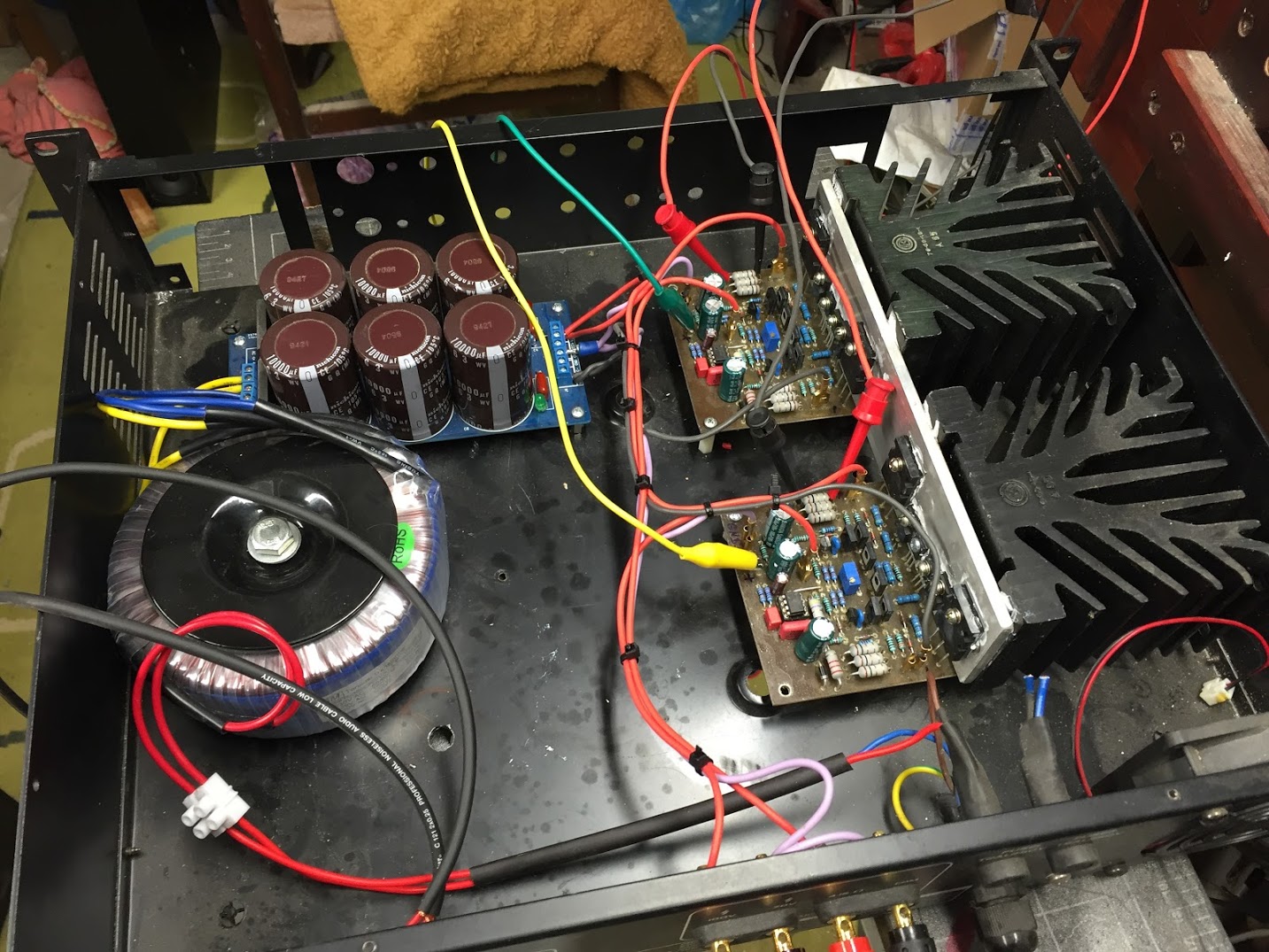

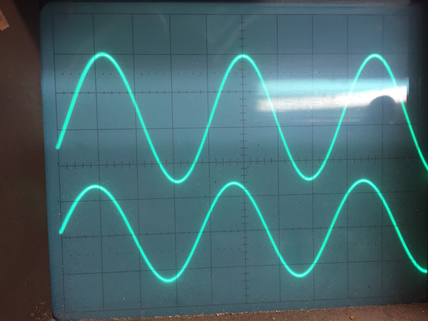

after very long time I had chance return to my projects... 🙂 lot of amps without chassis need to be completed... so I started with this lovely amp...
sq and sin at 50Khz

Nice work, A14 is one of the best amp.

I agree....

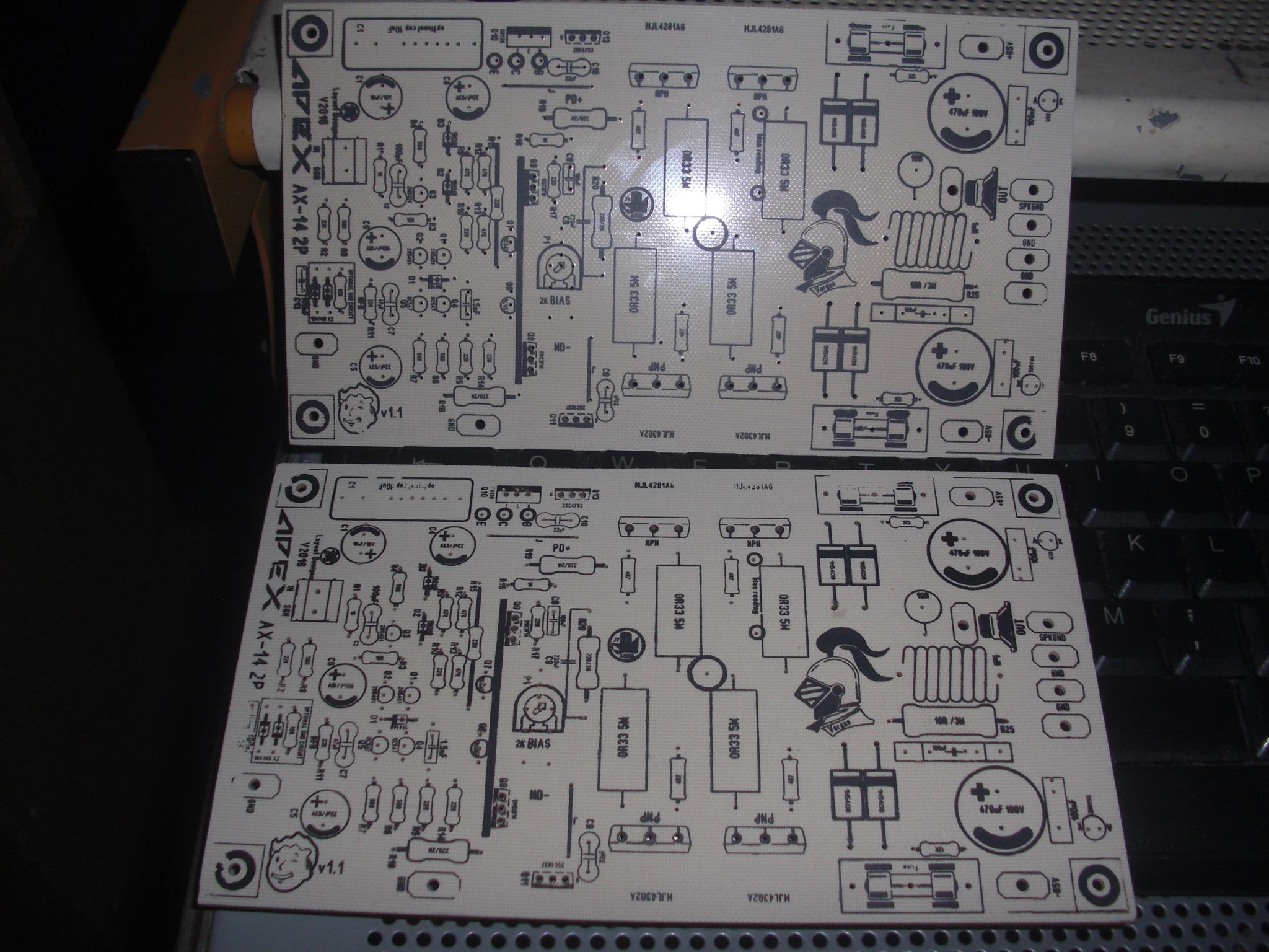

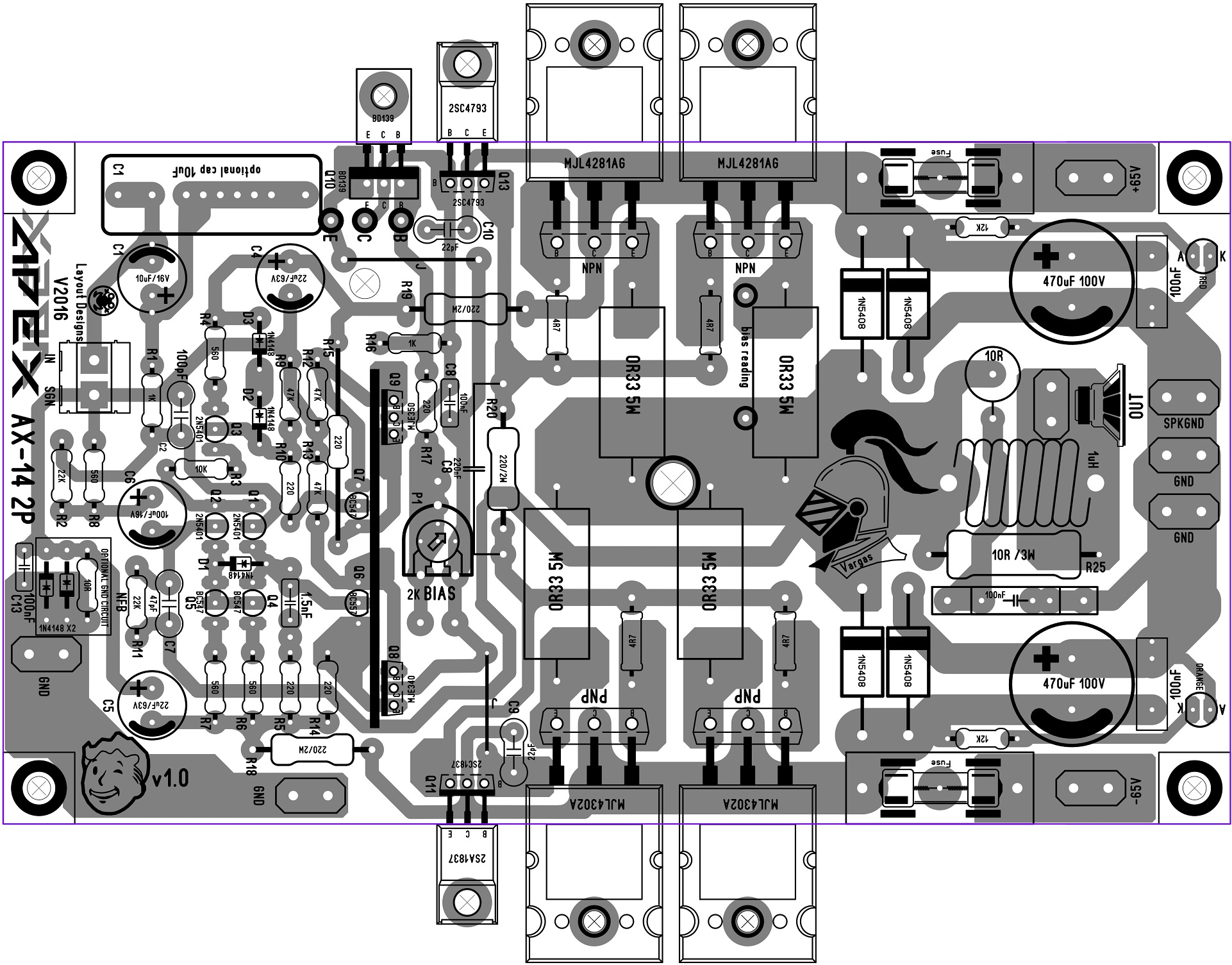

a friend from Venezuela is gonna try my PCB design of the AX-14 the difference is that it will have 2 pairs and a output coil I hope all goes smoothly for him because is difficult to get parts in Venezuela I hope all goes well fro him 🙂

Dear Vargas,
Kindly post the exact Schematic also which the PCB layout refers to. Thanking you,

even better guys I will share Sprint file too I have a little problem exporting to PDF files I notice is not an accurate size so I have the increase the size of the exporting PDF to 110% instead of 1:1 and this is why I leave Sprint file so you guys can just print the art work directly to the printer from the software 🙂 too, also multisim file
don't mind about the name "Golosa" I just need to separate the version 😛 still AX-14 same just with an additional pair 🙂 feel free to modified I don't mind at all 😉

Great stuff - thanks! I just linked this post to the Apex directory thread post 1.

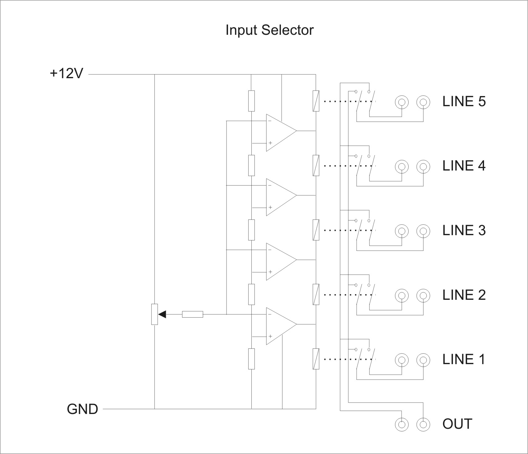

Input selector with pot...
Very nice! Seems modifiable into a volume control (one relay for each volume setting)...
Yes, Ultimate Stereo Volume Control can be made with standard single linear pot.

Mr. Mile,
I am interested in this as a i/p selector. Can you give me the values/part nos. for each components? It can be made in a small PCB form to be mounted on front panel for i/p selection.
also sch for volume control would be nice too.
