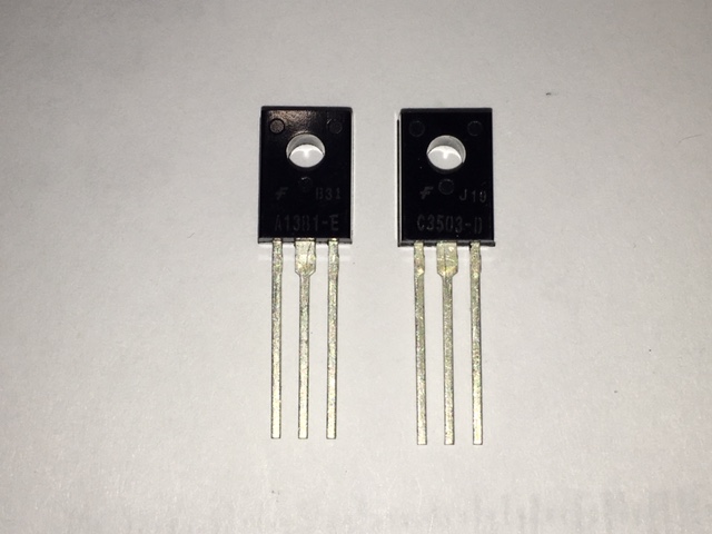

The KSC3503 are D-grades where the KSA1381 are E-grades. Using transistors with such different Hfe ratings may cause problems.
Personally, I would rather use the same grade for both.
I don't know for sure it will cause problems, but I brought this point up a while back in this thread.
The fact remains that the A1381 and C3503 are hard to source unless you use the mismatched KSC replacements. I see a few original Sanyo devices on eBay that appear authentic, but I'm not going to pay the ridiculous price they want for them.
Perhaps Bimo or Mr. Mile can recommend suitable substitutions.
If VAS transistor not match on hFE in this design, H2 will be increase, may be DC Offset, too. But I think it is OK.
A1381 and C3503 can substitute with another low Cob transistor like A1360 and C3423. If it substitute with higher Cob, phase margin and gain margin will be reduce and it may need change the value of compensation's capacitors. Slew rate will be decrease and THD at high frequency will be increase.
The KSC3503D has Hfe range of 60-120 and the KSA1381E has Hfe range of 100-200, so there is a chance of finding reasonably matching devices in the overlap around 100-120 Hfe.
I guess if I am feeling lucky I could order some 2sc3503 /KSC3503 off aliexpress and see if I can get some in the 100-200 range and then order the KSA1381E from digikey to try to match that way.
From what Bimo says, we just need to get reasonable matching in the VAS and we are ok.

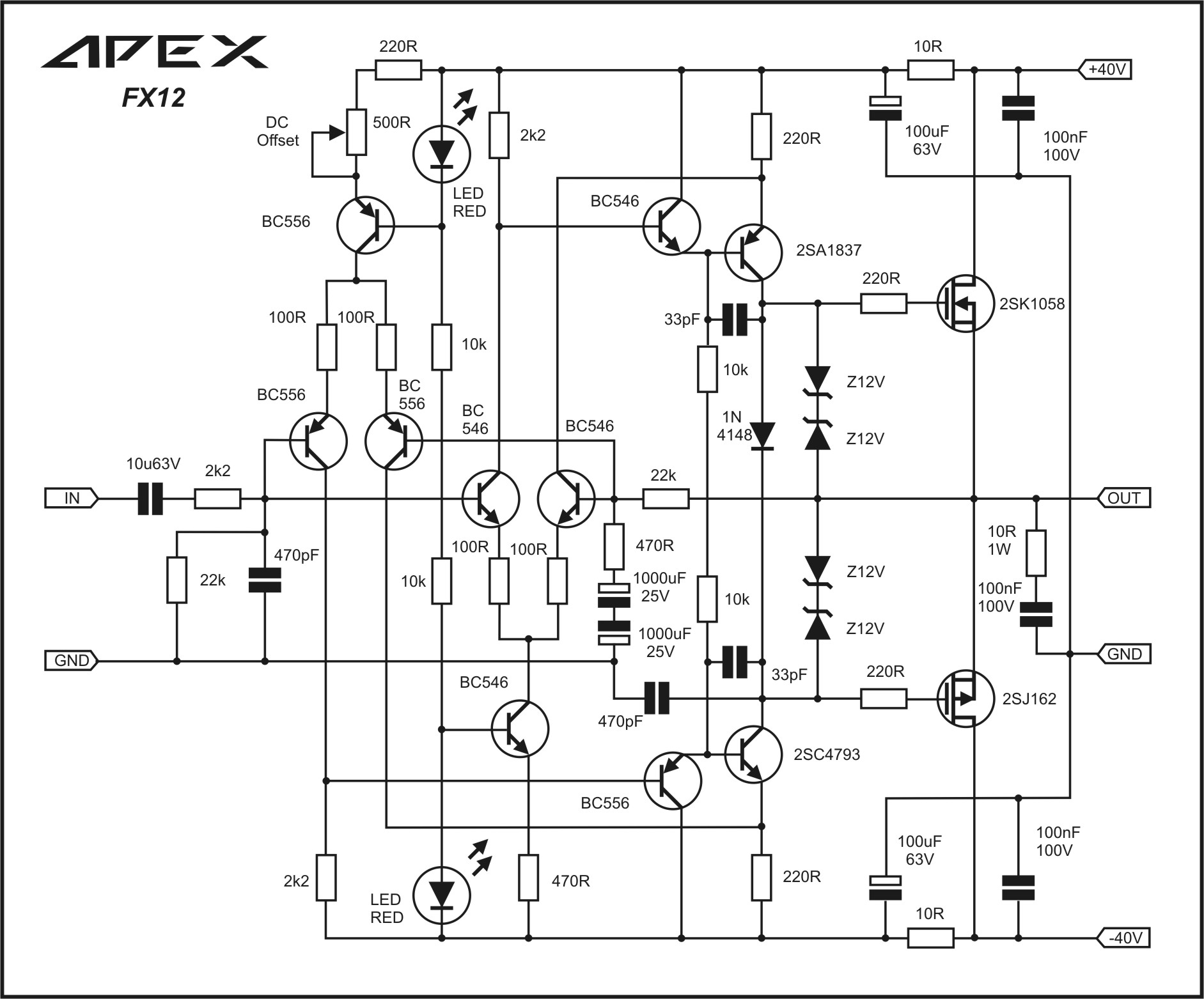

The input LTPs are massively unbalanced.That 38V does not belong there. It is misplaced. I understand the confusion now. Here is a corrected version
1.60mA/133mA = 120%
1.80mA/123mA = 146%.
You have to get these much closer to 100%
D.Self says better than 102%
But that is almost certainly not why you have the oscillation.
Try to find what is causing the overshoot after you fitted that 470pF slowing down capacitor.
Even if the Hfe is the same, two transistors with different Vaf will not behave as if "matched".
The KSA1381E has lower Vaf, but it also has higher Hfe. So it is actually better matched to the KSC3503D than if they had the same Hfe, if used in a symmetrical VAS.
Thank you keantoken!
I was also guessing that fairchild/digikey must know something if they only sell the KSA1381E & KSC3503D and expect them to work in symmetrical pairs. I will just start with this and not worry about extra matching.
http://www.diyaudio.com/forums/atta...w-ultimate-fidelity-amplifier-apex-fx12dc.jpgTry with 470pF instead 100pF...
Here incorrectly includes capacitors 33 pF - to the emitters, at a low impedance point, and need - to bases. 470 pF must be connected in parallel with the 22 kilo Ohm, and its capacity reduced to units or tens of pF.
Check this circuitry and compensation in SIM, otherwise you can burn the transistors.

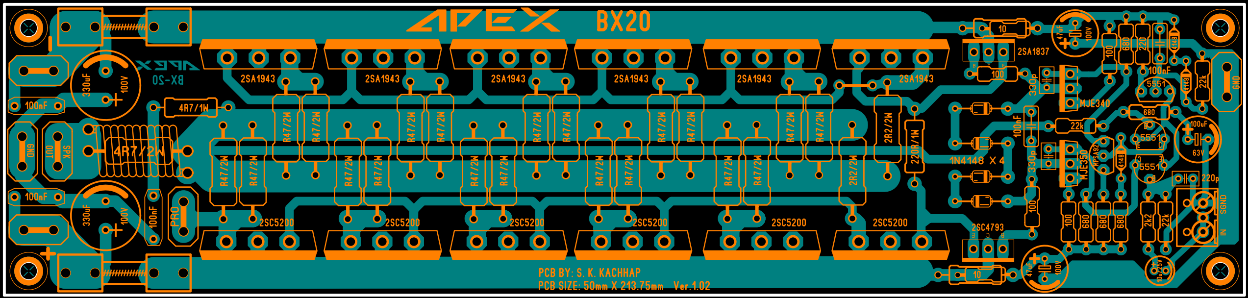

incredible, the BX20 looks easy to build and to customize! I really like the simetrical output design!
How is the sound of this amp?
And can someone point me to the right post/doc about how calculate the amount of 2sc5200 / 2sa1943 i need for diferents outputs?
xrk971 point me to this thread and are really amazing!
Post 6761. Sonal Kunal did a beautiful layout:
well done,xrk971, I have a directory devoted to the Apex designs, incomplete I may add.
