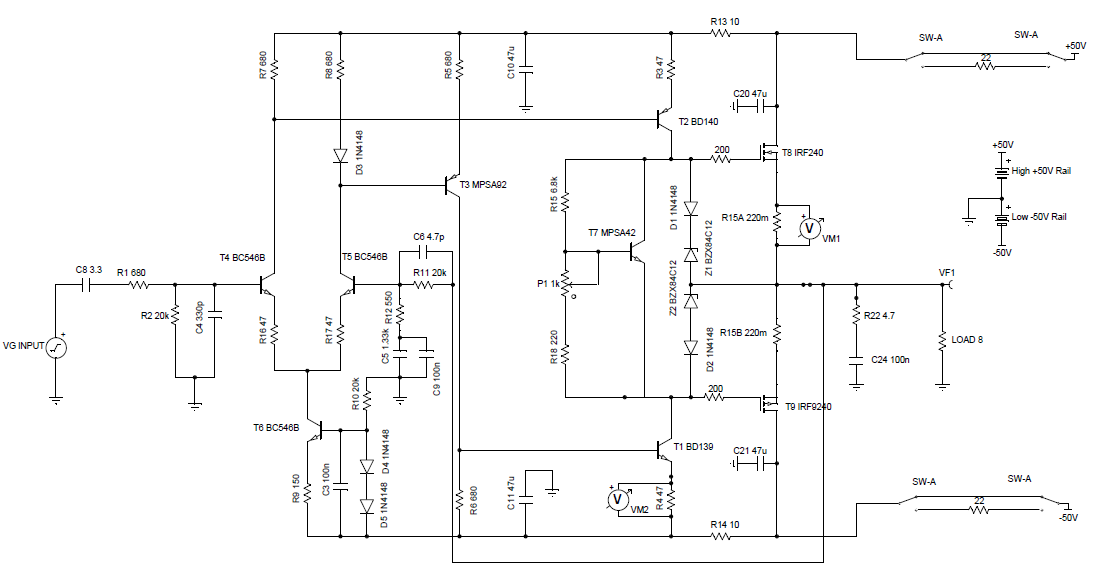

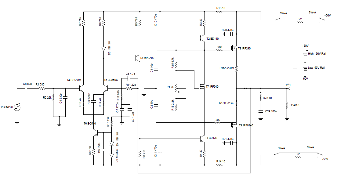

If I simply install hexFETs as shown in circuit - would it work per the simulation but with potential for thermal runaway if Vbe multiplier is not used? If I keep current below the 10amps (or whatever spec is) would t be ok?
HexFETs are on order.
It won't work without proper VBE multiplier. Your HEXFETS will self destruct.
If you want a simple amplifier with HEXFETS, you should try Apex A9 amplifier - it consists of just 9 active devices and an opamp.

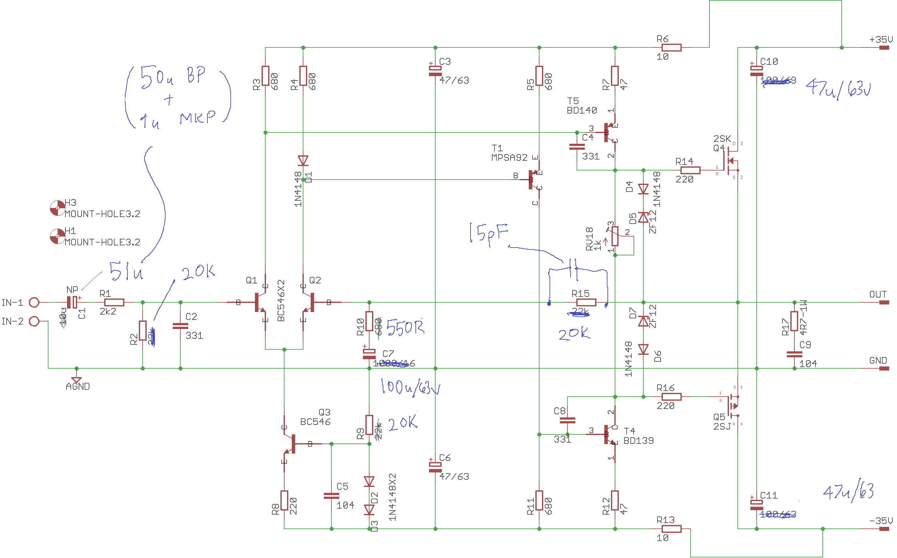

Here is the reference schematic on which my build is based and also sonal's layout. you could mark up your changes in paint.
reg
prasi
Prasi,
Here is my circuit as built. Thanks for providing the drawing.

Somethig like this. Not tested, not simulated.

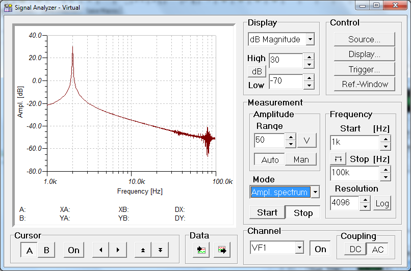

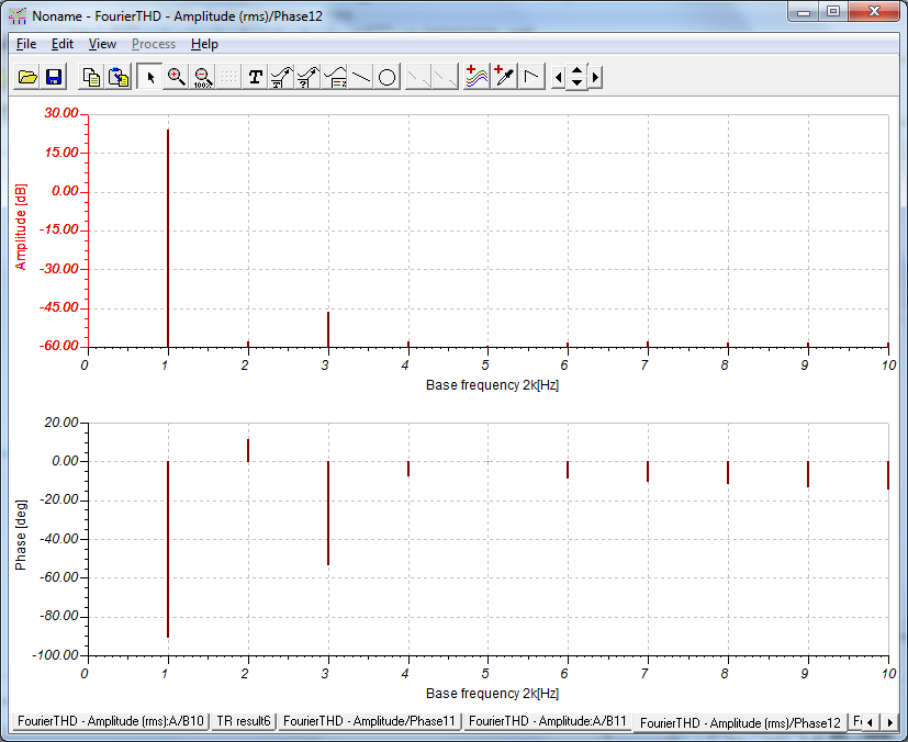

Ok, I simulated this Vbe multiplier circuit and it seems to be ok still. I think HD components went up a bit but still -55dB down at full power.
Here is circuit simulated in TINA (I set the resistor split at Vbe a little differennt, and pot wiper is set at 80%).
I think this might be implemented with flying leads on Vbe multiplier clamped onto the output FET.

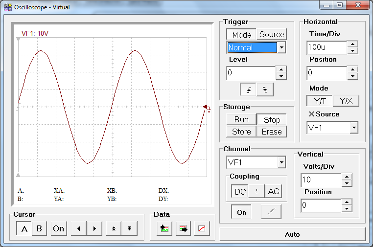

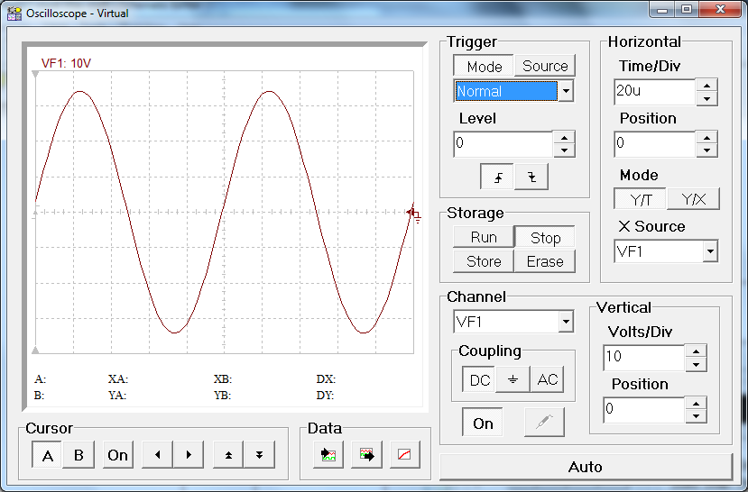

Here is predicted 10kHz sine wave:

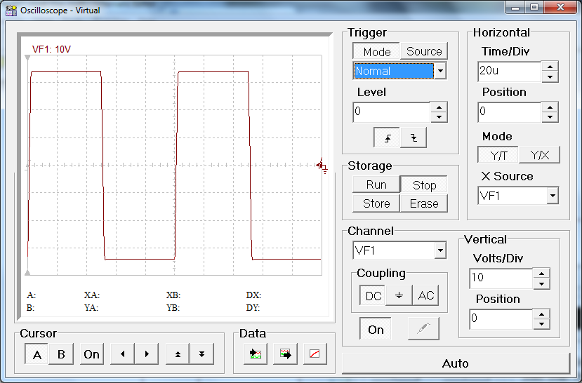

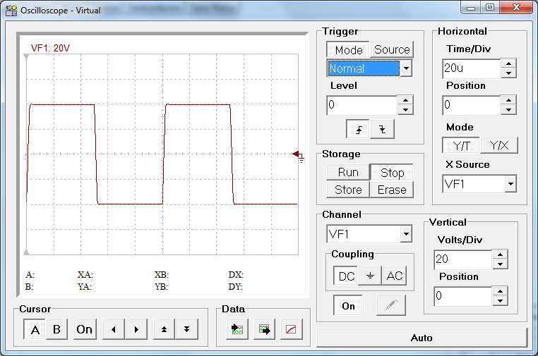

Here is predicted 10kHz square wave:

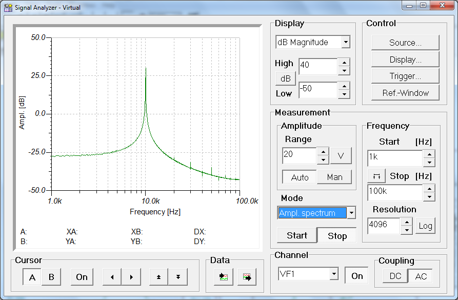

Here is predicted spectrum:

ONLY Lateral mosFETs work without a temperature compensator for the output bias current/voltage.If I simply install hexFETs as shown in circuit - would it work per the simulation but with potential for thermal runaway if Vbe multiplier is not used? If I keep current below the 10amps (or whatever spec is) would t be ok?
BJTs and Vertical mosFETs need a tempco to reduce the tendency for the output bias to wander, sometimes catastrophically.
C1 is far too big.Prasi,
X
Use it to set your low frequency band limit.
Typically somewhere between 1Hz and 20Hz.
For the 20k+2k2 your 5u1F gives an LF F-3dB = 0.14Hz
4u7F or 3u3F in MKT, or MKP, would do far better in controlling what audio signal gets through to be processed.
C7 is too small.
It should not have any significant DC voltage across it, nor should it have any significant AC voltage across it.
make C7>= C1*(R1+R2)*sqrt(2)/R10
If you make C1=4u7F, then C7>= 268uF, use 270uF, or 330uF, or 470uF, or even go back to the 1000uF originally shown.

Is the temperature compensation via T7(IRF540) shown above as suggested by Egra good? Is the idea to use a transistor with a similar temperature coefficient as the Vbe multiplier controlling the bias to servo the bias based on temperature? I guess I don't quite see how an increase in temperature on T7 causes the bias to change in a negative direction? Unless basically the Vbe multiplier in this case causes the voltages between the two driver stages to be lowered (because voltage between them is lowered by virtue of the variable "diode drop" across T7)?
irf540 is not good.
A small transistor that can respond to temperature changes very quickly is required.
That collosal FET will be very slow, if it can ever get near the output FET junction temperature (Tj), but it won't, ever.
I use a To92 next to the output devices, or a sot23 glued to the output's Collector/Drain right next to the plastic package.
irf540 is not good.

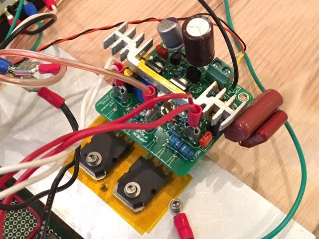

Ok, I made the input cap a 3.3uF+1.0uF=4.3uF MKT, C1 is now 1000uF/25v + 330uF/25v OSCON. I added a heatsink for the BD139/140's.
Listening to it now as I run sims of a modded hexFET FX8 with an MPSA42 (TO92) as the Vbe multiplier temp compensation. Sounds pretty good so far but need more time with more tracks.
Latest FX8 hexFET sim
This latest design seems to work ok but is not ideal. I am using an MPSA42 as the Vbe multiplier temperature compensation. To get low HD though, it needs to pretty much run in hot 'class A' mode with 2.9amps (yikes!) flowing through the hexFETS as measured across the 0.22R collector resistor.
Schematic:
The sims show that it is capable of driving 100w into 8ohms though. The plots below are for a 65w into 8ohms setting except square wave which is 100w.
Sine wave at 2kHz:
Square wave at 10kHz (100w I think):
Spectrum Analyzer for 2kHz at 65w:
FFT analysis for 2kHz at 65w:
