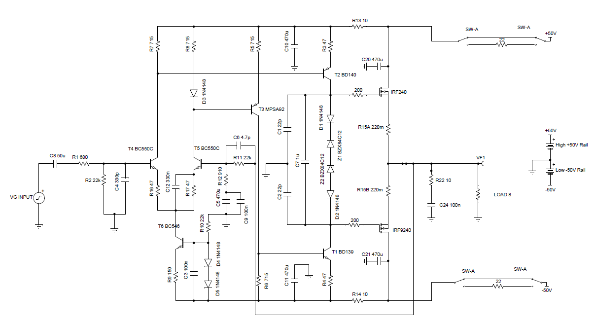

Thanks to egra for posting his TINA simulation. Once I had the sim, which has excellent performance btw, I had to answer a nagging question: what happens if you swap out the nice Hitachi's for some dirt cheap hex-FETs like the venerable IRFP240 and IRFP9240? I put those in and sure enough, the distortion above 3kHz started to degrade badly. I recall that often when IRFP's are used in Pass amps, there are some "emitter" (or shall I say drain/source) resistors. So I added a 0.22ohm resistor between the output pin and common point. This really cleaned up the distortion and this amp appears to make clean 20kHz squarewaves and have pretty low distortion - even when driven at high power. The hex-FETs can take higher current and voltage too so I boosted the rails to 50v. Assuming the other transistors and caps can all take it - does this make sense that it can work? Here is the schematic:

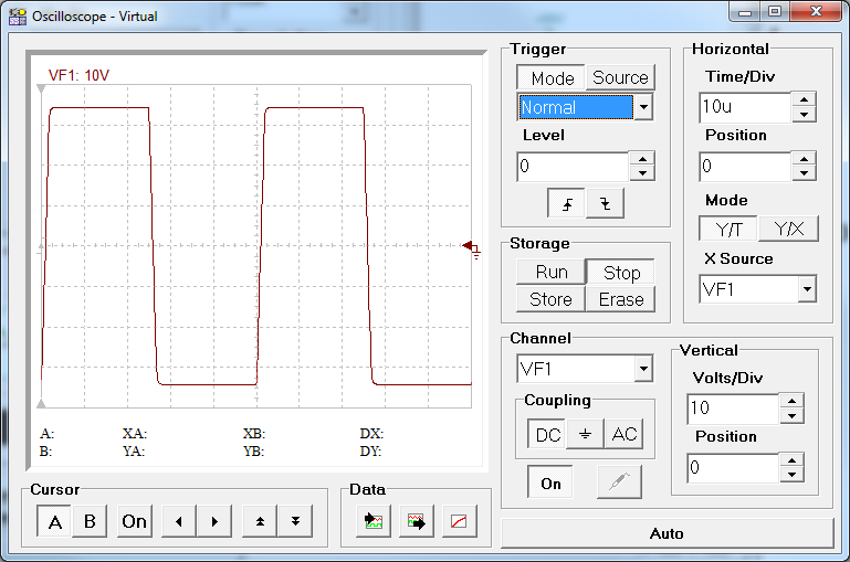

Here us the scope with square wave at 20kHz:

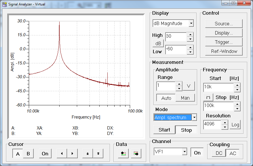

Here is the spectrum analyzer output for 20kHz excitation:

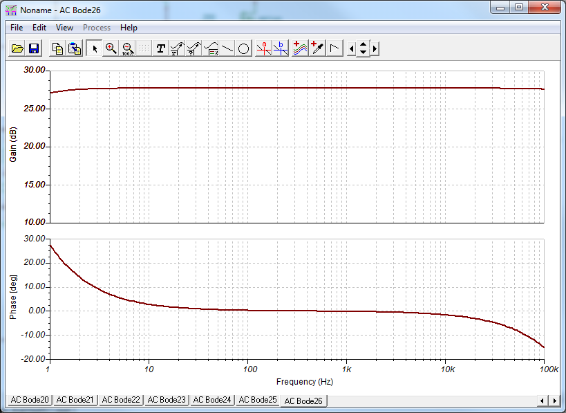

Here is the frequency response and phase plot:

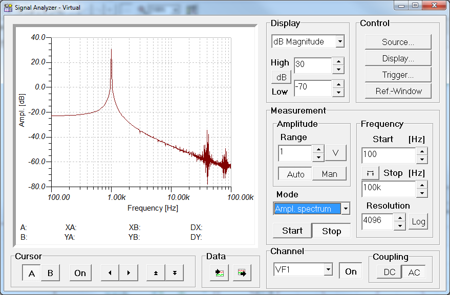

Here is the requisite spectrum at 1kHz excitation:
Let me know if I have done something totally wrong. But if this is right, it means we can use plentiful $2 hex-FETs. Oh, and the 50v rails now mean that this is a 250w class amp?

HEXFETs will require a Vbe multiplier for thermal compensation, since the negative temperature coefficient does not come into play until the device has about 10 amps through it (at least for the IRFP240). The exact values around the Vbe multiplier (also known as a bias servo) are critical to ensure that the thermal performance is matched as closely as possible.

Xrk, connect the protection Zeners to the output rail.
Add drivers between VAS and outputs.
Sorry, I am new at this. Would you mind marking up my schematic?
Thanks.
If you want a simple amplifier using HEXFETS, take a look at Apex A9. You can also use its schematic as a basis for modifying AX11/FX8 to use HEXFETS. Just copy the OPS part (VBE multiplier, drivers and output fets) from the A9.
