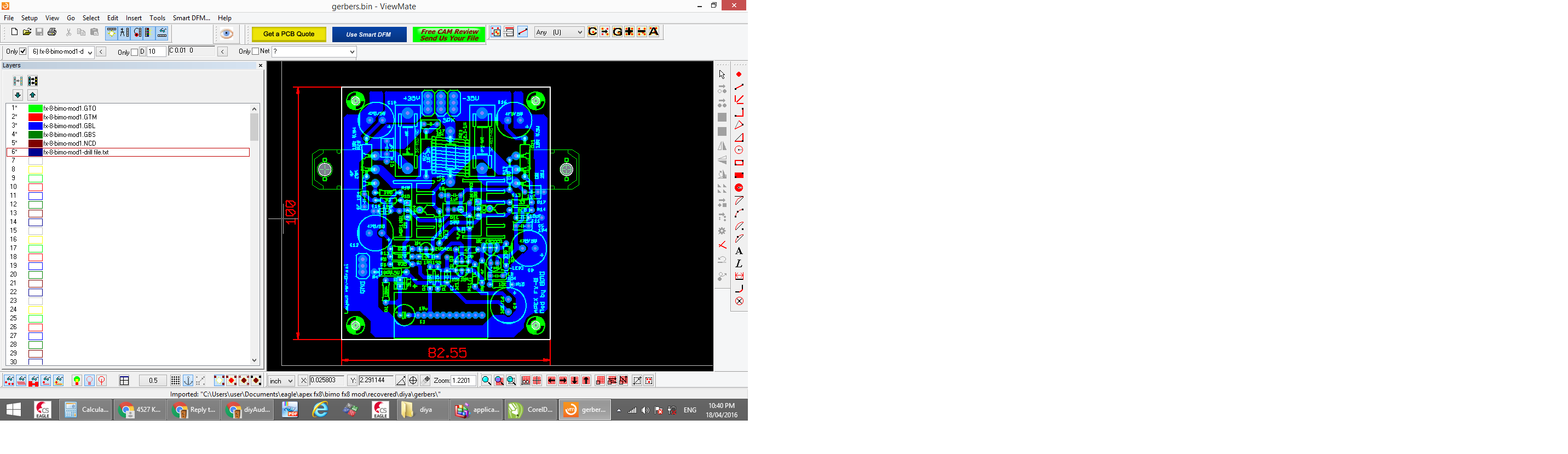

It's a pity that prasi's gerber files have one dimension just a little over 100 mm. Some factories offer very good rates for the boards up to 100 mm.

Oh! I see. I hadnt given much thought to that aspect. I will change it to 100 by moving things around. Here in india quotes are based on square centimeters area.

I submitted the previous Gerber files as 100mm max x 100mm max - there was a designation that said 100mm x 82.2mm I thought. What was the actual dimension?

The board does indeed measure 100mm x 82.55mm in eagle as XRK pointed. And I believe the outline (dimension layer) thickness (0.1mm in posted design) is not considered in PCB manufacturing. The board size is measured from center to center of outlines in x and y directions and its 100mm x 82.55mm.

and what was the quote?
the quoted cost was for 100mmx 100mm or was it for > 100mm x 100mm?

Oops! Sorry. I was looking at the dimensions on bimo's pcb which is 100,64 mm.

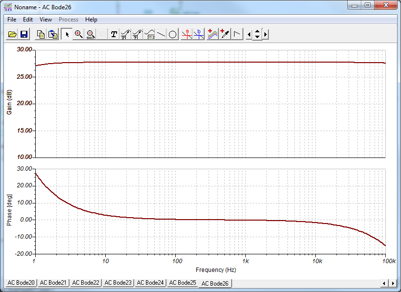

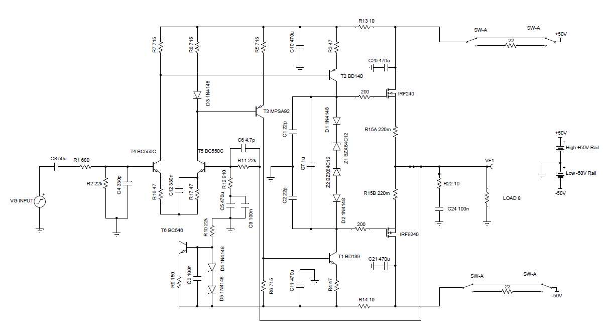

Thanks to egra for posting his TINA simulation. Once I had the sim, which has excellent performance btw, I had to answer a nagging question: what happens if you swap out the nice Hitachi's for some dirt cheap hex-FETs like the venerable IRFP240 and IRFP9240? I put those in and sure enough, the distortion above 3kHz started to degrade badly. I recall that often when IRFP's are used in Pass amps, there are some "emitter" (or shall I say drain/source) resistors. So I added a 0.22ohm resistor between the output pin and common point. This really cleaned up the distortion and this amp appears to make clean 20kHz squarewaves and have pretty low distortion - even when driven at high power. The hex-FETs can take higher current and voltage too so I boosted the rails to 50v. Assuming the other transistors and caps can all take it - does this make sense that it can work? Here is the schematic:
Here is the scope with 20kHz 1.41v sine wave excitation:
Here us the scope with square wave at 20kHz:
Here is the spectrum analyzer output for 20kHz excitation:
Here is the frequency response and phase plot:
Here is the requisite spectrum at 1kHz excitation:
Let me know if I have done something totally wrong. But if this is right, it means we can use plentiful $2 hex-FETs. Oh, and the 50v rails now mean that this is a 250w class amp?

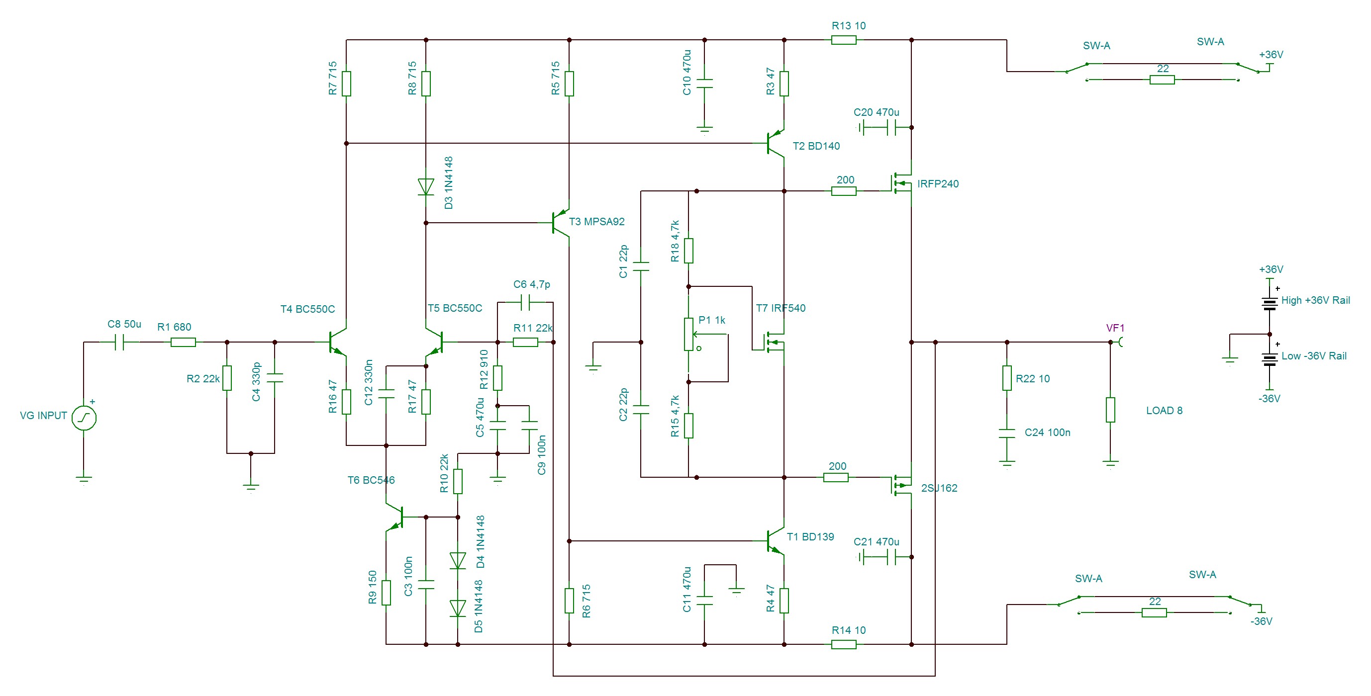

HEXFETs will require a Vbe multiplier for thermal compensation, since the negative temperature coefficient does not come into play until the device has about 10 amps through it (at least for the IRFP240). The exact values around the Vbe multiplier (also known as a bias servo) are critical to ensure that the thermal performance is matched as closely as possible.

So mount the Vbe multiplier on the same heatsink or ontop of the hexFET as temp compensation servo? I have seen something similar on my Dx amp but it uses a BJT and not FET.
Xrk, connect the protection Zeners to the output rail.
Add drivers between VAS and outputs.

Sorry, I am new at this. Would you mind marking up my schematic?

If you want a simple amplifier using HEXFETS, take a look at Apex A9. You can also use its schematic as a basis for modifying AX11/FX8 to use HEXFETS. Just copy the OPS part (VBE multiplier, drivers and output fets) from the A9.
If I simply install hexFETs as shown in circuit - would it work per the simulation but with potential for thermal runaway if Vbe multiplier is not used? If I keep current below the 10amps (or whatever spec is) would t be ok?
