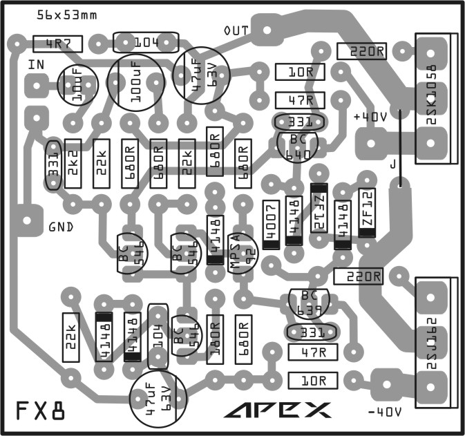

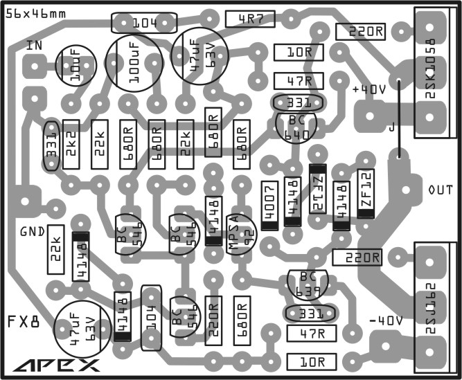

Here is an idea for Fx8 layout. Very compact, but I am not entirely satisfied with number of jumpers. Can you suggest improvements? I have added fuses and bypass caps.. minimum 20mils spacing , dont know if its good enough for iron transfer, but enough for phtoresist.
reg
Prasi
FX8 pcb (based on AX11 pcb)

I have started to redraw this layout some time ago, with the intention to build a pair. Not completely finished yet...
Zeners and diodes add to pcb...

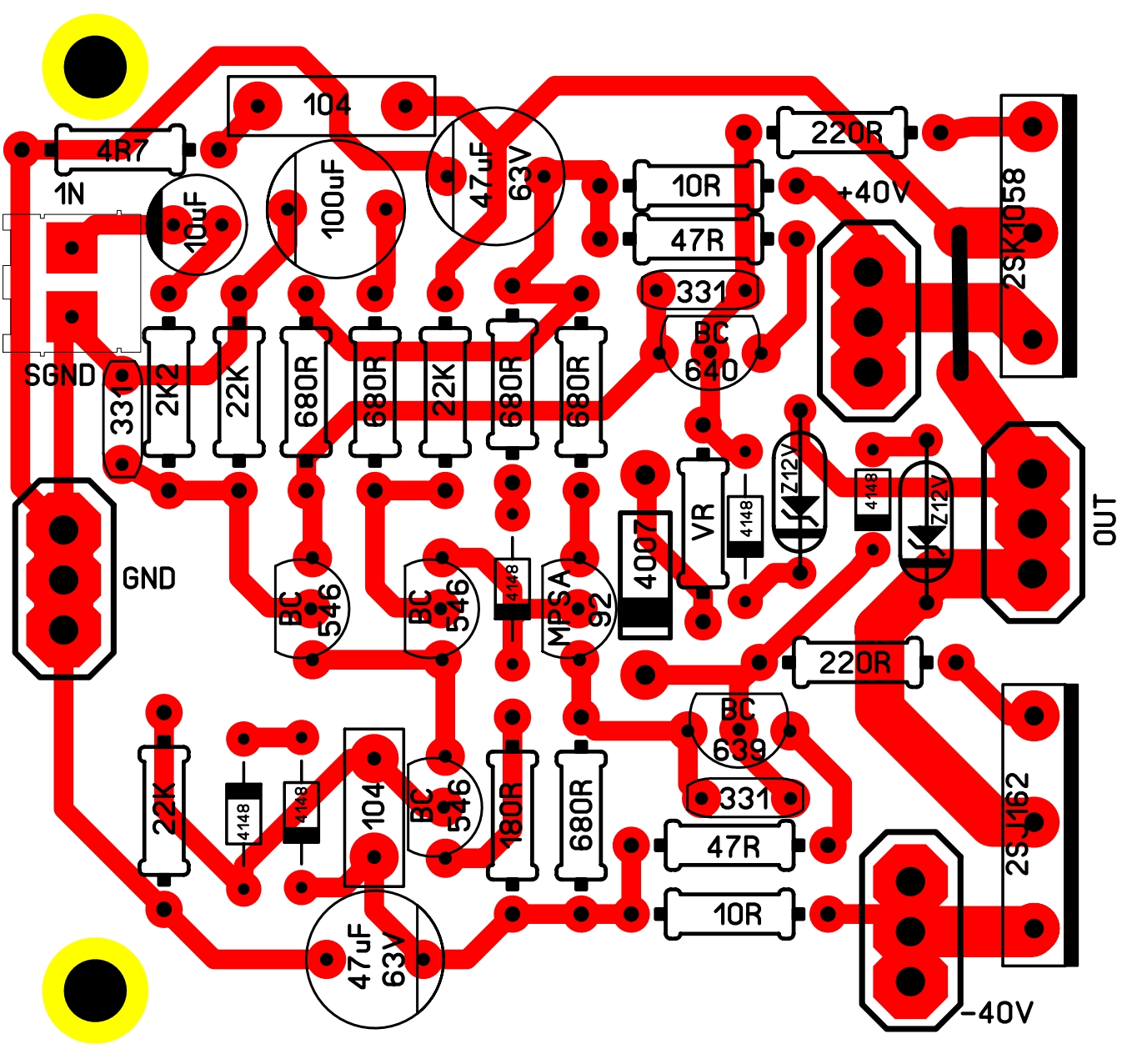

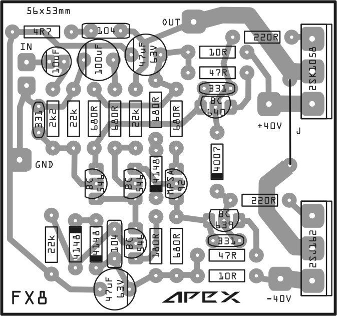

Hi Mile,
How do we adjust bias?
Thanks, Terry
Hi Mile,
I went out on a limb and figured to add a resistor in series with the 1N4007 for bias adjust. I figured to just use a trimmer there and then replace with a resistor. Please look over my layout and see if things are OK for testing.
Thanks, Terry
Thanks, Terry
Hi Mile,
Thanks, Terry
Nice pcb... use 1k trimmer instead 1N4007 for bias adjust.

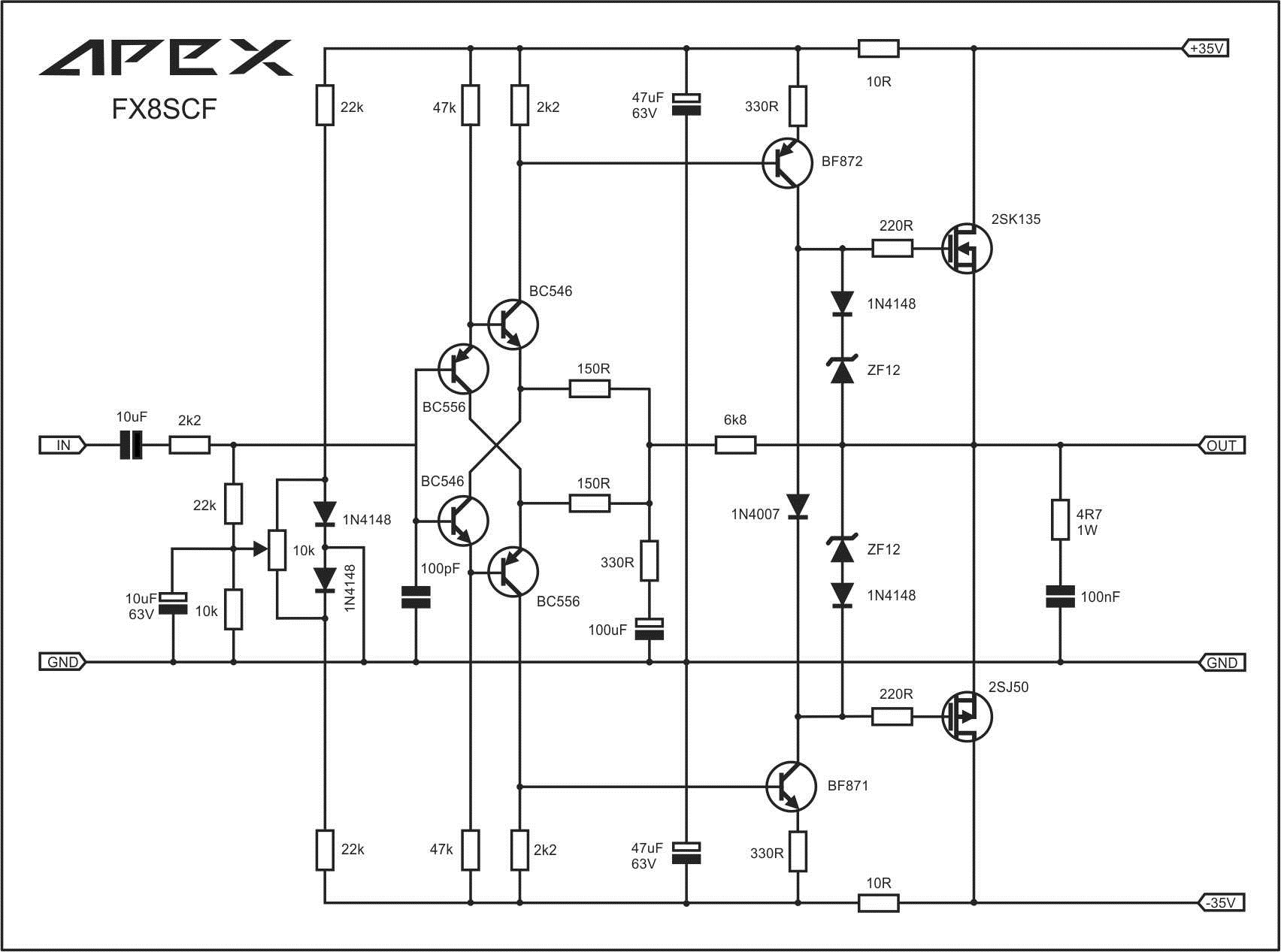

FX8SCF is idea for simple CFA amp with laterals it is not tested and no pcb.

Mr. Miles,FX8 nice pcb design...
is there any advantage in keeping BC639/640 pair near heatsink and also the thermal bonding of i/p BC546 pair?
reg
Prasi

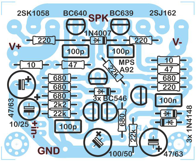

ax20 3pair
is this layout tested??
how about bias & DCO??

Mr. Miles,
reg
Prasi
VAS transistors need heatsinks, use BD139/140 instead BC639/640

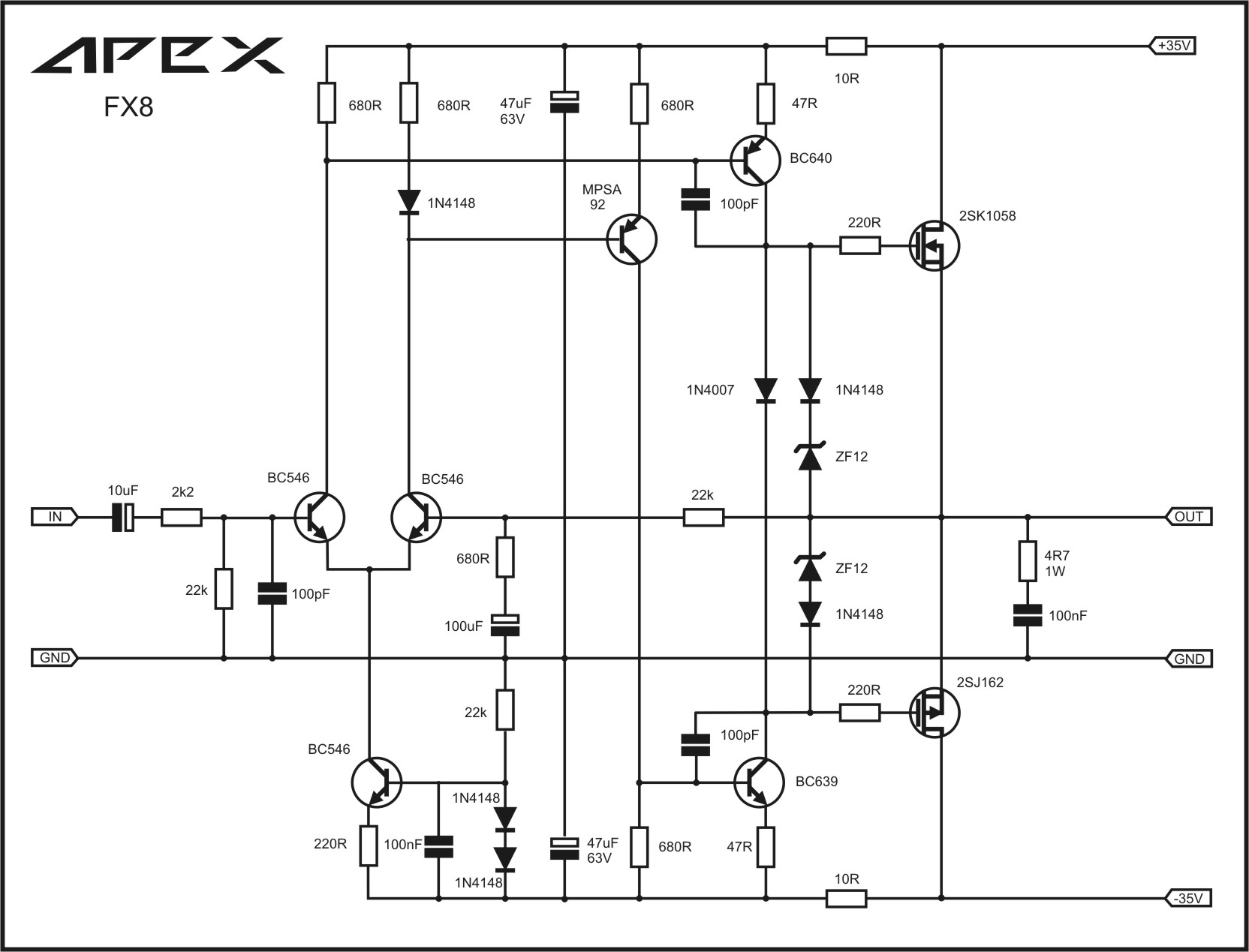

Nice and very cute little amp.. is it tested?
FX8 is AX11 with lateral mosfet OS, not tested.
Regards
Regards
What bias do you recommend? Has to be measured at the rail.

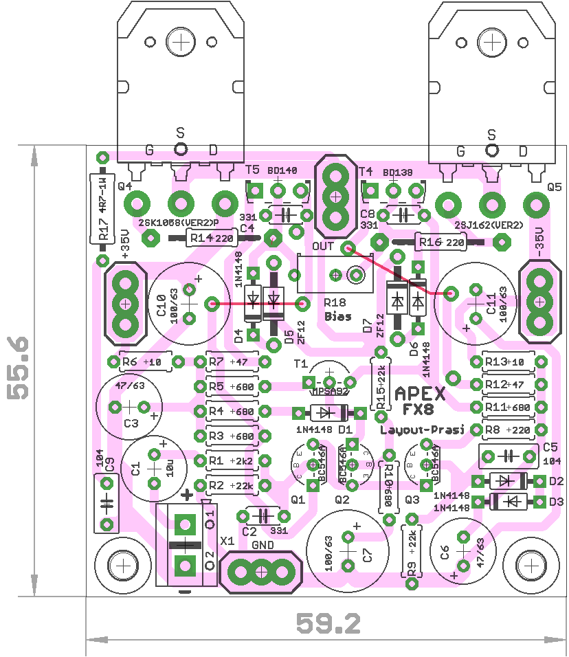

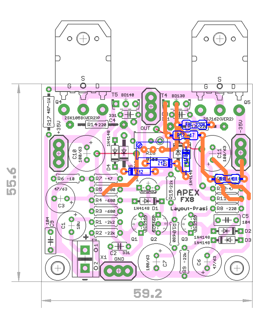

Mr. Mile,
Here is what I have come up with based on the blue PCB design. changes done
1. added zeners and 1N4148 diodes
2. Zobel
3. rail decoupling caps
4. Trimmer for bias instead of 1n4007
what trimmer value should i use?
reg
Prasi
Have you measured the elco caps? Mine only have 2.5mm pitch.Mr. Mile,
2. Zobel
reg
Prasi
I think he said 1k for the trimmer.
