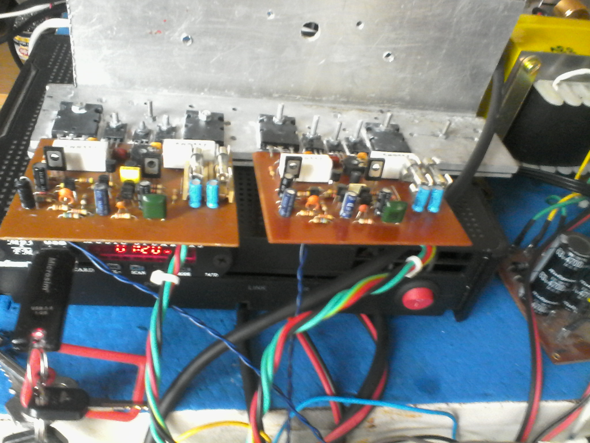

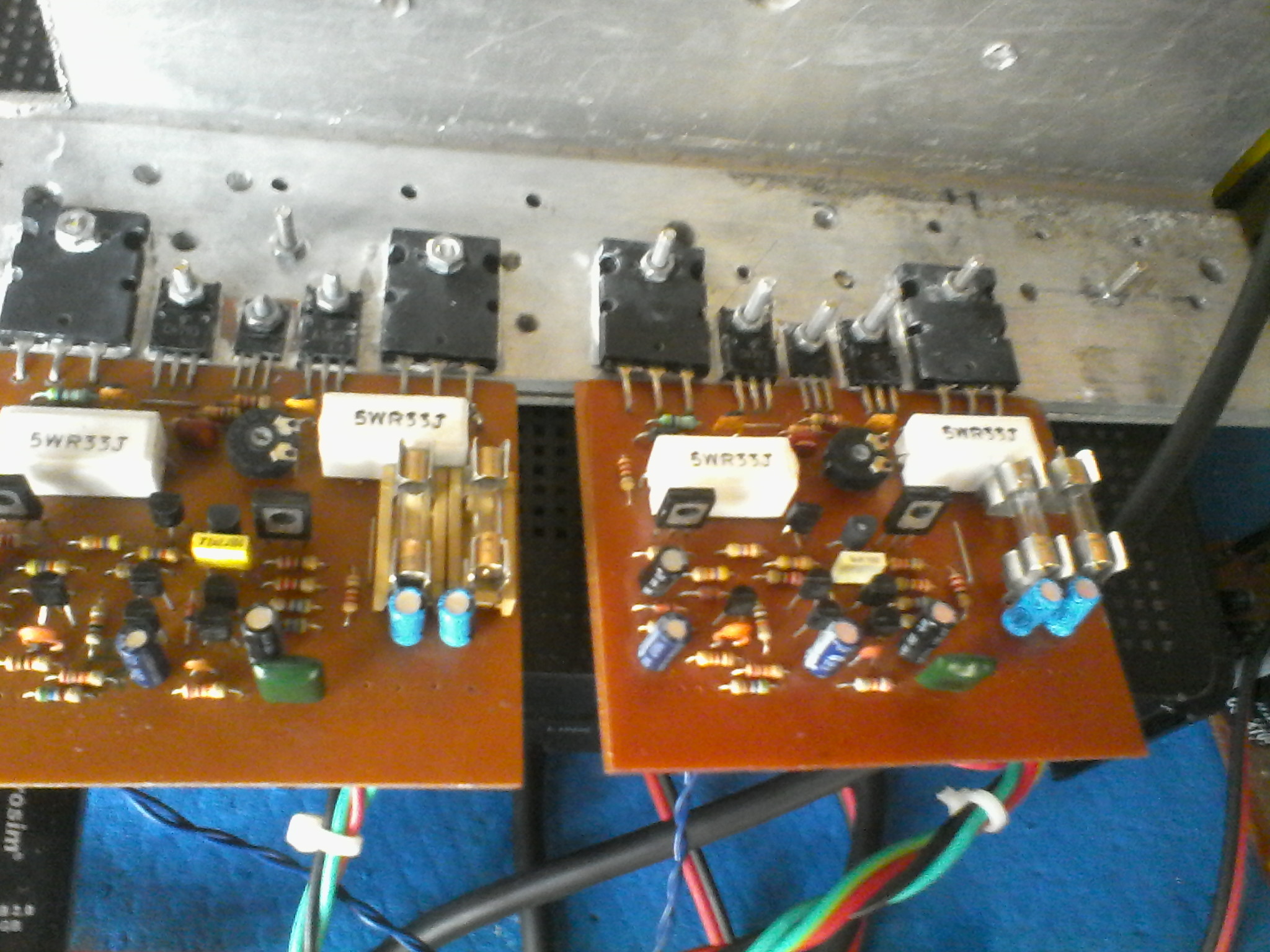

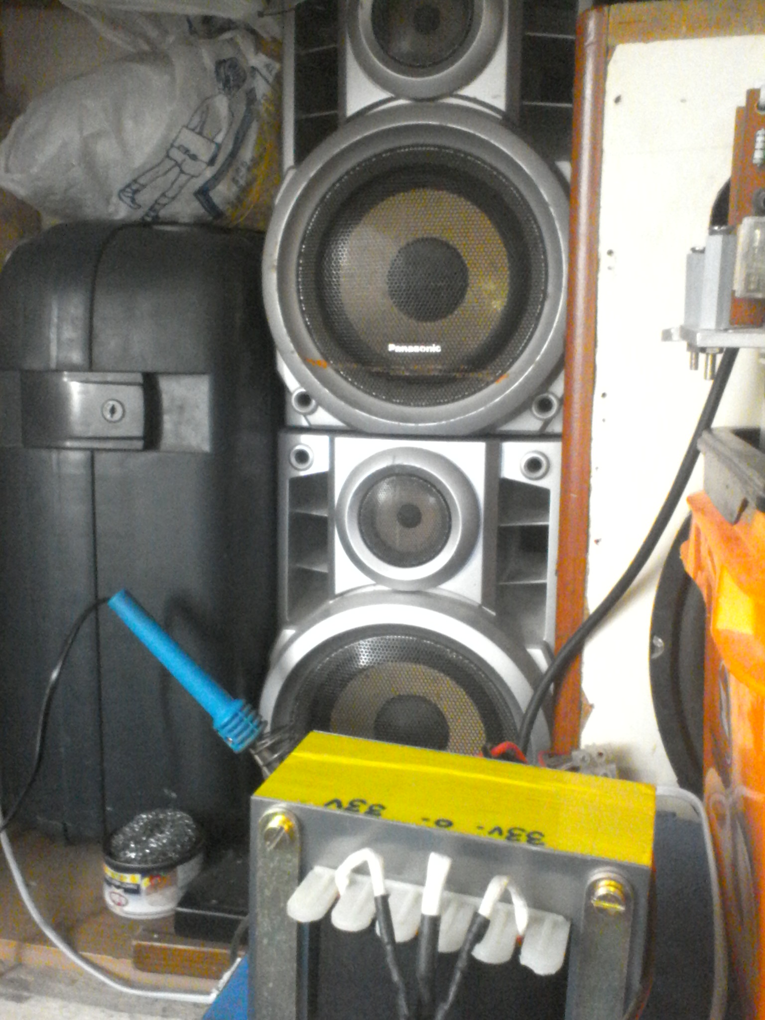

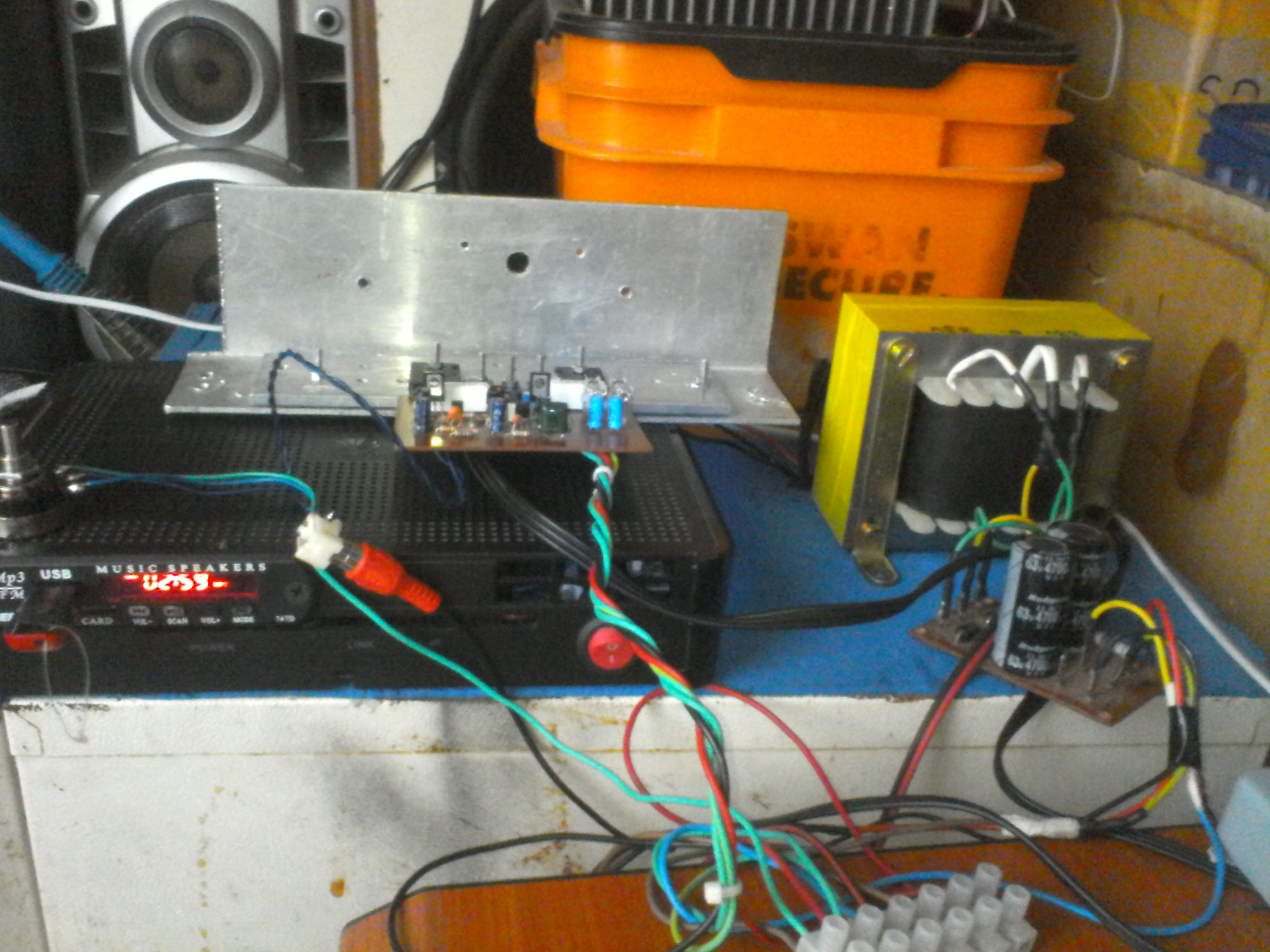

8 Channel APEX A-14 amp build finished, sound awesome. Loud and clear , super silent and perfect of home audio.
Using as 7.1 audio system, with 12inch sealed sub-woofer driven by APEX B500 amp. Getting 7.1 channel analog output via Asus Xonar DX sound card and PC.
Listening to music is a pleasure. And playing GTA-V (PC Game) with surround sound effects is real fun. During game play all channels perfectly creates detailed surrounding audio effects around the player.
Thanks Apex for sharing such a nice amp with us.

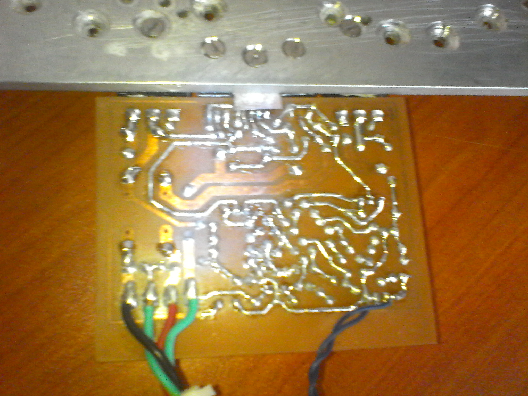

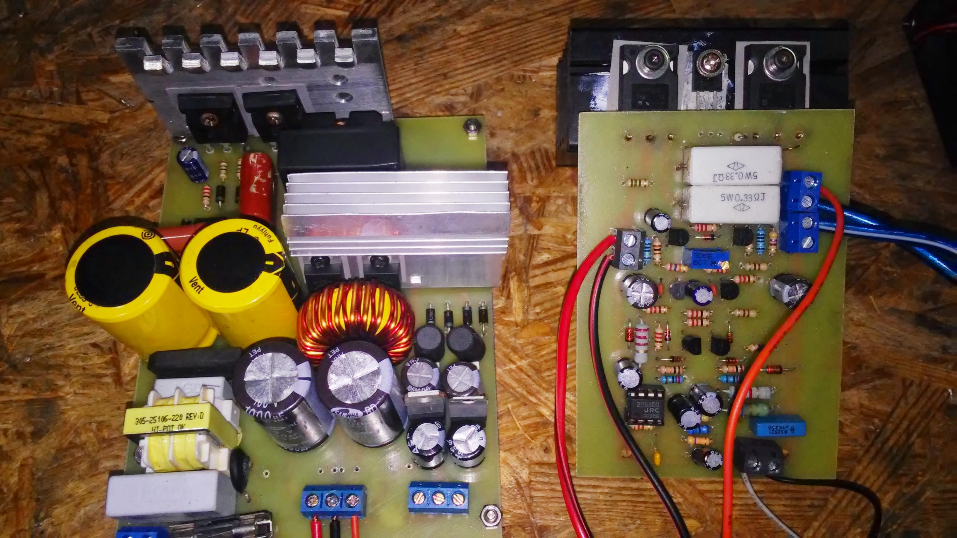

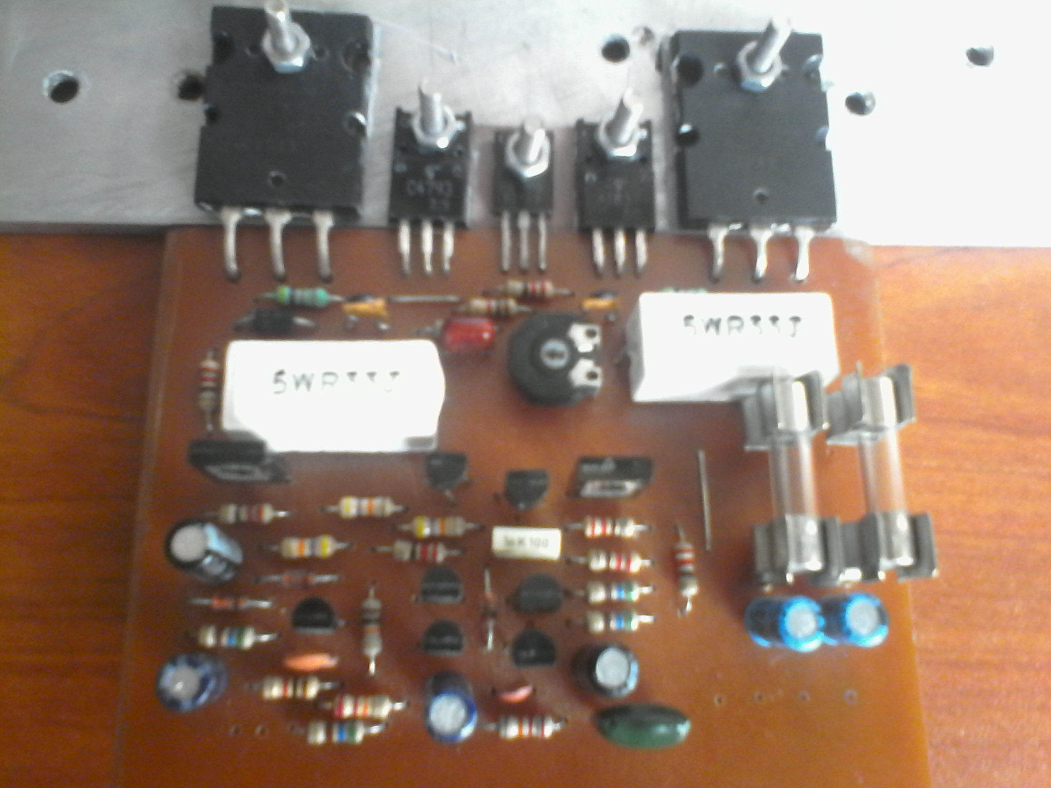

APEX A9 modified
APEX A9 modified with smps (2 x 48V/300W + aux 2x 15V)
irfp240-9240 0.33Ωμ smooth resistor and 68Ωμ resistor for the gain.
BC 560-550> BC 556-546

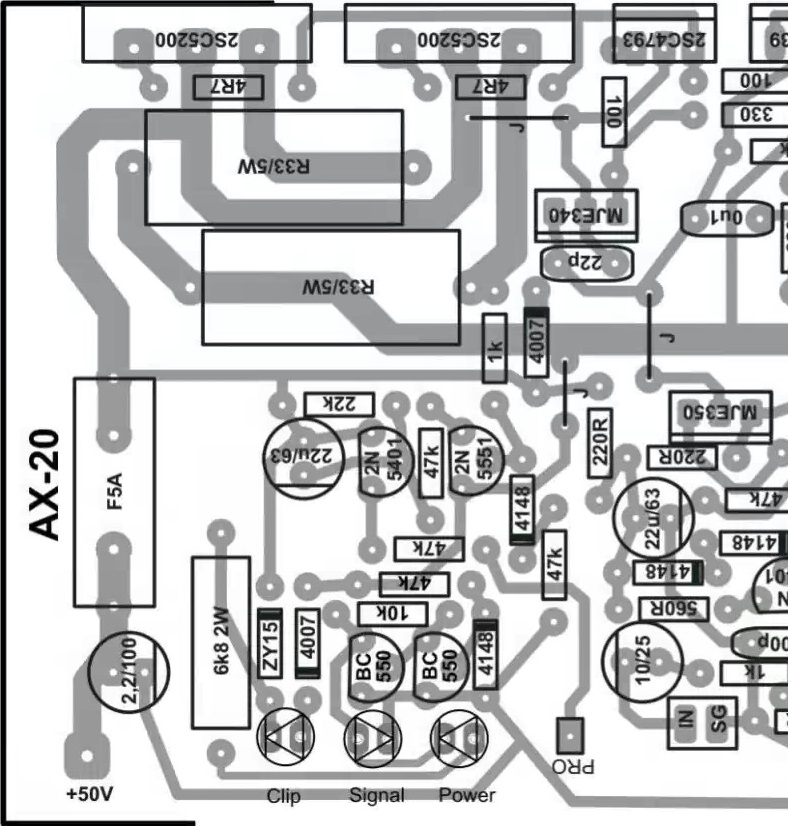

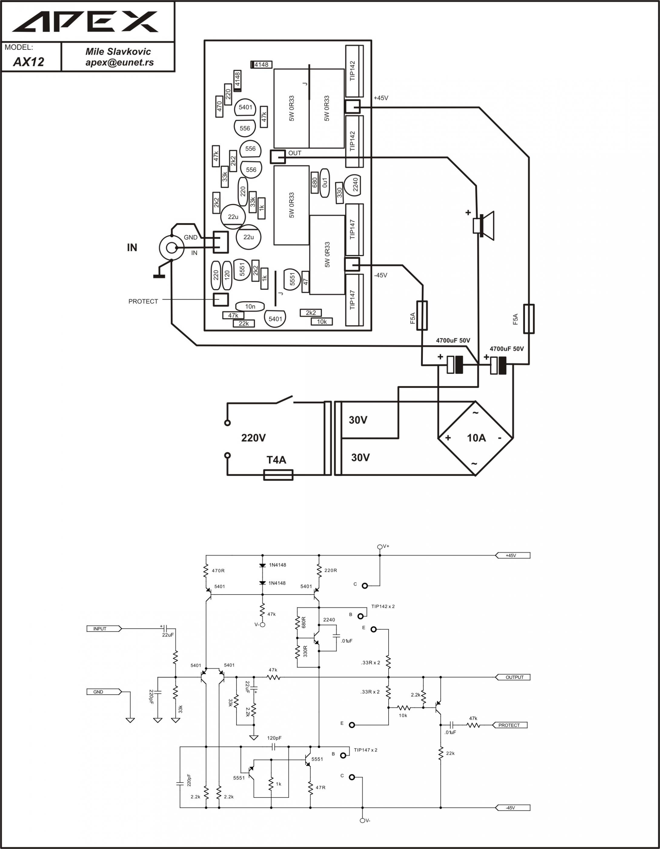

Led Color
dear all friends .. please help to color & Type LED on the circuit below, I'm making AX20 with LED Power, Clip, Signal.
led power =?
LED Clip =?
LED Signal =?
Thank you ..

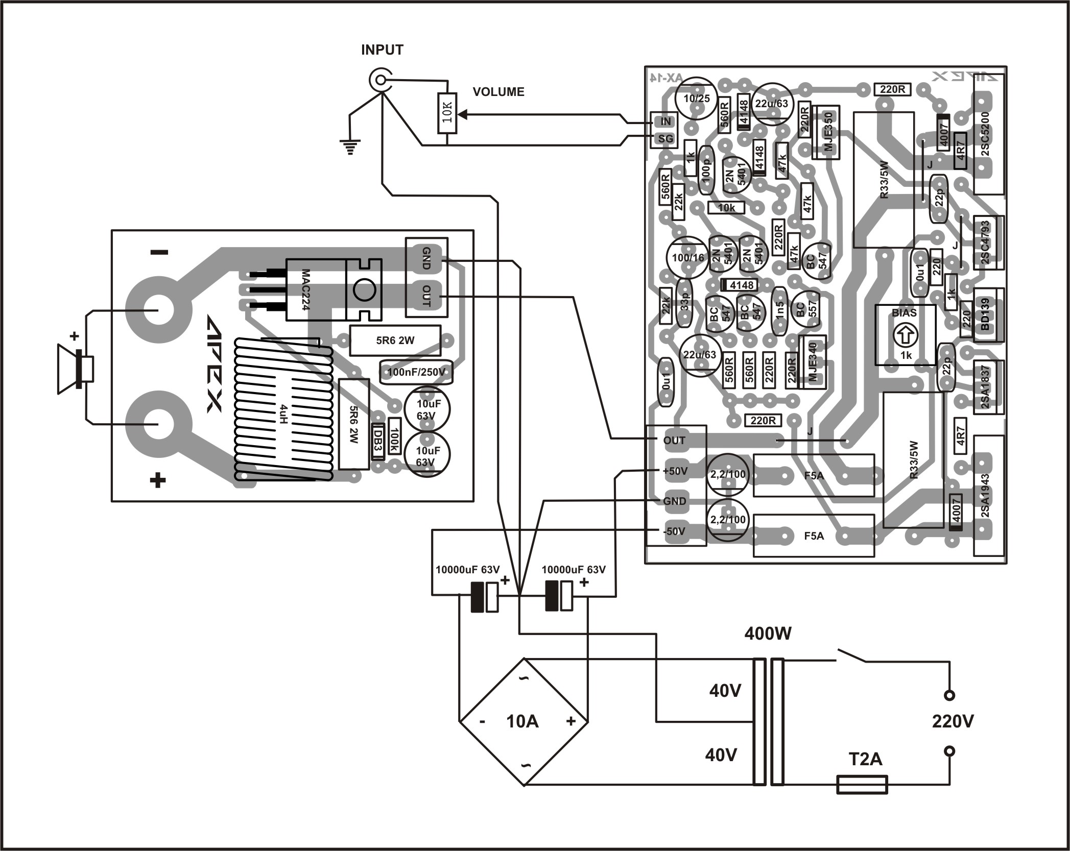

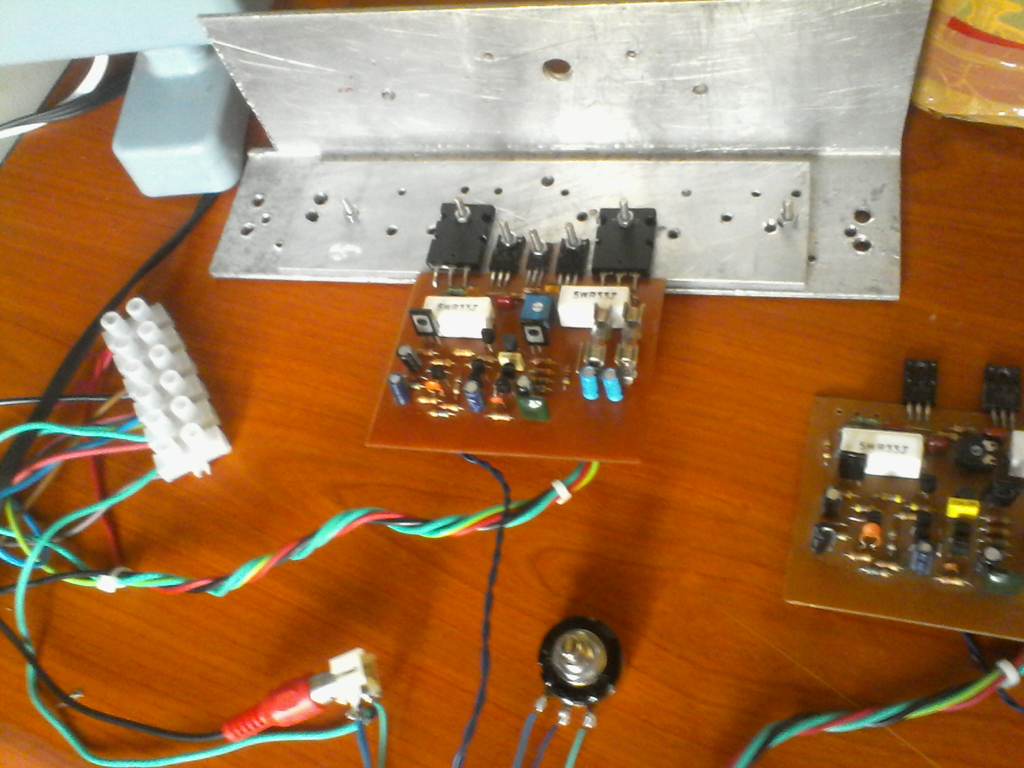

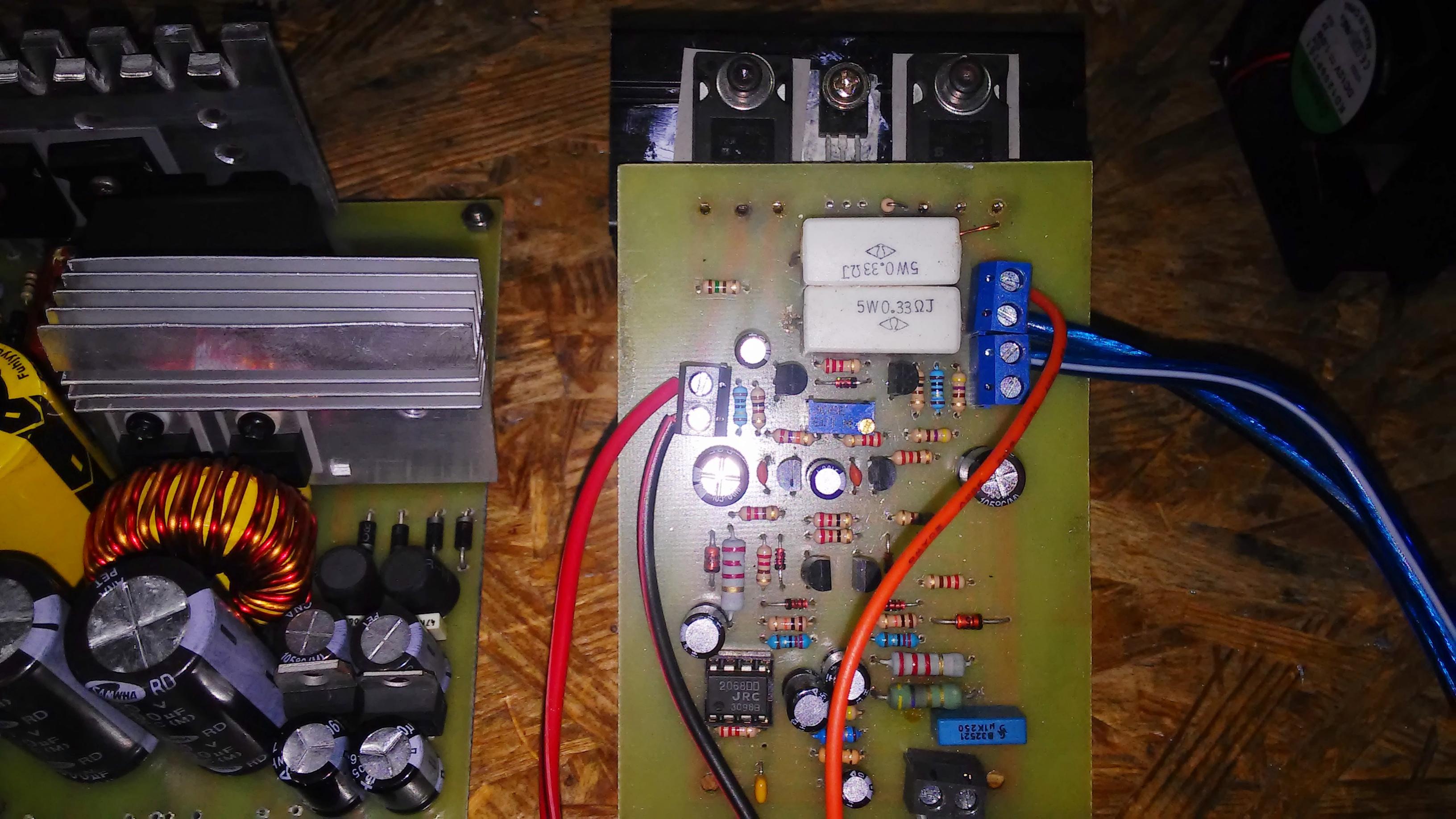

thank you so much sir Miles i try to connect my input gnd to psu gnd thank you so much sir..god bless
Sir Apex and sir 4319250...thank you so much i connect my ( in gnd ) to PSU gnd now problem solve sir.. my AX14 work great sir offset 10mv...very good sounding amp. thank you so much sir Apex...

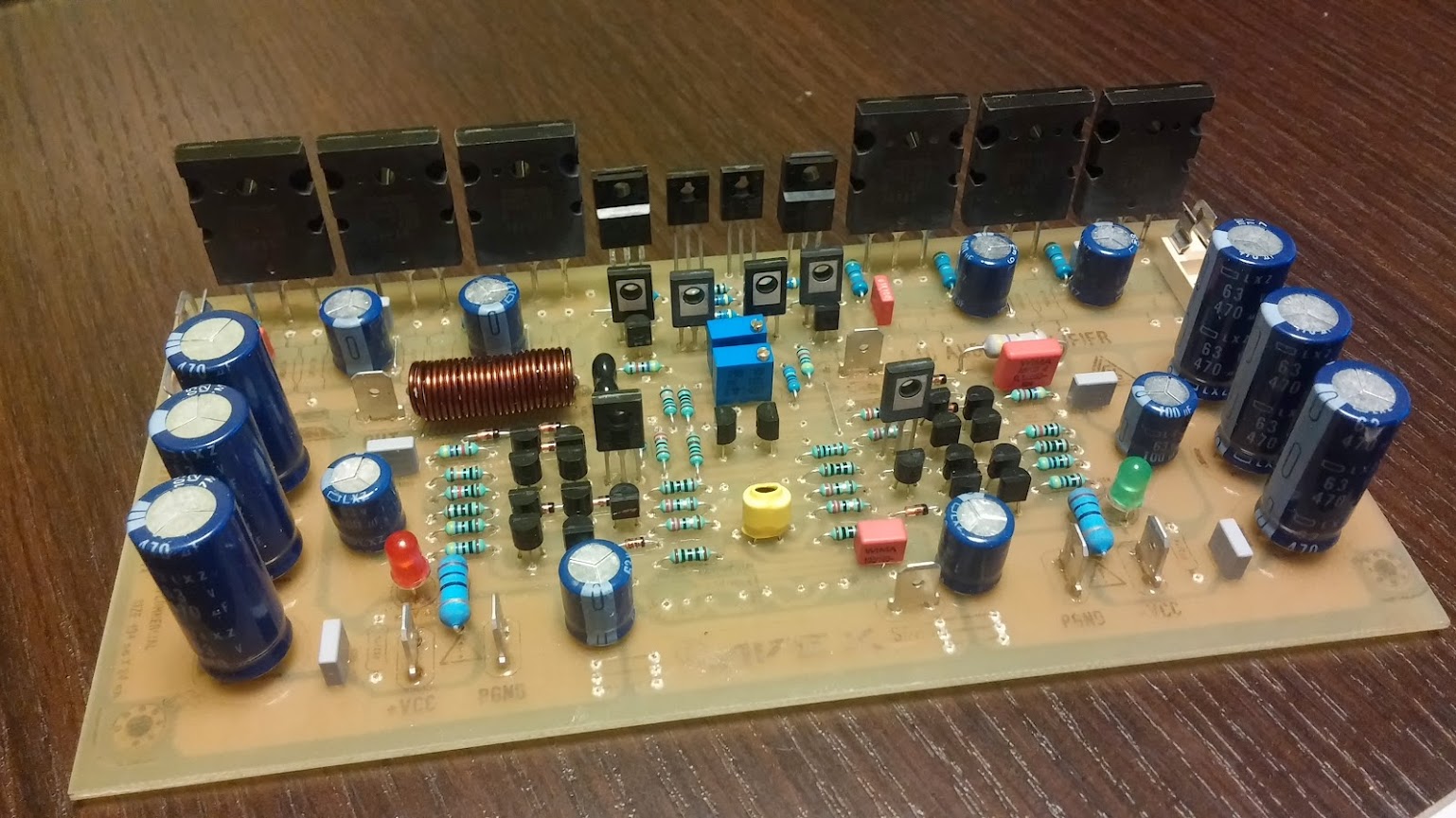

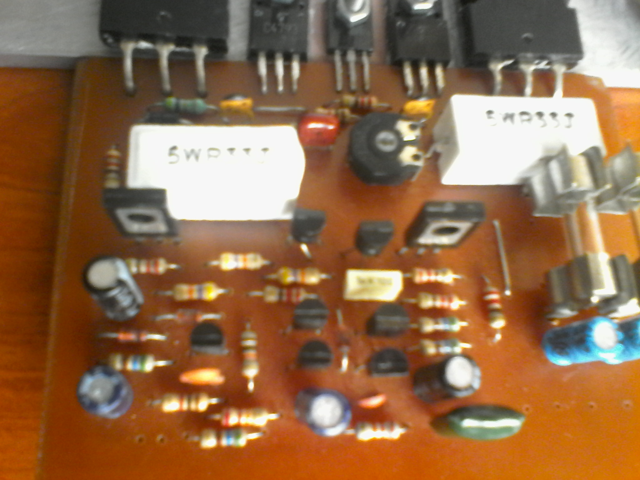

Mostly done...Just few parts missing...Alex, I saw few changes, mostly filtration, but in schematic is 220uf near bias setting, and you have 2x470uf in series? Can you explain me, functionality this caps?
Hi maxwell007,
Are two 470uF capacitors ,back to back to simulate a non polarized capacitor ,one terminal connected to the ground and second terminal it's connected to +/- 1,2V voltage to swing trimpot by 470K resistor .... 😉 Please solder resistor witch it's parallel with output inductor on solder side ..... Nice work ,congratulation .
Regards,Alex

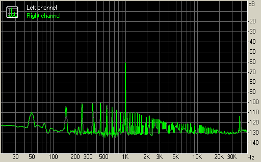

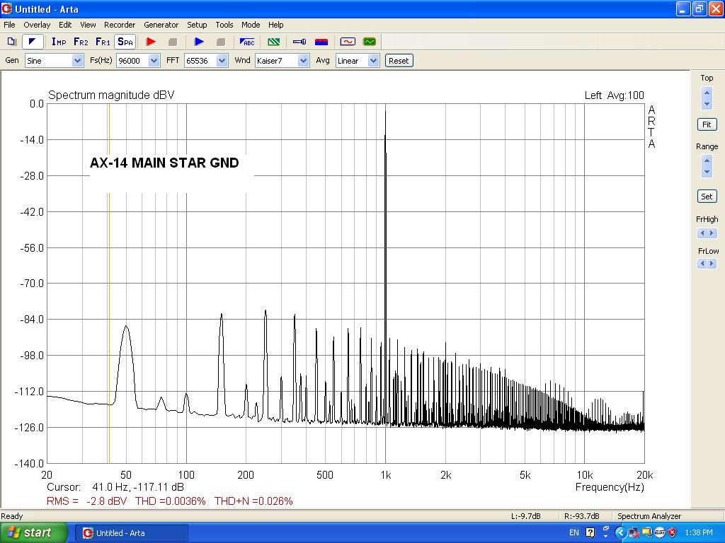

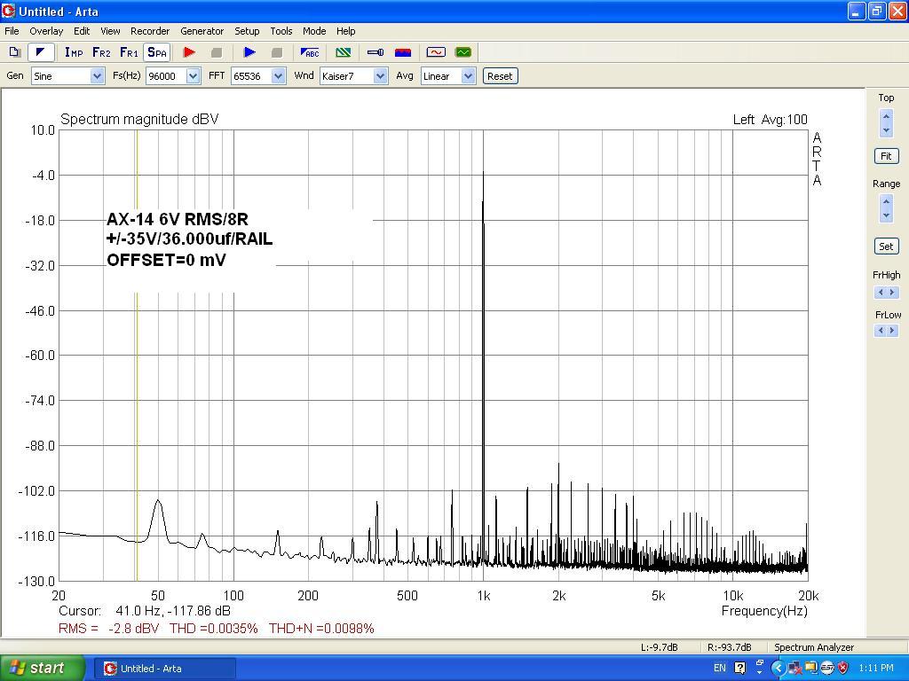

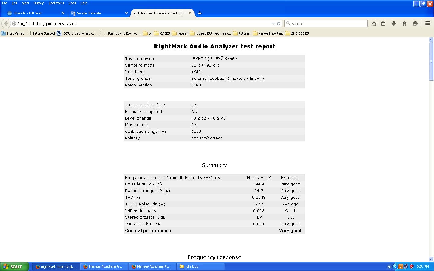

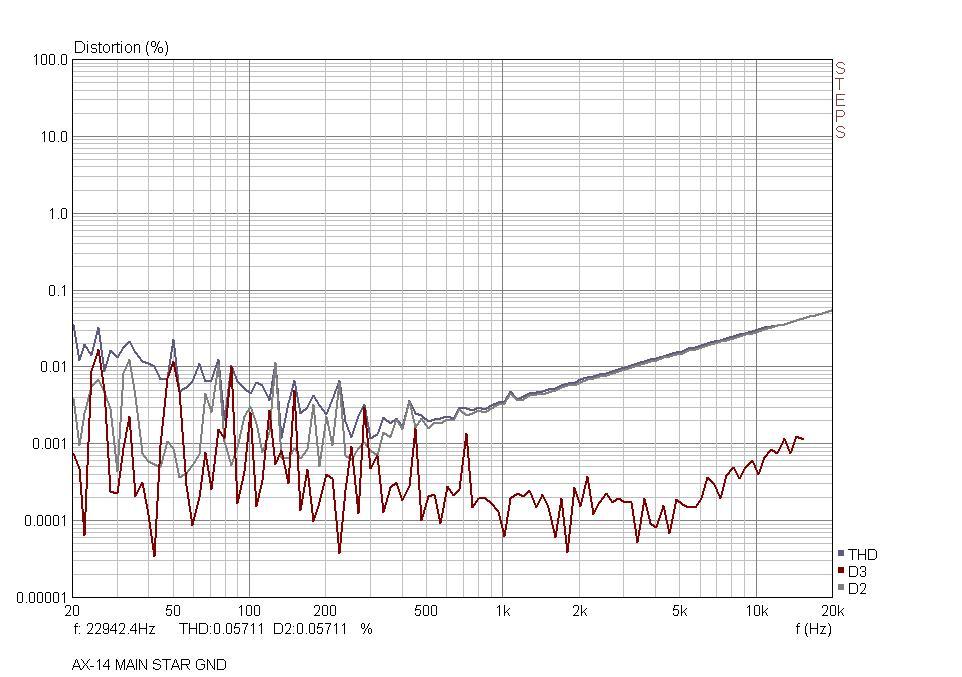

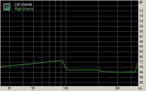

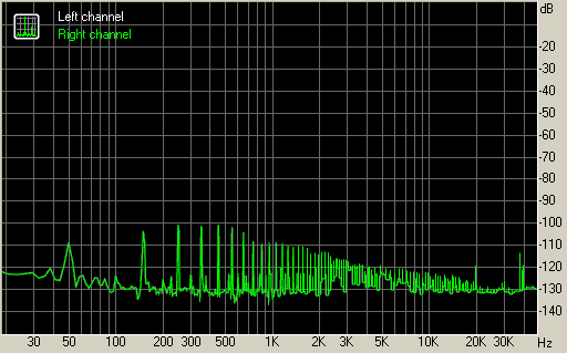

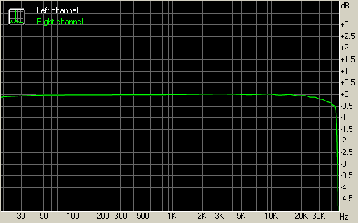

I want to share my experience on AX-14 .
I will post two set of test.

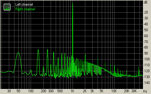

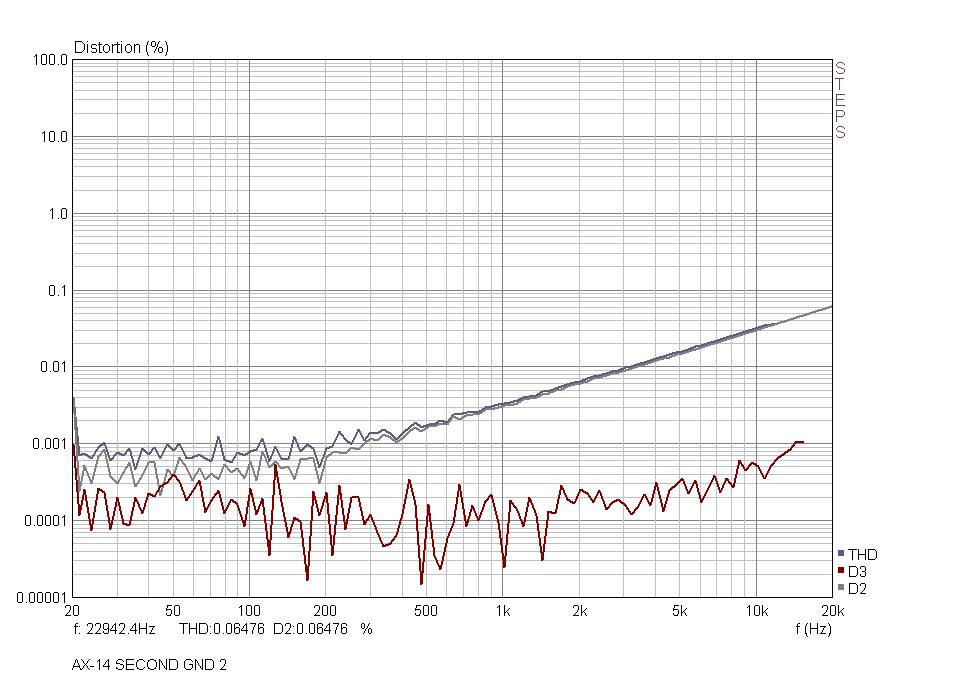

First test is with input gnd to main star gnd when second with inp.gnd to a separate star gnd ,a little farther.

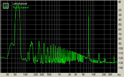

Same results using other software RMAA
Inp. gnd to main star gnd.
