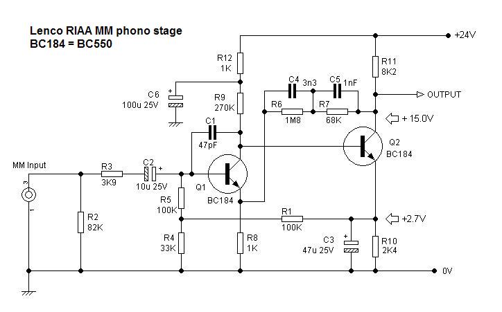

Here is one classic RIAA stage using CFA topology from the past. Very easy to build, simple and is not difficult to design pcb. Just a couple of transistors.🙂 You shall be surprised how good it is. If somebody has time to design it, it would be nice to post pcb pdf.Just like a monolythic opamp, this is why I think smt is the best to use for such a design.
I would have to say it is the most elaborate MM phono yet for me to lay my eyes on!! and I do not know of any other CFA type phono pre-amp either.
