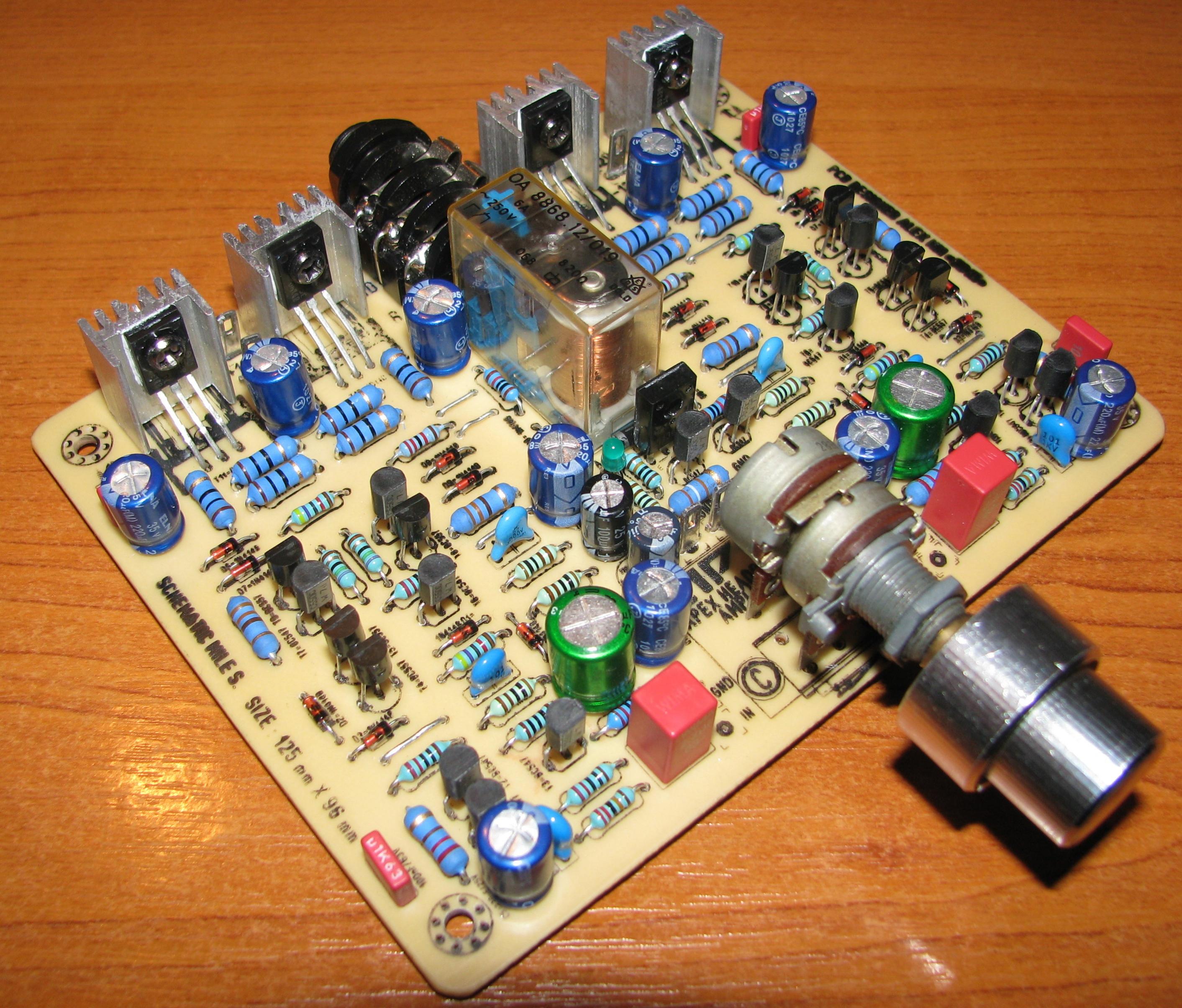

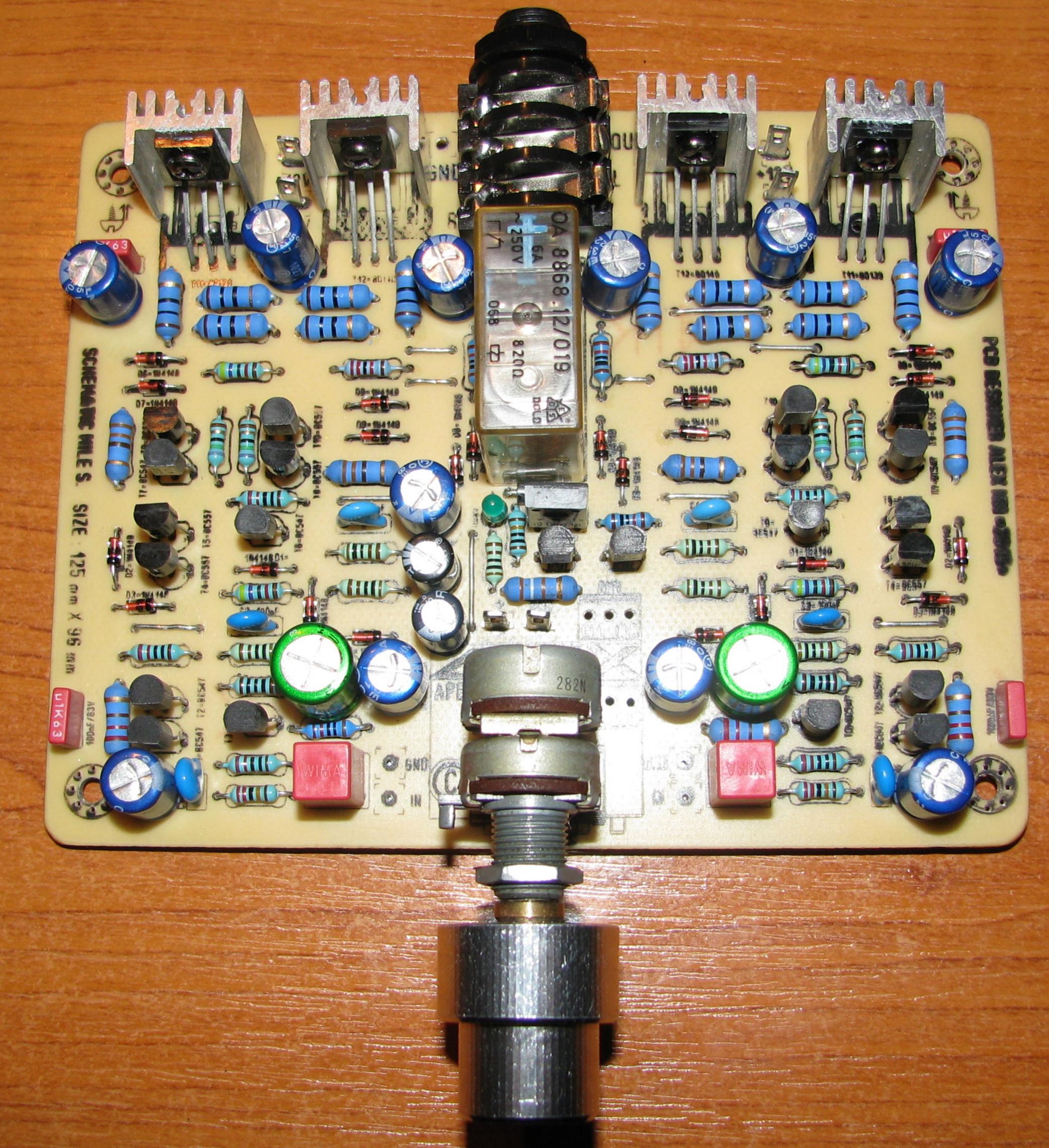

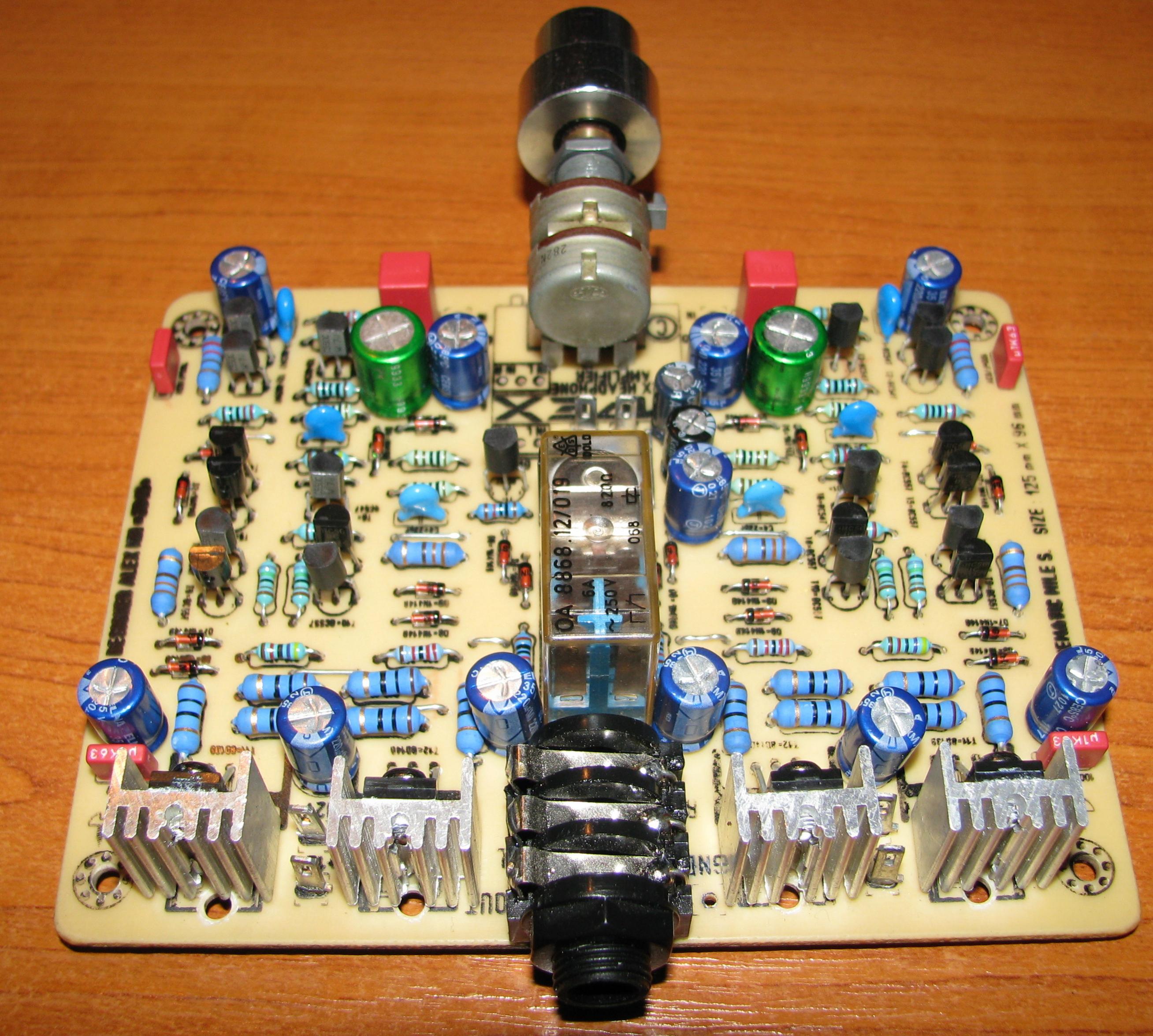

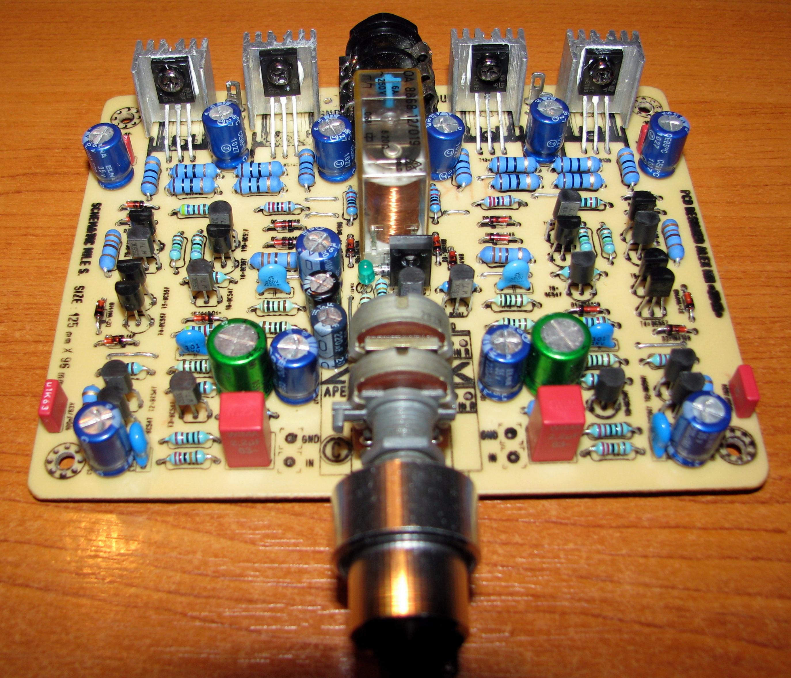

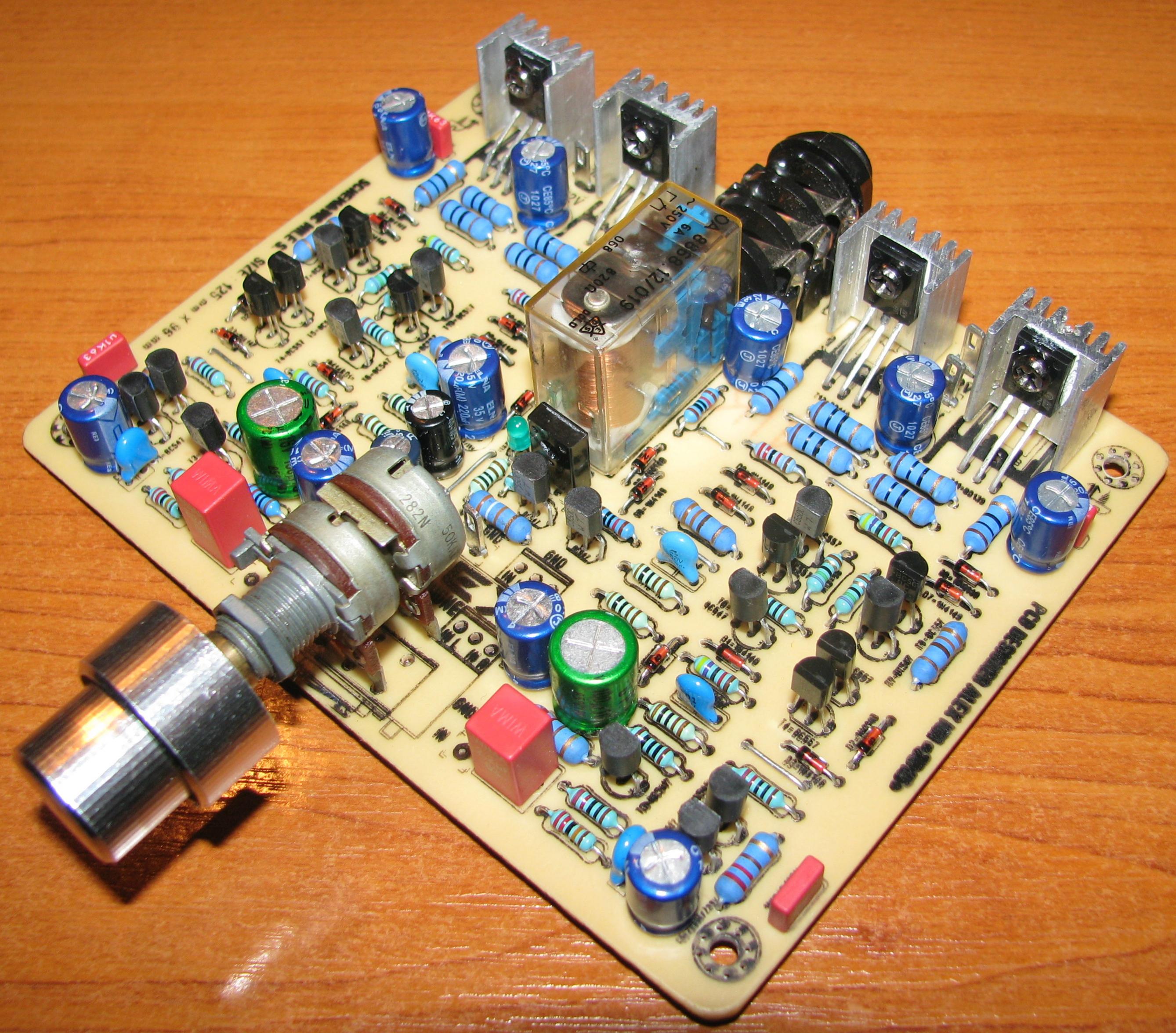

Let me present my new headphone amplifier based on SR PP12 schematic , not tested yet ,but tomorow will be ......🙂
Regards,Alex

I can't help noticing that your silk screen says BC547 and you have a BC546 there. Which one is wrong?
does not affect amp operation.
The BC5xx range are graded for different duties.
546 is the higher Vce version.
547 is the medium Vce
548 is the basic.
549 is the low noise version.
560 is the low noise and medium Vce version.
Add 10 for the PNP versions, 556, 559, 560
But they are all much the same.
