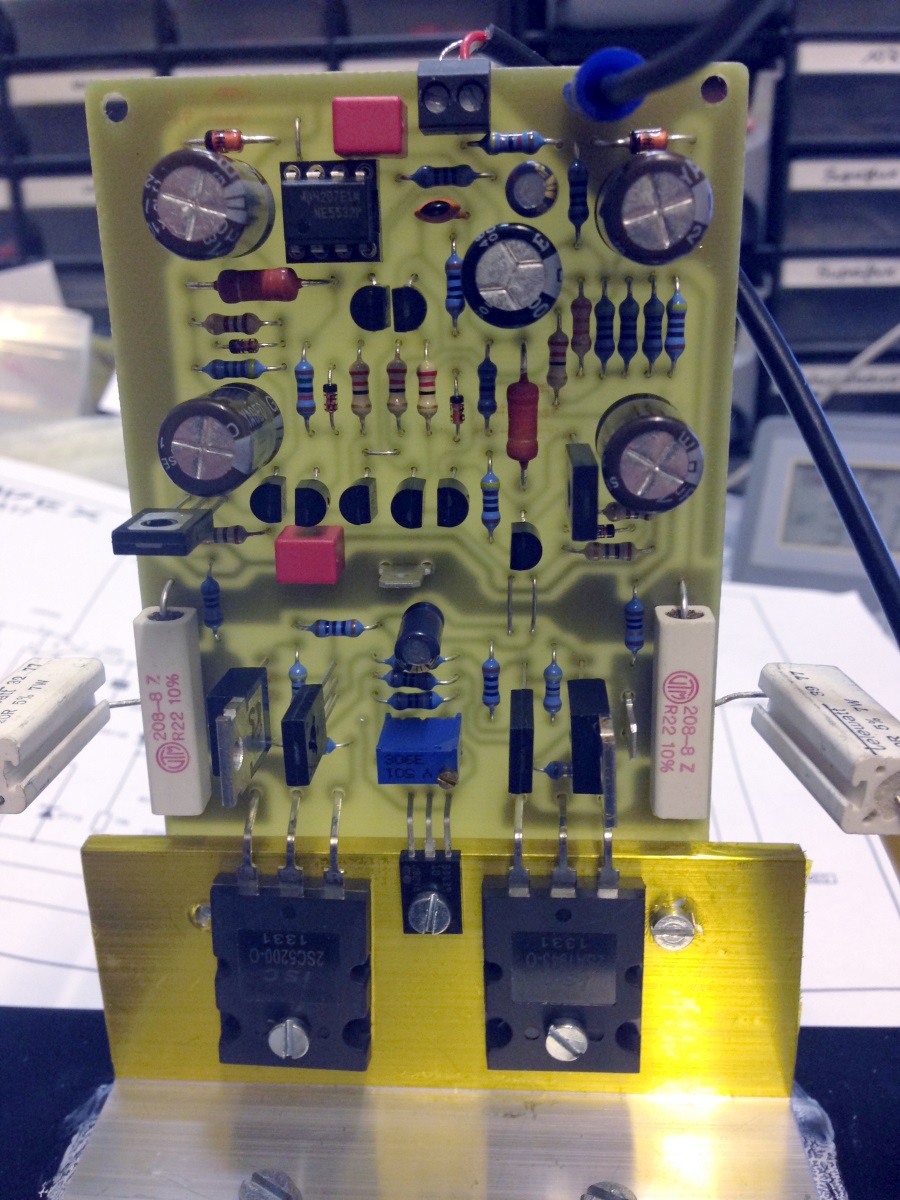

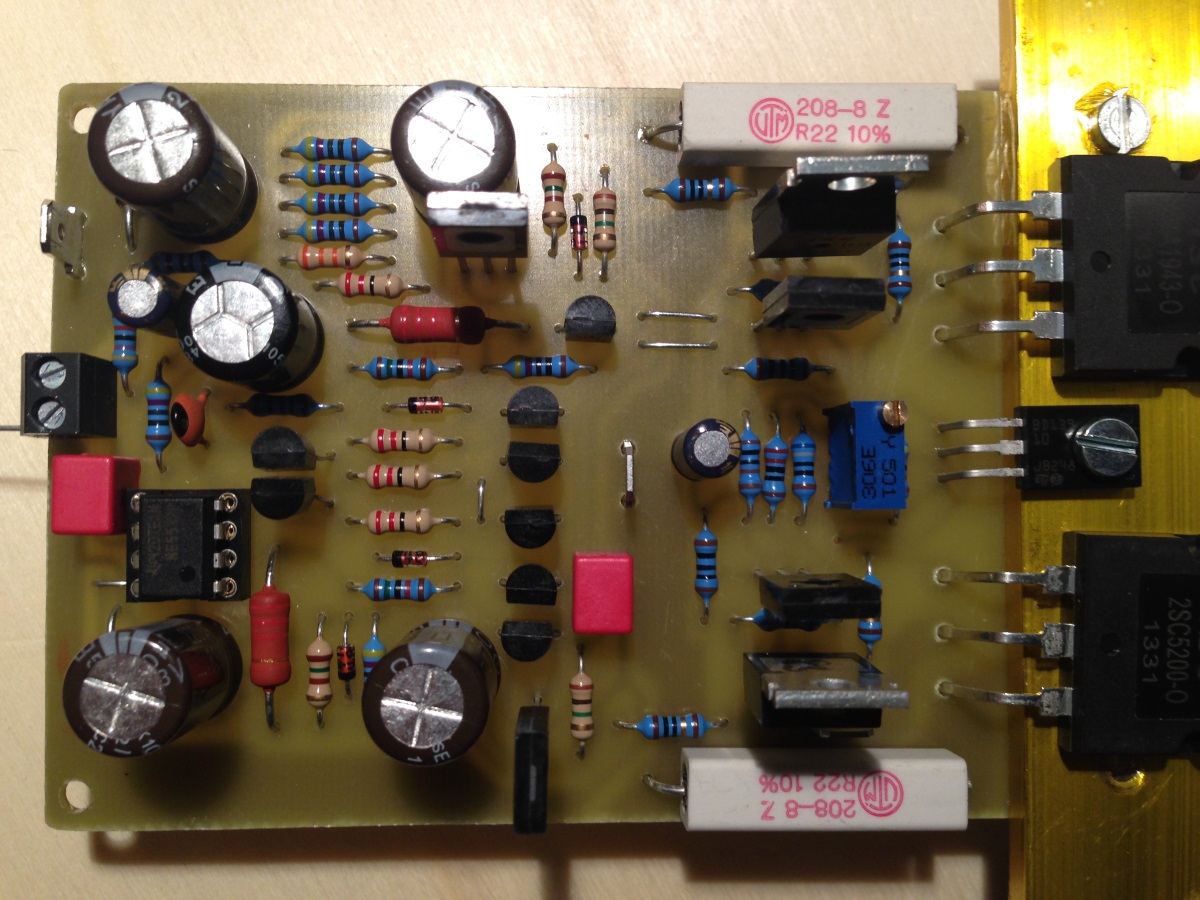

Ground-wiring is not optimal. I need a ground wire directly to the input to stop humming. I have the 4793/1837 replaced with 2SC2238 and 2SA968 - I had no other. Opamp is a NE5532, will be replaced later. The offset is 1.5 mV. Quiescent current is about 25mA. All components cool. All without any settings.
The sound is clear and neutral, close to the SR100. But I can not say anything yet. The test took less than 5 minutes.
I make a few measurements later in the day or evening, currently calls the family 🙂.
regards
Olaf
edit: Humming is normal - forgotten the wire from PGND to SGND 🙂

Nice work and nice pcb, A17 is CFA amplifier and SR100 is VFA... sound CFA vs VFA🙂

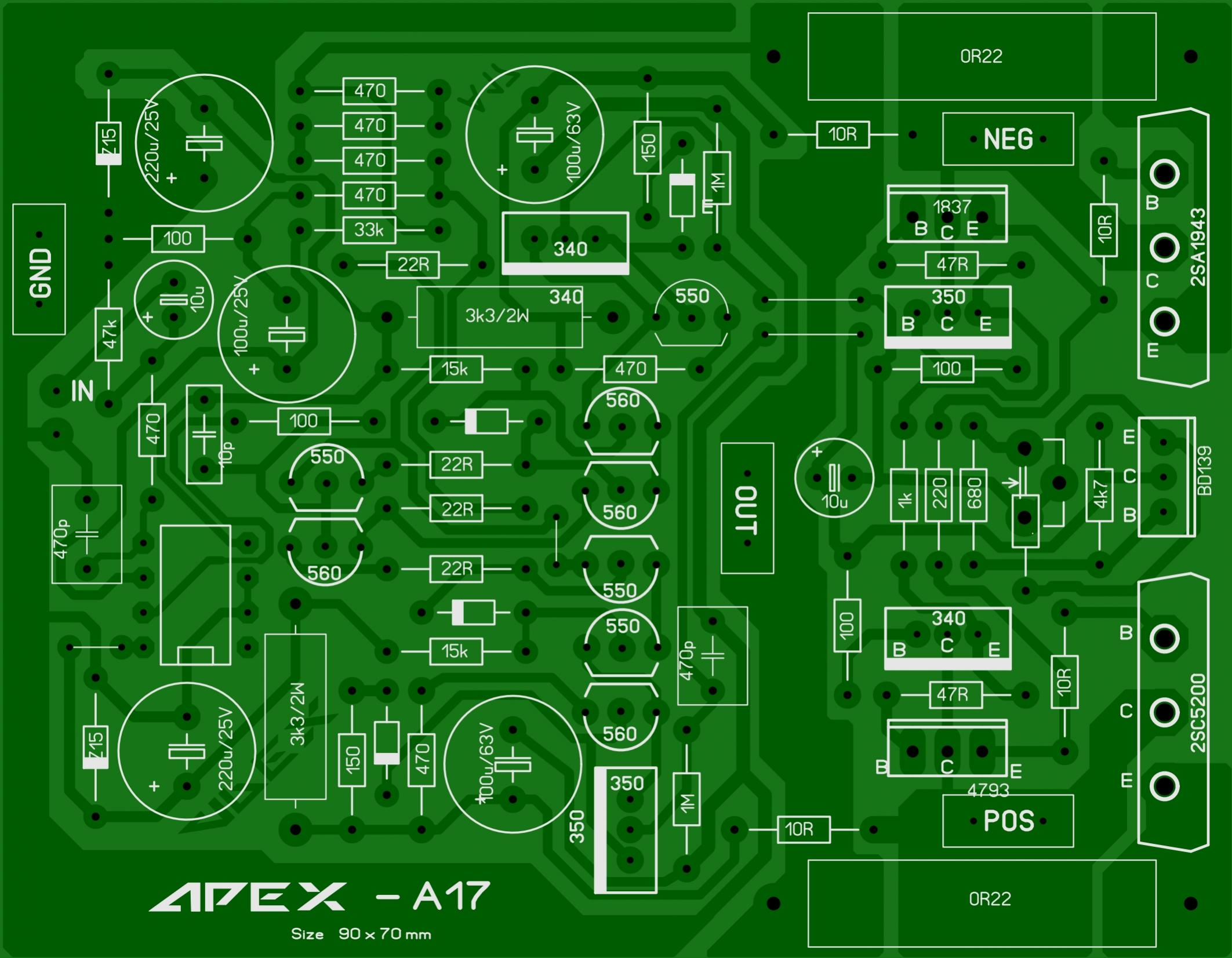

You should be fine using the parts number on the PCB they are the same as the schematic,
the input cap you don't really need a way too big cap there
and the reason I didn't make that cap "hifi sizes" is because it will make the PCB too big

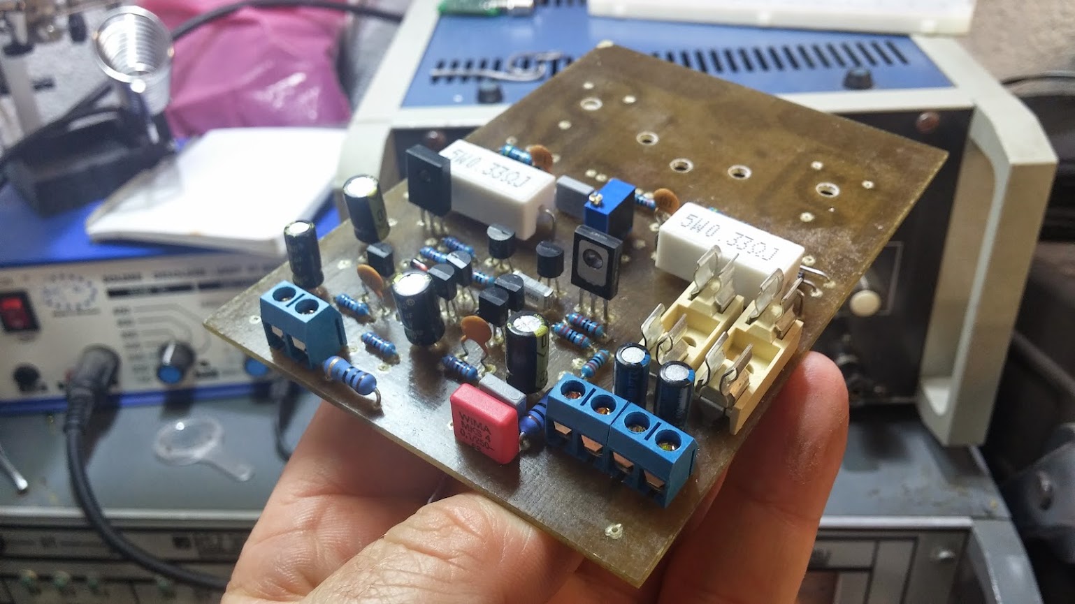

NE5532 is not good for A17 (bad offset) but 1,5mV is not so bad.
Hi, yes but was only one type I had at the moment.

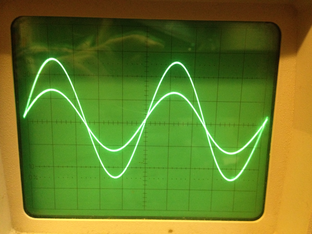

Here are a few photos and layout. The dimensions are 90x70mm.
The sinus is 0.5Vpp and 10Vpp at 20kHz. Operating voltage is + -36V DC. Bias is 50mA (all I could set with this setup), offset then is 4mV after 15 minutes when all is warm.

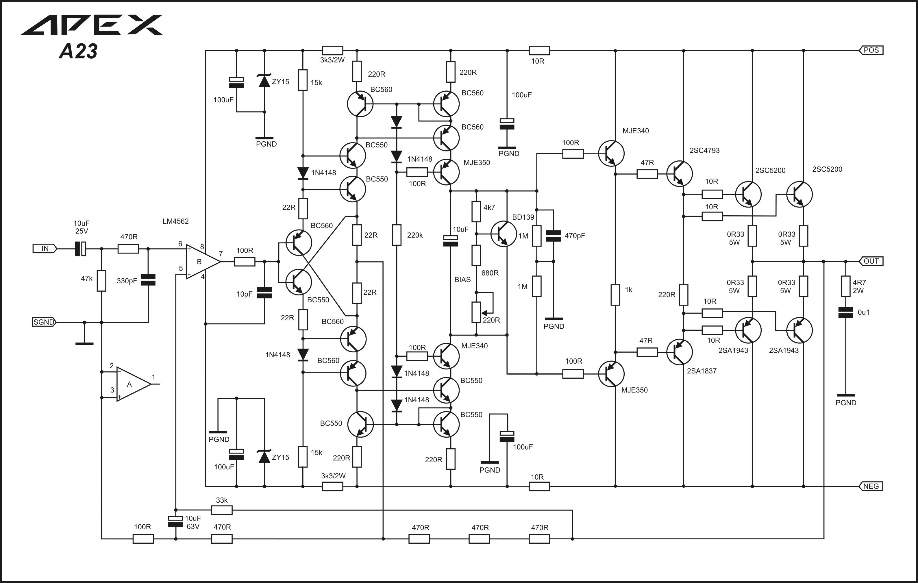

Nice new CFA amps, just on time on winter evenings to solder them !!

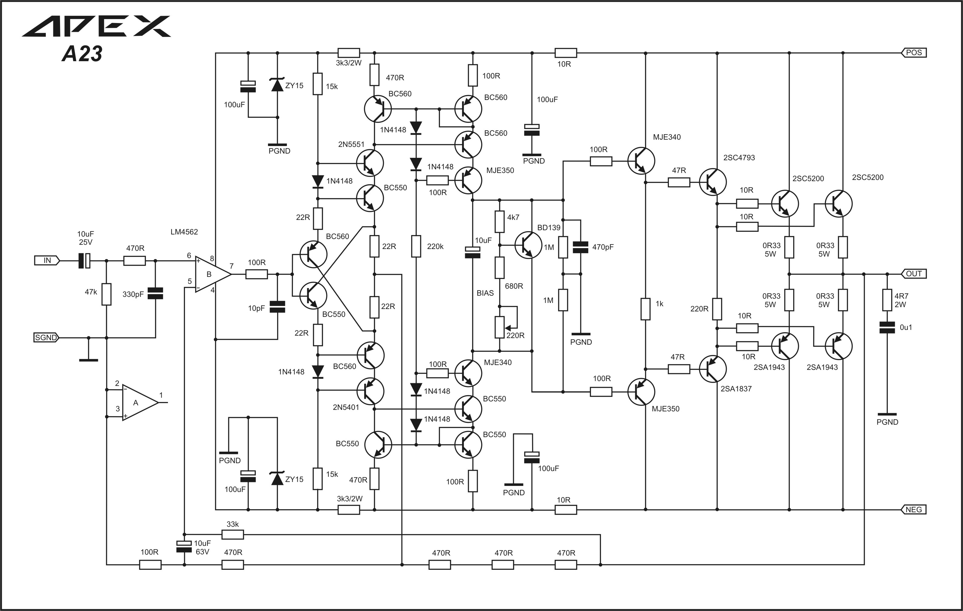

I have few questions, the A9 and AX9 they have 22R resitor at the NFB ground end, looks like it should be higher value to decrease gain a bit ??
The NFB is divided (A9) GND--22--470--1500--OUT,
what is the advantage of dividing NFB with middle 470R resistor (bit bigger part is injected into the second stage) ?
The marantz PM7001KI is using a jumper in this point.
The TL072 will be any good to start with ?? (I have only NE5552 and TL072 opamps in stock)

A9 and AX9 are simple CFA amps for use without preamp only volume pot on input, for AX17 there will be preamp... increase 22R to 47R or 100R to decrease gain.
Dividing NFB is for stability and some other reasons... with jumper in mid point OP work only as dc servo and ac buffer like in B500, use jumper with TL072 or NE5532.
