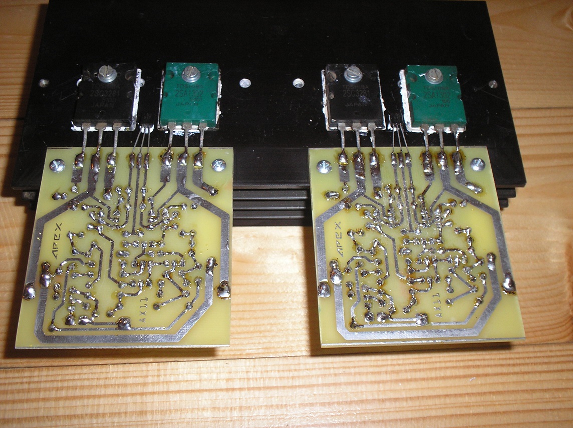

Here's my AX14TP, A big thanks goes to Juan for all the help without which I wouldn't have been able to do it !!
He sent me all the files (Gerbers) required for me to get the PCB done and also all the emails with pics and such, He's really great ! Unlike others who refuse to help when I request them,He was more than happy to help.
Anyways here's the pics of the PCB ( 70 Microns copper and Glass epoxy) :
Now the building phenomena begins !! Will post here if I need any help.

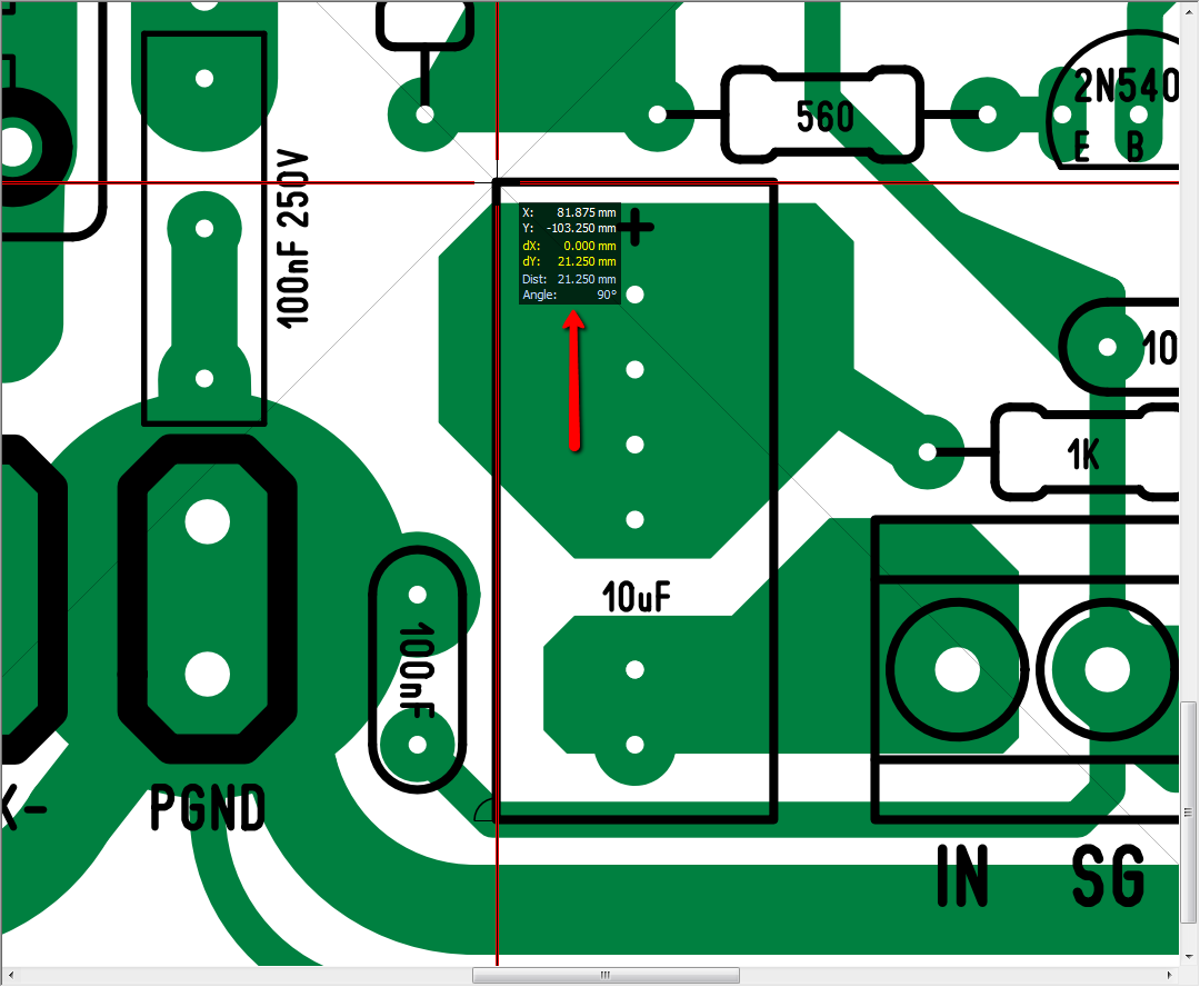

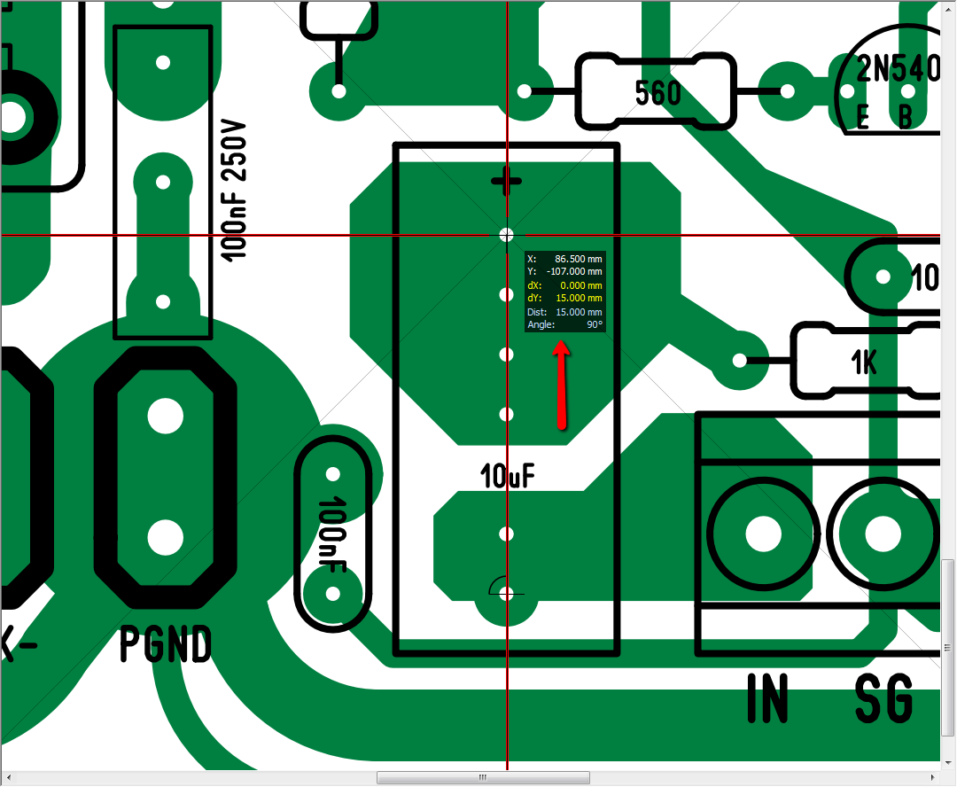

One Small doubt,the schematic has different components and the board has different,which one should I follow ? also the input cap value it says 10mfd is that correct ?? cause 10mfd input cap MKP or such will be huge and cannot be accommodated in the given space.
Plus the holes (pitch I guess) and such that you mentioned in the email,has it come out correctly ??
Regards.
Yes about the input I did use 10uF electrolytic and is fine with me, the maximum distance from lead to lead is 15 mm but can accommodated different sizes too. also the input cap you don't need a really large one the the maximum input signal is not going to be more than 1V example CD player, MP3's, iPods etc I mean is up to you what ever make you happy go for it 🙂
the maximum size cap the rectangular ones is about 21 mm x 10 mm

Thanks Juan for the reply,But what about the components ?? which should I use the one's on the board or the schematic ??
Well if you use the normal box caps (WIMA Etc),I guess its okay but I want to use as mentioned in the previous post the MKP or MKt type caps like this one below which surely wouldn't fit.
