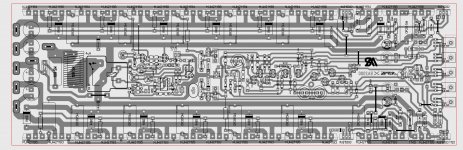

May I have a Apex B2000 pcb layout please?, gerber files, etc, anything please, thx in advance.
BA2000 pcb not tested
sir, please post copper side pdf tofor pcb so that we can make it.
Sir miles please post updated schematics of BA2000 thanks

hi friends please help. 90v + - dc and can i use 2sc5200 and 2sa1943?
may i suggest you to try BA1200 with 8 or 9 pairs at least you have extra. 0.47R 5w resistors can be used but you have to adjust bias accordingly. another is your PSU can be used also. but not that BA2000 it was not tested and i saw some mistakes on PCB design. several diyers tried this BA2000 but they dont make it as easy to work with this BA1200.
sam

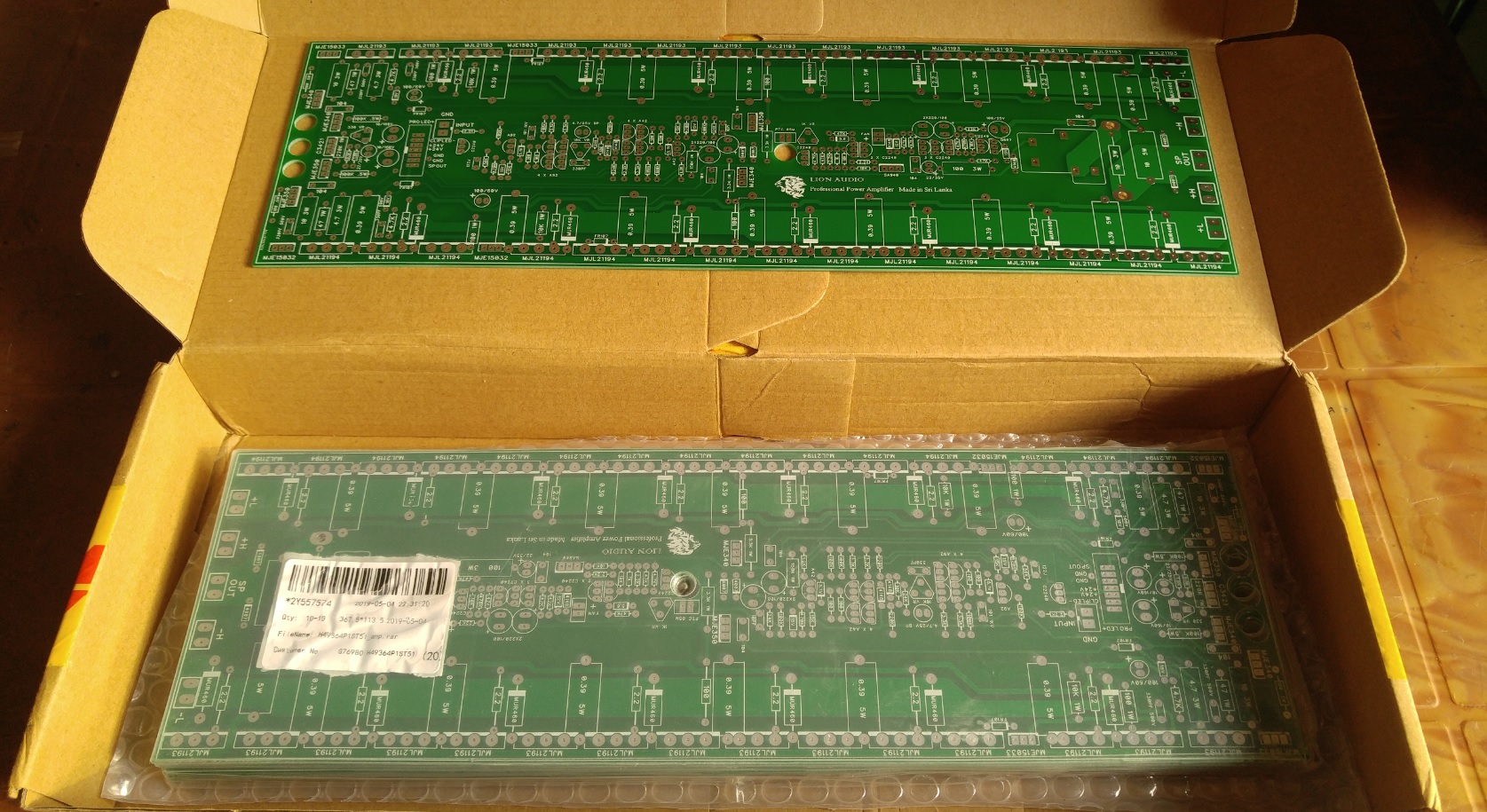

I have the BA2000 original amps PCB boards for sale. but double side.
If anyone need pls mail me shehanthapere@gmail.com
100% working and tested. Supper amp. if you build simply the pcb , ity wont work. Theres noise issues, so we need to follow the Original pcb design only
well that's a very good news why not share your experience since you're the first one DIYer who made successful BA2000, can you show us some snapshot of your boards? thanks

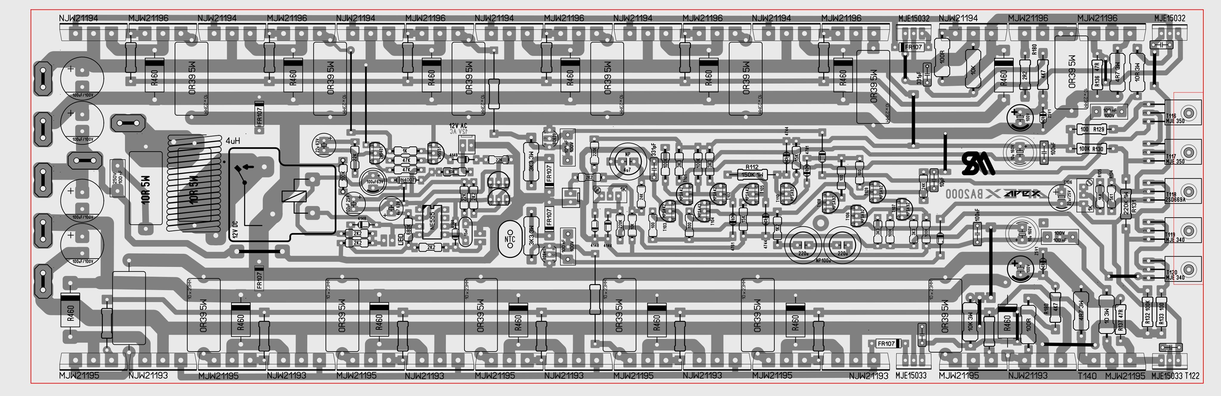

greetings sir RipX very nice pcb..do you have pdf file please share to us..thanks🙂
upon reading the whole thread i found out that the pcb that im asking is from sir wiljj78 design..im sorry sir wiljj78..my bad..
