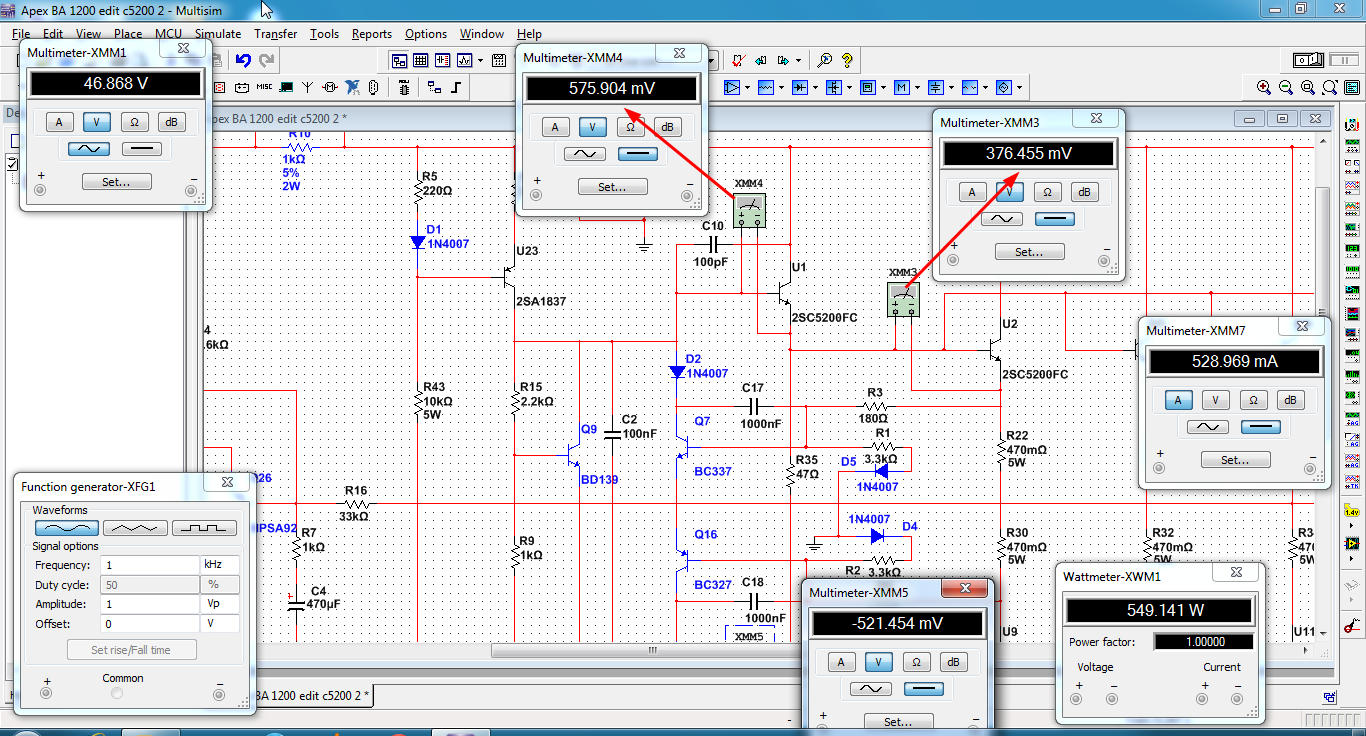

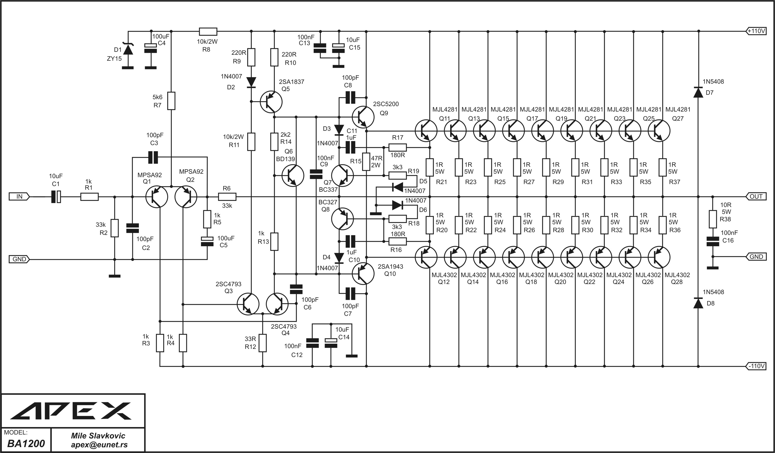

At the request of some friends, I share APEX simulation BA-1200
Apex BA 1200 - Download - 4shared
hi apex sir, how is this simulation?

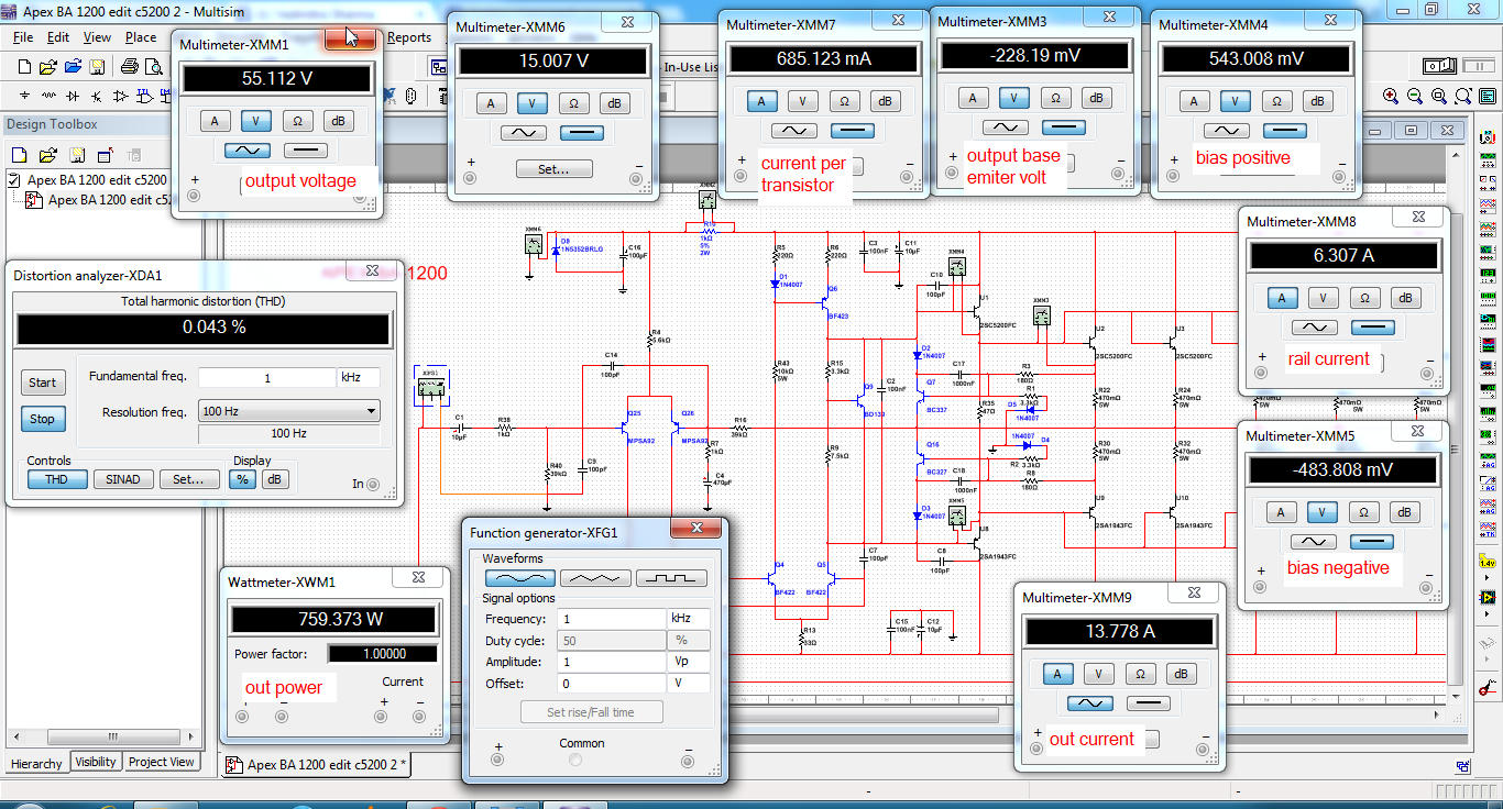

load 4 ohm.
55V output is 750W 4R load

hi apex sir,
i increase the 33k resistor to 43k and now power goes up, 900watts,
any suggestions?
You can reach the 900W output power if You keep the 33kohm resistor, and increase the input level....
The original desing has the gain, about 34, so You need approx 1,85Veff for 1000W/4ohm.
Sajti

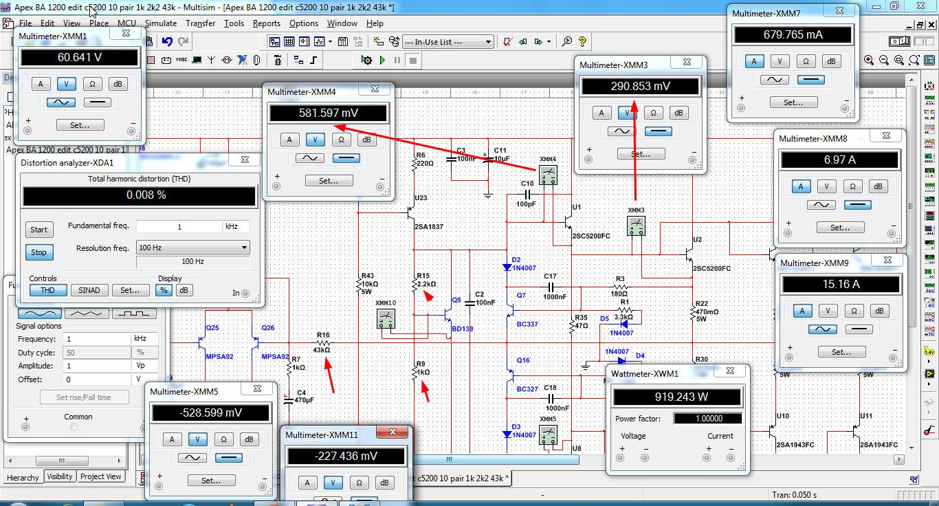

hi apex sir,
any suggestions?
You just increase gain not power, you can find maximum power with increase input level to the clip, output voltage without clip give you maximum output power.
Regards
nothing change, only 550watts/4ohm
There is the XFG-1 on Your picture. That gives the input of the amplifier, I guess. Increase the output level of this generator. It looks now 1Vpeak. Try to set 1.5Vpeak, and check the output power...
Sajti

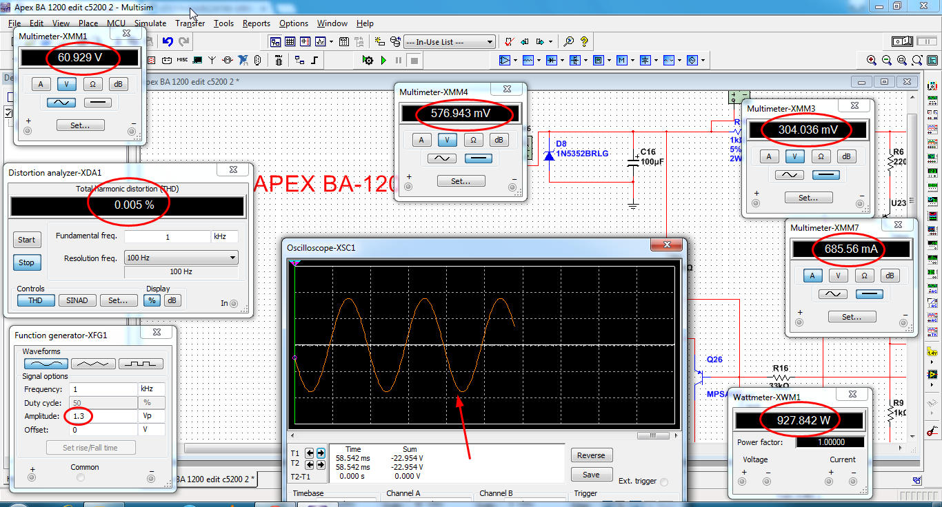

sajti, how many milliampere per output u recommend?
if You mean the bias, I wuold not go over 20-30mA.
Sajti
is it the bias is high in the image i posted.
685ma output bias per transistor,
685mA makes smoke in very short time....
Sajti
increase input to 1.3v,
now around 1000watts.
What is cliping level on your simulation?
