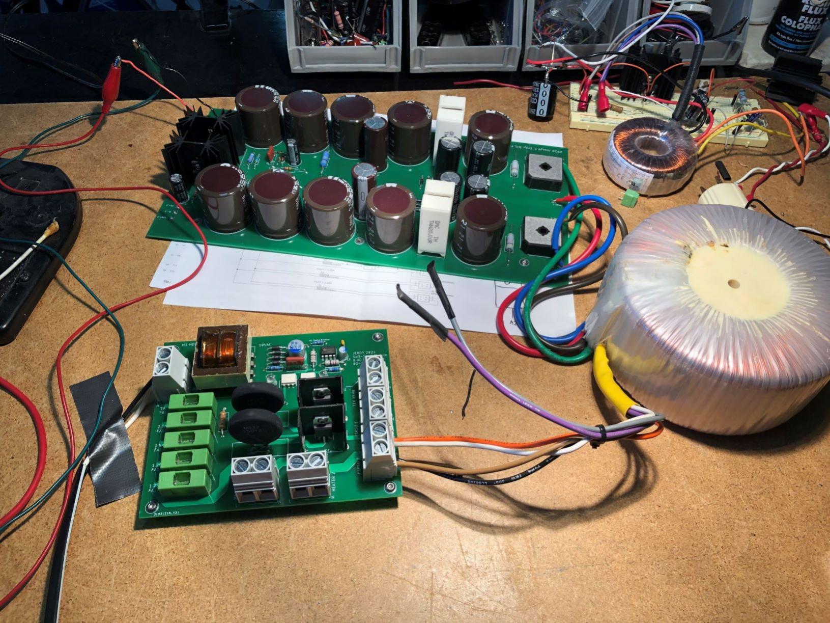

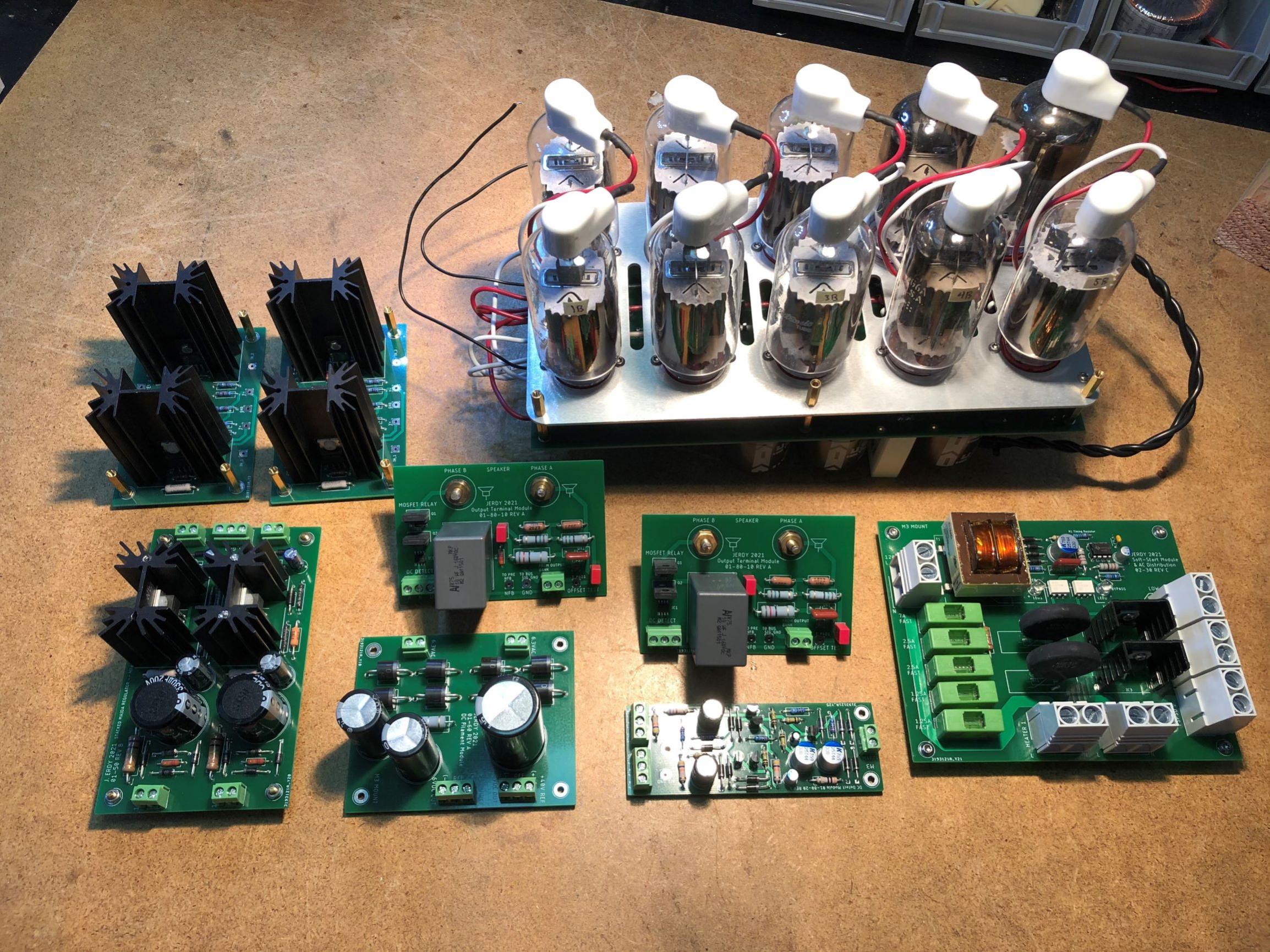

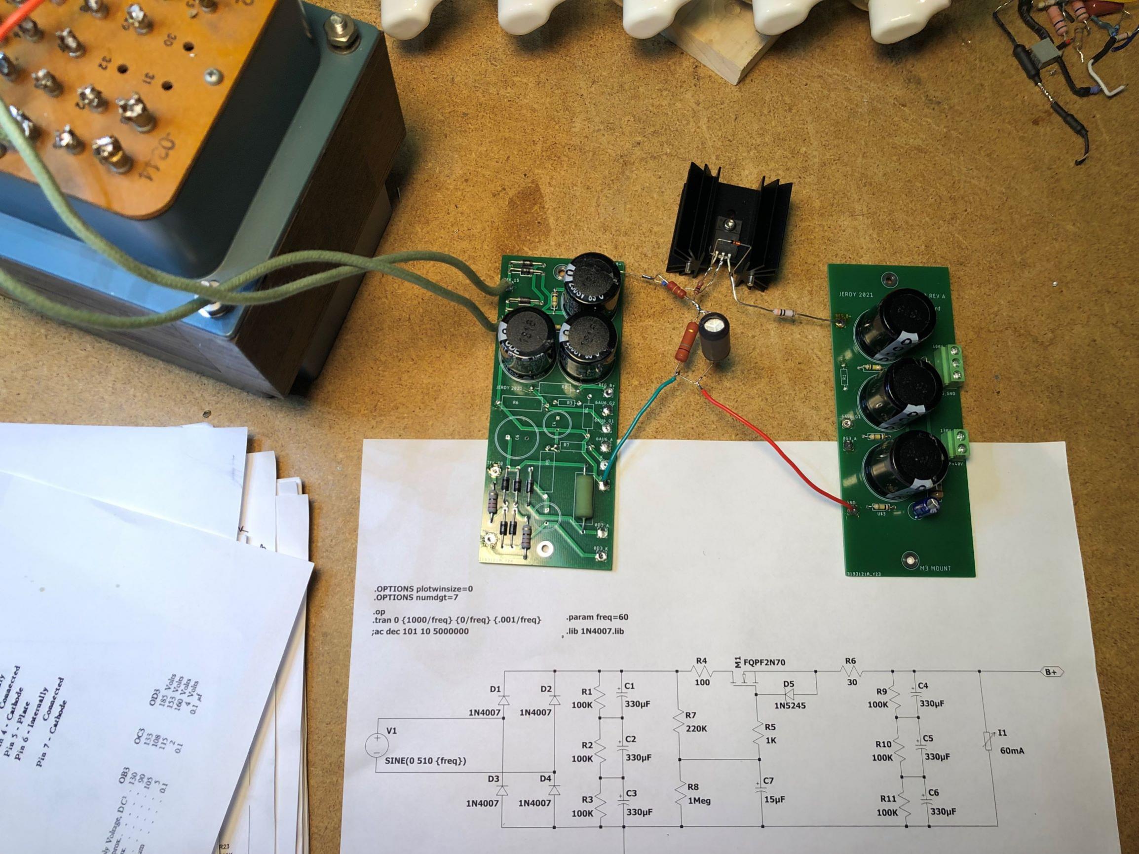

Progress Update: PCB assembly and Testing
As of this writing, almost all the PCBs required for one channel have been assembled.
The soft-start/fuse board has been tested with the completed floating output PSU and it successfully limits inrush when faced with the full capacitance on startup (2nd pic).

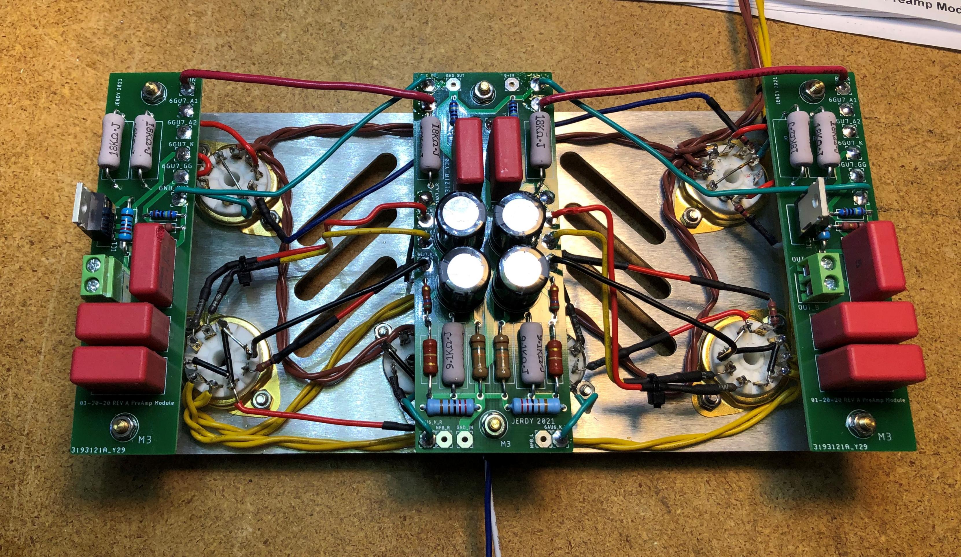

Third pic is the testing of the bipolar PSU comprised of two "stacked" Maida-style regulators (courtesy of Pete Millett). The positive and negative rails come out to +143V and -142V, respectively.

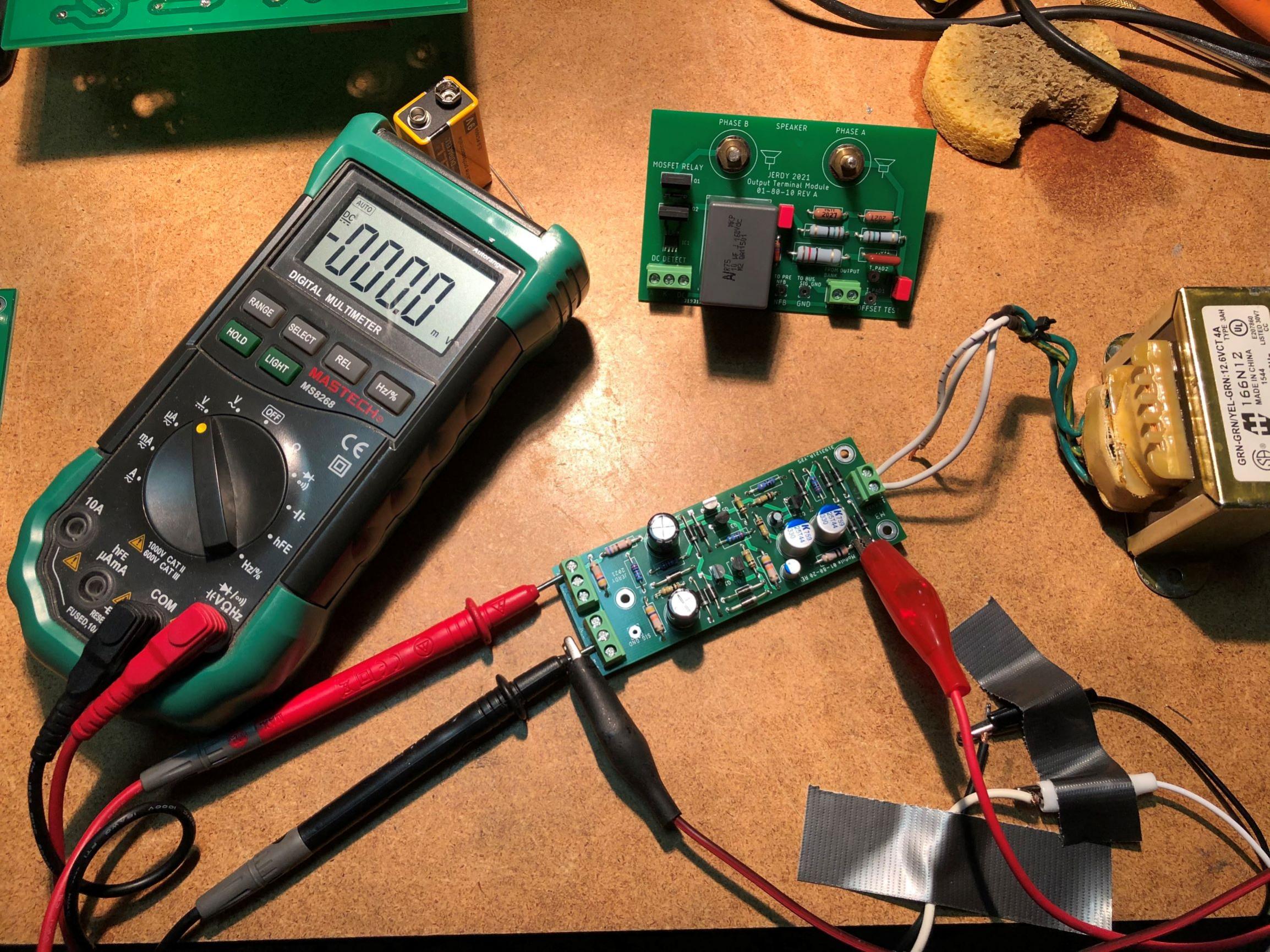

4th pic shows the DC offset detection board under test. A half-dead 9V battery on the input triggers the shutoff as designed. It is powered by 12.6V from the excess heater windings. There is only one board which monitors both output channels. It also provides a turn-on mute and AC-off mute for both.

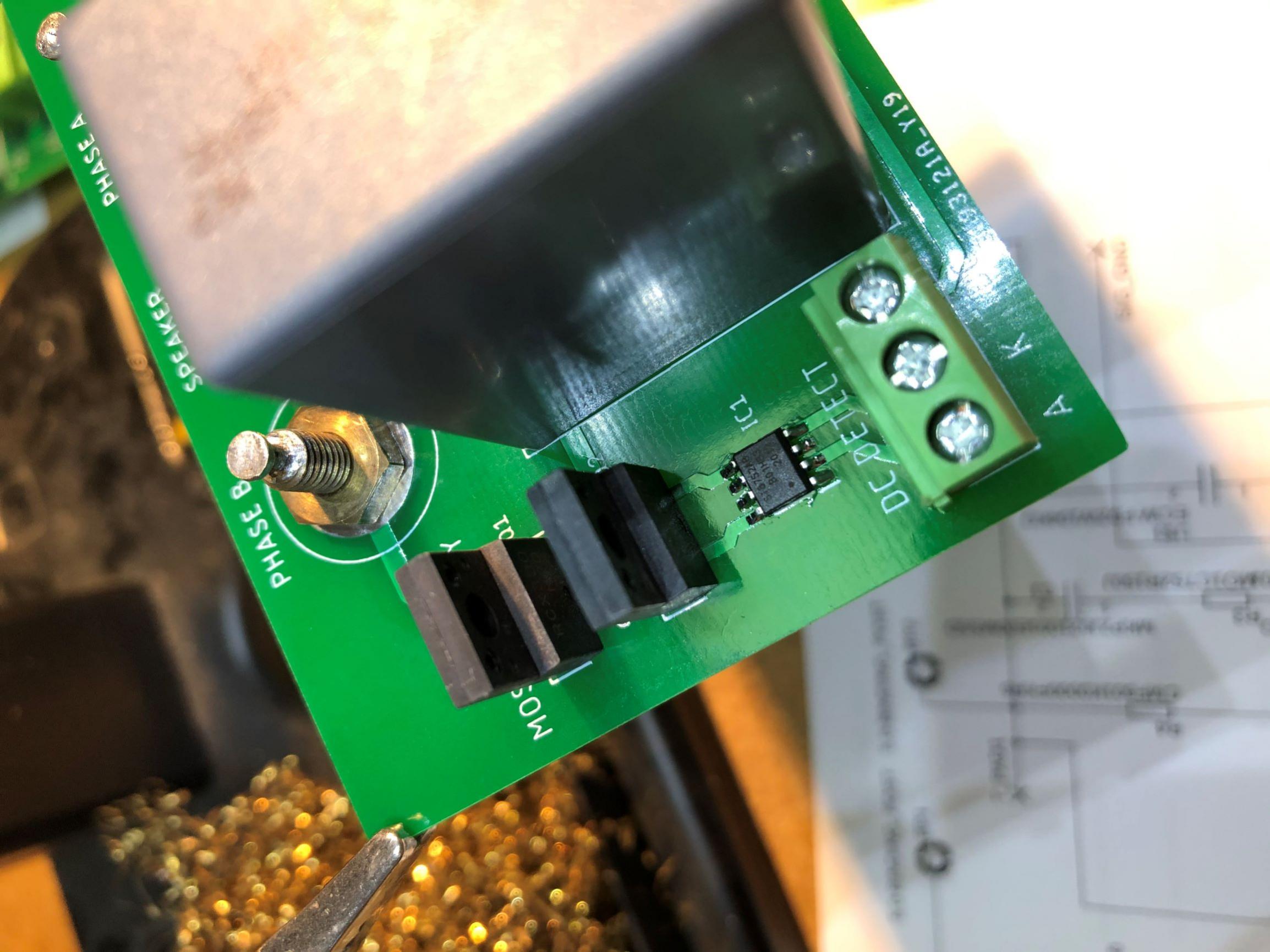

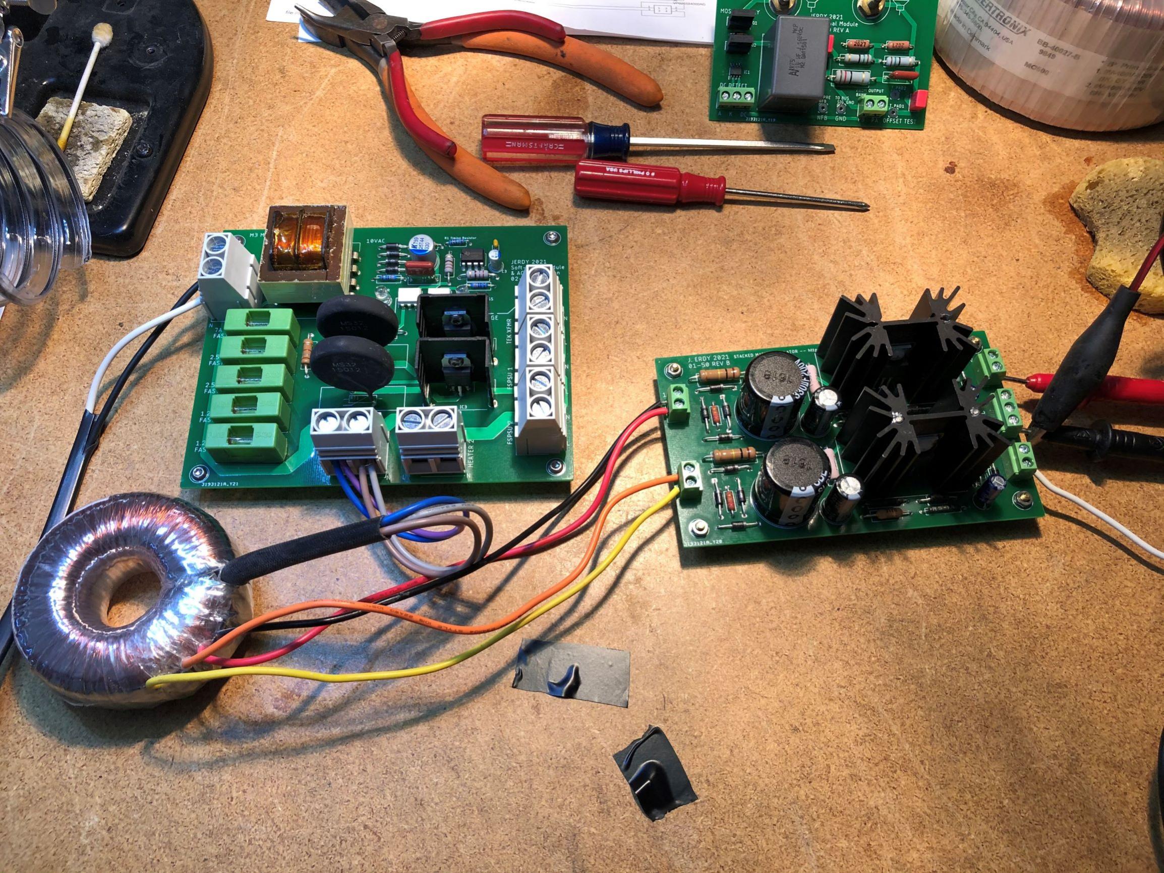

A closeup of the mosfet relay on the speaker output terminals is shown in pic 5. the tiny si7852 mosfet driver is the smallest component I've ever had to solder, but I managed to keep it pretty clean.
Pics 6 & 7 show rev C of the floating output PSU board in it's near-final assembly state. This was the board I ended up having redone due to significant suggestions made earlier in this thread. I also gained a lot of experience with board layouts since the first revision, so I was able to shrink the size down considerably.

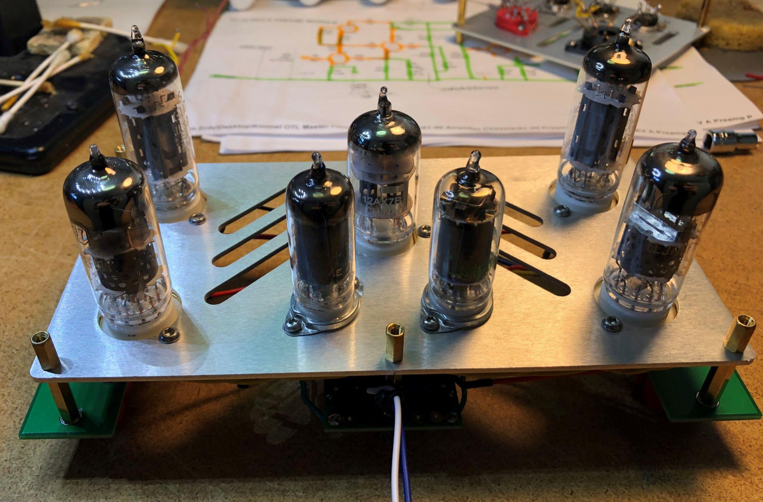

Last two pics show the completed preamp module. It's an odd mix of point-to-point and PCBs. The end result is still a lot cleaner than a completely p-t-p style. I will test it as soon as I finish the HV reg module, which now remains the last module that I need to complete.

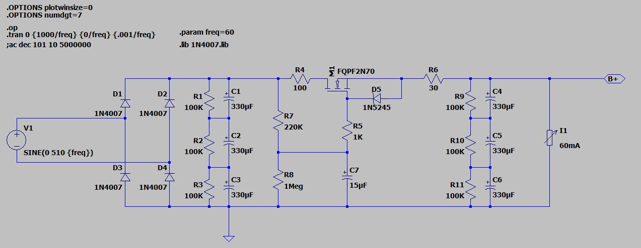

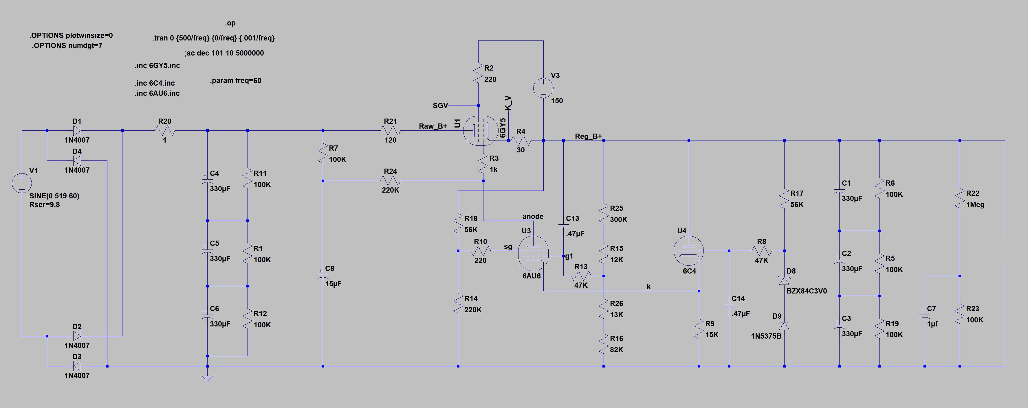

As the title indicates, I have been having trouble getting the 400V regulated supply to behave as expected. In short, there is a disconnect from LTSpice sims to prototype to final. I've been chasing down errors and making adjustments on the bench but I just can't get it match up with the sims.
I have attached the LTSpice files below, but I am prepared to abandon the design in favor of a more compact solid-state solution. The design is old, predicated on work I did (and thought I vetted) years ago when I was far less experienced. It's quite likely I overlooked some serious errors and even the performance I thought I was getting in the prototype was coincidental. At this point I am poised to cut my losses and redesign something safer, simpler, and more efficient.
The problem, near as I can discern, seems to be coming from biasing of the 6AU6. I can't find the adjustment point that draws enough current to lower the 6GY5 control grid to the ~370V required for 400V output while maintaining equilibrium with the other circuit elements. The output voltage is only 10V below the input and excessive screen current is drawn on the pass tube. The VR tube used is 85Vref, which I suspect may be too low relative to the desired output, causing issues with control tubes' voltage, current and biasing. Also possible is I'm using bad tubes and just don't know it. Most of my radio tubes were acquired in unknown condition. However, swapping among multiple 6AU6s changes nothing.
Any input is welcome, especially on suggestions for new HV regulated supply circuit designs.

Well, that's the point. How much current does the pass tube allow at a plate voltage of just 10 V? At which screen voltage? You'd feel better with a SS design in this instance.
Best regards!
10va-k is the failure condition. Sims modeled 70-100V across the tube, which should have been within spec. Moot point since it’s not working. Solid state is where I’m heading.

A 6AU6 has a lot of gain and is capable of acting as an opamp entirely on its own. You don't need that extra tube for starters. I don't think you need to abandon the board but some mods could be executed. If this were mine I'd be taking advantage of the gain of the 6AU6 (assuming you don't have cathode/filament arcing issues).
You could run a zener stack in the cathode circuit of the 6AU6 and use a divider network to feed the grid; in this way you could have some feedback gain to more tightly control the output voltage.

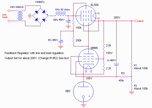

From what you describe, I'm picturing something similar to this circuit: (attached).
I can certainly pare my current circuit down by using just the 6AU6 and VR tube. I will mess around with some sims then try it on the bench. Thanks for the helpful suggestions.

Although they look nice I wouldn't use a VR tube; IME they make noise and you need low noise on the cathode. I'd use a zener stack bypassed by a capacitance. Don't run them too hot.
I recognize that schematic, Pete Millett’s engineer’s amp. I have borrowed that design before. I have a few more tricks to try on the tube regulator, but I do like the simplicity of the capacitance multiplier.

It's been a few weeks since I worked on the PSU issue due to some hectic life circumstances, but I finally got a chance today to completely redo the regulator topology. And it didn't work...
At this point I'm ready to scrap the tube-based design. I'm not sure if my sim models are way off or I'm using bad tubes. Either way, I have no confidence in the design from this point forward so I'm going full solid state. I plan to shamelessly copy Pete Millett's DCPP PSU design. It's simple, I have the parts on-hand, and I know it works well so I will let that be then end of it.
Attached is the LTspice schem capture for reference. I've been waylaid by this particular module for too long and I'm itching to get back on track. I appreciate the suggestions, and I'm just a tad disappointed I couldn't fix the original design.
