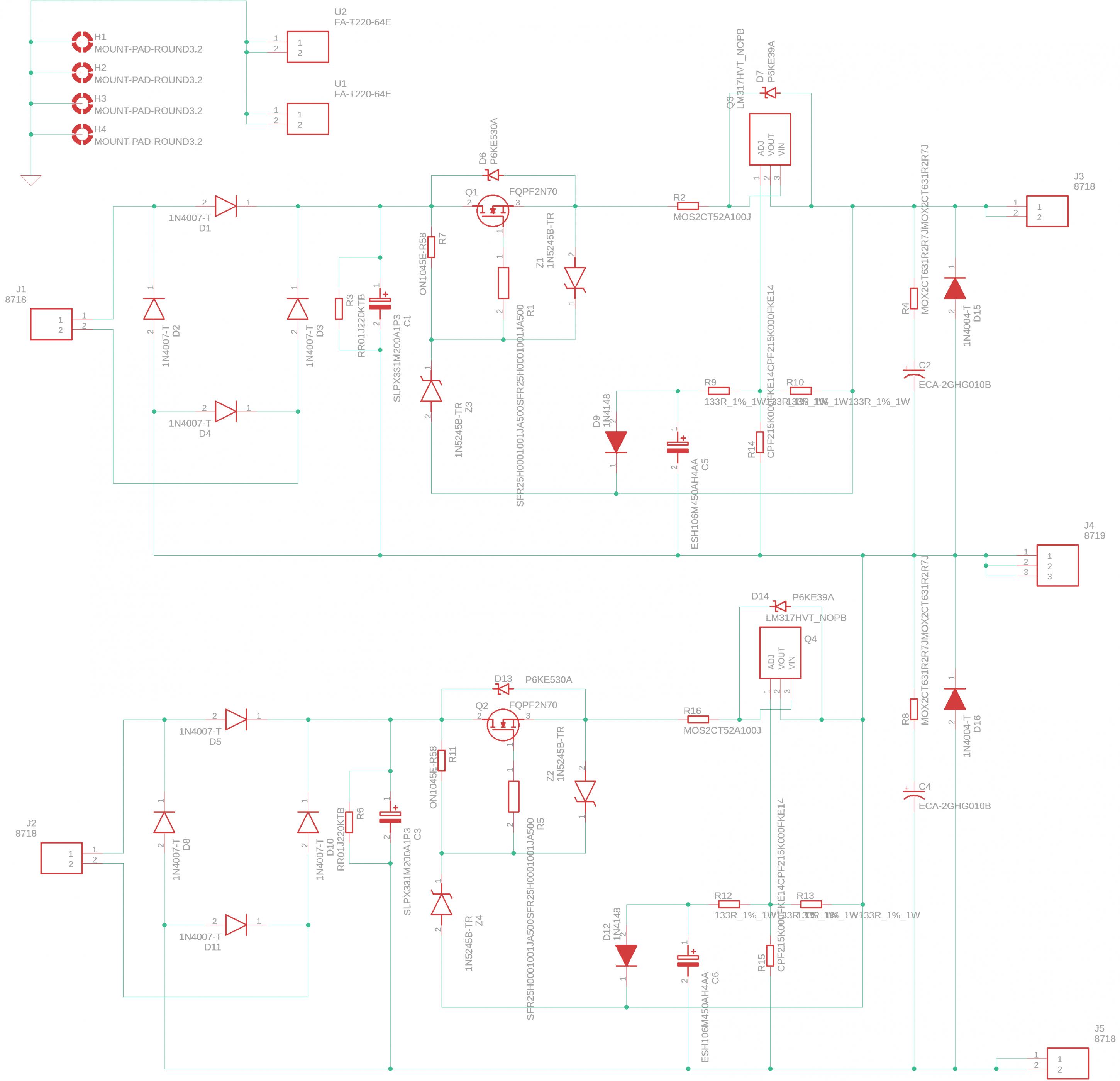

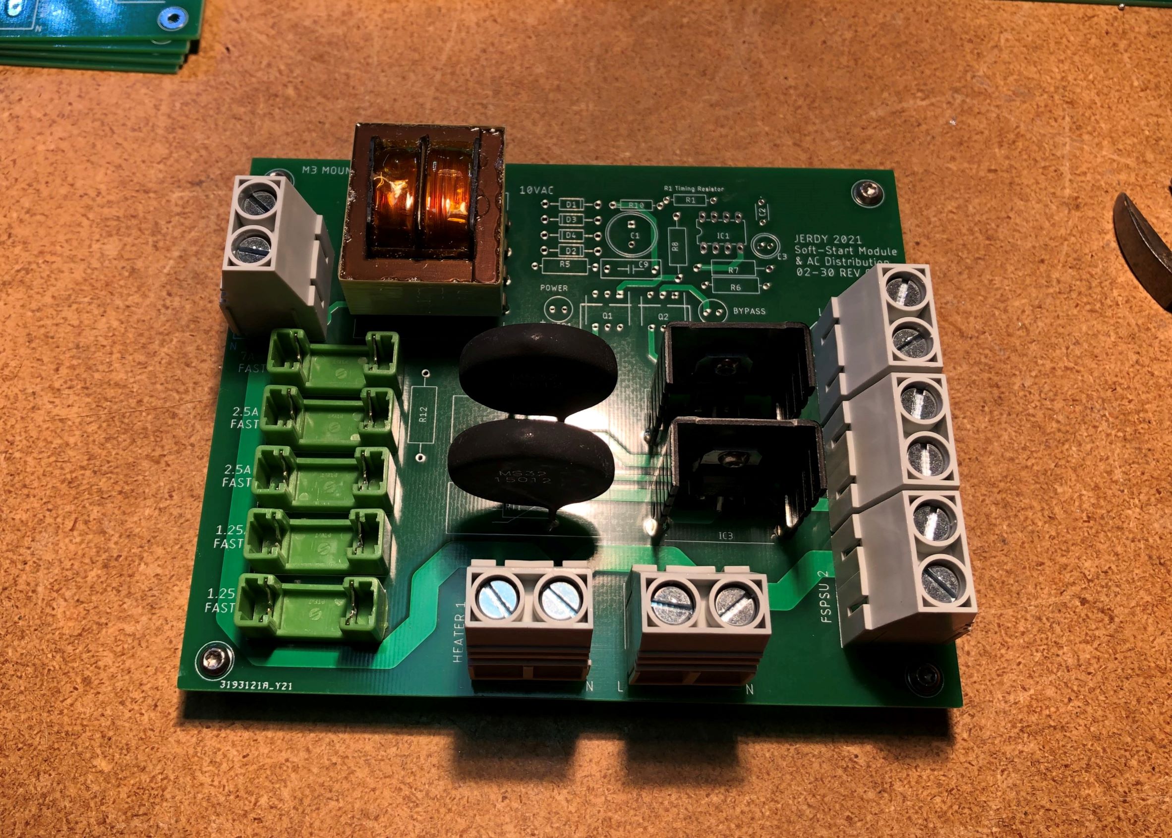

Soft-Start and Bipolar PSU boards nearly complete
After taking some time to evaluate necessary safety measures, I'm in closing in on a final design for the soft start circuit + AC distribution board. It contains the soft start delay circuit, primary fuses, and terminal blocks to connect to all the transformers. The circuit uses an NE555P timer to bypass surge-limiting thermistors with an optocoupler-controlled TRIAC. The timer circuit is run independently with its own transformer, and has a bypass delay of ~250ms.
Before submitting the order for the PCB I will test the soft start circuit to make sure it performs the same as the simulations.

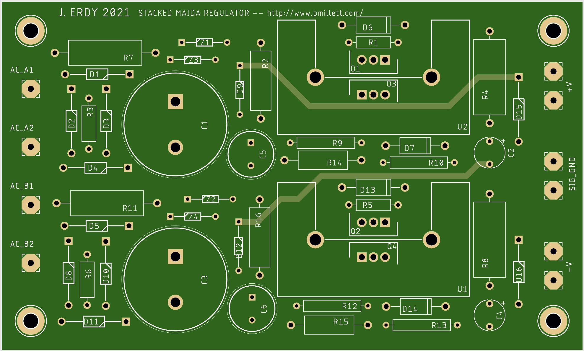

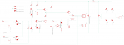

I also finished testing the maida-style regulator for the bipolar 150V supply, and confirmed that it behaves as designed. I will submit the PCB order once the soft start board is also confirmed.

As I revisit and revamp each module, I am getting closer to completing the comprehensive schematic. I will post it soon once I polish up the remaining modules.

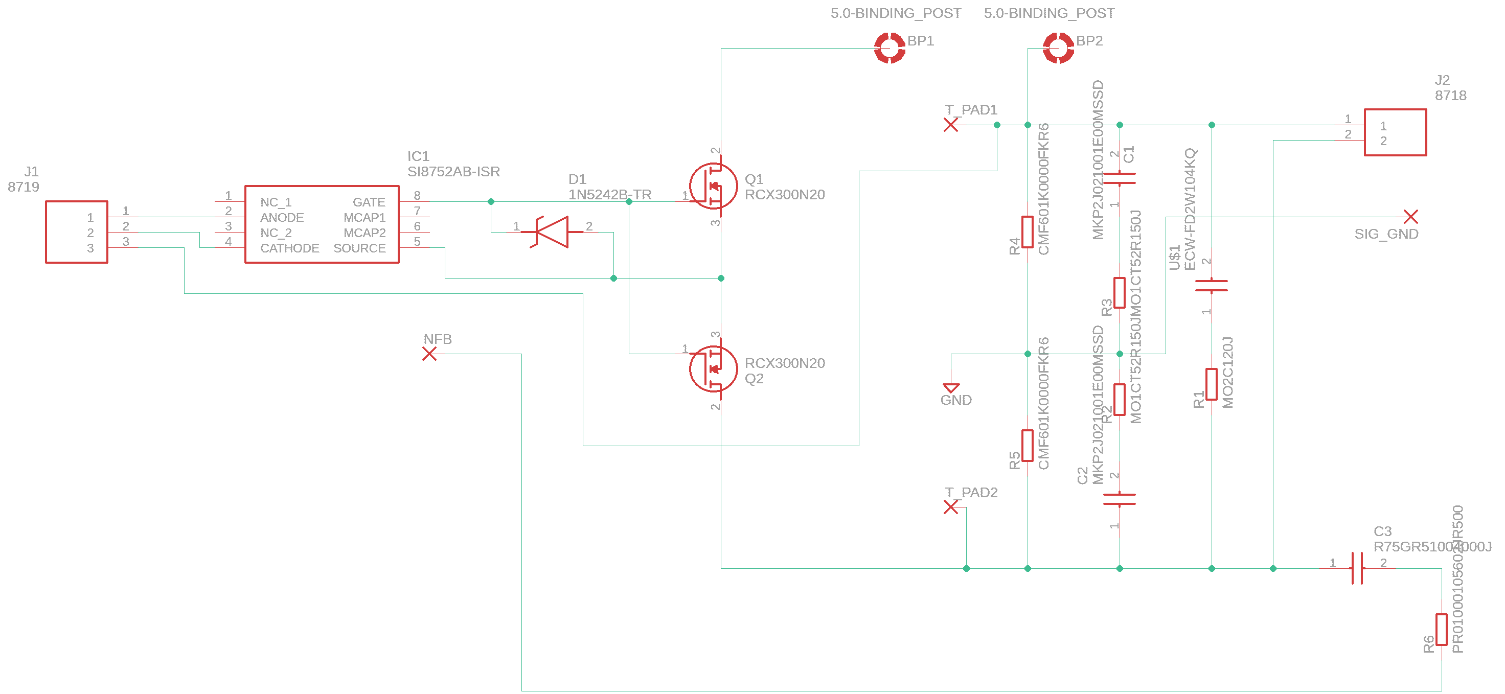

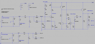

Speaker Protection Circuit
After some research and tinkering I decided it would be more fun to attempt to build the speaker protection circuit instead of buying a module off eBay. Borrowing from some existing designs and substituting some changes of my own, I have a circuit that seems to simulate correctly.
The circuit features DC offset detection down to 1.55V, which is enough to detect a significant imbalance (the loss of multiple tubes or an entire phase) and swiftly remove the speakers. Any higher voltages result in even faster turn-off characteristics. AC is passed down to 5Hz at full power without triggering.
There is also a turn-on delay and AC power-off mute function built in.
The relay is a pair of source-connected mosfets controlled by an isolated diode emulator, the Si8752. There will be one solid-state relay per channel, both controlled from the single detection circuit.
Still waiting on my parts from the other modules to come in so I can test the current designs before ordering the PCBs.
Inrush current limiter and fuse test
Got the parts for my soft start circuit and did some quick bench tests. I hooked up a completed output module board to the 500VA isolation toroid and put the 15R/12A Thermistor and 2.5A fast fuse in series with the hot side of the primary. This configuration is representative of the turn-on condition for one output channel.
The thermistor worked perfectly and the 2.5A fuse didn’t blow. Without inrush limiting the toroid would normally pull more than 40A peak. I monitored the voltage drop across the thermistor during inrush and it dropped to about 1V after 5 seconds or so. The thermistor is rated for continuous operation, and would do its job fine if the triac fails. It’s still safer long-term to bypass it and let it cool down in between startups.
At maximum continuous power output I expect each output power toroid to pull at most 2.25A RMS on the primary side, so the fast blow fuse of 2.5A should give enough headroom while also keeping the response fast in a failure situation.
I appreciate the advice from this thread a lot. It’s definitely elevated this project beyond what it might have been otherwise.

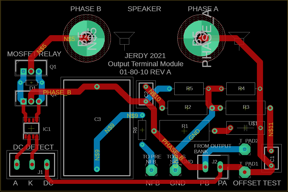

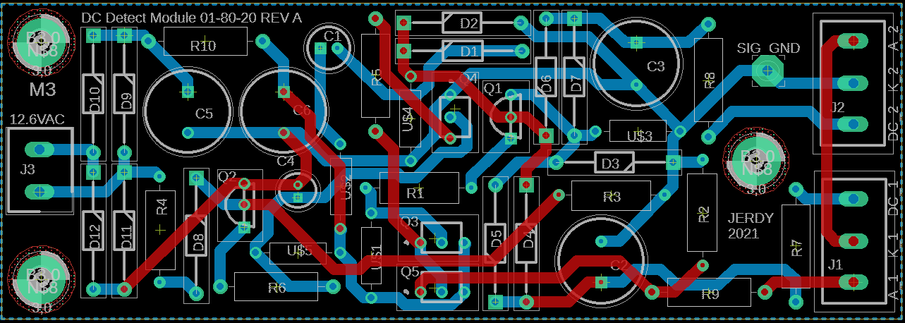

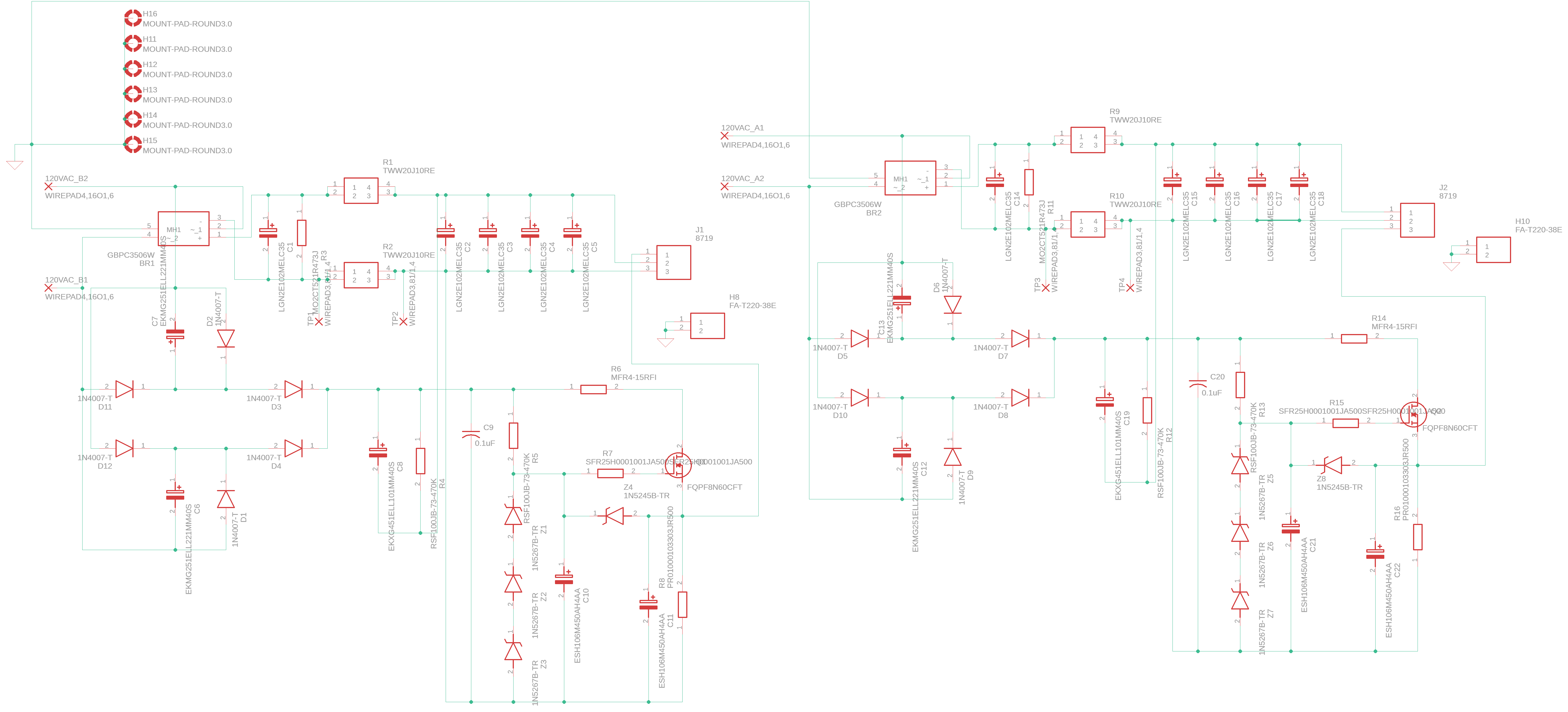

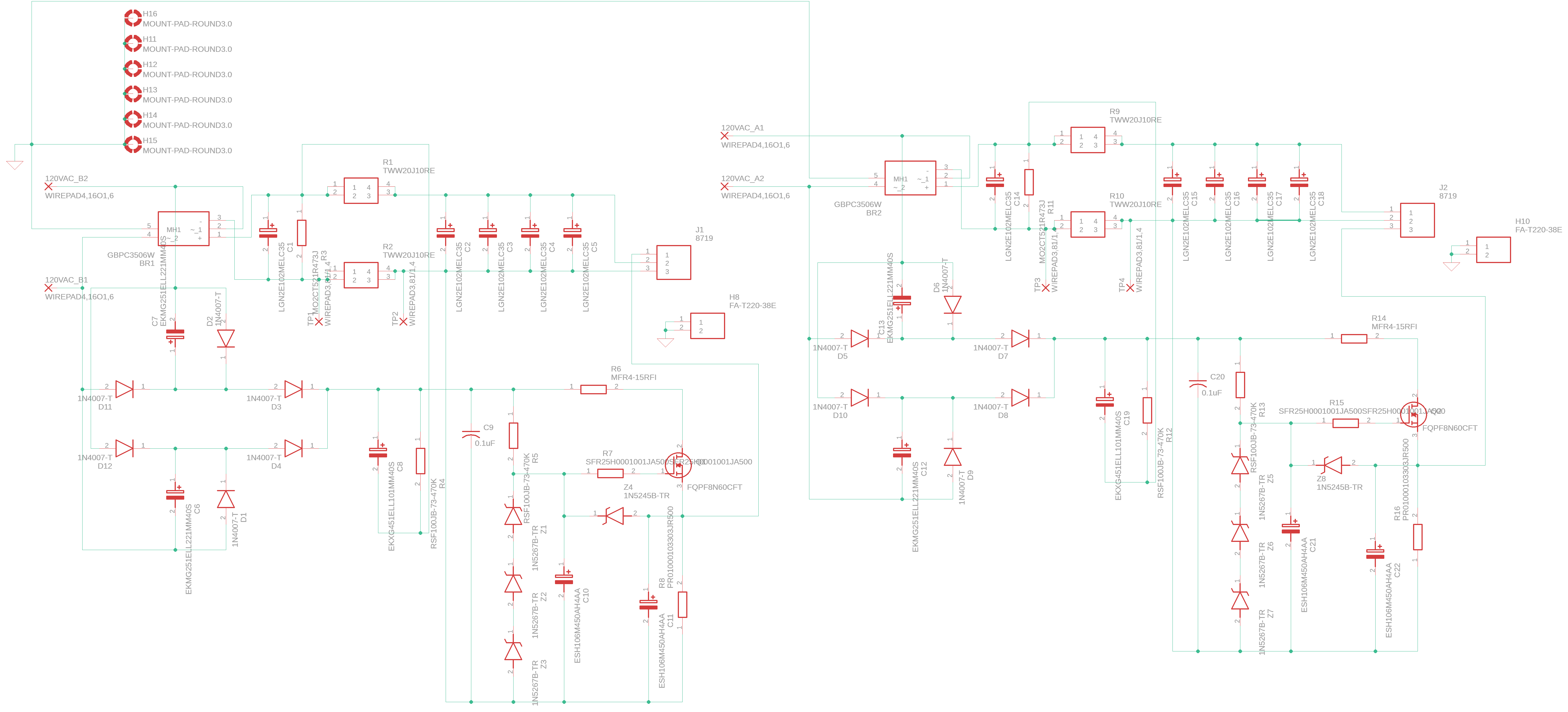

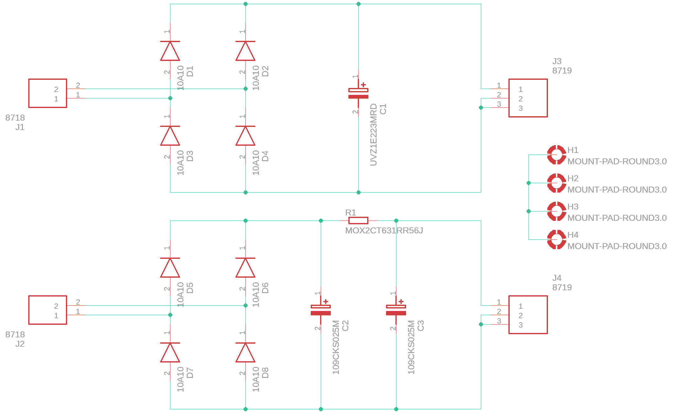

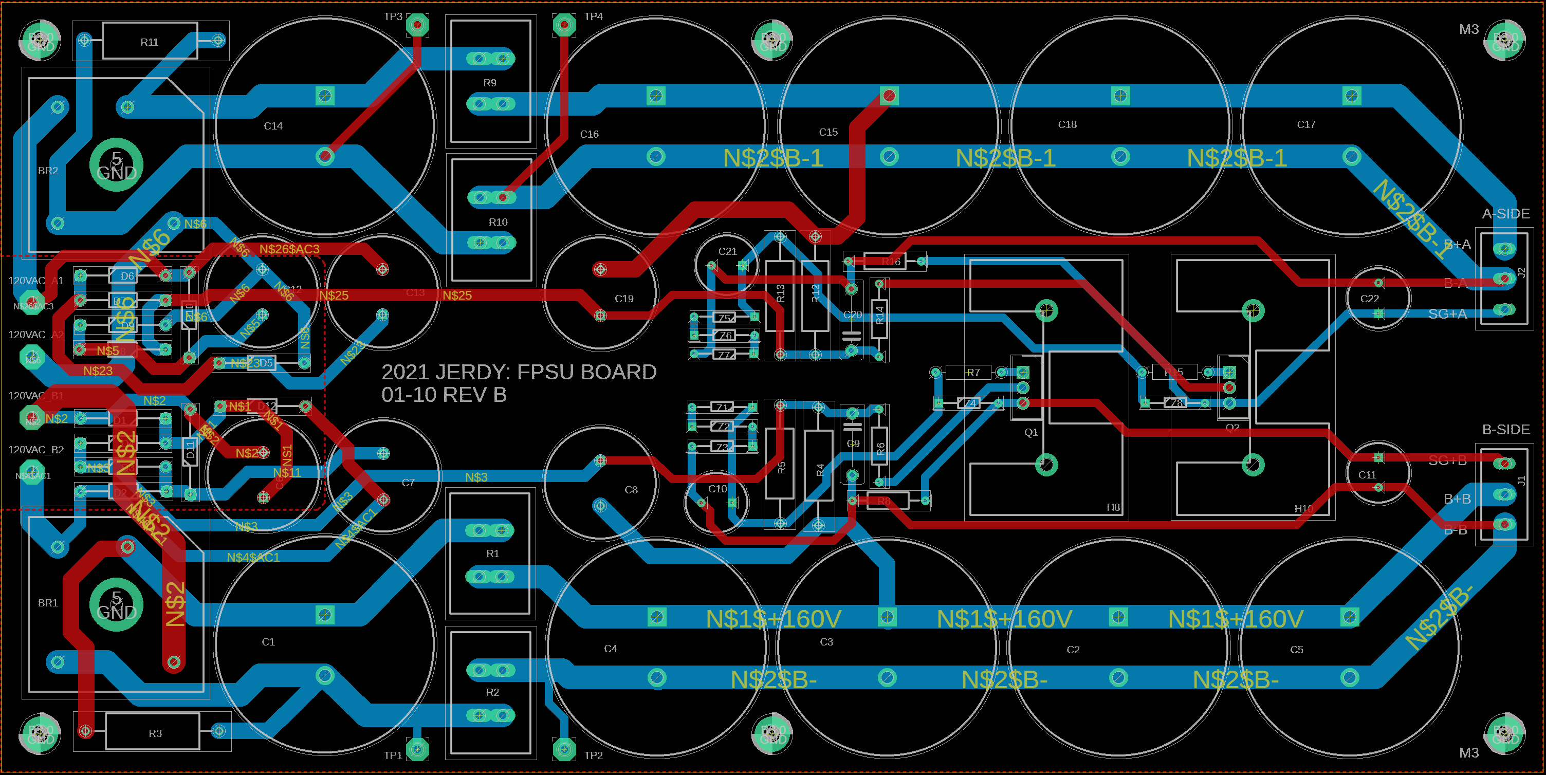

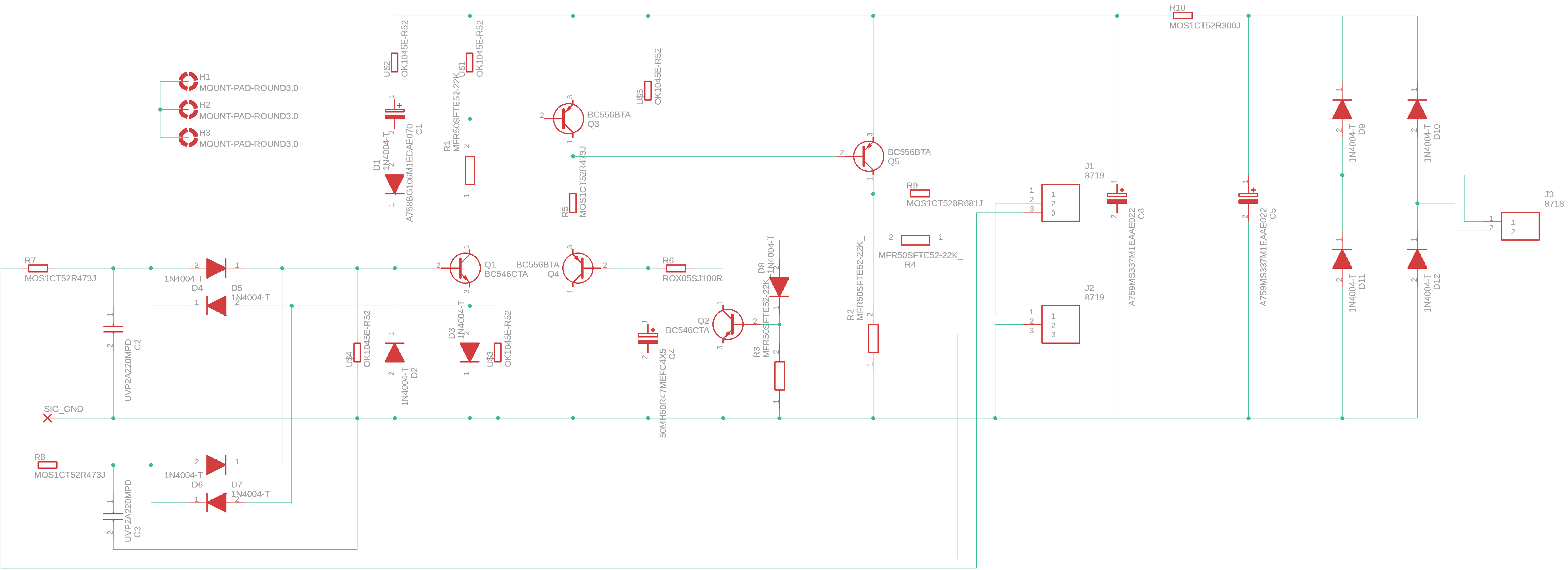

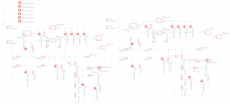

Schematics for PCB mostly finalized
I've been taking my time with the PCB designs, making double sure that I don't overlook any stupid mistakes before I fab them. Currently I have 5 PCBs that will be going into the amplifier chassis (designated as 01-), and one into the power supply chassis (designated 02-):
I will probably sit on the designs for another day or two before ordering, might make a few more tweaks. I've attached below images of the amplifier chassis EAGLE boards and schematics. They are all two-layer boards that I will be sending to JLCPCB.
- 01-10 REV B Output Module: this is the power supply for the output tube bank.
- 01-50 REV B Bipolar PSU Module: the +/- 150V volt supply for the bias and A2 driver board
- 01-60 REV A DC Filament Module: the preamp is high gain, and I was getting noise in the prototype and DC filaments are an easy addition
- 01-80-10 REV A Output Terminal Module: Connects directly to the speaker binding posts. Has hookups for output, NFB, and DC offset detection.
- 01-80-20 REV A DC Detect Module: DC offset sensing and protection trigger circuit. This will activate a SSR to disconnect the speakers if there is any significant DC imbalance.
Jerdy, I'm not sure about the connection to C8/C19 as that cap takes rectifier pulses that have to pass back through C1/C14 and the big bridge, whereas you have the rectification current pulses going to the next RC filter stage (eg after R1/R2 and R9/R10) - same goes for R4/R12 bleeds.
I see what you mean. Some spice simulations show that moving the negative terminal of the doubler supply cap and bleed resistor to the first filter cap keeps the charging current from running through the 10R resistor. Not a huge impact, but would reduce voltage ripple and improve current balance between the two 10R resistors. I have incorporated this change into REV C.
PCBs Ordered
Well, I pulled the trigger on the PCBs. 10 in total, which represents all the remaining modules (plus one redo). Prototyping and verifying the new modules was the slowest part, but things accelerated once I started on the previously vetted circuitry. As soon as JLCPCB finishes my order, things are really going to start moving.

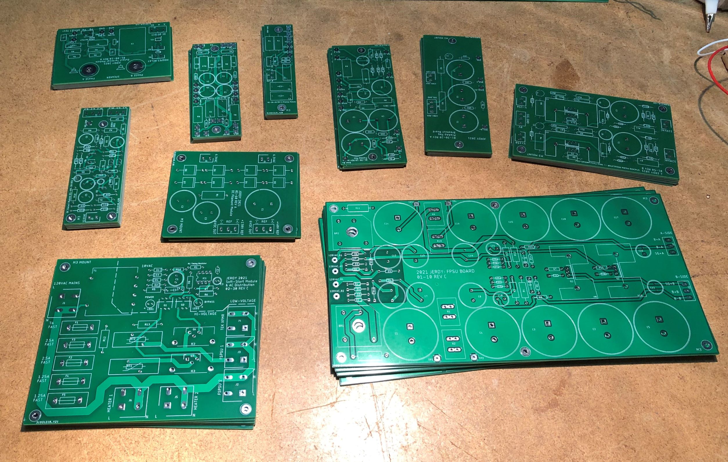

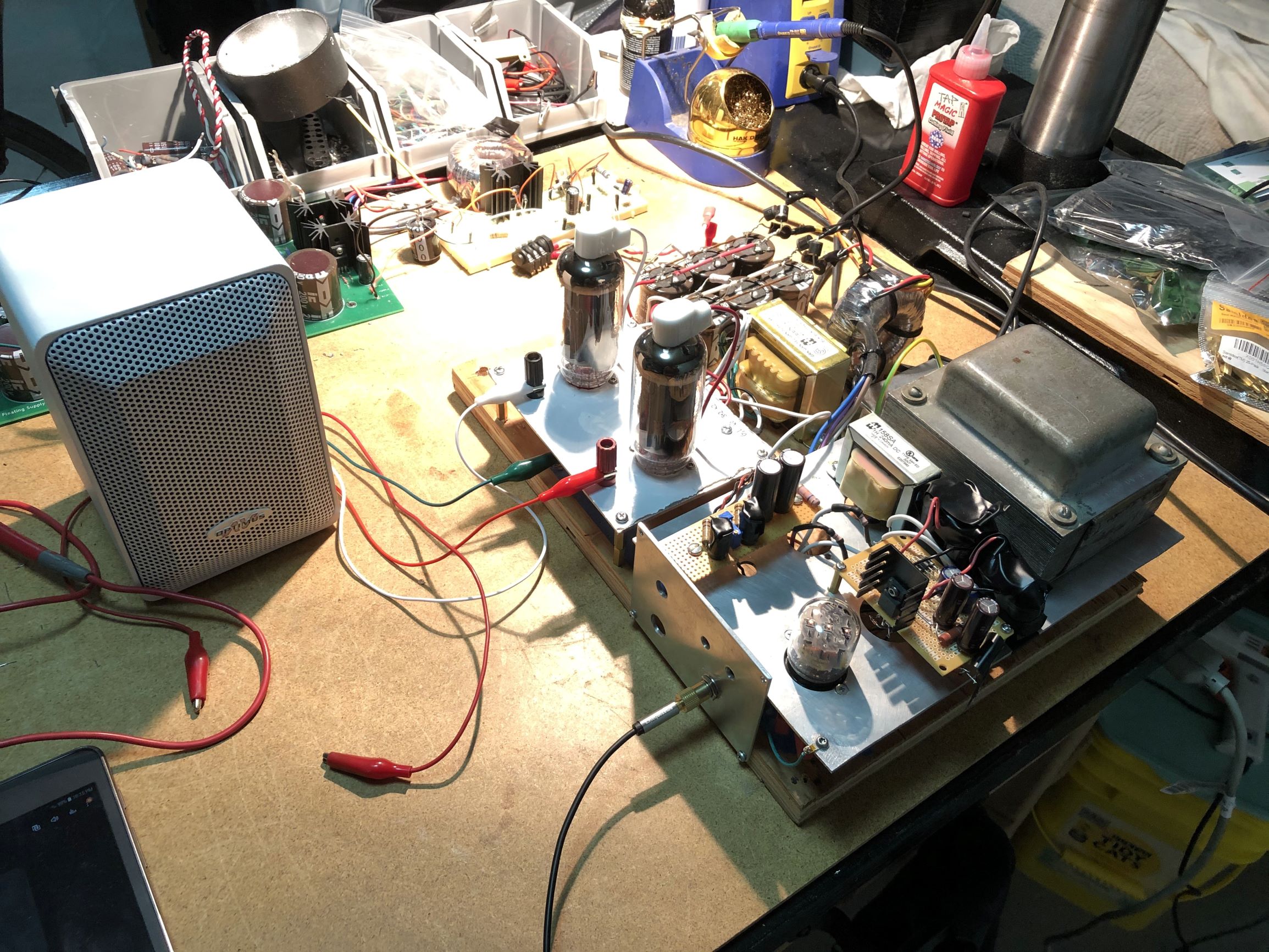

PCBs Arrive, assembly begins
The boards arrived today, much quicker than I anticipated. There are 10 modules in total, so I have a lot of work ahead of me. I got a start this evening on the soft-start module, and I did some dry fitting of the breakout boards for the preamp audio section and preamp PSU.
Originally, when this project was conceived 3 years ago I assumed I would do point-to-point wiring on the tube sections since all my sockets on-hand were solder lug terminated. However, once I learned how to design PCBs in EAGLE that plan changed. Now I've migrated most of the components onto breakout boards that can interface with the tube sockets. Next time I'm just going straight for PCB tube sockets...

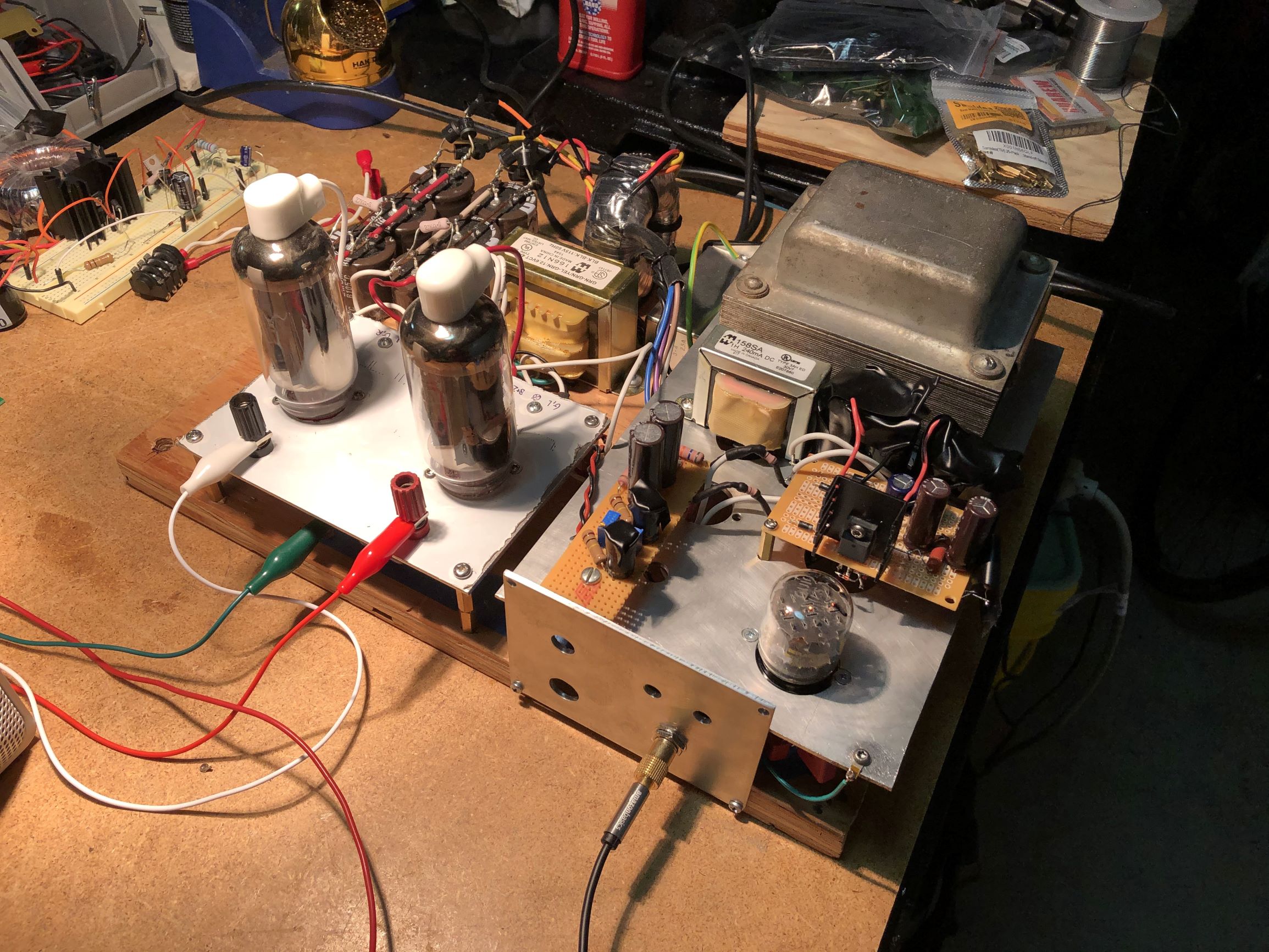

While I was waiting for my boards, I actually had some time to whip up a compact little OTL using 6LB6 tubes. Just two tubes can make 1 Watt audio power without too much distortion, which might make for a nice bookshelf speaker project. But first things first: I've got to finish my Big OTL!

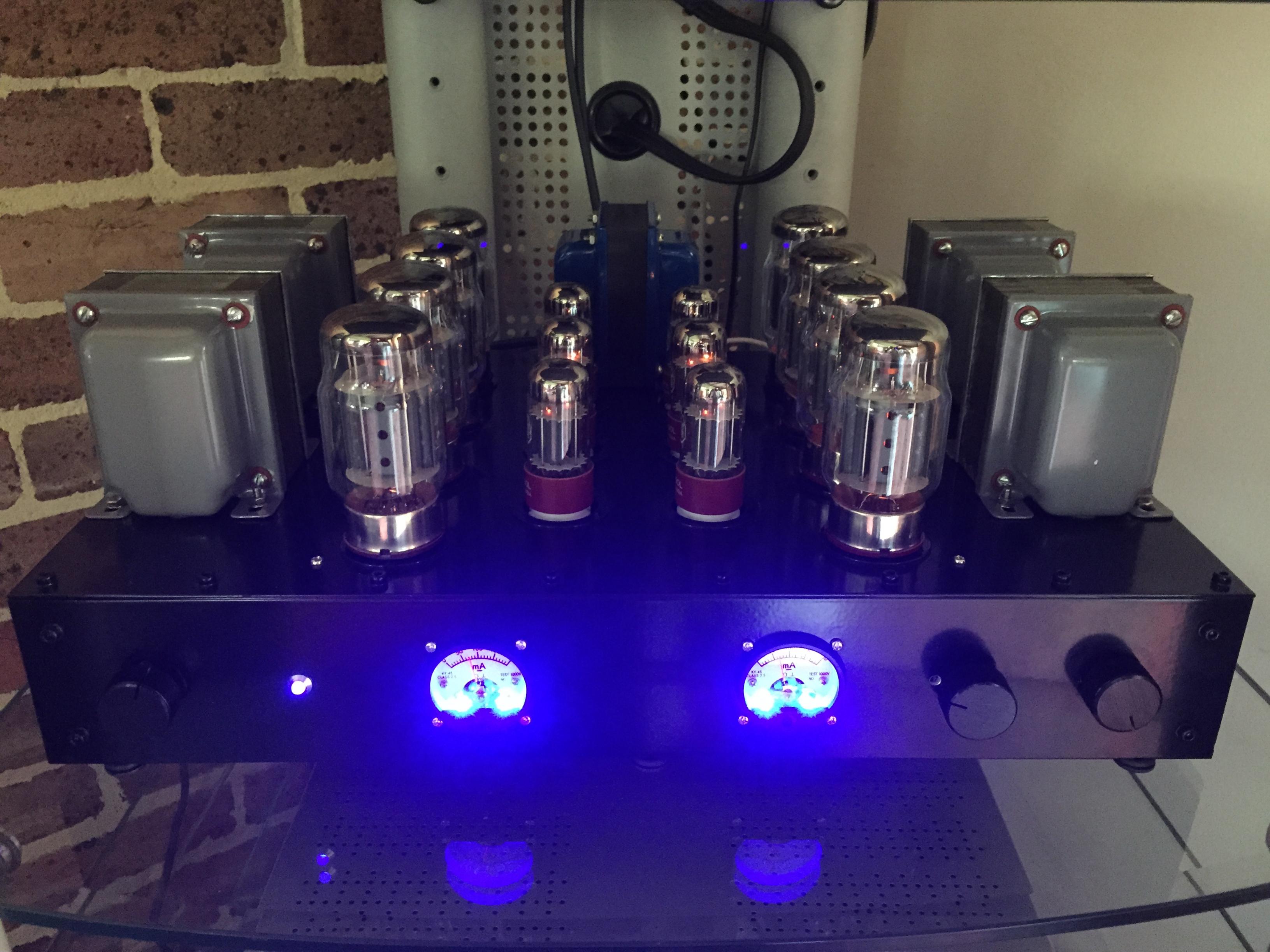

OTP in Circlotron
I built a Circlotron using 4x EL509-II per channel and a low turns ratio output transformer mounted at the speakers. The money you save on tubes can buy you some nice Lundahl LL1627 output transformers. It wont heat the room too much, doesn't require lots of negative feedback (mine is zero global FB), can use bell-wire for speaker cables, wont fry your speakers if there is an anode-cathode short, and it sounds great.
Are those new production EL509s? I did save money scrounging tubes, but all that savings is going into the other system components such as the PCBs and eventually the chassis. The original design goal was a directly-coupled Circlotron output, so I’m going to try and preserve that. However, I want to do a build eventually where I can splurge on an nice OPT; maybe a nice DHT SET since I haven’t done that yet. All my previous projects used repurposed OPTs of varying quality 😀
The method I’m using for speaker protection is an active DC offset protection circuit controlling a mosfet relay on the speaker connection. I tested it the other day and it worked as designed, will post some update pictures in my next progress dump 🙂
Also, beautiful build BTW. Love to see it!
