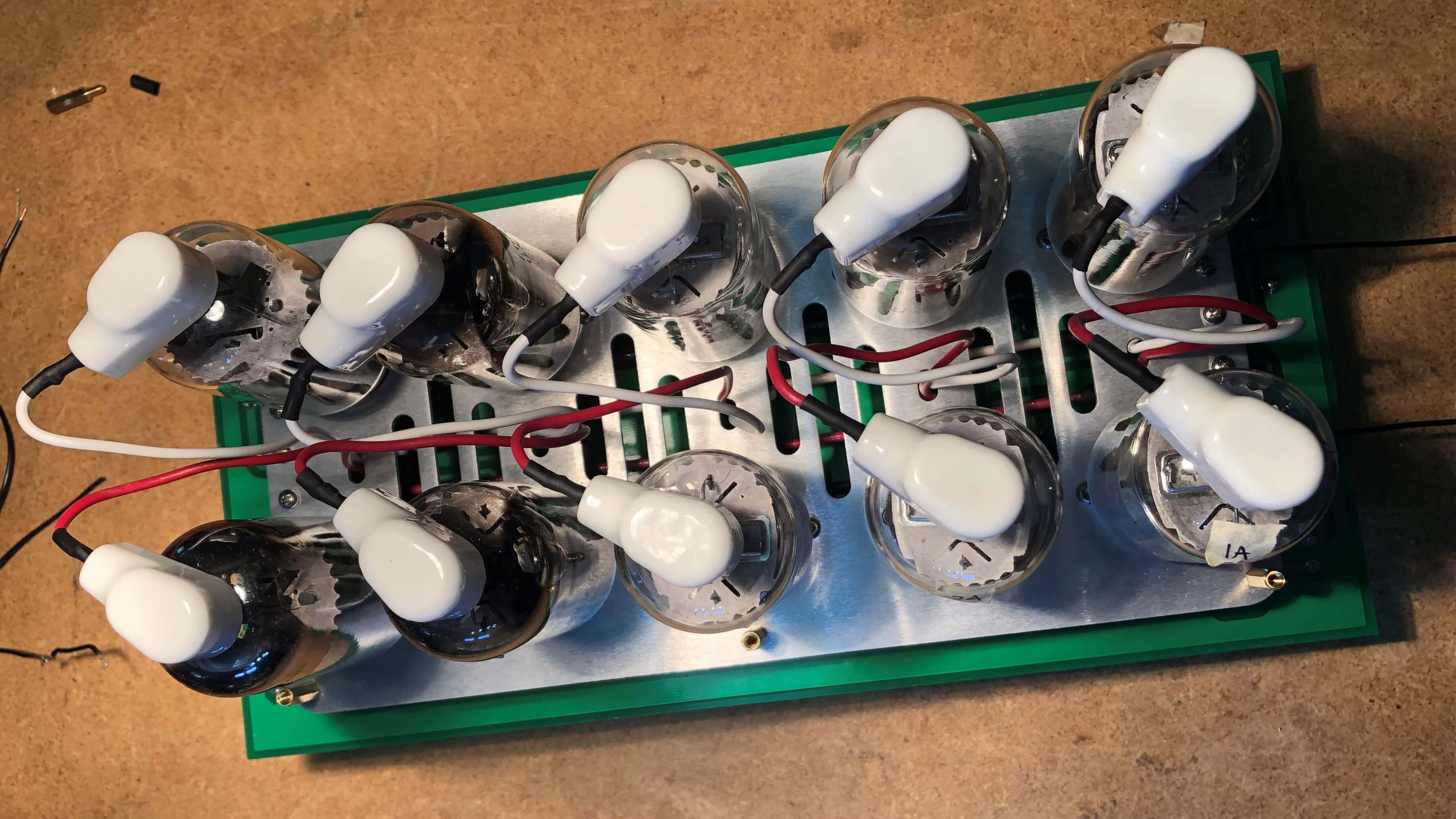

Those OP valves are a bit close together, i think you'll need a fan blowing up from underneath. thermal design often gets neglected in amp design, i think you'll find that chassis will get very hot.
Also be careful of fixing things in stone at this stage, you'll no doubt need to move things round a bit at some stage, layout is optimum with high gain power amps, stability can be lost very easily.
That said nice work so far, well done. Andy.

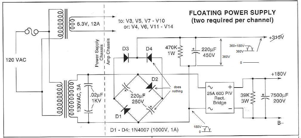

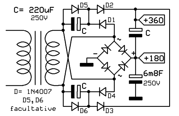

There is something wrong with the power supply.
And a possible alternative.
If the capacitors in the doubler age the could get smaller then the output capacitor.Then the get discharged past zero = charged in the wrong way.
C5 and C6 prevent that.

I built the Alan Kimmel circlotron a few years ago; mine is the "lite" version, with just four EL509 output tubes per channel. It works well, and although not my day-to-day amplifier, which is an OTL using two 6C33C output tubes per channel, I use it occasionally.
One issue I noticed with it is that although one can, of course, adjust the overall DC balance, there tend to be considerable differences between the quiescent current flows in the various tubes in the output stage. (I was finding up to about a factor of two difference between the current flow in one of the paralleled tubes as compared with another.) This doesn't seem to be ideal, but since it would be hard to do much about it without a rather major redesign, I decided not to worry about it.

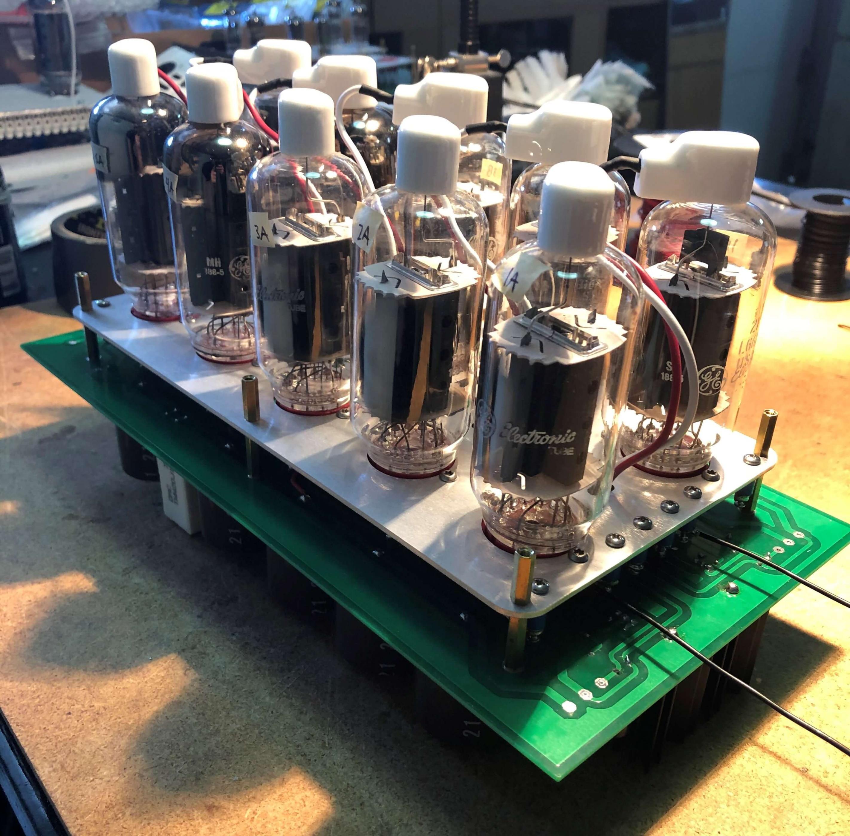

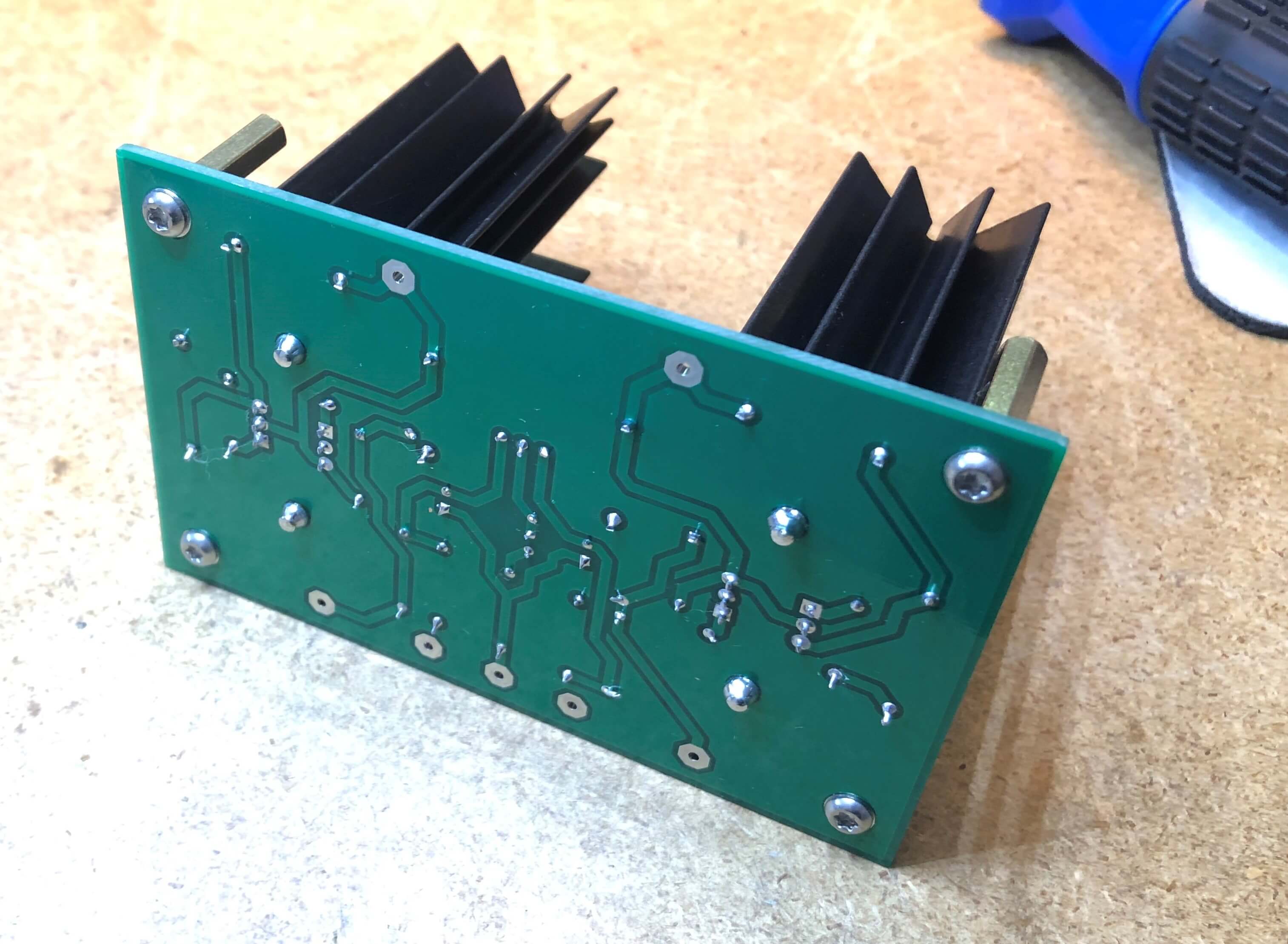

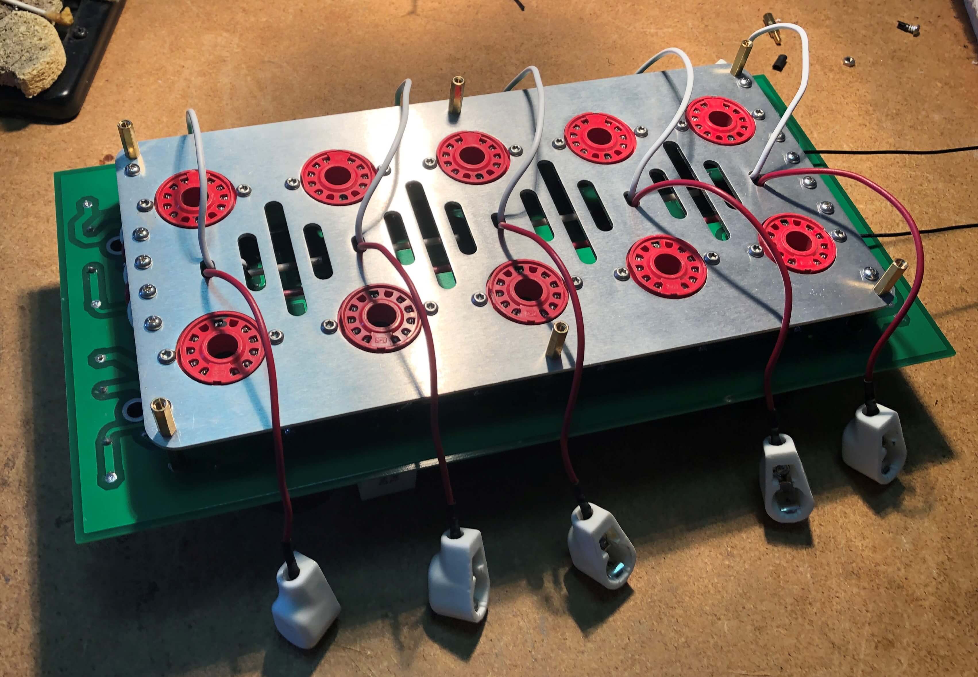

Output tube assembly complete, driver boards complete
It's been a while since my last post, but I would like to share the progress I've made since (and to show this project isn't dead).

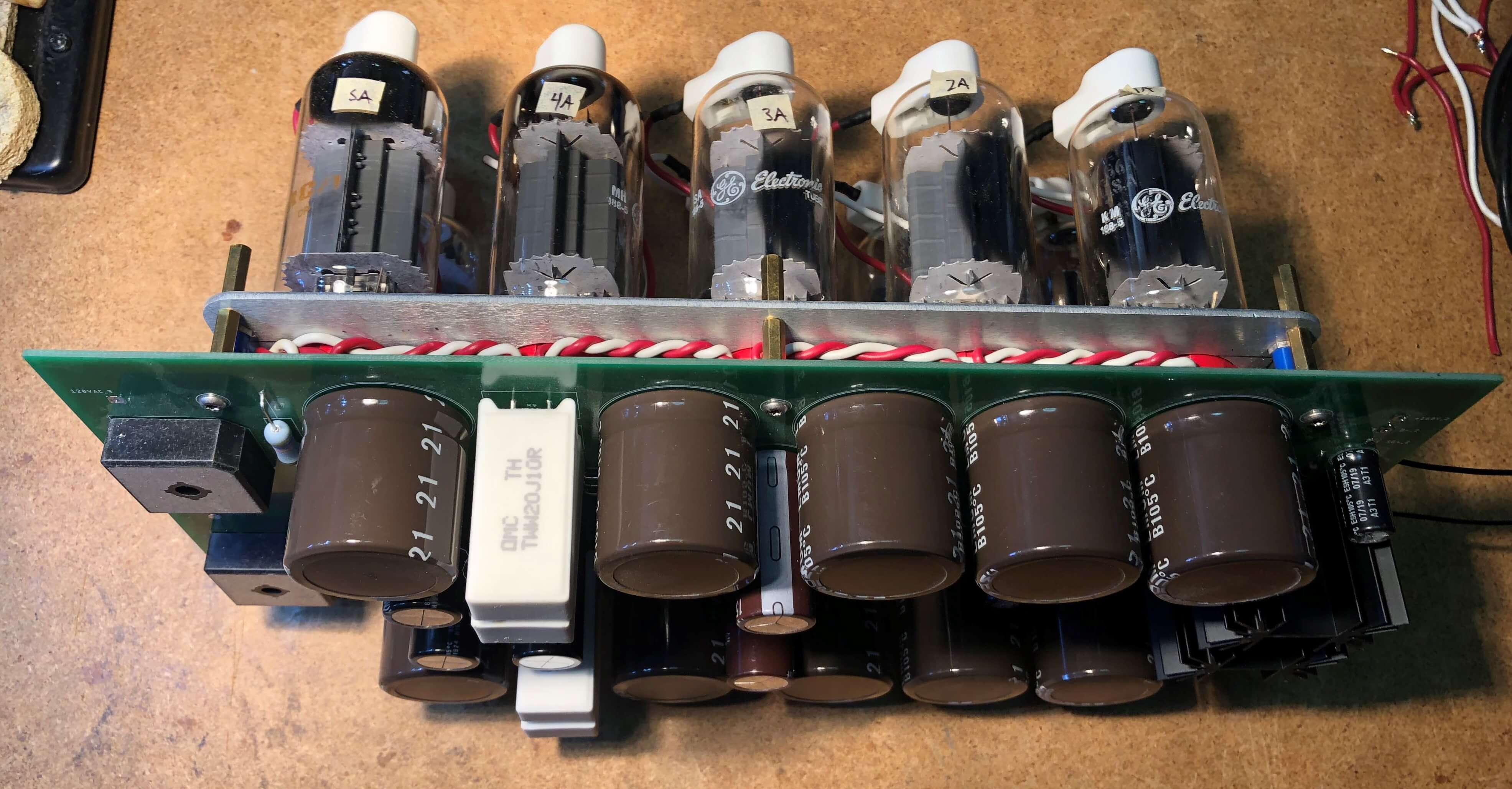

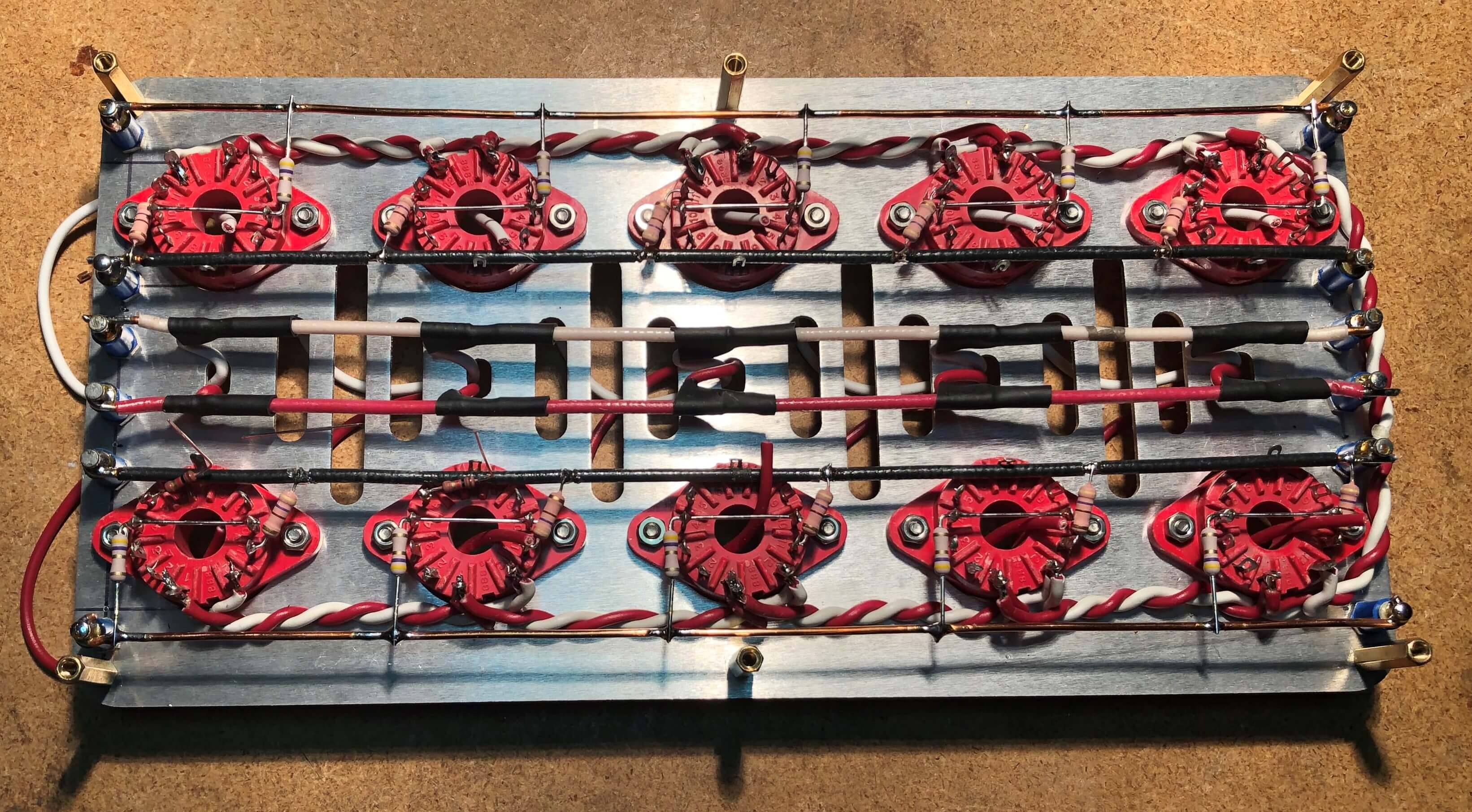

I took suggestions from the previous posts and made the necessary modifications to the output tube PCB. I populated the board with the power supply components and completed the point-to-point wiring under the tube sockets. This is one of the two planned output modules for this amplifier.

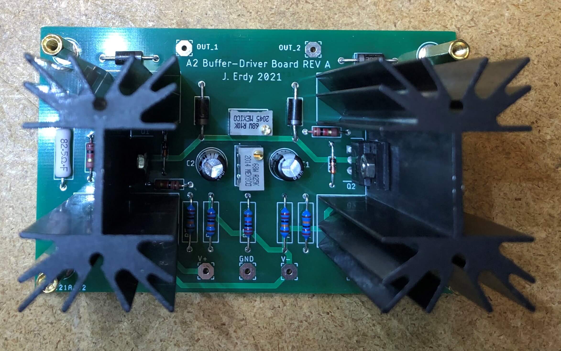

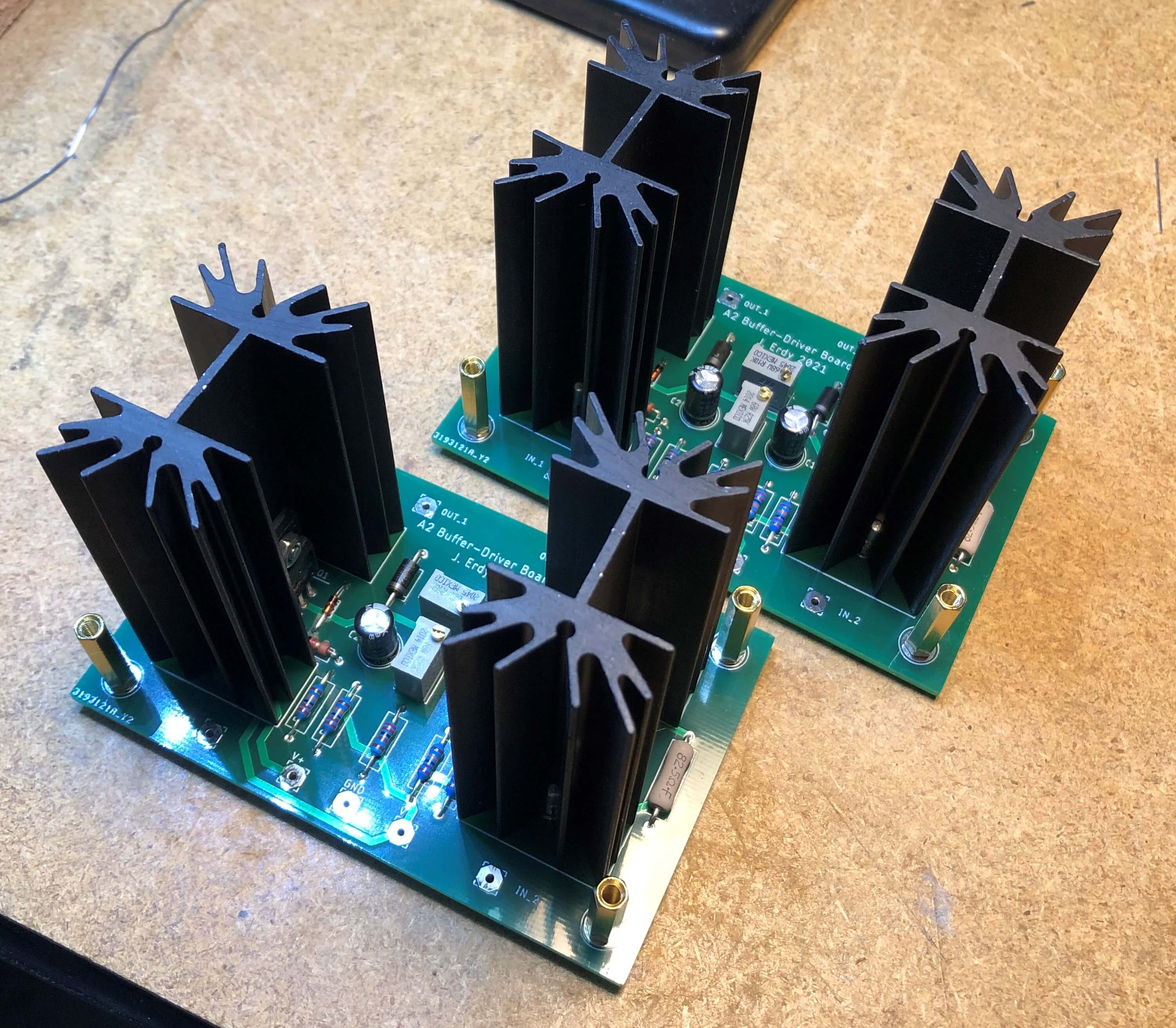

I also completed the driver board modules for the left and right output channels. The boards use mosfet followers to provide current drive capability to the control grids of the output tubes. The circuit scheme is the same from Pete Millett's A2 Buffer but with the addition of onboard bias circuitry.
My plan is to continue making one module at a time, chipping away at this until it's done. The effort required in planning this project has slowed me down a bit, but I have confidence I will complete it before the year is out.
Thanks for looking
Thanks for looking

Heat will definitely be an issue. My plan is to use two or more 80mm or 120mm high static pressure, low noise fans to create positive pressure within the enclosure. Ideally, the air pushed through the space provided between the tube mounting plates and chassis will be able to provide some cooling.

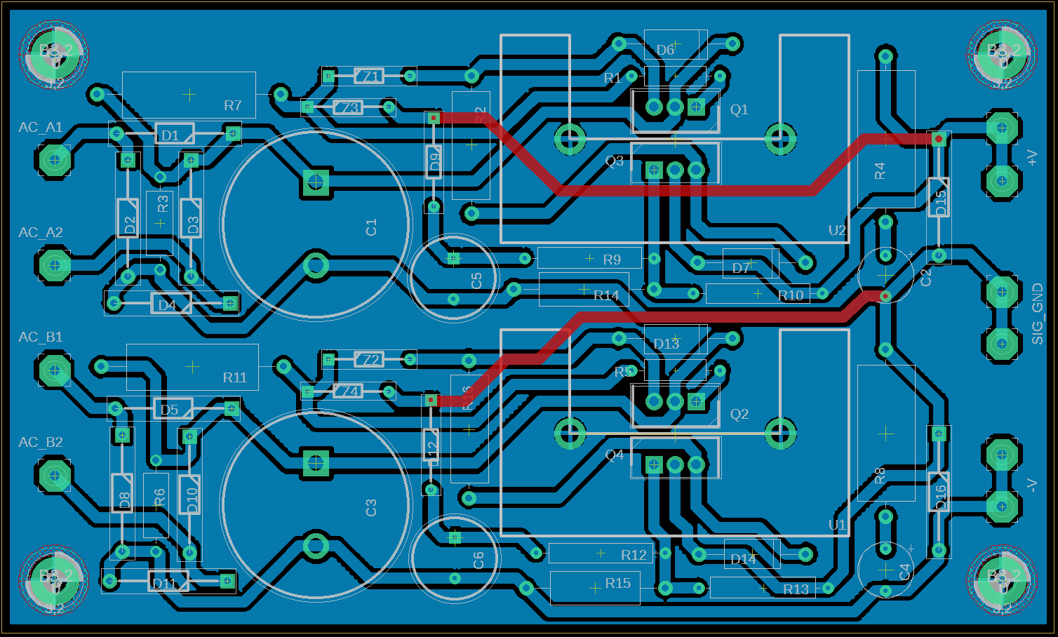

Power supply for A2 driver and bias network
I made some progress on the bipolar power supply for the A2 driver and bias networks. It's a +/- 150V regulated PSU based off of Pete Millett's Maida-style regulator.
To get the +150V and -150V rails I stacked regulators one on top of the other. It tests well in LTspice, so I feel comfortable ordering the parts. However, I plan on waiting until breadboarding confirms the performance before ordering PCBs.

In hindsight, there may be a small benefit in angling each tube base so that the hottest portion of each tube's anode/glass does not point to the same portion of hottest anode/glass on the adjacent tube in the other row.

Yes, I am aware of the high peak inrush current from the toroids. It's enough to make the room lights dim for a split second. I will look into this in addition to the resistor/relay circuit I was planning on adding to the primary side.

I'm hoping some forced air coming through the chassis from below will compensate for the close spacing. I've done a prototype with this spacing and it was hot but not absurdly so. Much of the heat comes from the class A operation and I tend to run in the low 50-100mA range for longevity.
