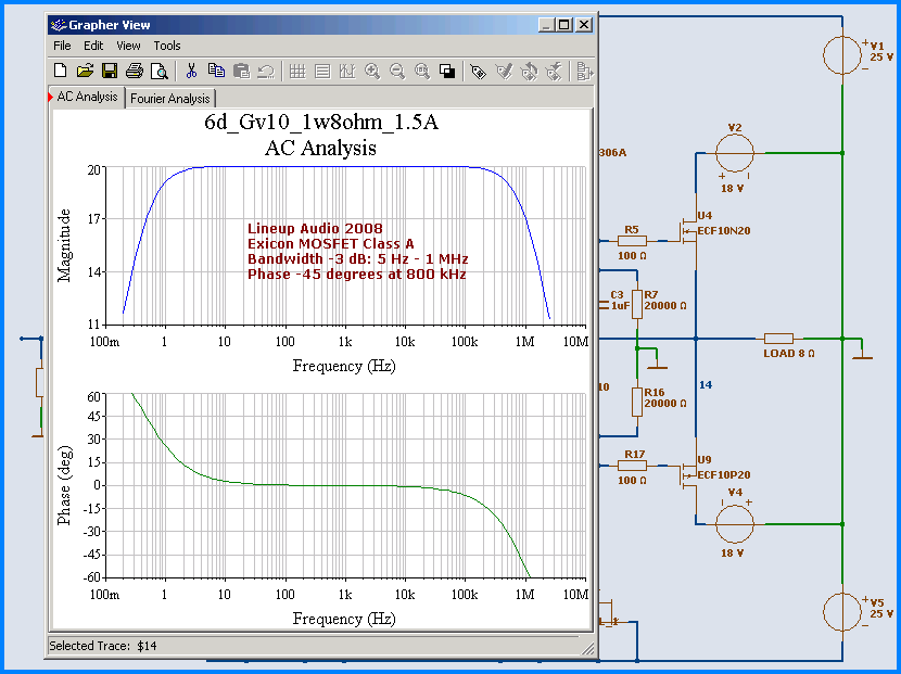

10 Watt Single End, JFET input - Lateral N-MOSFET output
The AC analysis is great, too.
A good match for the very low distortion 😎
Bandwidth, -3 dB.....: 0.5 to 1,000,000 Hertz
- 45 degrees: 800 kHz
The idle current is set to 1.5 Ampere at +-18 Volt DC.
Gives a consumtion of 54 Watt.
And max output Class A is 3 Ampere ( 2 x 1.5 )

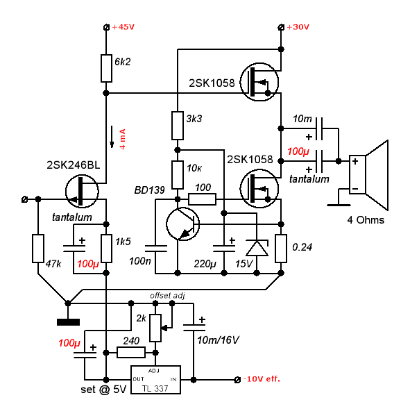

I like this amplifier very much. Hardly can be any simpler. It reminds of SE tube amplifiers. Probably doesn't measure very good since there is no feedback, but probably sounds very good 🙂 Does anyone know which JFET can be used for lower gain?

Lateral MOSFET is what many diy builders use
especially of course the popular & easy to find good transistors
2SK1058, 2SJ162

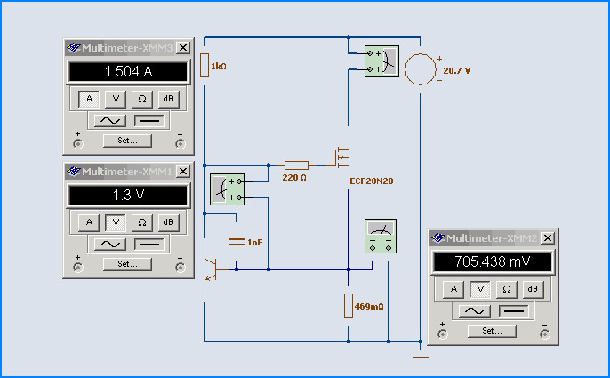

My SPICE test Circuit for NMOS devices. To get: Vgs vs. Current
ECF20N20 shows Vgs = 1.30 Volt at 1.50 A and 20 Volt Drain-Source.

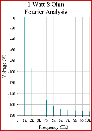

This is first result.
Idle power 100 Watt (2 x 20 Volt 2.5 Ampere Class A)
2SK389 JFET input
N-Channel Class A Push-Pull .. a la Quasi
using Exicon ECF20N20 250 Watt lateral MOSFET devices
Gain x14.6 (+23 dB)
Bandwidth, -3dB: 700 kHz
Attachment shows first version 1a from today
FFT Fourier at 1 Watt 8 Ohm output.
