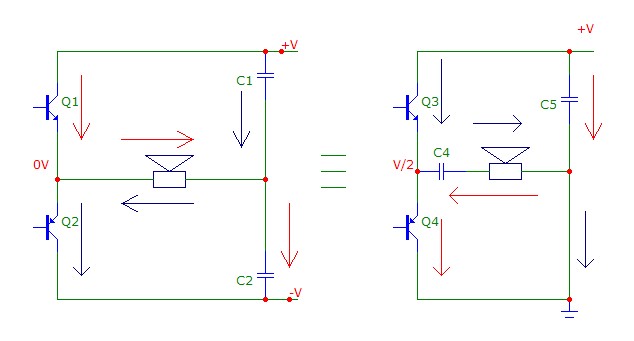

An interesting note. Loudspeaker currents flow through the supply capacitors not through the centre tap of the transformer, so in essence all amplifier outputs are capacitively coupled.
Hello Nico
That is not a power supply capacitor , that is a coupling capacitor .
If you talk about the big capacitors on the PC board .
You can see the schematic at the first post .

Hi Gabor,
you are not correct by your assumption what I say.
Several comments here claims that direct coupling is better than capacitive coupling, or rather single supply is not as good as split supply.
I am merely pointing out that whether using split or single supply, the signal path to the load is effectively capacitive coupled.
What line-up pointed out without saying is that the loudspeaker coupling capacitor and supply capacitor size need to be considered for LF response as they are in effect in series every other half cycle.

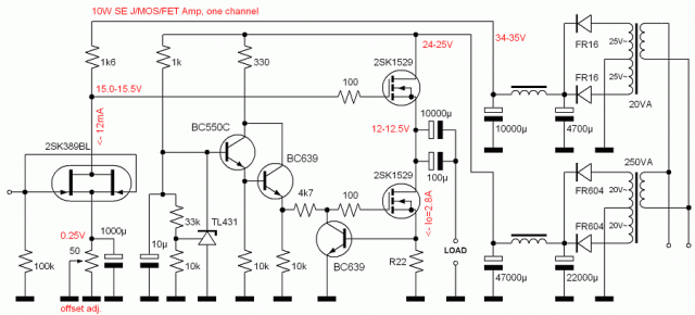

Hello Nico
Here is the schematic I talking about .
There are another schematic in these tread so be carefull do not be confused .
On the PC board that is coupling capacitor .
That is how the schematic was design , and even AKSA wrote that is a great design .
So I just want to check it out .
Regards

00940 said:But does the quality of the caps matter in the same way (output coupling cap vs psu caps) ? From the posts by Jan Didden in that thread : http://www.diyaudio.com/forums/showthread.php?s=&threadid=137497&pagenumber=2 , I'd think not.
But I might be confused.![]()
You are not confused and Jan is absolutely right. The power supply cap is as much part of the signal path as is the output transistors feeding the loudspeaker.
It is very important to by-pass large caps with little ones to maintain linearity and phase over a the entire audio band.
Nico
Nico Ras said:You are not confused and Jan is absolutely right. The power supply cap is as much part of the signal path as is the output transistors feeding the loudspeaker.
Nico
Quoting Jan Didden: "The audio return current from the speaker does indeed pass through the supply cap. But that does not impact the audio *signal* at the amp output.
Look at it this way. If we have a cap that distorts 10%, and if it is true that it is 'part of the signal', how could we then ever build amps with 0.001% distortion."

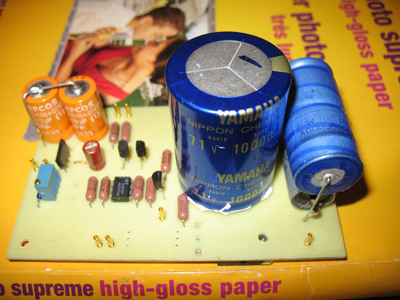

Hello
I almost finished populating the PC board the amplifier posted by lineup and design by Widow maker.
Hopeful I can test at the next week some times .
I only need the 1000uF capacitor , after I can ad the Power supply . I ad two capacitor for the power supply on the PC board .
I built several Class A amplifier like Sewa , both Hiraga , some Alephs like Aleph 30 , X , Aleph 2(not finished)but because these SE and so SIMPLE I can hardly Wait to test it .
I hope it does sound good how even AKSA wrote about .
Thanks to line up and Widow maker for the design and for sharing the schematic .
I post a picture from the PC board .

I wouldn't use that 100uf tantalium cap as an output bypass
cap. Or at least Walter Jung indicated they sounded bad in his
old article Picking Audio Capacitors.
Hello
I hate the soud of the dry tantalum capacitors .
I use Philips auxial which is one of the best capacitor in the market and a small Russian teflon capacitors .
I did tested many capacitors in the SEWA output , nothing come close to the Philips auxial .
I did tested tantalum capacitors in the input in a couple amp but Black Gate N one of the best capacitor.
I do not use tantalum caps , probably I would use resistors from Audio N but no capacitors .
Do not forget Mr. Pass use in the Folks amp 22 000uF capling capacitor .
And he wrote it sound great !
Thanks for the advise .

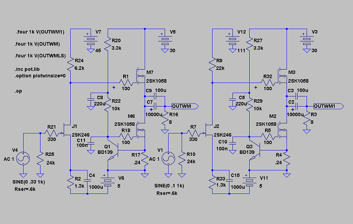

Hey Widowmaker,
The 6,2k drainresistors seems to load the 2SK246 very hard giving unnecessary high THD. Did some sims to see if it could be bettered.
With ca 110V and 22k the distortion is reduced 10x! Had to change the 1,5k sourceresistor to 1,3k to get as symmetric clipping as possible with ca 18V at the output device gate.
With the results I get one almost wonders if there is something wrong with the jfet models we are using? At 1W/8ohm I get 1% THD mostly 2nd order.
Have you done any IRL measurements?
These are the circuits I simmed:

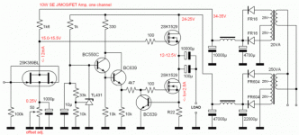

widowmaker said:I have one new version of solid state SE AMP:
Some features:
Zero feedback
Thermostabilization of output offset through negative supply for source of input JFET transistor.
Schematic:
Is there a problem with the original circuits DC-stability? When AC-coupled output, I would think it would be a minor problem with some drift?
- 10 Watt Single End, JFET input - Lateral N-MOSFET output
