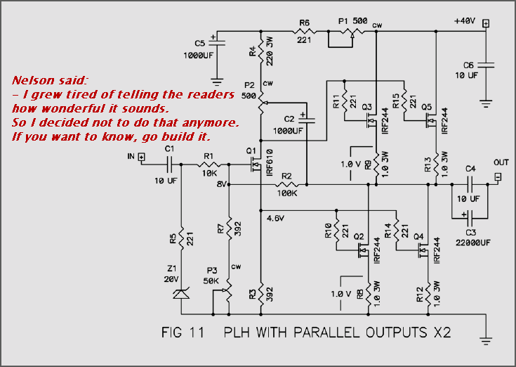

Nelson Pass said:
- I grew tired of telling the readers
how wonderful it sounds.
So I decided not to do that anymore.
If you want to know, go build it.
See attachment for schematic
if you REALLY would like to Follow Master Nelson advice:
- Go Build It !

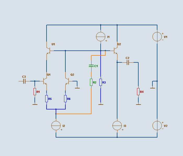

Low Feedback Amplifer.
Gain & feedback level is set by: R3-R6
Input stage is an original idea of mine ( Lineup Audio LAB )
Also this is some thing you can try.
I am proud of this ONE. Very!
As anyone who understands Amps .. will know! DS.

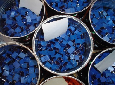

High time to tease Bogdan again, here's ~3500 in different values, can't squeeze more coffee tins in a low bit size dig. pic.
Average wholesale cost in the early '90s when they were still available $4/pc for a 56nF to $5.5/pc for 100pF.

Going back to the schematics, I see a strange thing:
It uses a TL431 Constant Volt Supply followed by a D'Arlington pair to provide s very low impedance source, and then follows it with 4,7 K Ohms and looses all the regulation? And then trusts all the current regulation of the output stage in the Vbe voltage of a BD 639, with its poor thermal coefficient?
Something strange, not to say wrong.

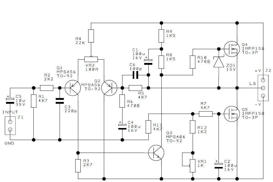

hi lateral single ended design
hi..i had a quick look at threads.. i wanna build this amp with lateral mosfets..2sk1058 or more powerful laterals.. which resistors should i change ? i want to use irfp150n for current source and 2sk1058 or more powerful laterals..
i am choosing laterals because they have smoother sound..
if you have powerful (more than 10watts )single ended lateral mos amp design please post..thanks
hello umut
I, Lineup, started this topic about widowmaker interesting little Class A amplifier.
Looking at your circuit I do not see any Voltage.
What is your supply?
Because this is the most important factor to make more power than 10 Watt.
+ one powerful transformer to give Volt+Current, of course
You idea of using 2SK1058, Lateral for Signal Ouput
+ IRFP150N for Current source is prefectly alright!
Either you can start PARALLELLING 2SK1058

the supply is +-15 volts for irfp150s..but now i did interesting something..now there is 250watts class d lateral mos 😀 its the mosfet🙂really sounds good in single ended mode🙂
http://www.classd.ltd.uk/product.php?productid=16176&cat=266&page=1
and the supply voltage is +7,5 -15 volts 😀
but i can use exicon mos or 2sk1529
I tried PLH amp its good..but ras10 single ended amp sounds more detailed than PLH amp..i dont want output caps
i think there are disadvantages of laterals in single ended mode..but it sounds smoother and more listenable for me..
i am waiting any single ended schematics with laterals
i registered lineup forum but cant see any single ended design..
best regards
Ümit

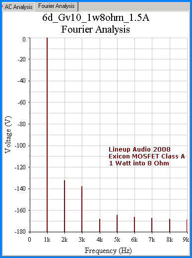

I did some additional work on this idea during the passed night.
I set the gain of my mosfet class a amplifier,
dual case 2SK389BL for input stage,
to 10 = +20 dB
At 1 Watt RMS into 8 Ohm resistor
shows the following very low distortion spectrum
