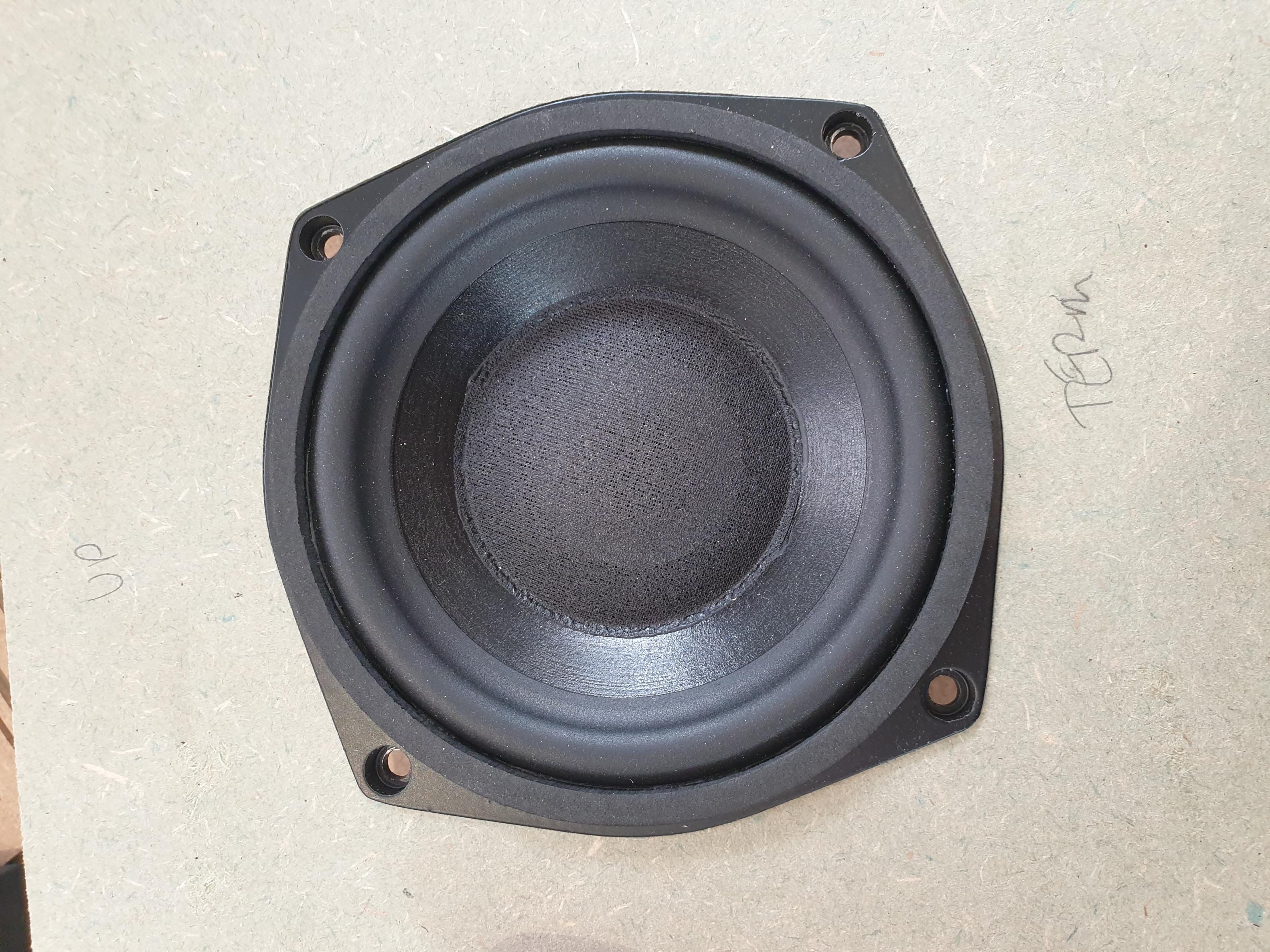

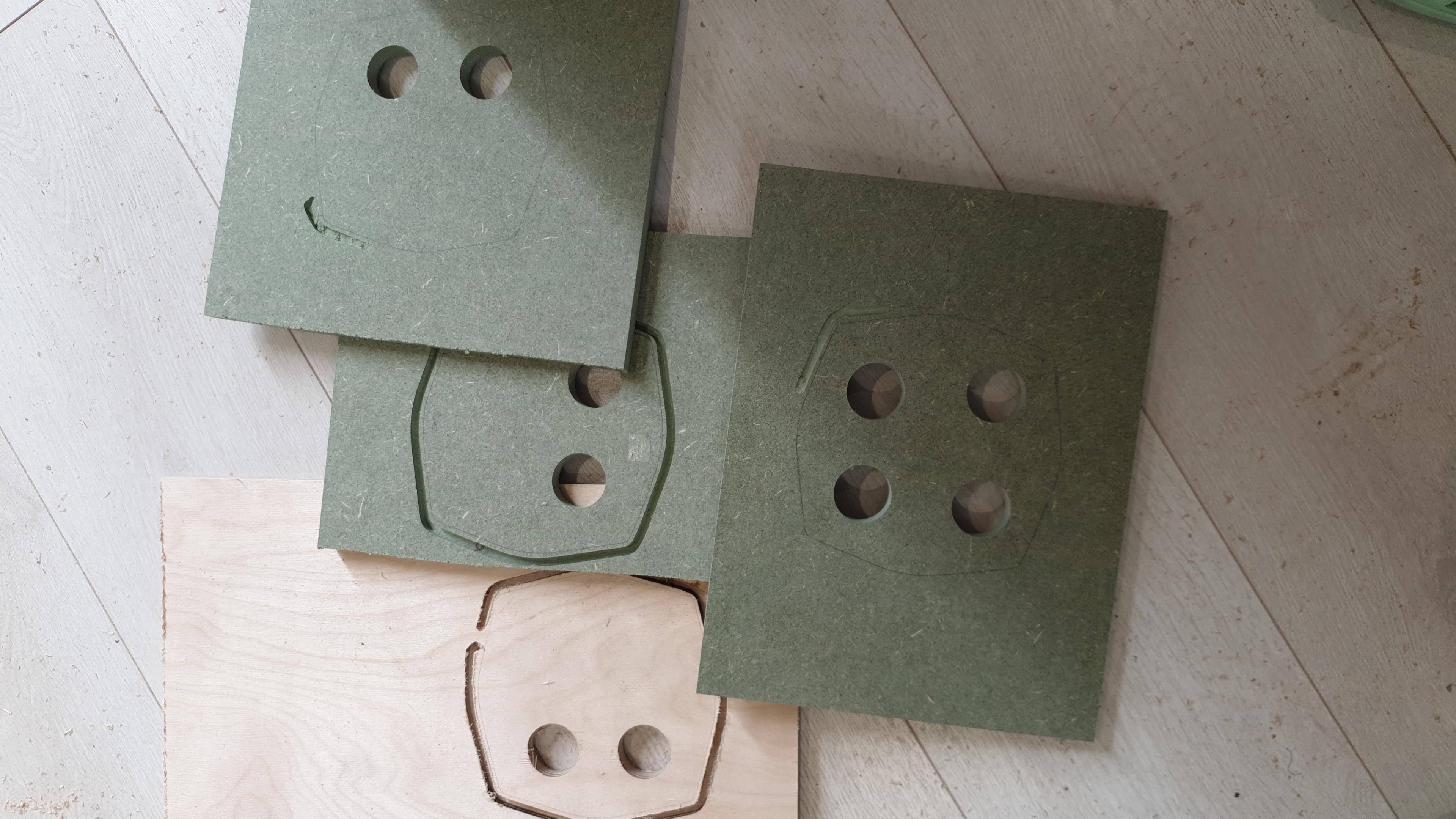

In the initial discussion of Matthias' monkey box speaker, the Fane Sovereign Pro 10-300SC was mentioned
Cheers! I had looked at this driver but it seems to be discontinued. Also, having spent a Saturday trying and eventually succeeding after losing my mind doing it I mah have decided to never ever ever try and flush mount and irregularly shaped driver again!
It is supposedly available at 62.6 GBP on your side of the channel: https://www.soundlite.co.uk/Sovereign-Pro10-300SC/de
Routing it flush should not be too crazy, it is basically a circle and you need stop early of finishing the round, then cut four straight lines between the end points.

It's not the how to, it's more the faff! 🙂
Workshop Co-ax Mini Bangers - B&C 5CXN44
Saw some video on youtube that used 3D printed template to route against with a template router bit. You could 3D print filler flange to a round hole as well. Endless possibilities with additive manufacturing 🙂 My irregular routings have all contained some errors, really easy to make mistakes.
It really is, isn't it.
Yeah, I got so frustrated this weekend I thought about buying a desktop CNC or 3D printer just to end my woes. I could buy a decent 3D printer tomorrow but I just don't have the space. Also, the frustation of a long print messing up half way through might put me in an early grave.
