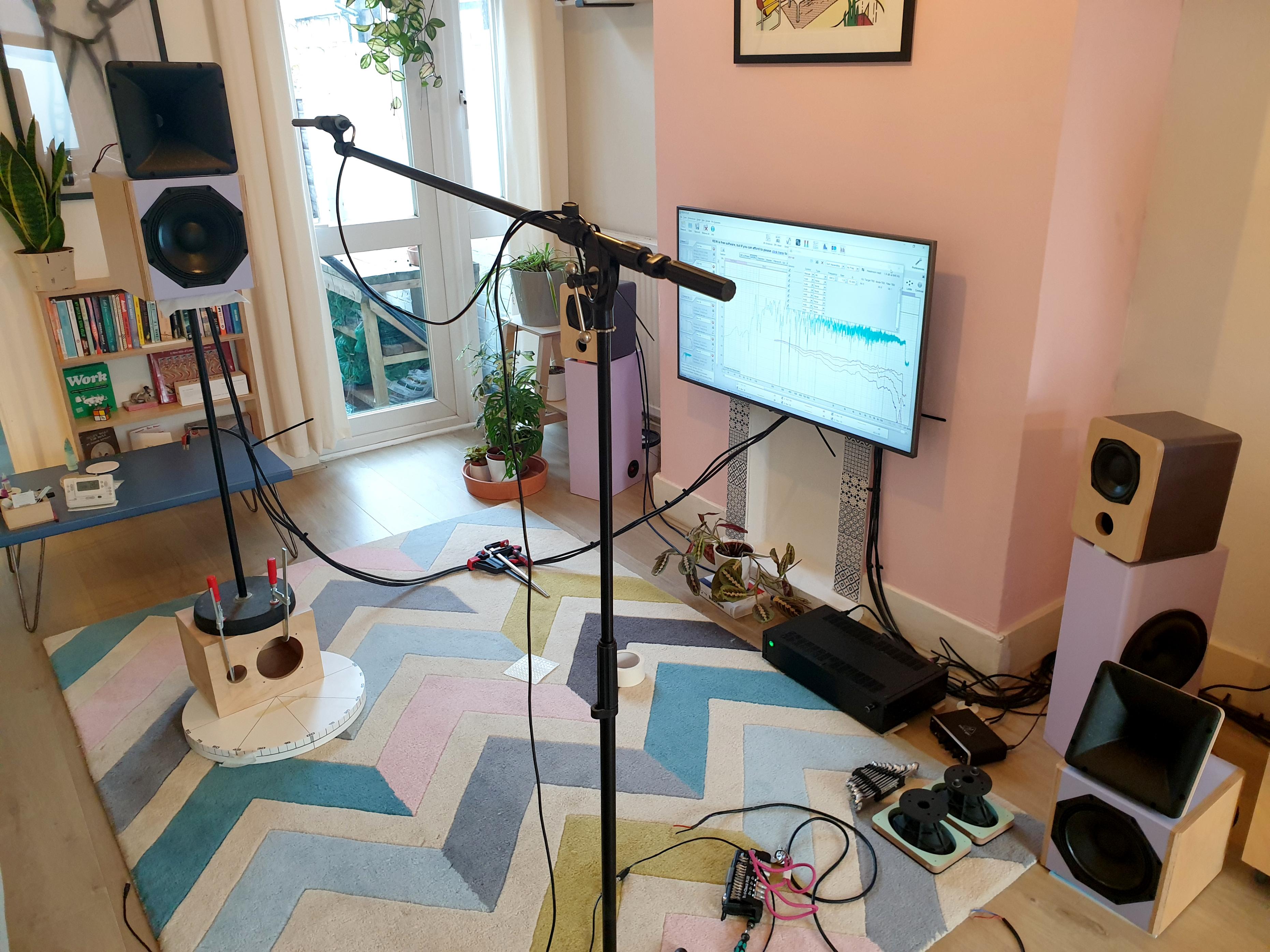

I have a couple of days off so I have done a wee experiment which I think turned out nicely.

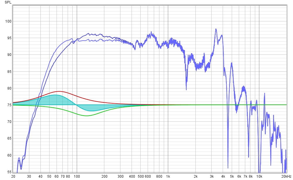

The cabinets I have for the 8PR200 were tuned rather high as they were built to hand over to subs at 100hz but I changed the ports to tune the cab to 65hz and applied some EQ. It looks quite severe but this system is never pushed above a gentle stroll. This is just to have a running system until I do the bottom half.
attachment.php

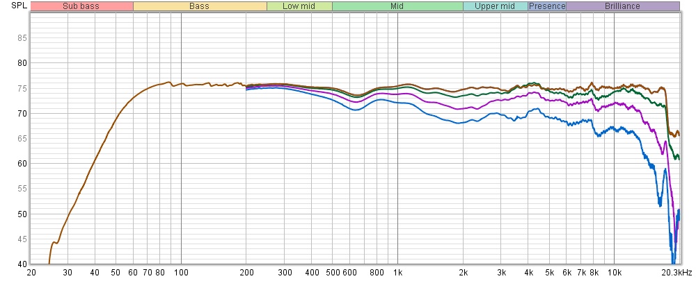

My anechoic chamber while the wife is at work:
attachment.php

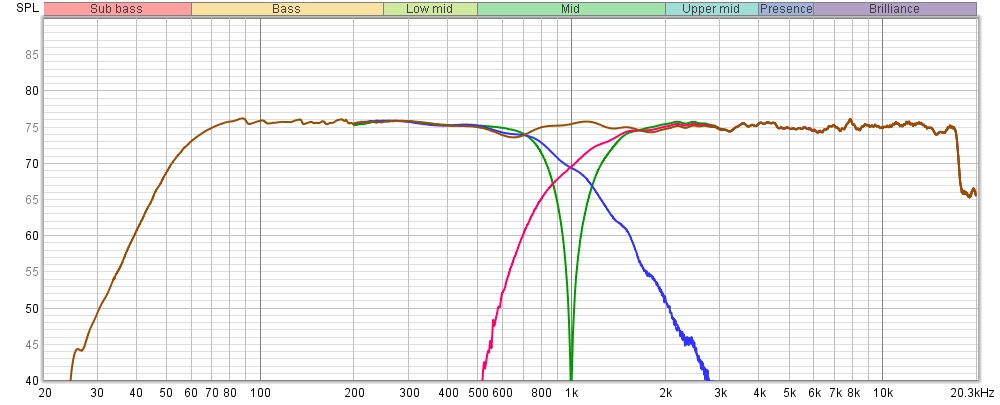

After very little tinkering the 8PR200 and Peerless DFM-2535 cross at 1000hz with an LR4:
attachment.php

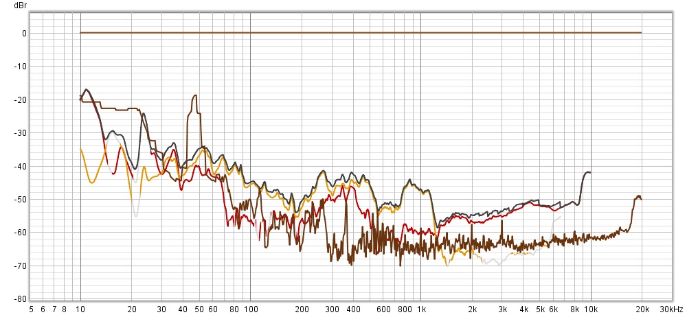

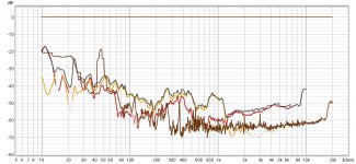

Distortion flits from -45db to -50db when tested at 90db:
attachment.php

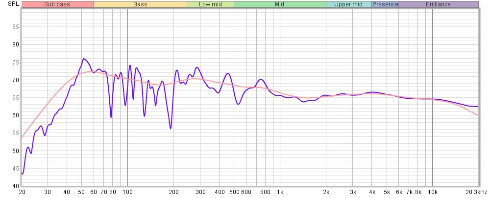

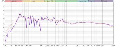

In room response after some very quick and light room correction:
attachment.php

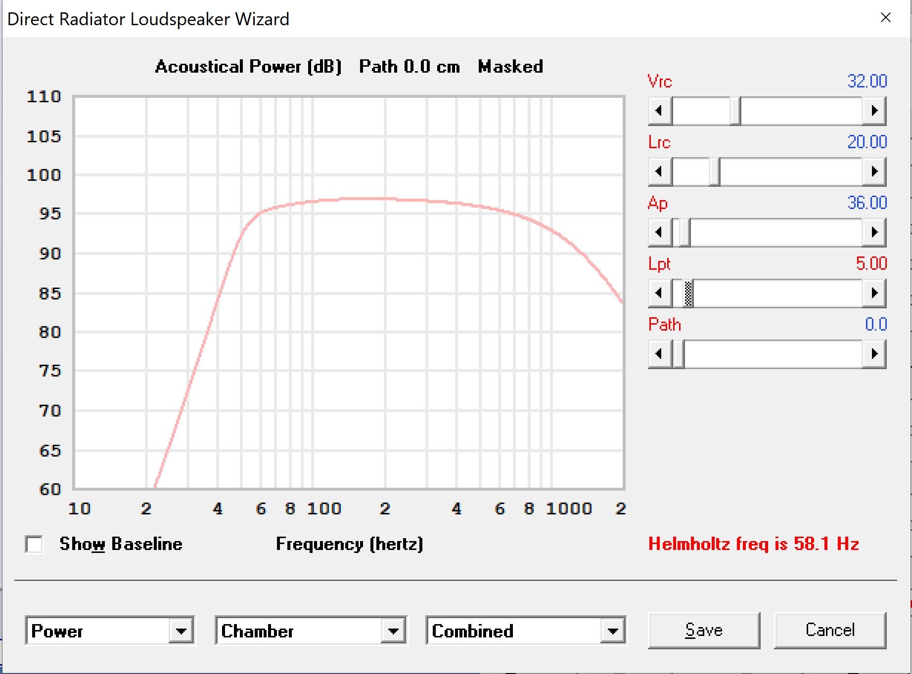

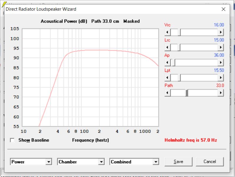

Yeah, I am surprised at the decent polars from this set up and did get me thinking what I could get out of the 8PR200 with the right sized box. This is a 16L cab with a 68mm ID pipe 155mm long. I've never been happy with the look of the current cabs in this house and want something more permenant so rebuilding could be an option.

Attached is a rough alignment from datasheet spec.
