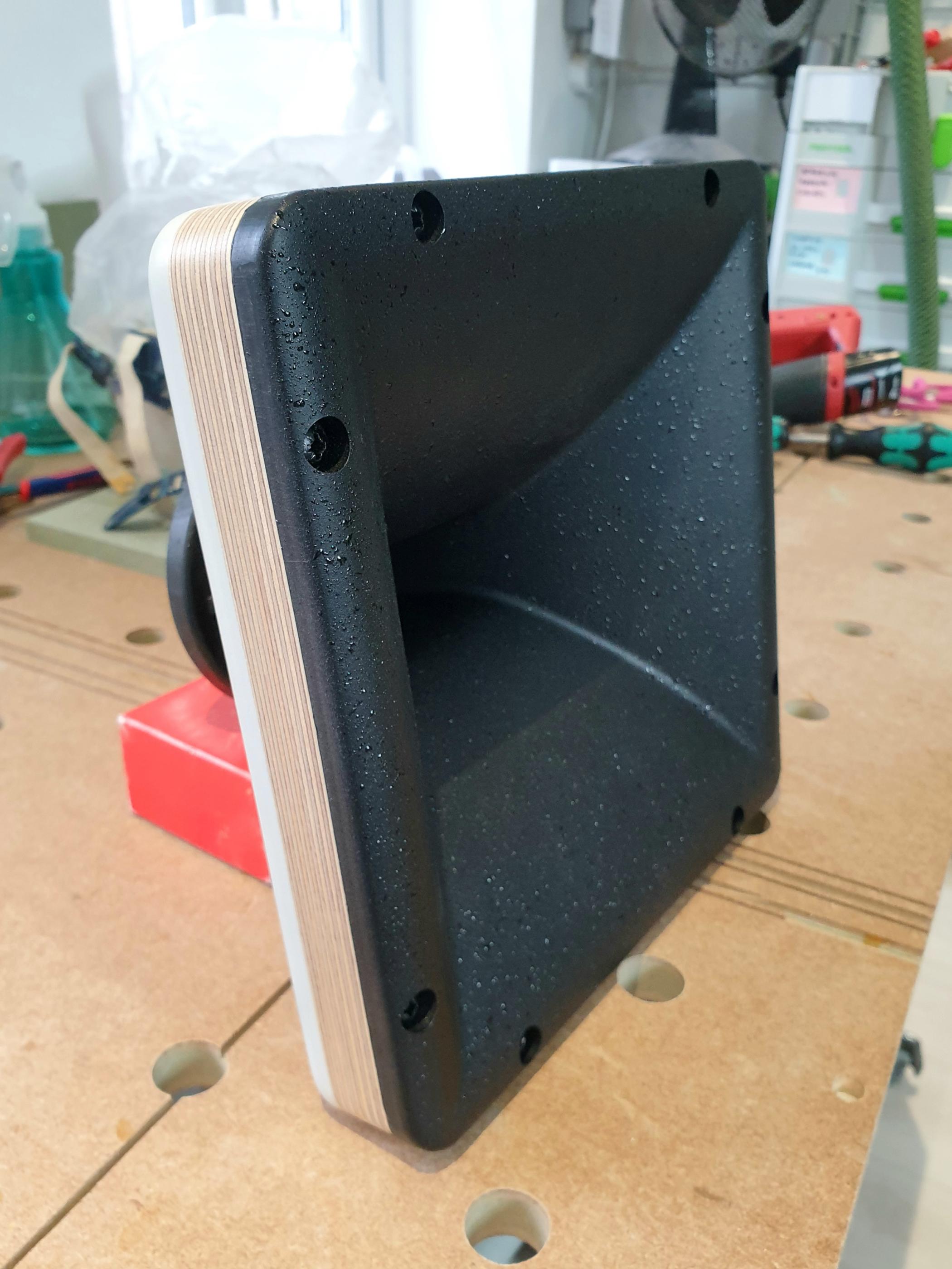

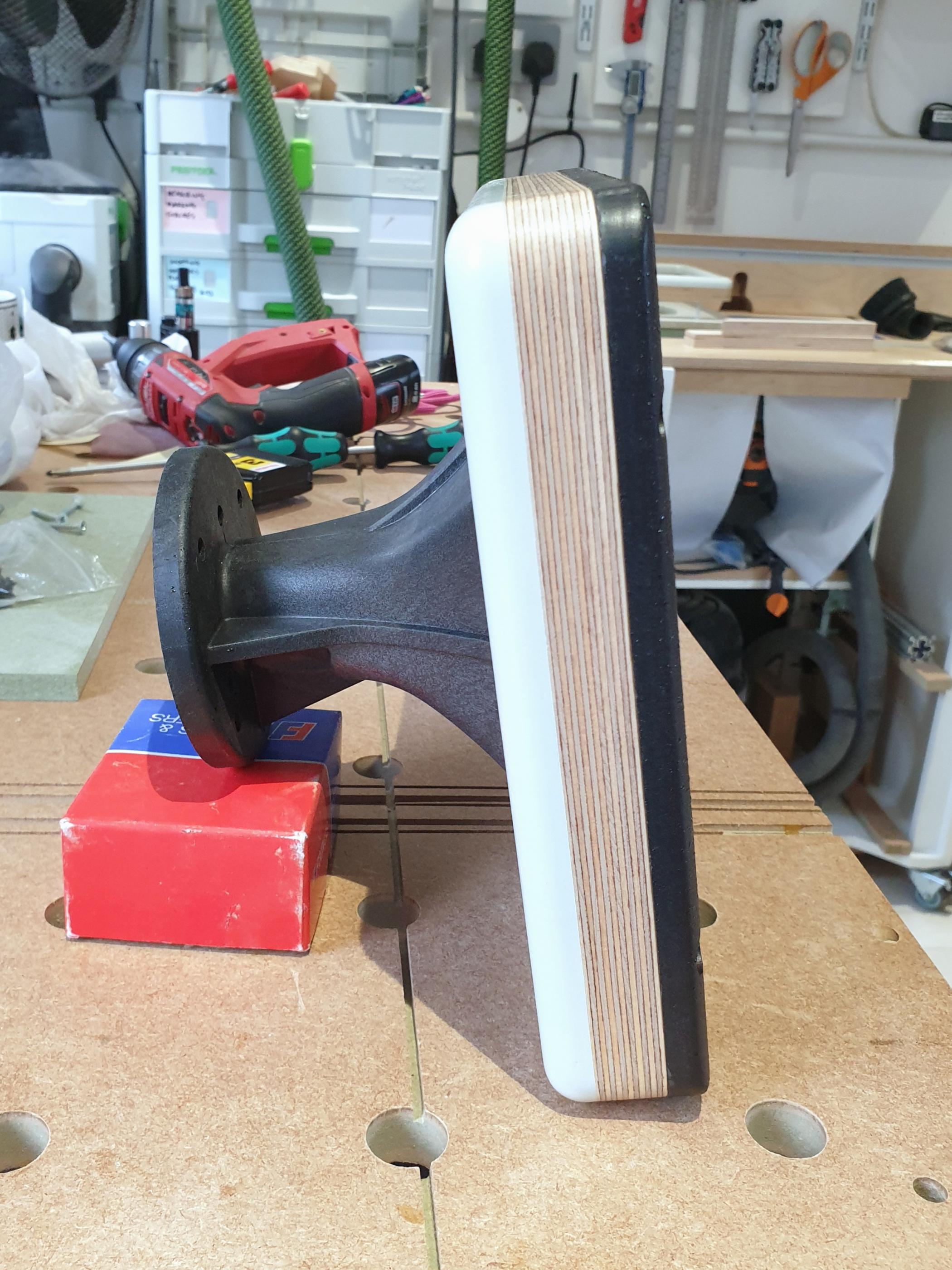

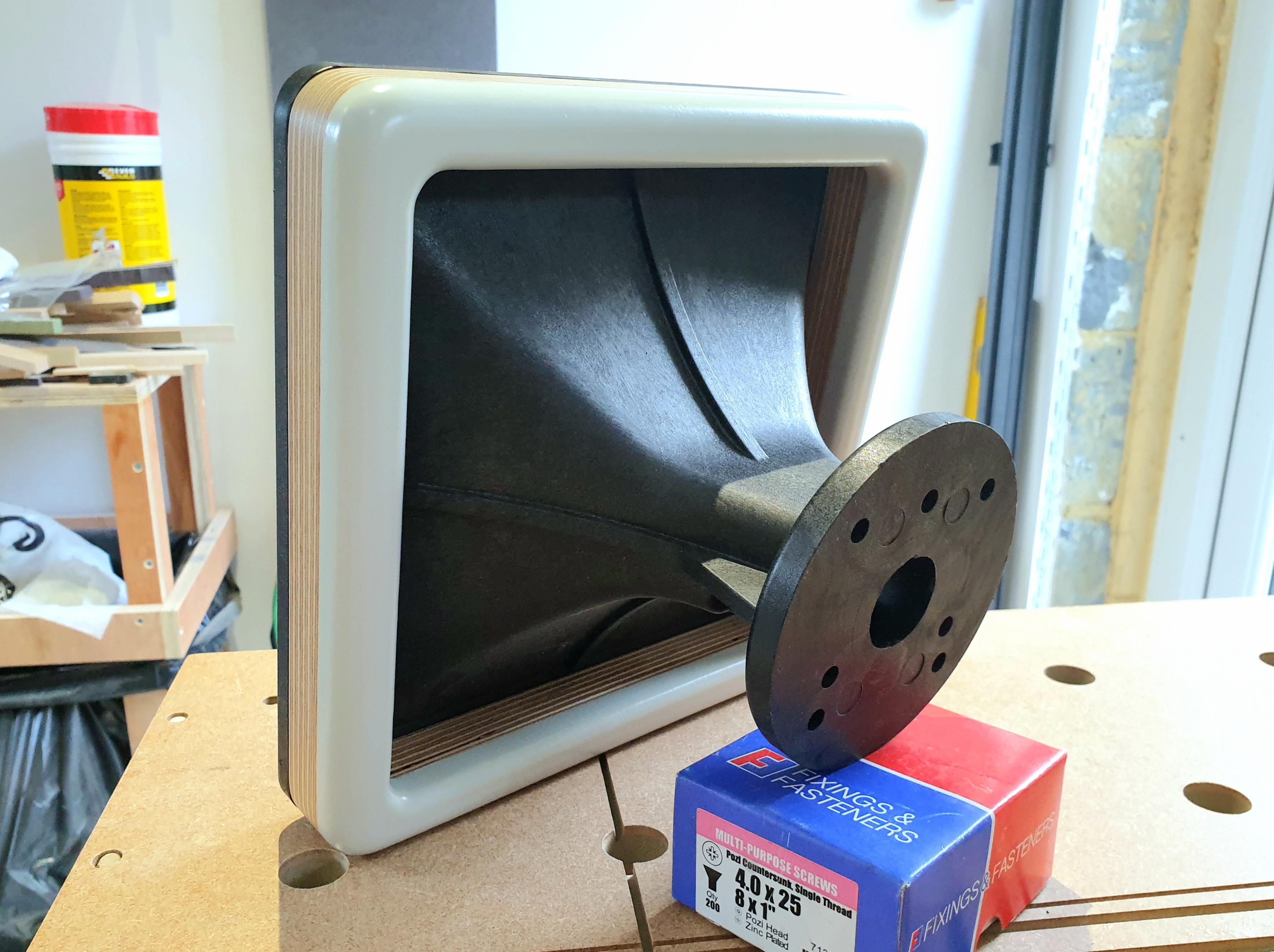

A little progress. Perhaps a little presumptuous to make a finished thing for the horn as I havent heard it yet but I want to try a constant directivity horn for a least a couple of months so this takes the industrial object edge off it.
When I did a less fancy version of this for the cast aluminium STH100 horn it deadened all the ring so I can only assume this will help the RCF one in rigidity and give it a bit of mass.
Nice, but what type of ringing do you talking about graham? Did you heard ringing with the sth100 that came from the horn when sound was played and the wooden frame has reduced that audible ringing?
No, no measurable ringing (that i can recall) but horns like the STH100 and this one arent meant to be freestanding. When you held the STH100 and tapped it then it would ring for a while but of course it was designed to be coupled to something (a cabinet) which would eliminate this.

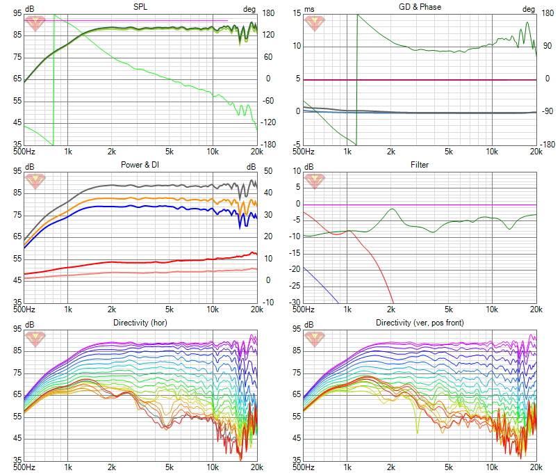

Did another quick measurement with RCF H100 + HF108 but something still ain´t right. Looks like one of the samples has a defect or so though I still hope it doesn´t! Unscrewed it from the horn and back on but no change to the FR.
Will get back with more measurements when I find the fault (or not..).
Oh forgot: this is with a 24dB-HP-filter (BW) at 800Hz.

I don't think you are right. 22 cm equals 1.5k, where the peak is and at 2k is the ditch. From 3k on it becomes visible in the normalized plot, the difference between on- and off axis reponse, slowly shifting. It is very simple: at 1.5k, there IS diffraction happening, it must, because there is an open edge. Round-overs, as in baffle edges, and termination, as designed in Ath waveguides, are two similar, but still very different solutions: The latter is an integrated solution for an optimized waveguide, the first is simply following basic insight, how to avoid strongly localized diffraction effects by smearing it through space, and hence, over frequency spectrum. You can do this separately. The simpler solution is but a question of the magnitude of radius. Easily applied and still worthwhile 🙂
If look at the un normalized graphs the peak and dip is from the driver and can be EQ smooth. Look at the normalized graph which is basically 0 axis EQd flat. The other lines (off-axis angles) are not straight but if look at the scale they go up and down within 1dB, very acceptable result especially with no construction involved.
You are right that roundovers would help but I suspect they would need to be r > ~5cm to smoothen the diffraction at 4kHz and below and still some of the issues might persist, it is a diffraction slot devise after all. Hence there might not be that much of improvement and would be lots of work to build one. If one wants to really better the response one should look for custom made waveguide 🙂
Actually the diffraction is surprisingly low, I expected much worse and it would be if the waveguide was on a baffle, without roundovers. On a flat baffle diffraction is easiest to minimize by reducing the flat are around sound source and I think here is similar situation, only some of the sound goes to the edge, which is very close to the source = not much of a delay = not much of interference problems. Roundovers are little better with very high cost in comparison, there is no work and no cost using the waveguide naked.
edit time over, here is the H100 with HF10AK in application with EQ and xo. As you see it is not perfect, but very acceptable performance. The graphs here are not normalized.
Edit, very rough baffle roundover guestimate attached 😀 Made diffraction sim that showed on axis diffraction peak and dip somewhere around like the H100, peak < 2kHz, dip ~4kHz. Roundovers help some already at 20mm but to smoothen the ~2kHz further bigger roundovers are needed. Even though we have a waveguide and the diffraction simulator is just a flat baffle and transducer I think this still illustrates the roundover needed for ~<4kHz stuff. It is all mostly relative to the wavelengths in question. The attachment cycles through 0, 20mm, 40mm, 60mm roundovers.
