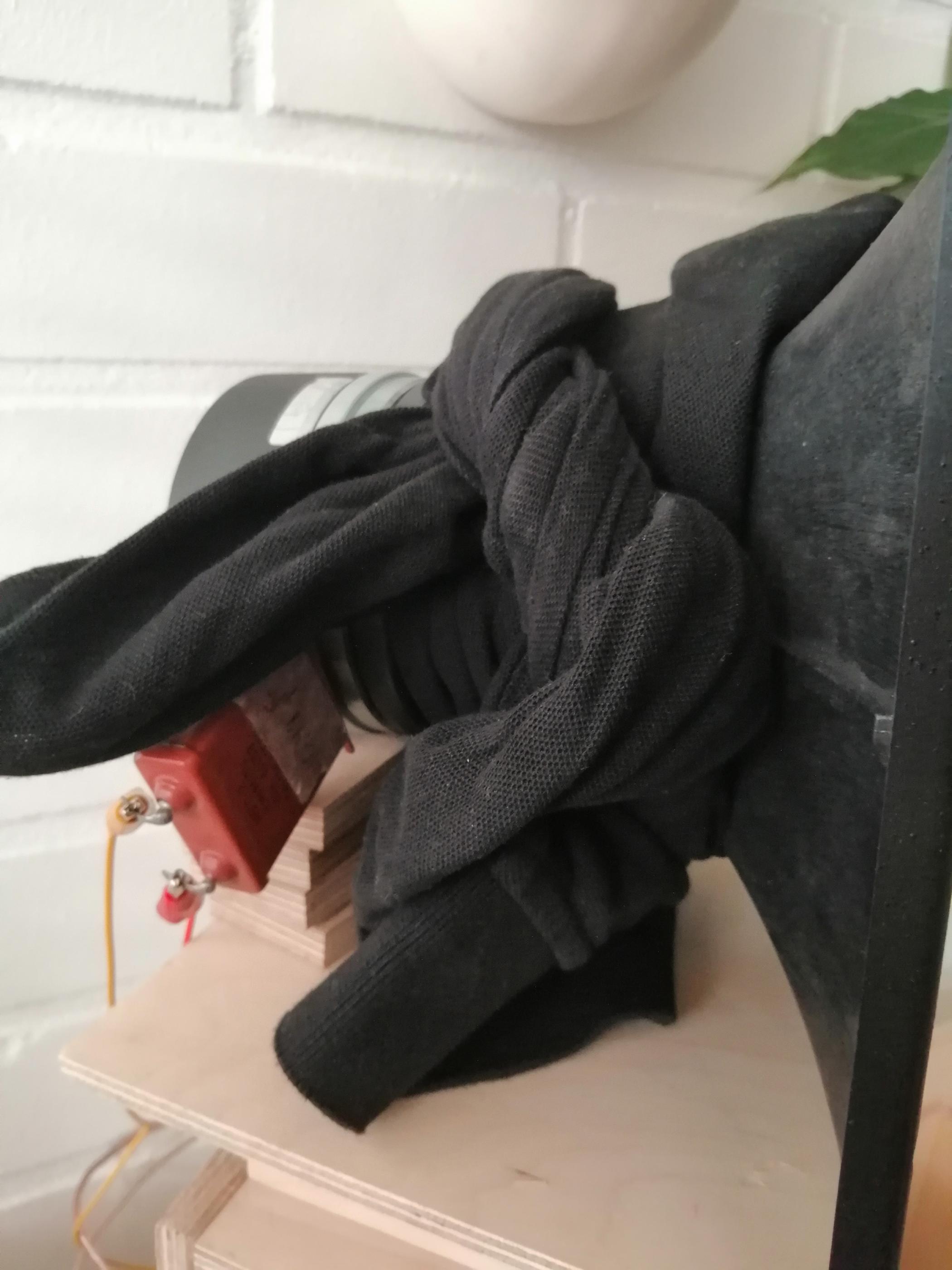

Birch plywood blocks under the CD works fine. attached is H100 on a birch plywood block stand with dampening t-shirt 😀 ps. The magnet is handy for holding xo parts.
you could make a clamp from plywood i think. Roughly, square piece, route a hole diameter of the driver in the middle, cut in half and grind some of from both. Drill and put bolts through the side to clamp the driver in between the halves. Solve problems as you go, never built one. Or make onlu U shape block, lay CD on it and tighten down with a rope. imagination is the limit!🙂
CD on it and tighten with rope
Hurry up with that final construction, you might need that sweater when the winter kicks in!

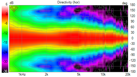

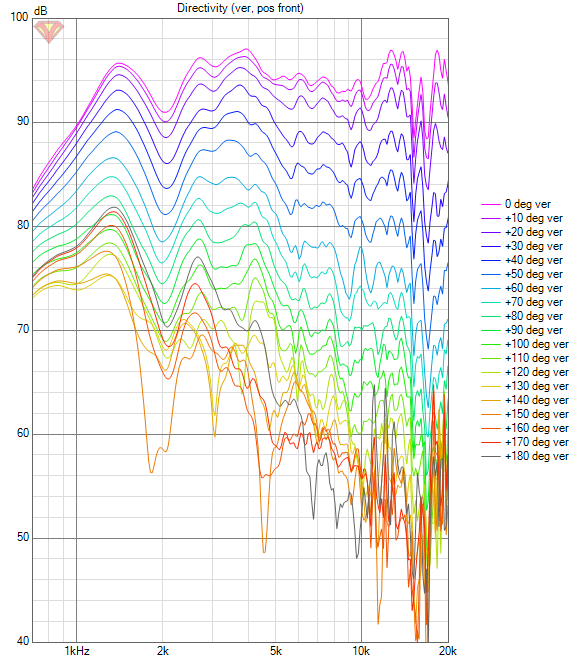

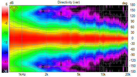

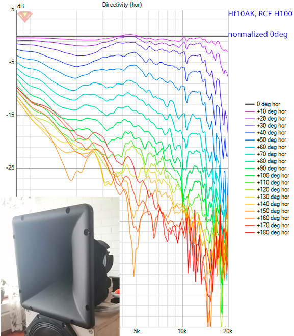

So many H100 measurements on one thread I'll add mine if you don't mind. It is HF10AK with the H100, ~10uF cap and l-pad in front. Level is not calibrated. Both vertical and horizontal responses measured on 15 degree intervals 0-180. The last attachment is horizontal response normalized to 0 deg.
I haven't been able to make as smooth looking xo transition to 8" driver in VituixCAD with the H100 as I could with smaller STH100. I think H100 is better match for 10" woofer. H100 is about constant directivity, STH100 has rising DI. I don't comment which horn yields better system since haven't compared side by side, both work fine.
edit. normalized polar maps added, looks fine.

Cheers for the measurements tmuikku.
Yeah, I am tempted to try the H100 with the 8PR200 boxes but not sure I can bare the faff if it isn't likely to be worth it.
One thing that I've been wondering about the HF10ak is the resonance peak around 1900hz not audible as a ring? Or at least measurable?
Hard to say, the valley on the graphs can be EQ:d flat since it is uniform to all directions. Easy with DSP, hard with passive xo. I don't think it is audible, I just fill it in with EQ and tune the boost by ear. I would have to measure the finished speaker to see how the response is with DSP but I'm not able to do that currently, need XLR - rca cables or wait for new amps to arrive so I can use my new DSP and audio interface all together.
With my old speaker prototype I was always uneasy with the mid range, something was not right. I think it was mostly the mid driver and enclosure fault because it feels much better now with new prototype enclosure, same driver though. Need to get accustomed to the current setup to be able to tune it better. Will buy another set of compression drivers and print a waveguide at some point, but new amplifiers and DSP first to get rid of the chinese ADAU+3116 noisegenerating setup. The progress is slow, too much responsibilities 🙂
ps. got better system simulated today after the previous post. I just had to lower the xo more to get smoother transition with mid + horn. Would need bigger capacitor to get response a bit lower still. I have to check out my old russian PIO stash if there is any. I've been into DSP so I don't have crossover parts bin 🙂

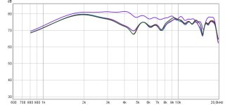

Did another quick measurement with RCF H100 + HF108 but something still ain´t right. Looks like one of the samples has a defect or so though I still hope it doesn´t! Unscrewed it from the horn and back on but no change to the FR.
Will get back with more measurements when I find the fault (or not..).
Oh forgot: this is with a 24dB-HP-filter (BW) at 800Hz.

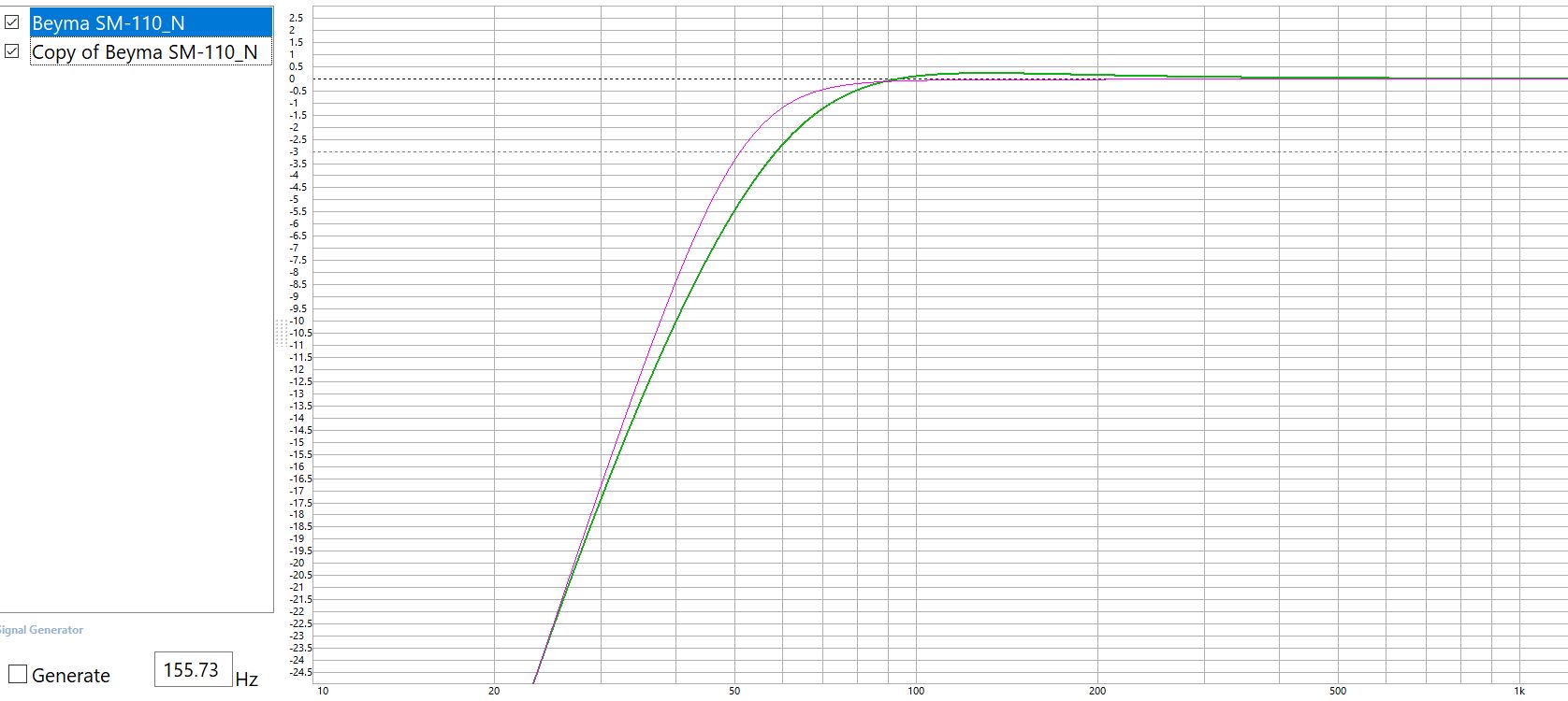

have a look at the Beyma SM-110/N, it performs stronger in a small 30 liter box than Faital and still has lower Mms than the Monacor that was suggested before (and that does simulate almost identical to the Oberton 10B200). I will observe your thread as I am currently downsizing my 12-inch + CD approach to 10-inch.
timuikku - cool, keep us updated on that!
joensd - hope it works out. Wish I had some advice for you, maybe start a thread about it and get clinical on it.
sheeple - cheers! the cheapskate in me had looked at these. a 40L cabinet is doable but it might put my wife in wince mode. The price really is attractive though!
