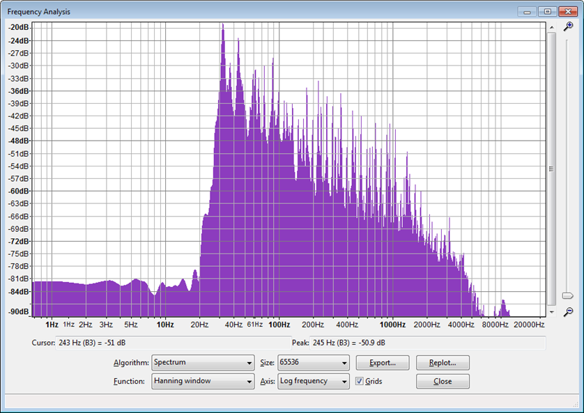

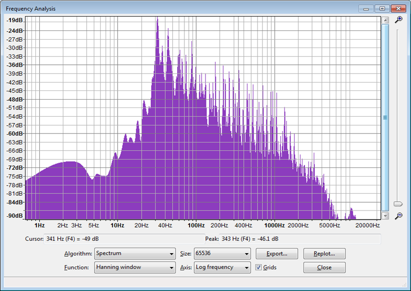

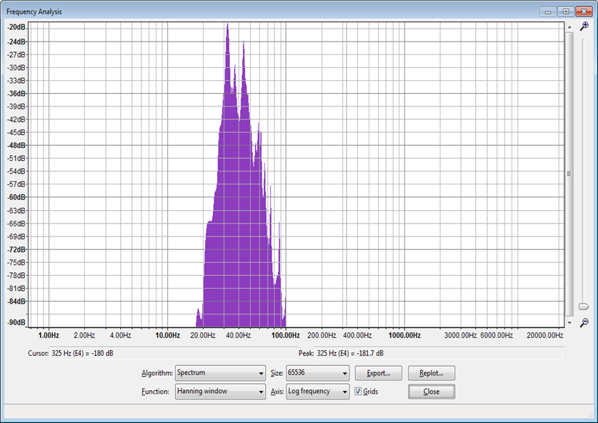

Wow! Your post brought up OLD memories of experimenting with MFB and EQ to extend subwoofer response flat to below 10Hz. This song was one I tested where it made no audible difference if the sub had output capability below 30Hz or not. It really confused me since that “shudder” sure made me feel it did. I eventually borrowed an HP spectrum analyzer to measure what frequency content was actually in the song, and it showed nothing below 30hz.
Of course that was 30 years ago. Now we are spoiled with the capabilities of free audio software. The results are the same though. Attached are *.zip files containing *.mp3 audio clips of the relevant section. One is untouched, another has a 28Hz HP filter applied, the third has a 28Hz HP and 50Hz LP filter applied. Pics of the spectrums for each file are also attached.
As you can see, nothing going on below 30Hz. The 28Hz HP version sounds exactly like the untouched version. So, what is causing the “shuddering”? It is beating between the closely spaced 32Hz, 37Hz, and 44Hz tones. The HP28_LP50 version of the clip lets you more easily hear just the bass tones and the beating. If you are unfamiliar with beat tones, you might check these links (both have examples you can listen to)
Beats. From Physclips
Beats
I have read that sometimes low notes on pipe organs are actually “faked” with beats if full length pipes are not possible due to size constraints.
Just for grins, I generated a *.wav file containing the 3 individual tones at the same amplitude shown in the spectrum analysis. First each individual tone is played separately, then the 32Hz and 44Hz together, and lastly all 3 together.

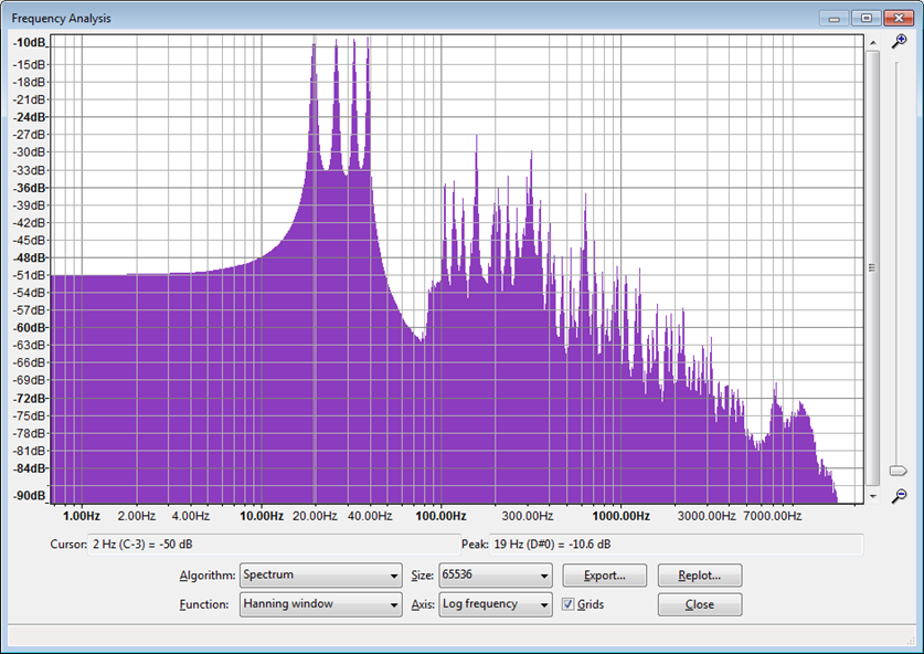

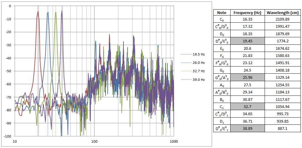

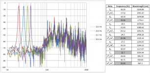

Can't believe I forgot, if you want to listen to an Enya song that has high level bass content below 30Hz,
you can download a “Rebassed” version of “Only Time” here: (link is in comments) YouTube
A clip of the song showcasing the descending bass tones(39, 33, 26, 19Hz) is attached in *.zip file.
Pics of spectrum analysis also attached. Silly loud bass, but kinda fun in small doses.

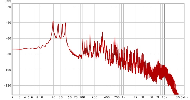

Screwball music. Easy to listen only if your system isn't able to put out flat volume below 30 Hz. The house shakes with my 17-foot 12 Hz pipe. Who is the intended audience? Interesting to see drop south of 100 Hz. Cooked, all cooked... but is it nice?
And here's a replication of Bolserst's zip. On the money which only proves my gear is OK.
Gear: 2010 MacBook Air, iTunes player, out the headphone jack to DAC, in USB from my $4 early Sound Blaster DAC from the Salvation Army store. Elsewhere I have posted how satisfactory is the built-in laptop mic too.
Thanks, Bolserst.
Sure wish I could figure out how to do an RTA with REW without going in and out of the Mac headphone jack, excellent as that is. Anybody?

As mentioned, this is a “Rebassed” version of the song.Screwball music…Who is the intended audience?
The original is much more artistically consistent: YouTube
The intended audience is those who like bass for the sake of bass. It’s actually a rather large and growing segment of audio enthusiasts which started in car audio and has begun to spill over into personal home theaters with single digit frequency capable subwoofers. It may not be something that interests you or think you would find enjoyable, but you might seek out a local mobile audio convention just to experience what many are enthralled with.
A few examples of the Enya song being enjoyed linked below. (hair and clothing fluttering to the bass)
Searching for “rebass” on youtube will bring up many many songs that have been similarly enhanced for bass aficionados.
YouTube
YouTube
Obviously the recording mic is being clipped by the 150dB+ bass output, but you get the idea.
The Enya track is interesting to me because of the uniform loudness of the stepped tones, the fact that they are pure sine tones, and include one just below 20Hz hearing threshold. Basically if you can hear it instead of just feeling it, your woofer is adding distortion to the pure tones. A nice test when comparing MFB subwoofers with non-MFB subwoofers.
