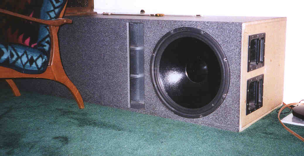

Yes, sub-25Hz is mandatory
I would say 10-25Hz is definitely mandatory, as there are several sources such as pipe organs, explosions, cannon fire, etc, that create frequencies in this region. Back when I had an audio system and some audiophile friends, we got together to try to solve this dilemma. We settled on a TL type design, and the only low-fs woofer we knew about back then was a Radio Shack 18” with Fs of 16Hz. The first attempt yielded a cabinet resonance of 10Hz, the second, a bit smaller, ended up at 12Hz. So we actually missed the 16Hz target, but in a beneficial way. Here is a picture of the larger of the two subs.
It was interesting using a signal generator to find the Fs of the combination; at around 13Hz the windows and garage door were also resonant and rattled noisily even though we couldn’t hear the sub working, though it could be felt some. 👍

I'm sorry Daveis but you wont be able to hear sub 20hz. And even at 20hz it will take 120db for you to even start hearing it as that's the threshold of human hearing.
