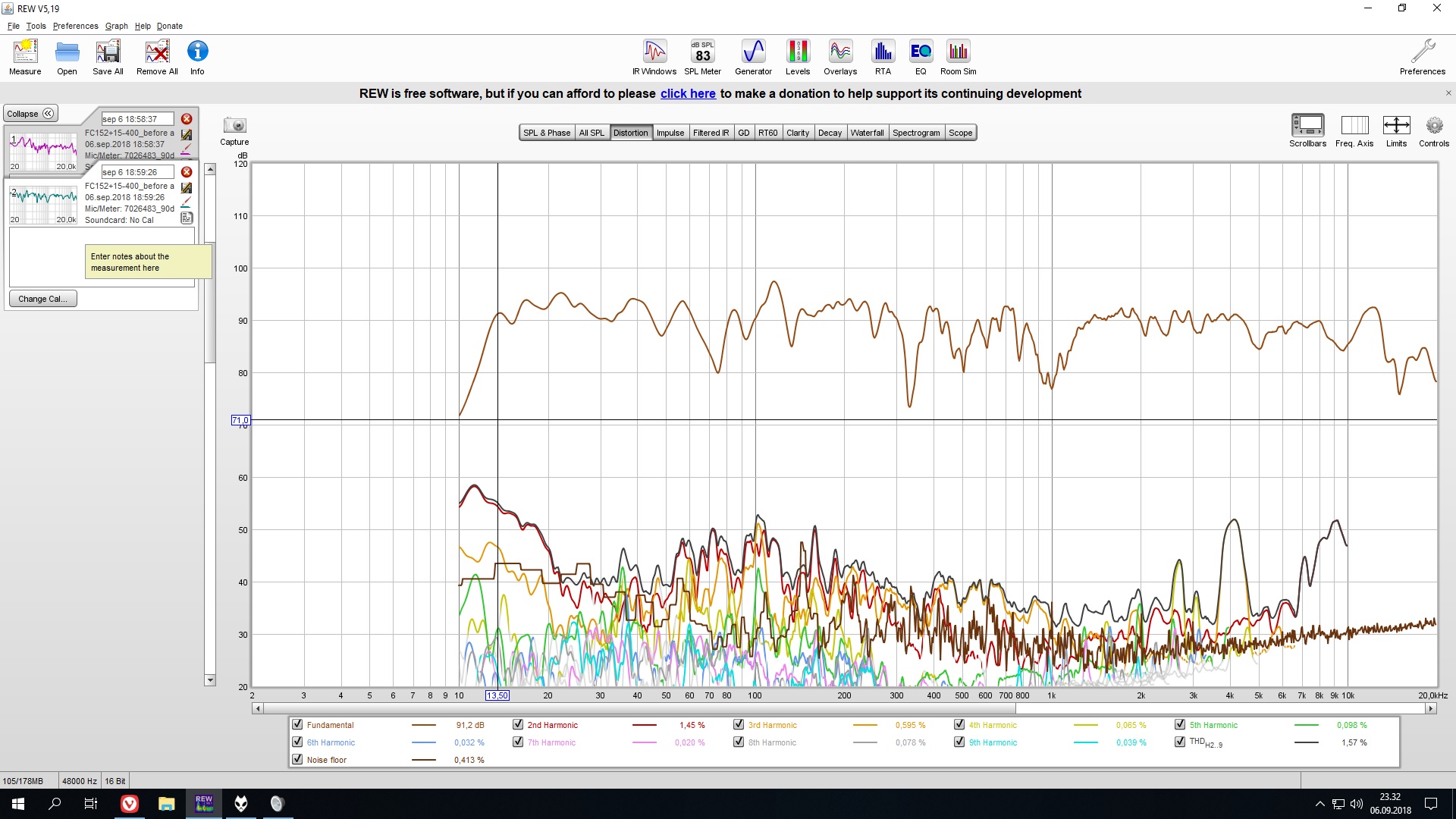

Tell me more.....Got flat response to 13hz in-room, unexpected bonus.
Was aiming for slow roll off to 26hz.
Measured about 1.5% distortion at 13.5hz, which is about the highest distortion in the useable frequency range.
It's in my way to long and slightly ridiculous plan + build thread.
Budget 40-10k+hz 100db/w planning
Here's a link to the measured distortion picture.

The response between channels even out "nice enough", not the prettiest squiggly lines around, but I am not a believer of pretty squiggly lines. Makes me think something is missing. Do note that the measured response was with no xo at all, because I had severe issues implementing any crossover at all, tried so many tricks to get it right, eventually decided to try without.
The measured response was using 5 bands of EQ, and nothing more. Just to make the lines "pretty enough for presentation".
My day to day use involves 2-3 bands of EQ, sounds much better, but less pretty.
