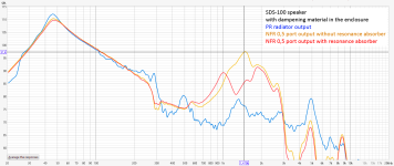

When planning, simulating, building and measuring bass reflex enclosures for 2-way speakers one difficulty is dealing with port resonances in the midwoofer’s passband.
I thought it should be possible to absorb resonances with Helmholtz resonators in/at the bass reflex port.
Obviously I am not the first to come up with this idea, but I also didn’t find very much about it on the internet.
Thus I decided to make my own measurements, see the following posts!

Option 1: tube absorber
Simple tube, one end closed, it should thus have roughly half the length of port for absorbing resonance of port fundamental; can either be parallel (and inside) the port or 90° perpendicularly mounted at port. Open end should be located at half port length.
Option 2: Helmholtz absorber
Mounted at half bass reflex port length, connected by its own small Helmholtz port to the bass reflex port

But I think I already found what I was looking for in terms of absorber, see post #251.
The challenge now is to find a port that can keep up with passive radiators. Investigation still ongoing.

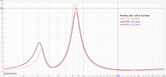

I will provide a comparison between passive radiator, NFR=0,5 port and NFR=0.2 port in the next postings!
as with the previous version the excel sheet is protected except user data fields just to avoid unintended changes, but there is no password protection, so feel free to unlock and change it!
lower NFR value ports start compressing earlier

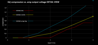

I am probably missing something here. When I look at the Monacor data in post 704, on every graph, the low NFR port called “3D Big“ always looks like it produces less compression than higher NFR port “progr big” and the same comparing the two smaller versions.
I don’t understand how these graphs show any advantage for higher NFR. Any help appreciated.
Like I said, probably I am missing something.
You are absolutely right and there might be a problem with my simplified assumptions. Thanks for pointing this out!When I look at the Monacor data in post 704, on every graph, the low NFR port called “3D Big“ always looks like it produces less compression than higher NFR port “progr big” and the same comparing the two smaller versions.
The problem with my graphs is they suggests to compare port geometries as a "ranking" but in fact they don't.
The ports are very different in size and geometry and I used the graphs to look for correlations which (I think) I found.
According to my findings the limiting factor for the "progr big" port is it's small middle cross section in relation to the displacement (leading to low MPSN).
The lower NFR 3d_big port has a much wider middle cross section and is better in this case.
I took three ports, the two you mentioned and a third one ("BIG") and isolated the compression/input detail graph:
The "3d_big" and the "progr_big" port result in a tuning frequency of 34,5 Hz. At this frequency mainly the MPSN limits the "progr_big" port.
There indeed is no advantage in the low level area for the higher NFR port.
But if you look at the red "BIG" graph, this port resulting in a higher 50 Hz tuning (thus less critical for MPSN and in addition this port has a bigger middle cross section area) has NO compression at all at low levels.
This and the statements in the roozen and salvattiet al. papers is why I suggested that a higher NFR port has advantages for lower levels.

Impedance measurement:
The PRs low impedance peak difference is interesting but probably not surprising, considering the PR system's higher order and steeper low rolloff.
also notable the slightly lower tuning of the PR version.

compression:
The reference value for compression rate shown here is the lowest voltage (0,25 V rms) for all speaker variants.
I already expected the PRs to be slightly less linear at low levels, but not so evidently!
Above 0,5 V the PRs are very constant up to the maximum level.
The ports have a slight "inverse" compression effect at low levels but then compression raises constantly. Up to 2,5/3 V the ports compress less than the PRs.
Both port start making audible wind noise above 1,5 dB of compression.
The NFR=0,2 port makes audible chuffing noise from 4 V up (strouhal number = 2,2 and MPSN = 30) with a slight chuffing peak at 1,4 kHz, the port's length resonance, but noise is still quite acceptable compared to sharp edge ports. The assumption that a low NFR port behaves better at low strouhal numbers was not confirmed. I suspect low NFR ports need a certain length to behave that way.
The NFR=0,5 port has no resonant chuffing behaviour but starts to make low frequency turbulent noise above 5,6 V (strouhal number = 1,5 MPSN =16), which is not very offensive, but clearly audible.

Influence of dampening material in the box
I "lined" the same test speaker (see #753) with two 12cm wide, 40 cm long strips of egg-crate foam positioned at the side panels and a piece of wadded natural wool (or cotton?) fleece on the bottom of the speaker.The speaker is far from being filled up with dampening material to avoid absorbing the useful bass energy and the dampening of the enclosure could of course be optimized further.
Here are the responses without dampening material in the enclosure for the PR, the NFR=0.5 port without absorber tube and the same port with absorber tube (6 cm extension air pump with 3 cm basotect):
and here are the corresponding responses with dampening material in the box:
as I mentioned before the best solution would be to include a lined stiffening board between driver and ports/PR in the enclosure and turn the speaker into a MLTL. The layout and TL development can be simulated and optimized e.g. with hornresp.
By the way, does anybody know what causes the even PR/port output slope to suddently plummet at about 300 Hz?
I cannot replicate it with hornresp simulations.
Is this related to enclosure dimensions? or distance between driver and PR/port (which is not the same for PR and port, by the way)?
