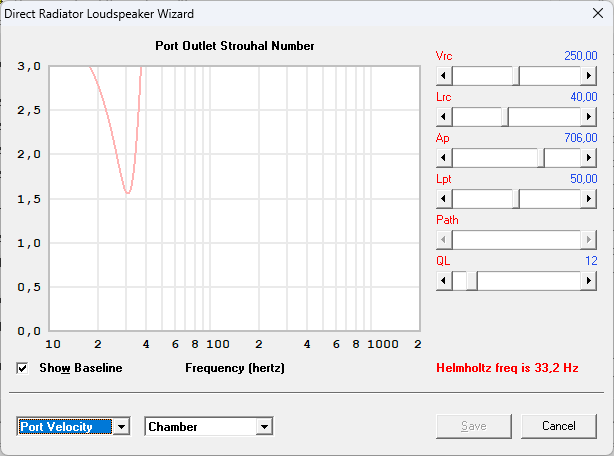

2. finding a suitable port mouth size to keep strouhal number in a safe range
I would then switch to hornresp for convenience, because it can output strouhal number graphs directly in the loudspeaker wizard.
It is still possible to calculate the strouhal number using the air velocity data, the tuning frequency and the port radius, see here.

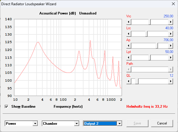

your specified data:
volume: 250 l
tuning: 33,2 Hz
desired output: 125 dB/1m
I used your values for the port and (surprise!) the tuning in hornresp is exaclty the same. But hornresp also shows the resonances that a 40 cm deep undampened enclosure will produce (I just took an arbitrary depth value).
Now I switch to the port air velocity graph and press Ctrl and click twice for the Strouhal graph (thank you once more, @David McBean!):
The strouhal number remains just above 1.5 at all frequencies - that's perfect!
If the graph would go below 1.5 I would simply increase the port surface slightly while keeping the tuning at 33.2 Hz by adjusting port length.
Increasing the port surface increases the port radius (thus increasing the strouhal number) and at the same time it lowers the air displacement which also increases strouhal number. So usually a small change will be enough.

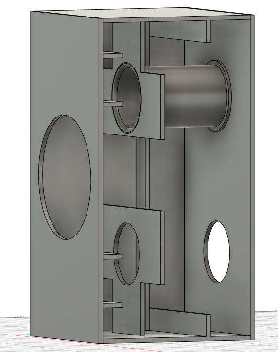

Wow, cool, thank you very much! Yes I'm going to build one first and with detachable panel so I can tweak the ports if necessary.
Good point about the heat! I'm planning to use PETG for prints, melting temperature 230-250C which should be enough. And thanks for printing tips, the ports are likely part of bracing so they should be strong for many reasons.
Driver is middle of the longest dimension to kill the first mode so one big port is tough to locate other than directly behind the driver, and likely emits all the driver noise. The two ports are positioned to reduce box modes leak, at least in theory, Keeping everything symmetric should keep the modes at bay.
Goal is very high performance, and it's about same amount of money and work in construction as any other similar size subs, if this planning stage is not counted in, so why not try 🙂 this is also my first high output system so let's see, many changes to do errors and learn.
Current sketch attached, I need to think more about the bracing, it's possible to make inlet of the ports terminate in panel just like the outputs, and there is good chance to do CLD with the bracing but need to first calculate how much plywood I need for the whole project and then cut sheets, and figure out how to put it together. Also driver could be mounted from behind and even the magnet could be secured to the structure if back panel is detachable.
Thanks again! I'll keep you posted after some results. The project spans several months though so might take some time before I get to measure.

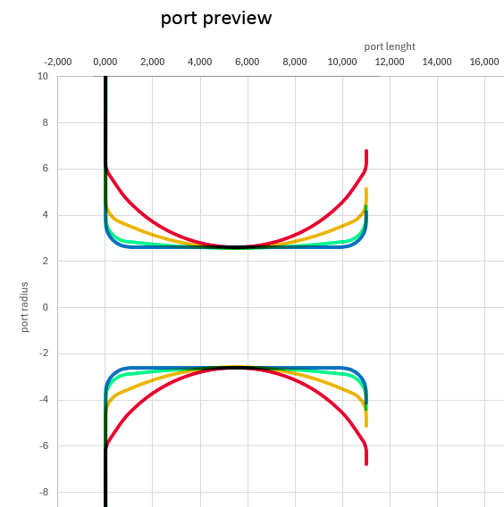

Just a quick sign of life.
I am continuing to develop the Excel tool for flared (variable NFR) ports.
I think the tool lacked quite some usability.
So here are some planned improvements:
  • the input of exterior port diameter and NFR is somewhat unintuitive. I will change it to exterior and minimum diameter input with calculation of resulting NFR.
  • I tried to make a rough port section preview based on an excel point graph. this should give a quick feel for the port dimensions.
  • input field for speed of sound will be less prominently placed, because it may lead to mix up with port air velocity.
  • there will be an input field for maximum desired port output SPL at tuning frequency - keeping in mind that the total output will be slightly higher with the driver output added.
  • based on the desired SPL and a formula posted here I will provide calculation of necessary air displacement and resulting max. port air speeds, strouhal number and MPSN at tuning frequency. I will add a comment stating that strouhal number will be slightly lower just below the tuning frequency (this can be observed in hornresp).
  • I will provide warning messages for any dangerously high or low resulting value (e.g. max absolute air velocity limit of 30 m/s; min MPSN based on the port length/min-diameter relation between 20 and about 40). using these warnings it should be possible to adjust values to get a good behaving port geometry.
  • metric and imperial versions will be included in the same file on two different spreadsheet tabs.
feel free to comment!

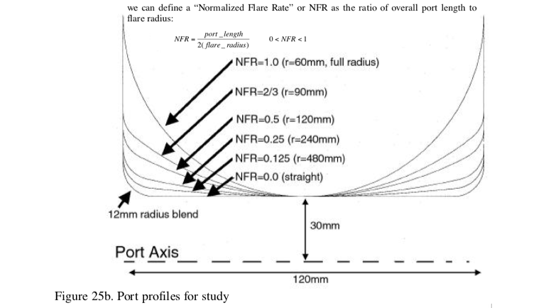

port geometry preview in the excel tool:
Reactions: tmuikku

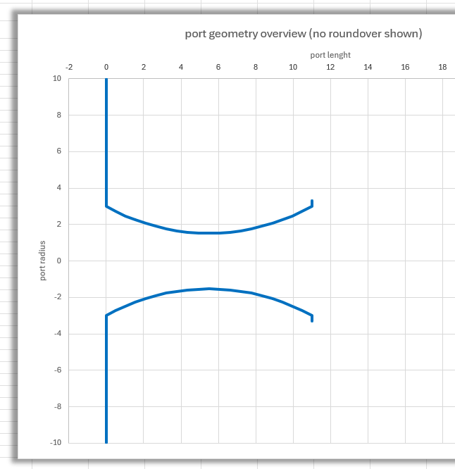

Most commercially available "flared ports" are straight with a radius at the end, a "Normalized Flare Rate" of "0".
Appears you are eliminating the end radius, which changes the exterior port diameter as used in the AES paper" Maximizing Performance from loudspeaker Ports" that coined the "NFR" term.
No, that's just a simplification of the excel graph - but I'll try to include it. Just needs some trigonometry to convince excel ...
Yes - and it's a pity, because higher NFR ports are so much better. But I know straight ports have the advantage to be adjustable to any length. But 3d-printing might be a solution.

At this point these are theoretical, and performance will see upon built. The above image port has very small final roundovers and had to shrink the port a bit to fit bigger. If I have enough filament and time I might print both and see which works better to find good balance for NFR and roundover. Max diameter of the device is limited by my printer bed, and the final roundover robs quite much of port area. Bigger could be done in multiple pieces, and not sure if I can actually print this succesfully anyway. Time will tell, printer has arrived in mail so project starts somewhat soon and ends at some point 😀 It's always a slow process to do this stuff with all the real life happening.

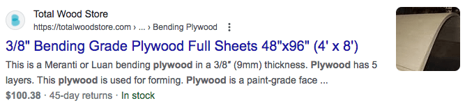

I'd prefer using bending grade plywood, especially for large displacement ports.
With some creative clamping prior to final assembly, an exact Fb could be achieved with a small variation in the center width.

Will it have an option for the rectangular or square exit ports as used on most commercial cabinets using NFR profiles?
Reactions: stv
I am using the formula as proposed by salvatti/devantier/button that refers to round ports, with a correction factor based on actual speakers built by augerpro and me.
But I already did one example of a round and rectangular width-flared very flat port post #469.
comparison of width-flared and height-flared port impedance (the latter makes more sense and is similar to the example you posted!) in post #494 and subsequent, #498 compares noise spectrum and compression behaviour of round and height-flared flat port.
the examples I used are very small and inaccuracies may have quite an influence, but generally the flat port has a very similar tuning and seems to behave slightly better.
I think that any cross section shape with similar surface should lead to a very similar tuning.
The geometry defined via NFR has circular walls for round ports, but translated into a constant width port the curved port walls would need to follow another shape (elliptic?) to follow the same cross-section-surface development.
But as the most relevant section of such a port is the middle narrow one I suppose a slight deviation from the idealized geometry would not make a huge change.
Anyhow, I might try to include an option for a rectangular port geometry...

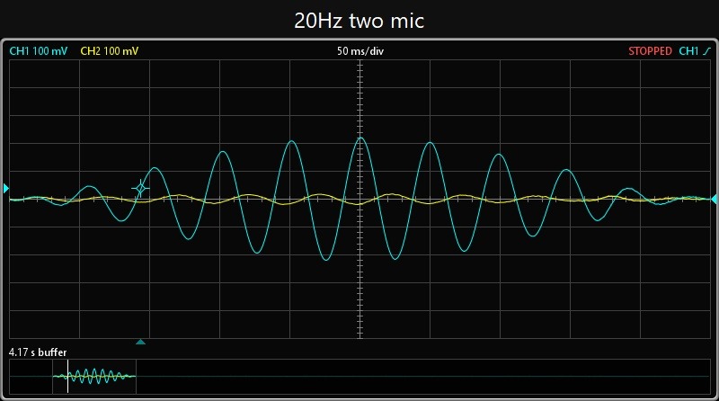

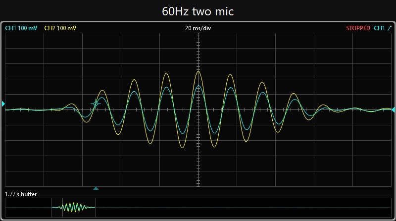

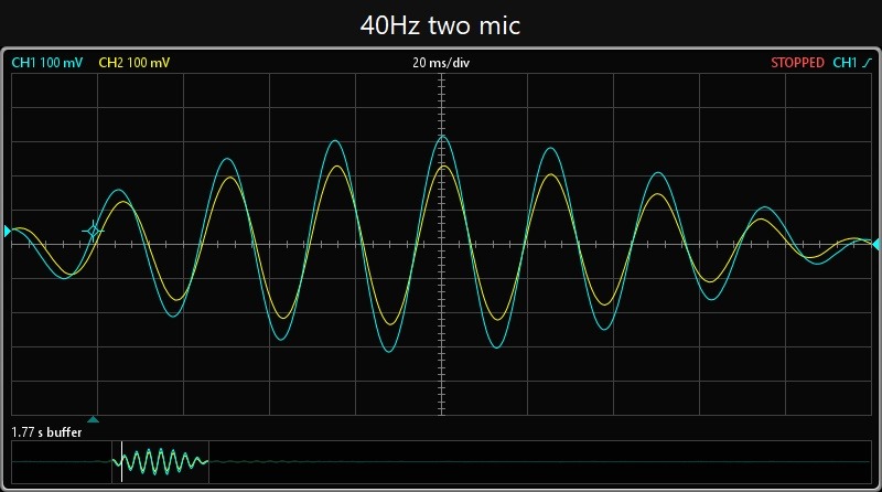

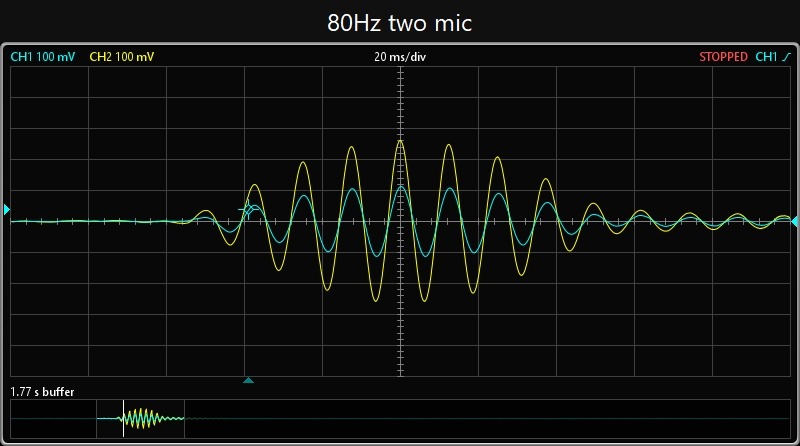

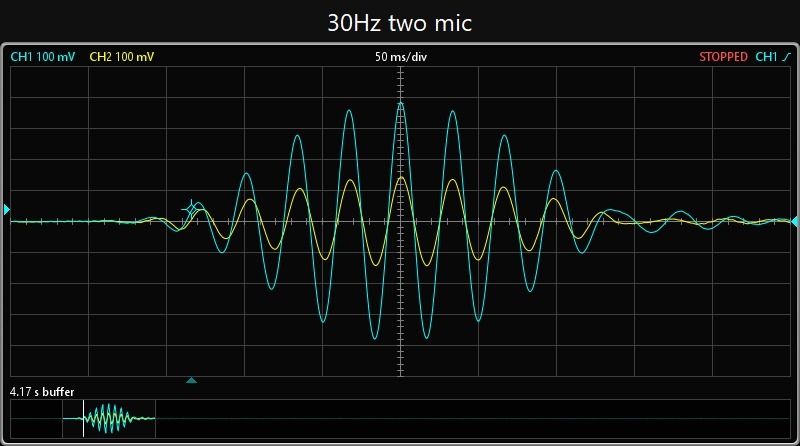

Hi stv, hope this is cool...jumping out of the RIIR thread to continue with port timing...
And thx for suggesting longer bursts. I had bee wondering if Helmholtz resonators perhaps took a certain number of cycles to begin resonating.
first, @ juhazi. Yep, I wasn't exactly happy with the single-cylcle flat-top burst, in terms of what how scoped electrically vs acoustically.
Playing around, I've found a cosine window matches the two much better.
So I've made some 8.5 cycle cosine window bursts, using two mics, one stuck in front of the direct cones, and one stuck at the port.
Both mics are equidistant from the front of the subs.
I spent a little time to get the two mics reading the same output voltage, so that the scope traces show relative outputs as well as relative timing.
(There's a snip of Hornresp's direct and port contributions at the bottom, for comparison with voltages.)
In all screens, Yellow is the direct radiator. Blue is the port
All the above are above port tuning at 25-26Hz.
Here's at port tuning 25Hz....still same polarity.
Now below port tuning, with a polarity inversion between the two.
Ok, I think it's all correct, but I don't do this very often so there's always room for error.
Assuming all is correct, I can't see any lag between direct and port.
