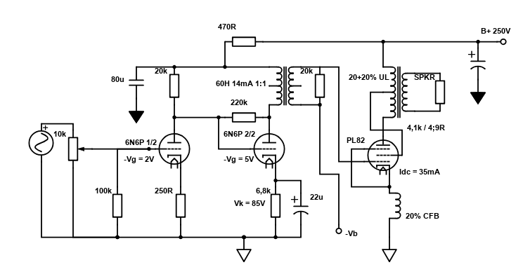

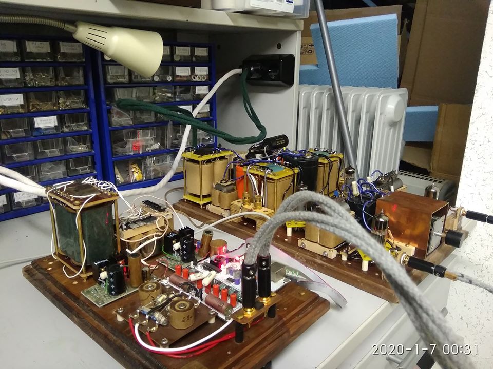

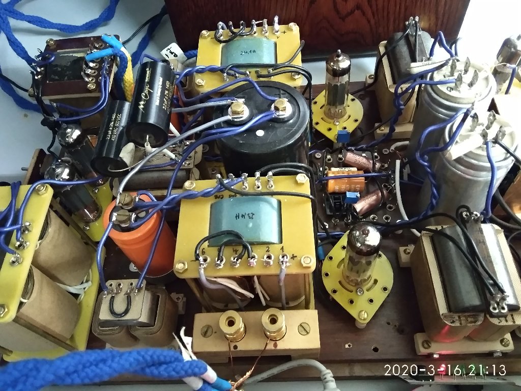

I highly recommend trying a CFB SE amplifier. It retains a lot of SE magic (immediacy and intimacy), while having clean, punchy bass and lacks that typical high level SE distortion most amplifiers do (for good).
The DF of this current prototype amplifier is 7,8. I can even go higher if needed.
This prototype board to the far right is built with a PL82 tube.
The power supply is single transformer, tube rectified with PY82, then LC (split) LC.
Thanks to Mr. Patrick Turner, there's a lot of useful info of CFB + UL amplifiers on his website.
AmadeusMozart,
Bifilar transformers are 1:1. You get the same input and output impedance.
Bifilar means the two wires are side by side for the complete length of the wire (all turns are side by side, to make it essentially unity coupled).
A good example in audio is a 1:1 interstage transformer.
Perhaps you meant unity coupling audio transformers that use bifilar windings, the plate and cathode wire pair are wound side by side.
Sounds like something done by McIntosh and perhaps a Fisher model or two.
Unity coupled plate and cathode requires Extremely high voltage swing from the driver.
In push pull outputs, that is often done by cross-wire connecting the top of the driver plate loads to the output plates (Positive feedback). In solid state, this is called bootstrapping.
In single ended, there is no way to cross wire the driver load to the other output stage, there is only one phase of SE output.
But Global negative feedback needs to wrap around these stages to get the distortion back down (compensate for the positive feedback).
It is interesting that in order to use the local negative feedback of unity plate cathode coupling to get distortion reduced, the circuit also uses positive feedback to the driver stage to get the extra required driver voltage swing, which increases the distortion.
No free lunch.
