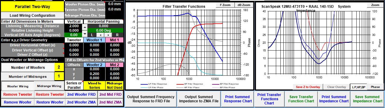

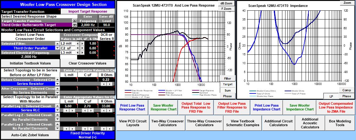

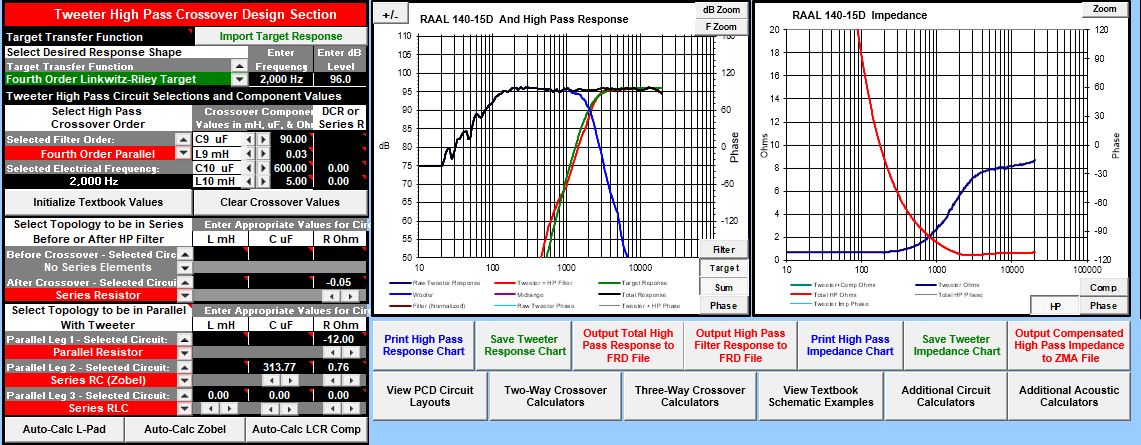

This being my first crossover I need to be corrected and advised to do it right. This is what I have done so far using software "Passive Crossover Designer". I am posting few pics below.
I would like to know what am I doing wrong and what to improve and do correct.

By looking at the component values for the HP something is not right, very odd values.

The impedance with two 12MU's in series and RAAL should be min 9 Ohms rising to above 15 Ohms in the tweeter range, considering the needed padding resistance.

HP section values 90uF, 600uF, 5mH,... they are toooo high.

This is a very rough simulation based on traced FR and Impedance curves for both drivers (12MU 2Xseries) and is only a guideline of what is to be expected in the final system impedance. This is not an actual representation of the baffle/box you will be using, for that you need to measure. I did not use your zip files but my own tracings.
See attached:
See attached:

This is what I am getting as a result by inputting your values.This is a very rough simulation based on traced FR and Impedance curves for both drivers (12MU 2Xseries) and is only a guideline of what is to be expected in the final system impedance. This is not an actual representation of the baffle/box you will be using, for that you need to measure. I did not use your zip files but my own tracings.
See attached:
Tweeter Inverted Polarity.
OK so this is different than the initial 1-Ohm diving curve, now the impedance looks as expected. So go on from there and tweak.

The only correct way is to use the measurements from the actual speaker/box. What I showed was only a guideline, which does result in a predictable Impedance, and is a possible starting point for further refining.

Correction: the simulation was done with the 8 Ohm version of Scan 12MU and not the 4 Ohm, by mistake. But the principle is the same...Lower L1 inductor for the LP, lower series R for Tweeter padding.
