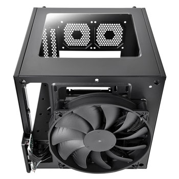

I plan to mount this entire amplifier rig (with a bunch of other things) in a mini-ITX computer case with a large fan:
Sorry, I don't see any clear markings in the core. Any ideas on what else I can do to improve this amp?
