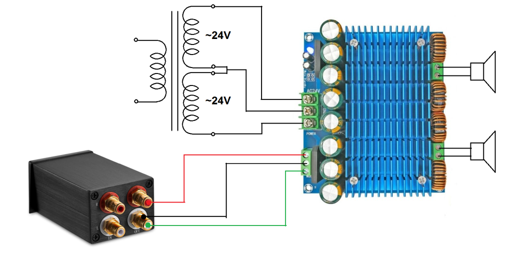

I need help wiring this board.
The power and audio input terminals have a ground with which I don't know what to do. I got a toroidal transformer with dual 24V ac outs while this board requires 24V as well. I've read about how the dual outs can be wired in series and connecting one end of the connections to the ground but this would add the voltage to 48V. Should I get a 12V dual out transformer and wire it in series instead?
Also, what do I do with the ground terminal on the audio input if I want to connect L and R rca connectors?
All is described in this picture: https://luckyretail.com/Uploadfile/201806062/159570/159570-7.jpg

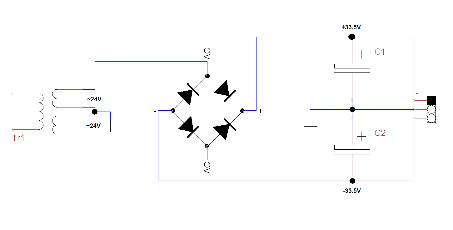

If your transformer has separate secondaries, then see this picture: http://sound.whsites.net/xfmr8-1.gif
You need the right part - 0V connect to the GND.
The inputs connect to the signal source, preferably with 10k A-type logarithmic potentiometer.
Thanks for the reply. The 2nd picture is exactly what I was describing but I would need dual 12V outs in series to not go over the max voltage of this board. I don't know why the first picture recommends dual 24V outs when you have to wire in series to connect to the ground which would add the voltage to 48V 😕
I purchased the wrong transformer for it but I guess I can use this on an IRS2092S with rectifier board for a subwoofer project.
If your transformer is 2x24V - it is suitable!

Ah, I see now thanks. No more problem with the power supply but I still can't make the audio input work. How do I wire it to a pair of rca connectors without a potentiometer? How do I deal with the ground pin? I already have a passive preamplifier that I will use so I don't need a potentiometer.
Yes, that's what i'm trying to do 🙂
The preamp is something like this:
Amazon.com: Nobsound High Precision Passive Preamp Volume Controller VOL Control HiFi Preamplifier ALPS (RCA&HiFi Version, Black): Home Audio & Theater
I want to be able to connect the audio input of the amplifier board to the rca out of this kind of passive preamp but I don't know what to do with the ground..

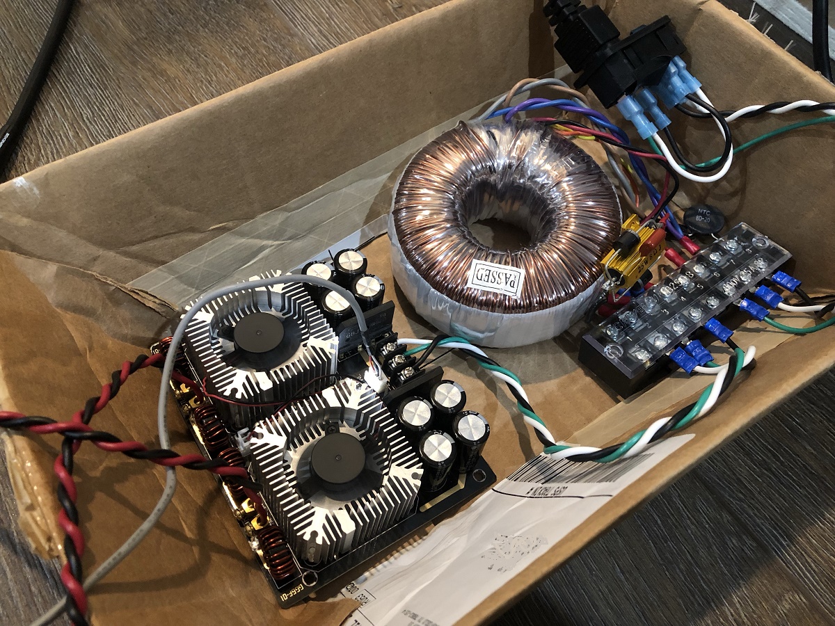

I finally got around to hooking the amp up and everything worked well 🙂
I can't really use it with my main speakers running on active crossovers yet (Fountek NeoCD3.5H + Vifa NE180W) but I tested it on my pair of Usher S-520s and they sounded good! Full and impactful, in contrast to how these speakers have a tendency to sound bright and thin with some hardness in the upper midrange with some equipment. I did not get this sound with this amp at all.
There is a slight hum on both channels that is audible when you put your ear really close to the drivers, but inaudible even less than a meter away. The heatsink gets rather warm in 24V operation but even a very slight breeze from a distant fan is adequate to keep it manageable.
Other than these, everything's good. I look forward to getting this setup fitted in a proper case.

Just tested this amp. No switch noise from fan. No hum or hiss. Using with 25V 250VA Avel Lindbergh trafo. Using 10R and double diode GLB between earth GND and center tap GND. Tested on 90dB speakers and could barely hear any noise or hum with ears pressed to speaker come.
Fan noise is loud. Could add a power resistor or string of diodes to drop speed. Does not need to be this fast.
Tested on 82dB multi-way speakers and definitely a lot of power for bass kick drums.
Fluke 101 measured 200uV rms noise at output. About 50mV DC offset.
