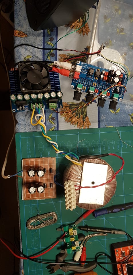

Help! X-M252 noise
Hi All,
Taco5000, im very sorry for my poor name choise... 🙄
Nevertheless, i have bought an X-M252 Amplifier, and im getting some horrible noise from it...
I have tried alot, to no avail..
The noise im getting from the amplifier is a 200Hz hum. (This is measured with my phone close to the speaker)
The setup im using is a toroidal transformer (24-0-24), and a pre-amplifier (See below)
NE5532 OP-AMP HIFI Preamp Preamplifier Volume Tone EQ Control Board Module HighQ | eBay
The hum is originating from the amplifier, but it is quite low when only the amp is connected to a speaker.
As soon as i connect an input to the amplifier, the noise/hum gets louder. When the pre-amplifier is connected, to the amp, the noise is at its worst (compared to just RCA connectors directly into the amp). The noise hits its highest, when the volume pot on the pre-amplifier is turned all the way down. When i turn the pre-amp up to half volume, the noise is at it's lowest.
All wires to and from the amplifier & pre-amplifier are twisted to keep out noise (as much as possible).
I have created a DC-Filter to the mains, just before the transformer. This helped a bit on the hum.
It is also worth mentioning that i can hear my transformer hum when i place my ear next to it. It is not that loud though.
Can anyone point me in a direction? I'm all out of ideas of what to test next..
Best regards

Yes, please see below:
First, disconnect the preamp and the fan. The little PCB is some kind of dual rail switch mode DC/DC converter? For the fan use entirely separate PSU... If you load a symmetrical PSU with not symmetrical load - there is one reason for hum and noise...
Second, the transformer is with 2 separate secondaries? Are the two voltages the same? Did you connect in the correct order the secondaries?
They have to be connected like this: (+)_(-)-(+)_(-), where + and - are the current phases of the two voltages.
Then connect the two inputs to GND and see what is at the outputs.
The outputs have to be connected to loads! Resistors or loudspekers!
I see also, that you have a DC blocking module before the transformer - it's OK, but see with the oscilloscope what is the shape of the secondary voltages. If needed, use resistor deviders.
And isolate the DC blocking and mains cables, to not touch them by accident!
Thank you for your help with this!
Yes, the preamp is powered by a +-15V switchmode PSU, this is fed from its own 5V psu (5V phone charger). This setup works just fine on other amplifiers! - The fan is also powered directly from the 5V phone charger aswell. (The fan was added yesterday, just to see if it could cool adequate with 5V input - I did not add or remove any noise from the system)
The transformer have two secondary windings, both 24VAC. I see your point in loading with a symmitrical load. But even with two speakers hooked up, (symmetrical load) the hum is still there!
Oh, that is a very good point, with the current phases of the two secondaries.. I must admit that I did not think of this! I would guess i can see the current phases with my o-scope(?).
I presume you mean that I measure the AC/DC voltage on the output terminals with the speaker plugged in?
If there is a voltage difference on the secondaries, do you suggest that I equal them out by using power resistive divider?? I just need to understand you correct!
The DC blocking PCB is taped on the button to avoid accidental short circuits!! - But this is only for testing purposes! I absolutely hate working with exposed mains wires. This DC filter was one of my attempts to remove the hum.
