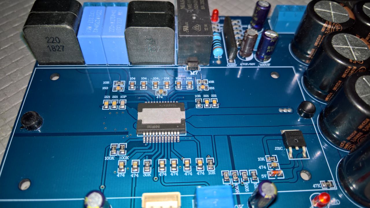

The output filter is 22uH + 220nF, but the capacitor should be 470nF, according the datasheet!
Before the first power-up, I soldered 1.5k resistors at the outputs, before the relay contacts and 100nF capacitors in parallel of the 220nF.
The volume pot is 50k! It should be 10k...
There is little white noise, heard in the high frequency drivers, but at very close distance.
My transformer is 2x21-22V AC, which gives about +/-28-30V DC at the filter capacitors.
The 5V line is derived from a zener diode and transistor, which do not touch the heatsink!
There was white termal paste on the chip. I cleaned it and put Arctic Silver 5 paste for CPUs 🙂
At idle the heatsink and the output inductors are little warm. Not tested yet with strong signal.
The switching frequency is set to 340kHz.

I am happy to hear that also you got your board.
The 1K5, is that to give a minimum loading during start-up?
I haven't removed the heatsink (yet). Is the 5V for the relay circuit?
My tweeters may not be as efficient as yours or my ears are simply not as good as yours - I recall no white noise.
Good luck with it!
Yes, the 1k5 resistors are for the minimum loading during the start-up.
The 5V supply is for the Mode pin of the TDA8954 chip.
I use pro speakers, which are with 94-95dB/W sensitivity.
These days, after work, I'll try to make some measurements with the scope.
And there is big switch-off bump in the speakers. On switch-on the relay is properly delayed and there are no problems.
