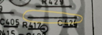

@poundy - OK, I'm back after 'xmas now, and have pc (& Kicad) access again...
Good to see the schematic progressing: mz543578854 already highlighted the shorted cap - don't forget the missing Vee rail supply and the wrong ground net label (all in my notes above).
The only other errors I can see in the schematic now are various part values, but those shouldn't affect generation of the pcb.
Once the area around R409 / C424 is correct, you'll be able to proceed with sorting the pcb tracks - note - if R409/C424 is not corrected, the netlist & ratsnest (that are generated from the schematic) will both be wrong, and it will 'force' the pcb to be wrong (the netlist & ratsnest essentially define where tracks can / cannot be placed).
I see you've made a good start on arranging the parts on the pcb (as per the NAD original layout), so just a couple of comments that might make things clearer before you start the tracks:
# It's worth remembering that the pcb sheet is now in the 3D world, as opposed to the 2D schematic, so, all the parts are now accurately to scale, to the exact mm dimensions and shapes designated previously via the footprint assignment tool. They also have orientations, so the 2 terminals of e.g., a resistor / capacitor etc., are not the same. Try zooming in on the pads of any part and Kicad will have added 'net labels' (to every pad) that show exactly which 'net' (not part) that particular pad connects to. You may or may not need to rotate parts as you add the tracks.
# Try picking up a couple of parts (one at a time), and just moving them all over the pcb surface (without putting them down) - you should notice the ratsnest 'lines' between the various parts are 'dynamic', e.g., they change according to where the part is... it's not random, but wherever the 'connecting line' jumps to will be in the same 'net'. It'll help when you're laying out the tracks.
# Try selecting the track drawing tool, and then just click on any pad, you'll see several pads become highlighted. Those are all the pads on any particular 'net', that ultimately all need to be connected (electrically). It can be helpful to see where you're trying to go... . Note - you added 'net labels' to the schematic for the 'external' pcb net connections, e.g., Vcc, Vee, GND, etc. Kicad continues to use those, but also automatically generates all of the necessary 'internal' net labels, from the schematic.
# The choices you make for part footprint need to reflect the real world, e.g., not only the physical size of the part, but also the orientation of the part on the board. In the NAD 3030 case for example, a lot of the resistors are vertically mounted, not horizontal. It saves a lot of 'real estate', but does mean you'll probably need to change some of your footprints (there are equivalent vert. & horiz. footprints) in the std libraries, and the orientations NAD used are shown in the service manual diagram. Changing footprints can be done either on the schematic, via the f'ootprint assignment tool (probably the quickest), or directly on the pcb individually (via the edit footprint option) - NOTE - these changes have to be 'mapped' between the schematic & pcb pages, in both cases, e.g., if you change one, the change has to be updated to the other, otherwise it'll all get very confused (use the 'Update pcb from schematic' button, and vice versa...).
Apart from that, probably the easiest is simply to start routing a few tracks and see how it goes... I'd again work to the NAD manual layout as a template (I haven't tried it, but see no reason it won't be close). There is one added 'cheat' they had to make, but you'll probably come across that soon enough, and it's easily sorted then.

Now with the tracks, which im not going to start just yet, untill the pcb is 100%, i presume these are the programmes current interpritations of the tracks, and these now have to be drawn on as they need to be in thier final positions.Do i draw onto the board and leave/ignore the rats nest?
No - the 'lines' you're looking at are showing you the 'nets' (the nets defined by you AND the internal nets assigned by Kicad) that correspond exactly to the schematic. They are not representing tracks.
Look at your schematic, say R429 for example - one end of R429 is connected directly (electrically) to R425, C413, and Q407(B), that's one of the internal Kicad assigned 'nets', look at the other end of R429 and that's connected to R427, C415, and Q409(B), that's another of the internal 'nets'. Kicad manages the entire schematic based on the various 'nets' - they are completely defined by the schematic, and cannot be over-ridden on the pcb, e.g., Kicad will not allow you to place tracks which breach the schematic nets (hence the importance of the schematic).
Now look at your pcb screen - select the track routing tool and just click on one of the R429 pads - you should see 4 pads become highlighted, corresponding to the nets just described (zoom in on any of those highlighted pads and they will all have the same net name). The other end of R429 obviously corresponds to the other net. Now if you imagine turning or flipping R429 you can see how that will have a profound impact on how the tracks need to be routed.
Just start down by R401 say and try drawing a few tracks - it'll become clear very quickly, and you can easily delete tracks, re-route them, etc. - you will make a ton of 'mistakes' etc., but they are very quickly and very easily reversed / corrected as you go along. You'll need / want to shuffle the parts around, maybe turn them, etc., one route doesn't work, try another, etc.
Kicad always draws straight lines, vertically, horizontally, or at 45 degrees, and it won't let you cross tracks or connect to the wrong pads.... Here's a couple of tracks I just threw in as an example. Broadly speaking there's no right or wrong, but I'd aim to largely follow the NAD diagram as that's how you've already placed the parts (again, don't worry about any pad that's on a ground net.

Two points worth mentioning at this point:
(1) For the various ground connections - we'll add a 'ground plane' to the back of the pcb (so the entire back surface becomes 'ground').
Note - All of the component terminals which connect to ground (/GND) are now directly connected to /GND via their solder pads, and a bunch of the ratsnest lines will have disappeared (that's why I said ignore the ground connections before).
Until now, everything you've done will have been on the Front Copper (F.Cu) layer (hopefully), but now there's 2 copper layers, so be sure to always select the layer you want to work on... that will apply to the silkscreen layers as well later.
(2) For the wire link - one of the easiest ways I've found is just to add a 'jumper' to the schematic, as follows:
That'll add a 2 terminal 'jumper' to be inserted onto the pcb - it needs to be placed in such a way that one terminal can be directly connected to R409 with a new pcb track, and the other terminal can be directly wired to the appropriate terminal of C424.
Note - You will need to 'edit' the footprint to space the 2 terminals of the jumper further apart (you can see from the footprint name that they're only 4.6mm apart in the std. footprint) - that can be done just on the pcb screen (right click, edit footprint, etc.) and saved without affecting the library footprint. It's a useful exercise in itself, for working with footprints (do it off to the side of the pcb screen to avoid accidentally interferring with the pcb layout).
Just an aside - you can 'toggle' (hide) the various layers on/off as needed, so try toggling the front and back fabrication layers off, it'll be easier to see for routing.

OK - it's worth stopping & reviewing at this point:
You need to look at part orientation and position much more, e.g., look at C401 - if you turn it 90 or 180 degrees you can make the tracks to R401 & R403 much shorter & neater (shorter & neater, is better), and, as 'mz543578854' says, the same for R407... there are quite a few others. You'll need to be critically looking at each component as you add the tracks, what's the best orientation / placement etc. to give the shortest, neatest, track layout... and, as you progress thru' the pcb, you may well need to go back and re-examine parts that you've already done... The original NAD layout & track routings do work and are a very good guide - BUT - they cannot be copied exactly, as Kicad uses straight line tracks, not the 'curvy' tracks of the original. That means slightly re-organising the positions sometimes.
I don't think I can talk you through all the changes... I have been thru' the exercise, and do have a rough 'first pass' layout, so, as 'mz543578854' suggested, maybe the easiest is for you to try to reproduce a picture of that ?
It's not perfect by any means, but it's functional, tidy, and would work (once finished). It should give you plenty of hands-on experience with part & track manipulation if nothing else. It's produced using your earlier posted zip file + my corrections thereof. If your schematic now differs at all, it may not be 100% equivalent, but will be very close provided you corrected your schematic as discussed.
- start by hiding the 'fabrication' layers - so all the white text gets hidden - you don't need to see that info, and it wont appear on the final pcb anyway (in this case).
- you've kept all the horizontal resistor footprints and not used any vertical footprints (as the original does) - that's fine, but it costs 'real estate' on the pcb, so makes routing the tracks more difficult.
- the transistor footprints you chose (with 3 inline terminals) add a little complexity vs. the originals. It's a minor change, but adds a little complexity.
- you've ignored my suggestion to leave the ground cionnections until later - so have added a bunch of un-needed tracks (see my above comments re. adding the ground plane), none of which are needed, and all of which add complexity...
- J1, 2, 3, 4, 5, & 7 are also complicating things - just drag them off the bottom of the pcb for now and don't connect them with tracks yet. The bottom of the pcb shape, and the physical connection to the NAD amp has to be modified later anyway.
- As you're developing the track layout, you also need to bear in mind - every track you add potentially 'blocks' other tracks, e.g., Kicad will not let you cross tracks, as that would violate the electrical rules.
- avoid 90 degree track turns or junctions, use 45 degrees.
