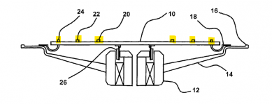

In your BMR builds, did you add any "ring masses" or locate the voice coil at a particular radius ratio in order to "balance the modes" as they describe in the Tectonic literature and patent?

As I mentioned in my post on the BMR units I have, the ring masses have been economised down to 3 straight strip masses. Not idealThomas,

Thanks Eucy,As I mentioned in my post on the BMR units I have, the ring masses have been economised down to 3 straight strip masses. Not ideal

I hadn't really been thinking about BMR's much lately until I saw @Sandasnickaren's pics of his small round BMR's, so your post didn't catch my attention originally.
I wonder if it's the same on their larger units? Their white paper seemed to suggest that they prefer designs that require 3 or 4 ring masses. I'm thinking that those three straight strip masses only count as one ring mass, but I could be wrong.

Yep.. They're on the same diameter lineI'm thinking that those three straight strip masses only count as one ring mass, but I could be wrong
No, I haven’t add any ring masses. I was planning to but never came around to do it. They sound well enough. The VC former diameter was given by the chosen exciter, so no. The edges are done according to their patent.Thomas,

If I remember correctly from reading this patent some time ago, the third outer ringe was removed as the rubber surround was placed in this position, to replace it.
So only the two inner rings were used.
