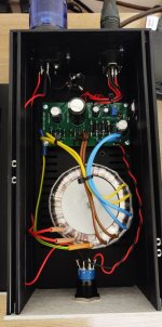

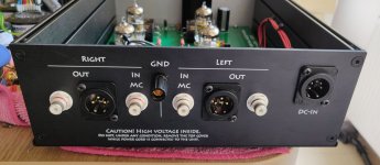

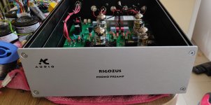

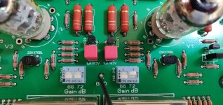

Fully balanced phono preamp
Here is my fully balanced phono preamp for MC cartridges, using LL1941 step up transformers and 4 X Tesla PCC88 tubes. Adjustable Gain: 62,66,72dB and Loading adjustment on secondary of LL1941 to match the cartridge. I used two case design for low vibration and to keep away the transformer from tubes. It has a mute circuit with delay. Maida style regulator on phono PCB, heaters are regulated.
Thank you guys. It took a considerable amount of time to design and finish the preamp. Especially the cases.
