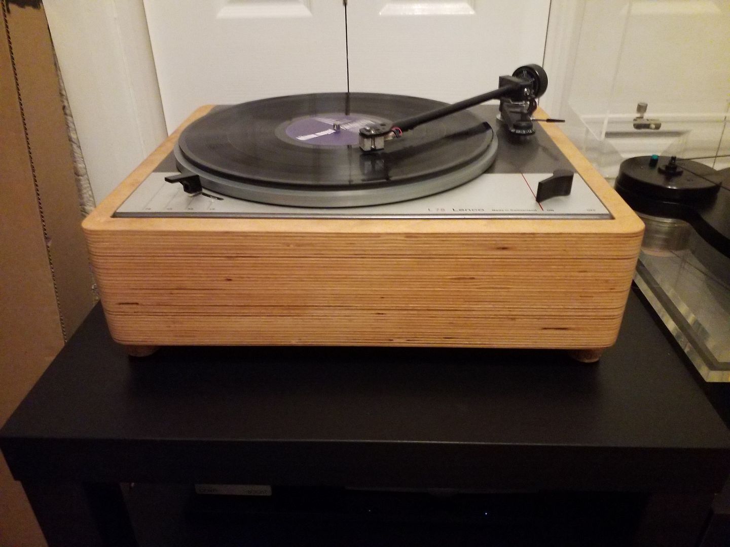

Lenco build - fully refurbished with Linn arm and Denon 103MA cart.
Plinth is Ply with cork feet and plenty of other mods

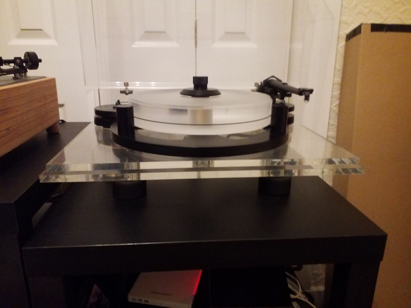

And the other TT
Michell Gyrodec with SME V and Goldring Elite.
The platter is 100% acrylic with 'Pete Pylons' replacing the springs in the suspension turrets and mounted on skateboard wheels - plus the bearing under the spindle replaced with a none metal bearing.
Both TT's sound fantastic 🙂

Both really nice builds...congratulations .
When you say " non metallic bearing" what did you use ?
Great work...but what/where do all those cables go to in that photo of the deck ?...there must be more to tell ?🙂

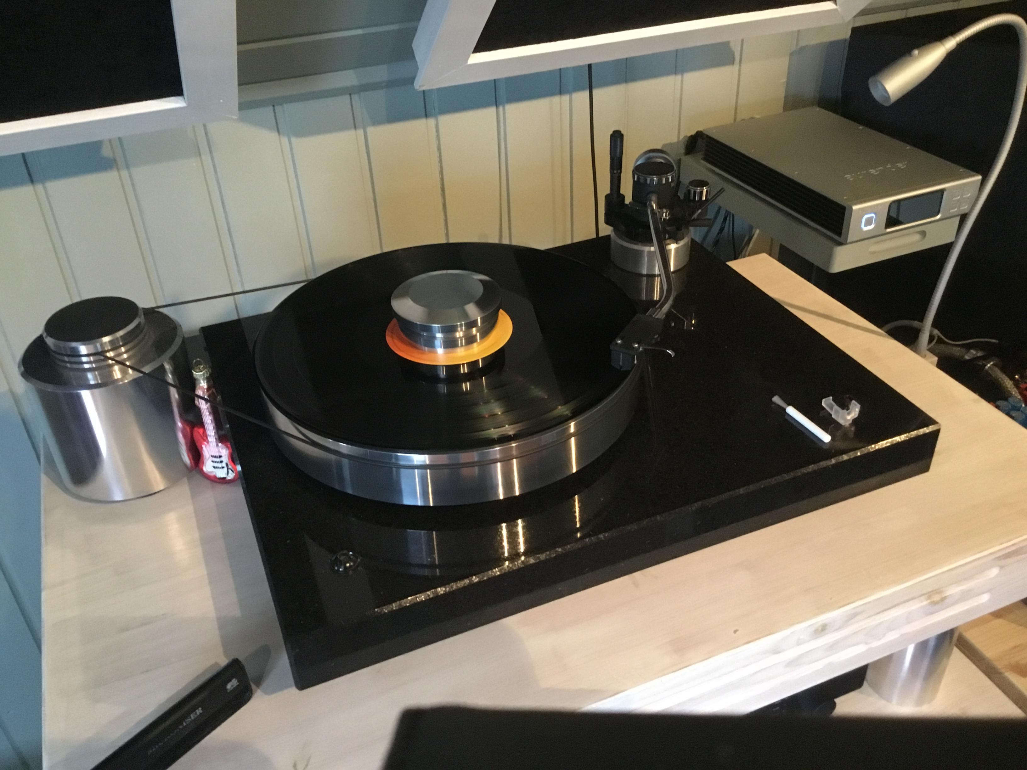

My turntable with the tonearm Lil Casey by Carlo Ballestrero (nocdplz)
Hi Alex,
Nice TT of yours. Can you pls provide some details such as material of the plinth, bearing type, motor unit ....

Granite plinth, massiv alu platter, ac motor inside massive alu housing, and Jelco 850 mkII with Denon 103-R cartridge. Sounds dynamic and detailed.
that’s a serious TT !
