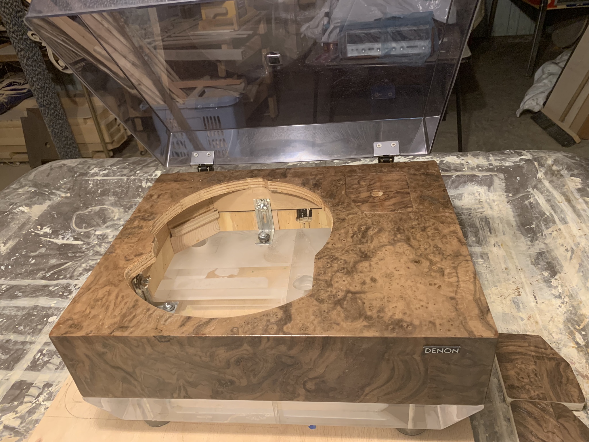

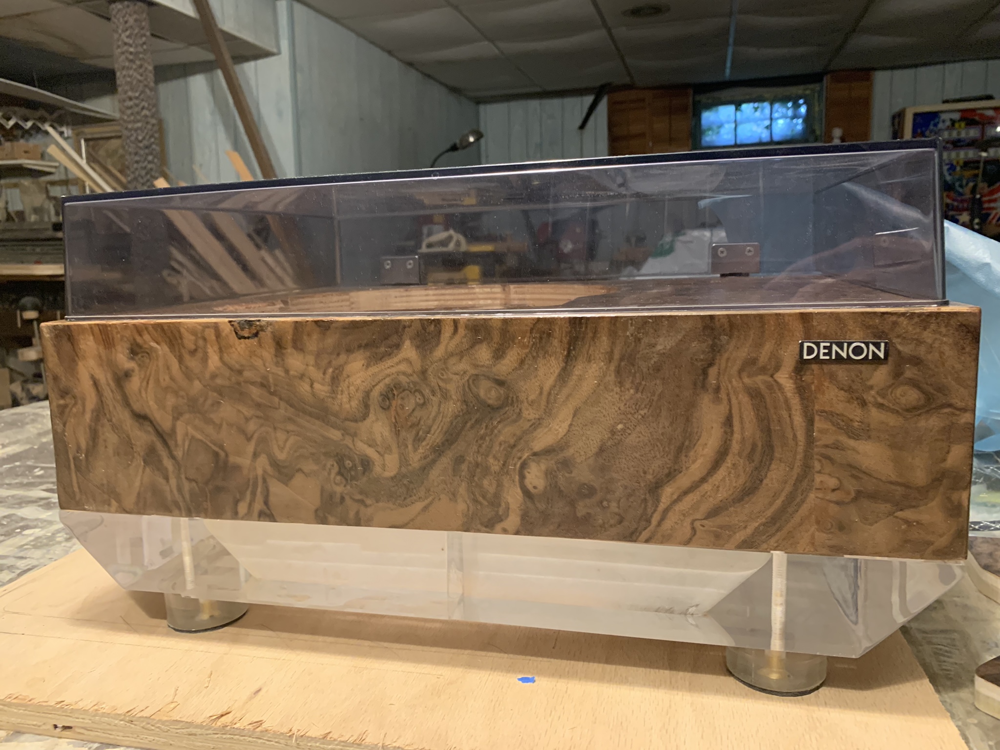

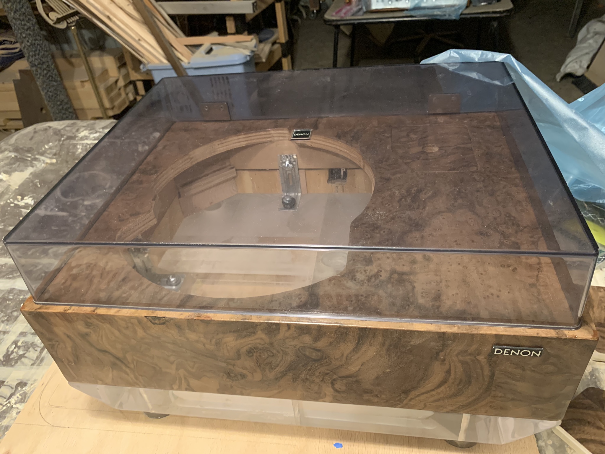

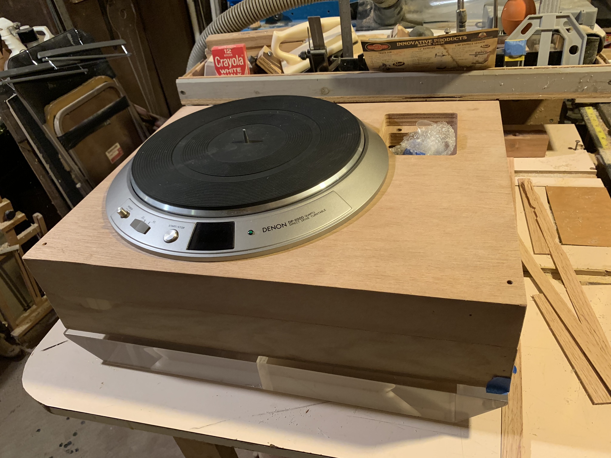

My almost finished Denon plinth
Still trying to figure out topcoat for veneer

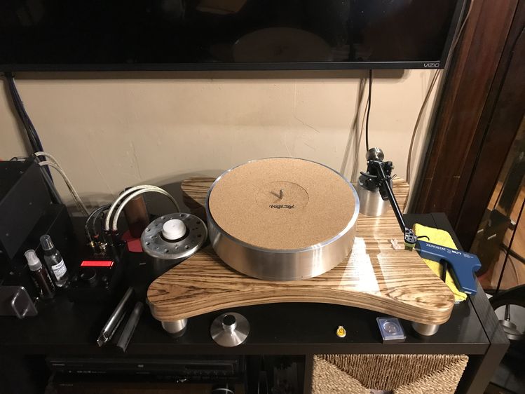

This is My very first turntable build. The construction took 4 long months as I wasn’t sure how I wanted to make the bearing housing. The platter is supported by a single thrust bearing and uses bronze bushings. I’ve only made three changes since completing it in Jan of 2018. The first change was to replace the Hurst 3905 motor with a Hurst 3949 motor which uses ball bearings versus bushings. Initially the platter had to be pushed to start. After some side by side testing I learned the the original steel pulley was interfering with magnetic field and prevented unassisted start ups. I replaced pulley with one I made from delrin cutting board. The last minor change was to go monofilament fishing line and ditching the rubber belt. I still don’t know the overall weight but platter alone is 33 lbs. Only two items were sent to a machine shop, the platter and the main shaft. Metal pulley had lots of runout and with only a drill press on no lathe I was not able to address it. The Delrin pulley still has runout but far less than the first.YouTube
